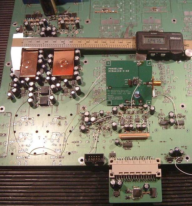

Hi Jaka,
Yes, I noticed that you had correctly decoupled the PSU to their respective ground connections on the IC’s. It all to common to see PCB designs where the decoupling caps are connected to VCC but with impossibly long connections to there relevant ground pins…
Like ECL, LVDS also requires controlled PCB impedances.
As the PCB I modified to UHS CMOS clock distribution was originally designed for LVDS, the PCB tracking was far longer then desirable using CMOS transmission - about 150mm @ 100MHz, but still it performed better then LVDS - the CMOS was series terminated.
Your comments about the XO clock deserve further comment. There’s little point in having an ultra low noise supply for the XO, only to have a poor quality supply to the modulator. The PLL and clock distribution in the modulator also requires the same care and attention – not to mention the modulators output section which powers the final PWM reference Latch’s and output pin drivers.
Also, it’s a bad idea to have separate supplies to the XO and the modulator as any noise on these supplies will no longer be seen as common-mode by the modulator. Operate the XO and modulators PLL / Clock sections from the same low noise supplies.
The little modulator PCB should contain the Modulator, SRC, XO & Low noise supplies for modulator + XO.
Use a discrete transistor Pierce XO with a single transistor gain stage as the logic level buffer.
Below is the offending PCB, you can see it heavily modified with the PhaseLink XO BD, with the PWM referance Latches and there PSU under the copper screening tins (notice a CMOS clock length of about 125mm), above the tins, the 200W output stage, with no heat sink – just 2 ounce copper PCB. Also, notice the TAS5015 modulator on the small plug-in PCB in the lower of the picture.

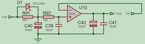

Here’s my solution, a simple LPF / Opamp / EF. It deserves little circuit description, but anyway here are some notes.
The Vref pin is the required Output voltage; its maximum depends on the input CM range of the Opamp. I normally use a standard regulator as the reference input source; its noise contribution is filtered by the LPF R1, C4.
Don’t send too much time worrying about the noise performance of the Vref, as its completely filtered by R1, C4 – as I said I use 78XX / LM317 type regulators to provide the “Reference”
D1 charges up C4 quickly to about 150mV of Vref, where R1 then takes over and provides the filtering.
R2, C5 stabilise the FB loop at HF, I’ve not spent much time “tuning” these values, as circuit performance is limited by thermal noise.
The Collector voltage on Q1 is supplied by a Pre regulated supply say from a 78XX or 317 type Regulator - at least 3V to 4V higher then Vref, this voltage also powers the Op-amp.
The feedback is TAKEN FROM THE critical node – say the power pin of the IC. So lets say the above circuit powers the PLL Vcc on the TAS, the output of the regulator feeds the PLL’s Power Pad, AND THE REAR off the IC PAD is used as the Feedback pick-up point. This way the regulator senses the true voltage and noise as seen by the PLL. For ultimate performance, it would be better to sense the voltage on the Die - but in this case, we have no access to this point…
The noise of the circuit is lower then –155dB Rel say 5V, from 50Hz, and is limited by the 5534, which is very low noise.
The output impedance - being actively reduced by the Open Loop gain of the 5534 is lower than the typical PCB Copper tracking, and certainly much less then the IC package impedance.
Very simple – and not easily bettered, sure an AD797 gives a little lower LF noise, but its greater then –155dB already!!
A great advantage of the circuit is as the output impedance is extremely low across the entire audio band due to the active FB; the quality of the bulk decoupling capacitors becomes less critical i.e. less capacitor sound "signature".

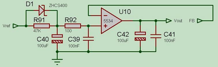

Hi Jaka,
C1 on my earlier posting should have been 100nF, U1’s pin numbers are incorrect & a FMMT617 can be used at lower current levels.
As the OPAMP can directly supply (and sink) up to 30mA for low current applications, it can be used without Q1. If Q1 is not used then R2, C5 are also no longer needed, but in this instance keep the FB traces as short as possible – a good idea in any case.
Here’s the circuit for up to 30mA, again the same principle for the “Vref” filtering and FB Kelvin sense as earlier.
R92 limits input stage current in case of O/P short Circuit - thereby preventing damage to the internal protection diodes. Its value should be kept as low as possible to prevent unfiltered thermal noise - but high enough to limit IP current during S/C. It should also have been fitted in my ealier post.

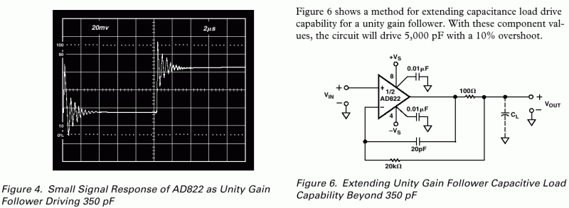

HI Jaka, Tiki
Your quite correct in being concerned about RF IMD effects on any “non-linear” circuit.
I’ve used the circuit topology for 10 years now, and in that time only once have I seen RF affecting the noise floor. The 5532/4 have proved to perform very well in the presence of RF. I’ve also found that newer breads of “Super Opamps” perform much worse – to a point where I no longer try using them.
I’ve found that the AD797 in unity gain applications oscillates at about 500MHz – 100uV and greater, even with the “Series Damping” resister in the FB loop as described by AD. Due to the HF and low level of this oscillation, its not visible on a Scope, I only found it with a RF Spectrum analyser. The PSU was well decoupled – I still have not been able to use the AD797 in unity gain application with satisfactory results.
In the case of the RF IMD induced “5dB Noise Floor” modulation with the 5534, I cured the problem by placing a 100pF cap next to the IC across the FB loop. This was only observed in the configuration without the EF current buffer. I guess the RC loop stabilisation components help here.
Now when I use the 5534 without the EF buffer, and with a long FB connection, I always place a 100pF cap across the FB loop as close as possible to the IC – my error for not showing it on the circuit.

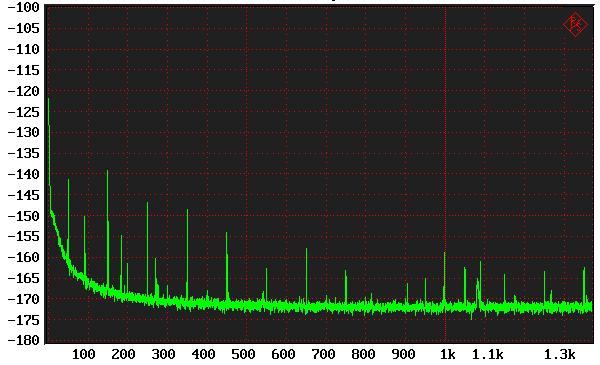

Below is a typical FFT of a 5V output regulator, with 0dB scale referenced to 5V. The designed was based on the second circuit (but the addition of the EF buffer does not effect the noise floor). The regulator is driving a reference latch Clocked at 33.868MHz. The mains harmonics are due to analyser and test set-up - notice the very low & flat noise floor.

The LM317 is a still considered “Low Noise”, but even with good decoupling peaks at about 1KHz, the frequency of this peak depends on the output current. I would not worry too much about RF IMD in the 5534 circuit when you observe such behaviour from standard regulators.
100uF+100nF C I/P, C O/P & Cadj
Belows an FFT of a LM317 with 100uF+100nF C I/P, C O/P & Cadj, Vout 5V, No Load, Vref 5V.
