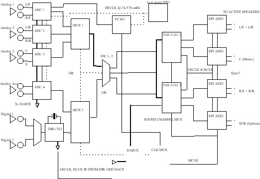

John and Jaka, thanks for the comments.
This is getting a huge project. By building it modulair and in small steps it must be feasable.
John, what do you mean by your remark about the 6 analogue inputs? I'm aware of the dac / adc loop between the dvd and the preamp, but is there an alternative to get the decoded signal in the preamp?? (Without modding several DVD players to get the I2s?)
As for the low jitter clock in the preamp, I distributed the signal throughout the the design when in analogue mode. Easiest for keeping the machinery in synch. I guess.
Now working on the schematic of the AES receiver, using the TI DIR 1703. This schematic is soon to be posted as well as the almost finished H-bridge power supply prototype. No measurments taken yet. Scope is soon to arrive and then I know more.

Pitch254, I agree with Jaka, it would be easier to try a simpler project first, and then scale it up. I would recommend modifying the I2S on a DVD to provide the surround outputs. It’s not worth going to all these lengths to have a pure digital amplifier, only to have an extra DAC to ADC conversion loop. Your block diagram has the SRC in the “Power Stage and filter” - so no need to have a second SRC in the pre-amp. If you use a SRC, there is no need for a VCXO.
