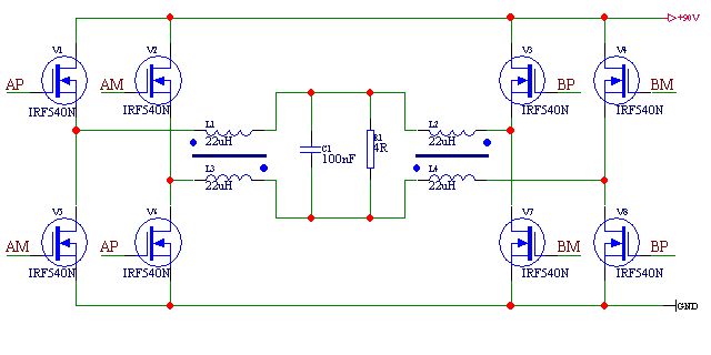

Hi John,
I attached schematic of double bridge output stage that was already proposed. It can be used with classBD outputs of TAS5015 modulator. Filter resonant frequency is 107kHz. Note coupled inductors L1, L3 and L2,L4. They center output common voltage at half of the supply voltage. Next attachment is simulation showing ripple cancelation. It shows 12kHz sine wave burst at 0.93 and 0.001 modulation index. Voltage scale is 20V/div and 20VmV/div. Note almost absolute lack of switching ripple.

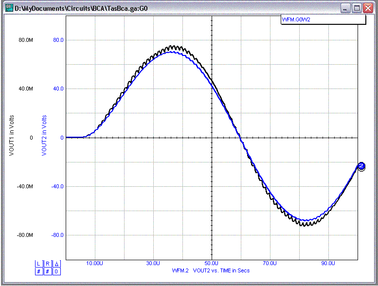

Hi Jaka,
Many thanks for spending the time doing the simulation, the output ripple looks very good - what’s the switching Freq?
Forgive me for some possibly stupid questions – but here goes: -
In simple terms (as that’s how I think), can it be thought of as a double AD output stage (coupled inductors) but with the added benefit of carrier cancellation offered by BD modulation?
1. How sensitive are the coupled inductors to tolerance matching, I once designed a SMPS with coupled inductors for regulation and found it hard to insure QC on the production line (its ALWAYS hard to insure QC on the production line in Asia – but the designs sensitivity to matching didn’t help).
2. Are you sure about the phasing of the Bridge, normally AP and BP are opposite in Phase – what’s to stop them shorting themselves out – or is the current limited by the inductors? So V1 & V7 are on, then V5 & V3. Then sometimes the bridge is in Tri-State – just depending on the 180Deg BD delay shift…. I guess your going to say the inductors limit the current…. In that case, they had better not saturate … (I know inductors should never be allowed to saturate, but in this configuration it would be fatal).
3. What’s the FC of the filter into 4 Ohms, and would you have to double the size of the inductors for 8 Ohms as usual – I’m sure you would…
I also wonder if coupled inductors would cancel the distortion effects due to core permeability linearity verses magnetising current – is there a net constant current in a coupled inductor?
I guess if there is, then the cancellation of the distortion would be dependent on the ratio of the original error and the matching of the coupled inductors. To that end, it maybe an advantage to always use coupled inductors on an AD output stage.

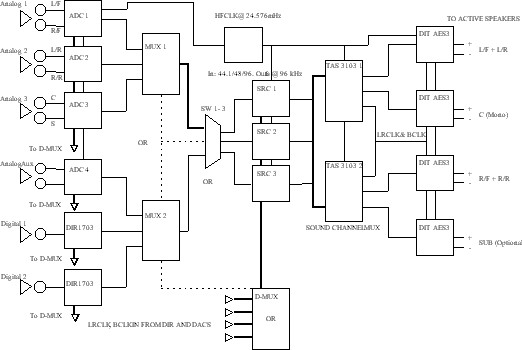

Sorry fellas, but last thing I remember I just finished a 5012/5110. You'r going way too fast for me. But can you have a look at this please (see picture)
6 analog in for 5.1, and extra inputs for dig and analog stereo. Mux this to a SRC and than to tas3103 for channel muxing.
The channels are sent to digital speakers using AES3 balanced stp. The digital speakers will consist of 5015/5182 amps. all running on a vhq HFCLK vcxo @ 98 mhz.
Using tas 3103 for hi/mid/low driver filtering.
Will this work? Especially concerning the clock strategy.
Do the 1703's require their own clock / crystal? Or can they swing on the hfclk available?

Hi Pitch 254
1. Is there any reason that you need 2 DIF1703 – I would recommend just Mux the AES inputs to one DIF1703
2. In the “Pre – Amp” section, only the ADC’s need a low jitter Clock, the SRC should be used with the modulator in the Speakers to attenuate the total system jitter. Run each SRC from its own 100MHz clock (using the TAS5015), and not a direct multiple of the sampling frequency.
3. The output DIT's would need to be run off the ADC clock when the unit is in ADC Mode, and likewise, when in AES mode the DIT's should receive their clock from the DIF1703.
I question the need or 6 Analogue surround inputs, would it not be better to received decoded surround data in digital, thus avoiding an extra DAC / ADC loop?

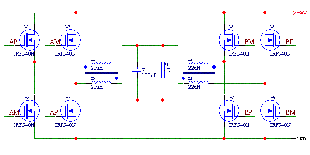

Hi John,
simulation frequency was 390kHz (tas5015@100MHz).Triangular modulator was used for sake of simplicity.
You are correct, it is actually two AD bridges. As you noted, schematic was wrong, correct drive signals are on the picture below. I made error when redrawing simulation schematic in Protel, since Ispice schematics are not readable.
I do not see inductors as critical element. In simulation they were modeled with 0.9 coupling factor. In real circuit, I used toroidal core (both gapped ferrite and Magnetics KoolMu) with one winding on each half of the core. As long as you have equal number of turns on both windings I do not see a problem. My experience with coupled inductors is that it is preferable to have loose coupling, for instance each winding on a bobbin of a UI or UU core. I have tested the circuit with triangle modulators and it works as advertised.
Net current in coupled inductor has the same shape as in single inductor, so no distortion cancellation. So far i have not researched what is the best material for filter core (air?). I know all materials with distributed gap have nonlinear permeability vs AC and DC flux density and frequency and that low mu materials are more linear. But from sharp rise in current when gaped ferrite core comes into saturation I assume that their linearity relative to the DC flux density is superior.
Regarding filter design, it is no different than with single bridge, only that the net inductance is the same as single inductor (22uH) in case of uncoupled inductors. Two paralleled inductors in series with two paralleled inductors. If you couple the inductor, you calculate whole number number of turns for double inductance (44uH), but only half of the output current.
There is one added benefit of coupled inductor. It's transformer action helps to equalize AD bridge switching times.

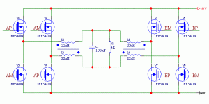

Hi Jaka,
Something has gone wrong with your simulation. The A outputs use positive modulation, while the B outputs use negative modulation. Thus BP similar to AM just toggled in time (with delay). A polarity swapping is needed on the B side. In your way, that's a short circuit.
In this way a simple IRF540 is enough because of the current halfing. The ST's IRF540 has 10 nC miller charge.
The simplier if you use the A and B outpust just for bridge operation.
The band-pass of your filter is at 80 kHz with 30 Ohm.
Regards, Gyula
Hi Gyula,
You are of course correct that L = Al * N^2. But you will also see that circuit with 22uH coupled inductors simulates the same as one with uncoupled 44uH inductors. This is also consistent with your simulation of bandpass of 80khHz (calculated resonance is 75kHz at 44uH). Please, also do not stick to the proposed component values, they were chosen only as the proof of concept. I have built the circuit 3-4 years ago and it was not intended for audio.
Best regards,
Jaka Racman
