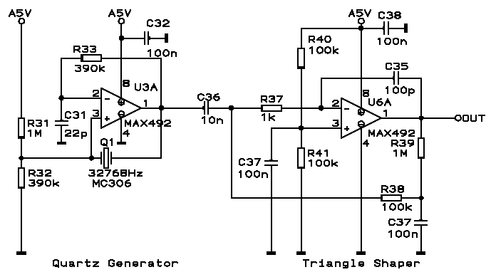

Hello Pitch!
Thank you for the device! I would like to make it from discrete components instead of zxcd1000. I have a very simple schematic for that quartz drived triangle wave generator. It consist of a square wave oscillator which is driving an integrator, but in this way the average value of the output is moving undeterminable. This can be corrected with a high value parallel resistance with the integrator's capacitor, but this point the output is nonlinear. An another method should be used.
This is my problem..
Regards, Gyula
Regards, Gyula

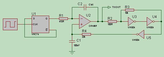

Hi Gyula, All,
I know totally zilch about all these digital amps and I can't figure out what's the quartz is doing in the triangle generator.
IMHO, when you define a specific slope for the triangle, and want to switch at specific voltages (for defined avg) without some sort of feedback/servo, then the period of the triangle is already defined and the quartz is out of the job.
If this is OK with you, and you don't need a quartz exact frequency, two comparators, a flip-flop, two ultra high impedance current sources and a cap, will do.
Peter Jacobi
Gyula said:I would like to make it from discrete components instead of zxcd1000. I have a very simple schematic for that quartz drived triangle wave generator. It consist of a square wave oscillator which is driving an integrator, but in this way the average value of the output is moving undeterminable. [...]
Peter Jacobi
Hi Gyula,
Simple FB can be added to the OPAMP integrator you mentioned to restore DC conditions.
Here’s a basic idea behind the circuit, pls. note I haven’t tested it so you might have to play with the values, Cint depends on the output frequency and amplitude of the Tri Wave required: -
U1 divides the input clock by 2, thereby insuring a 50% duty cycle clock. If the logic is powered from 5V (recommended), the average DC voltage of the Clock will be 2V5. The output from U1 is fed into the Integrator by R1 (keep it value below 1K to prevent noise, adjust C2 - Cint) the integrator generates the Triangle wave (insure the Opamp is unity gain stable – due to the 100% FB though C2). The output is “sliced” at about 2.5V by the “Comparator” based on U3 & U4 with R2 & R3 creating a small amount of hysteresis (this hysteresis will cause a very small offset error). U5, C1, R4 filter the resultant square wave from the output of the comparator - who’s duty depends on the DC offset at output of the OPAMP. The Opamp then insures the average DC voltage on its Non Inverting and Inverting inputs (2.5V) are the same.
I hope it's helpful, John
triangle
Hi Gyula,
may this idea work for your triangle shaper? I did not prove it, only simulated.
The trick is, to connect the feedback resistor R38 before the integrating resistor R37, not across the integrating capacitor, C35.
All component values have to be changed regarding your design.
For DC and therefore the AC arithmetic average value the network R39, C37, R38 should act as a short between U6A's output and his noninverting input - creating a voltage follower. R38 should possibly get a larger value, depending on the stabilisation time and the input bias current of the OPA.
Good Luck!
Hi Gyula,
Good Luck!

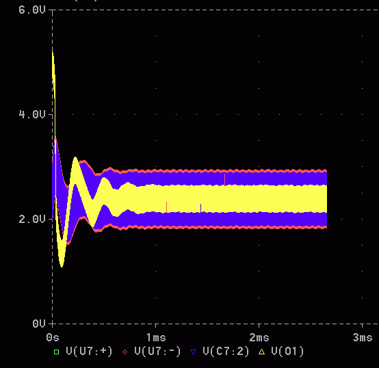

triangel
Here is the simulated stabilisation behaviour.
red - input 1MHz rectangle 1V (plus 16kHz 10mV sine, as disturbation)
blue - voltage at the inverting input of the OPA
yellow - output
Wow, the other guys were really fast, but my 'solution' looks simpler!
Regards, Timo
yellow - output
Regards, Timo

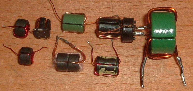

Hi John, Timo, Jaka and Peter!
Peter, I'm understanding your doubts, I just thought it before written the question. The quartz control is needed for eliminate the thermal dependence.
John and Timo, thank you for the really fast help and the simulation ! It will be a big help for me to do an analog modulator.
Jaka, I did your suggested modification for class-I. You suggested that the mosfets' discharging should be delayed to avoid the coils' exhaustion. The result is quite GOOD!
Jaka, thank you for your help!!
The drowning is just a little amount in the sound already, a little bit more delay still should be done.. I think the high range of the sound is really better even in this case, than it was in class-D. There are two paralleled SGS Th. IRF540 in the output stage's upper and lower sides, driven with the IR2110 through a (47 microhenry) x (MBR1100 Schottky) with cathode to the fets. When the fets were connected directly to the driver's output, the drowning was horrible, I didn't think the histeresis, Rds/on/, and Uf losses is such a great amount.
The coils were made from two A-324117-2 Arnold MPP toroids with 16 turns on each of them. A little bit small ones, but in my country only this type of Arnold MPP was obtainable (for approximately 2 weeks), so the situation in this country is drastic.. really.
I don't understand what crown writes at his homepage (with illustrations) : class-I recirculates the reactive energy (current from the speakers' inductance), and the other topologies don't.
It almost have done with class-D. what a blame!

Here are some pages I scanned from an old (1988) article. Described is crystal driven triangle modulator and also output filter with notch stage. (John might be interested).

For teaser, attached is a picture of 25kHz output from class D amplifier running open loop. It is from the article i scanned.

Thanks for scanning the Class D Info - maybe I’m slow, but it’s not immediately obvious to me which components in the LPF comprise the Notch Filter?
There’s some good information in the equivalent circuit for the output filter - better models for the Caps Etc. Guess I will have to load it into my Simulator to find how the Notch is created.
Here’s a picture of some of the many inductors that where tried for the Zetex inductor solution – I hope that Pulse are not trying to take the credit for the inductor design! – Which are good for there target market @ 0.013% @ 100W Open Loop (for the big green ones) – but are nowhere near my target of less then 0.00005%!
