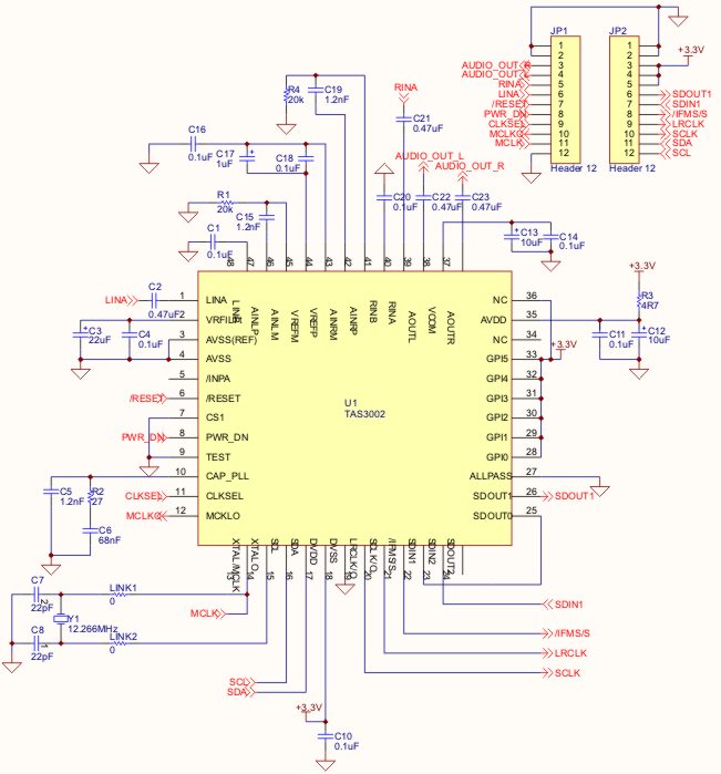

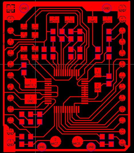

I have just finish building my second TAS3002 test board but it still isnt working!
I was wondering if someone could have a look and see what I am doing wrong. I have attached a Protel schematic+photo of a TAS3002 test board I have built.
However when I power up the board the 3.3V rail drops to 1.3V and the board sinks 450mA !!!
Help!
Mark.

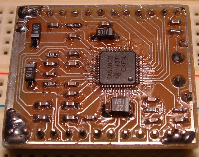

TAS3002 further details
The photo I took looked shocking, The soldering actually looks a fair bit better than in the picture.
Here are some pictures of the PCB, schematic and a better photo of the board.
Mark.

Hi Mark,
While I have no experience of the TI TAS3002, I had a quick look at your boards and schematic. At first glance, there appears not much wrong with the circuit, i.e. No outputs connected to GND / VDD, or reversed power connections.
The obvious aside, my attention would then focus on the PSU decoupling. If you take a closer look at the device decoupling, you will find extremely long & thin path lengths between the devices Vdd & Ground pins. It’s not helped by the fact that the AVdd & AVss are physically located on opposite sides of a QFPP! – A very bad device layout by Ti.
A 100n decoupling cap should be placed as close a possible to the package across pins 17 & 18, A ground plane under the IC from pins 3 & 4 (AVss) routed thou pins 36 & 34 (both NC), and a 100n decoupling cap from this ground plane to pin 35 (Avdd) – again directly on the PSU pins as close as possible to the package. Pin 18 DVss should also be connected to the ground plane under the device.
Remembering that you decoupling the internal die – DVdd to DVss & AVdd to AVss.
Best of luck,
John

Thanks for looking over the circuit and your comments. They are very valid comments and it was a tricky balance to get decoupling caps as close as possible to the pins and to also minimise/eliminate the need for vias as this is a homebrew pcb.
This dosn't however explain the reason for the significant voltage drop/current consuption of the IC. Its wierd that I made another board with this IC + the TAS5010 and although it did have another error, it exhibited a similar current consumption/voltage drop and it was configured significantly differently to this board.
I might have to resort to cutting tracks and measuring current consumption of various pins of the IC to track it down.
Any ideas anyone? Just after a little protoboard for this IC so I can play around with it!
