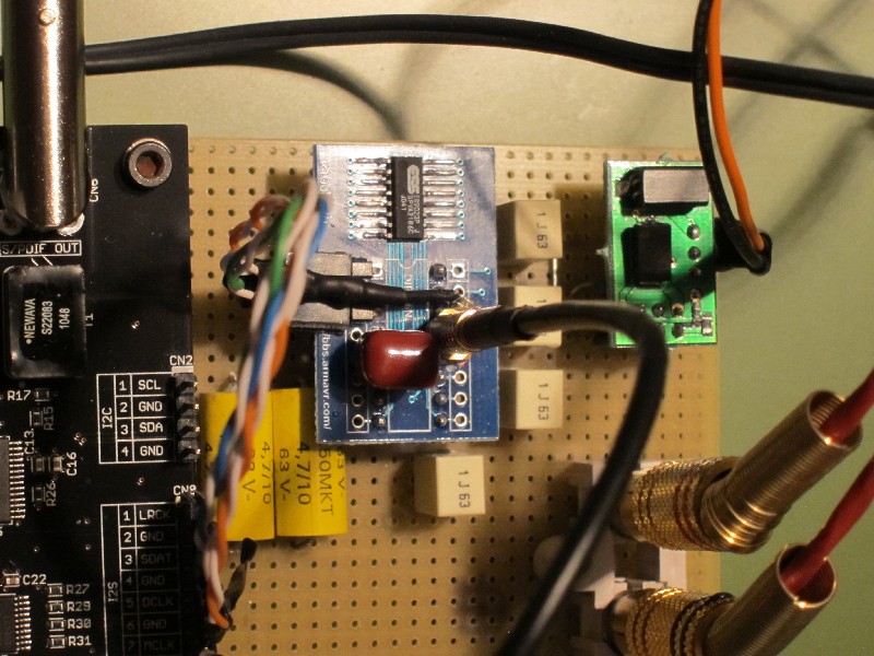

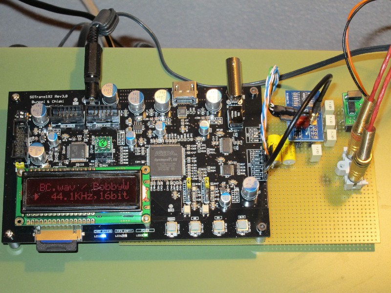

Hello Patrick,
I'm also very interested in parts for the output stage.
I like very much my ES9023 Dac but at the moment is more precise but a bit more agressive that my AD1865.

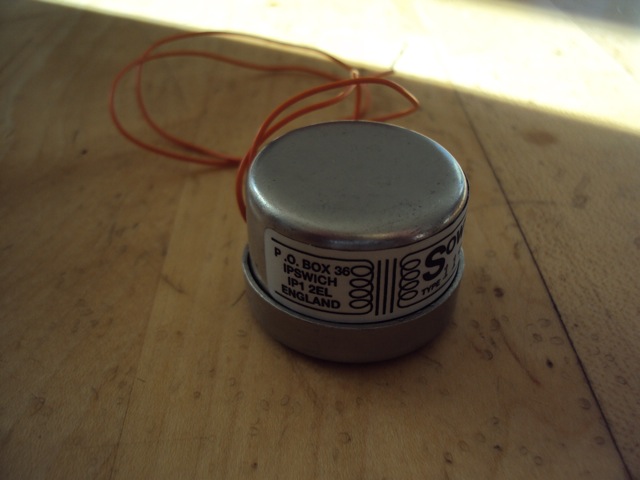

This are the 24mH coils that Sowter makes for me. They are wound on a Mumetall core for low distortion. I use them in an inductive RIAA i designed for a German High End company.
Such coils are used in expensive mixing boards and tube equalizers so they have some audio credibility. I will make a filter-buffer board and test this with the EUVL ES9022.
Then i have something to compare with the Faston coils when they arrive.
The resistor to ground before the buffer has to be raised in value in proportion to the higher coil value.
