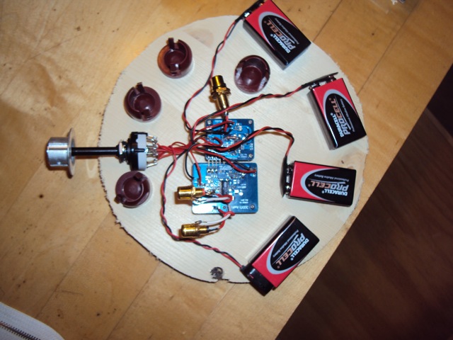

After initial success i had some trouble to make the Wolfson input receiver look. After consulting with EUVL i made a switch that connects all 4 batteries at the same time. BINGO, it works. This time with the Forsell as transport and much shorter wiring to my power amps. The sound : I was speechless. Much more energy then before. Mind you, this does not sound like analog at all. It is a very honest sound that brings out the best and the worse in the recording. From silky smooth tube recordings like Harry Belafonte at Carnegy Hall to rough and ready Mary J. Blidge. There still is this this tiny bit of artifice. I have to listen more but i am already addicted.

Joachim,
If I get some time around Easter, there is a balanced version to try.
And if you would invest in a QA550 as a temporary solution (our own is not ready in 6months), you can also drive the player and the DAC (without the Wolfson) with one single clock at 45.584MHz.
There is a lot more to come with this harmless looking chip.
But next thing we all look forward to your filter buffer. ;)
Patrick

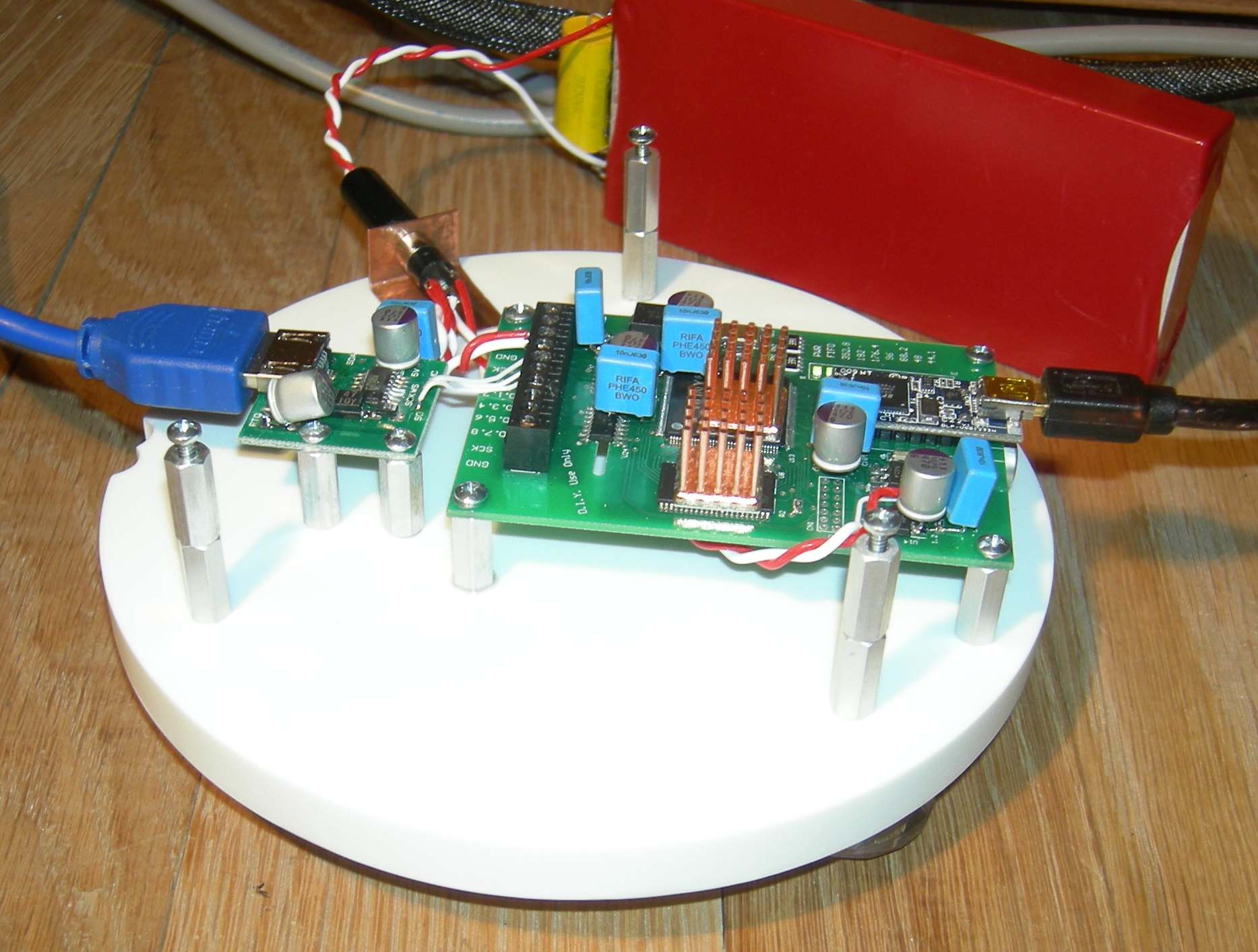

Hi Joachim,
Do you see any physical resemblance between my attached picture to the device you have in your rack :D
PS! If you feed the ES9022/3 DAC with true 24bit data the last of the "There still is this this tiny bit of artifice" will be removed and you can either drop your filter or change it to a greater pass band.
The SD card player you mentioned from our friends in Japan, the Titan USB -> I2S board or the exaU2I USB -> I2S board (in the attached picture) are the sources I know that will give the best results with ES DACs..
