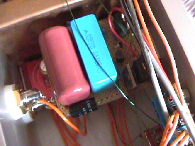

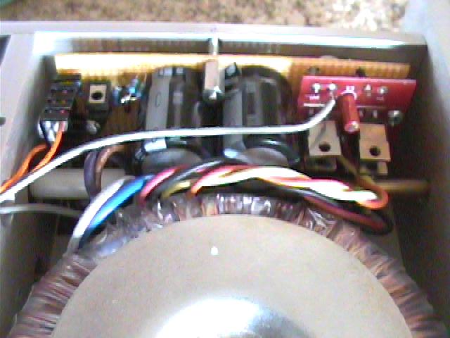

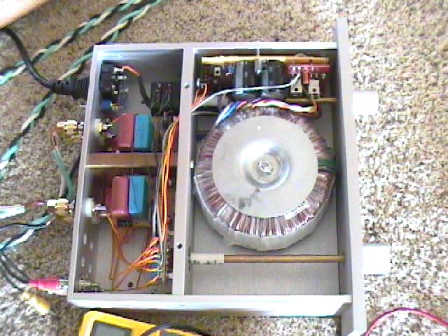

It works!
Well, after a few minor setbacks it's working and sounds pretty nice at first go. Haven't had time yet to listen critically, but no abvious nasty's. To recap, I'm using Brian Gt's board and resistors (premium pack), but with 47uf Cerafine caps on the board, Pedja's ultimate discreet regulated ps, and Pedja's jfet buffers. This is all stuffed (and I mean that - I'll try to post some pics later today) into one of Peter Daniels fancy chassis.
One might ask why I chose this combo. Just in case you do, here's the story. I bought Brians kit mostly on a lark. I'm in this primarily to learn, not to save money. So I figured I might as well complicate my life, and I liked the idea of building a couple of discreet circuits (have never done that before) and getting the whole thing to work. Plus, a fair number of builders have fournd the regulated and/or buffered "clones" preferable. I'm not taking sides in that debate, and I probably won't test one against the other. I'm getting out of it what I want.
As for the start-up problems. The first I had was a loose solder joint on the neg. ps j309, so no output from that side. Can you say DC offset boys and girls? I had used smd j309's to which I attached fine wire, then mounted. Those are tiny. Fiddling around, I accidently detached one of the wires. Once fixed, I discovered that I had wired the source selector switch wrong. Fixed that, and it works. By the way, I wired the selector switch so that one position grounds the buffer output, in order to eliminate the turn-on thump. That works.
I still have a little tuning to do. I'm getting about 90mv offset in one channel and some hum, about 75mv in the other but very low hum. Maybe a bad joint or grounding arrangement to chase down. Time for a break before I tackle those.
Thanks to all the DIY members who inspired me to give this a shot. It's been slow going, because I'm a complete novice, but it's been fun.
Sheldon
