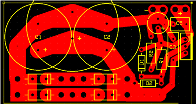

Any interest in GC input buffer and power supply regulator pcb's?

Non-inverted board and inverted board layouts with care to keep all the power, inputs, and outputs in the same spots...
I believe this all has the right schematics. :) I have holes for a bypass cap if you choose, as well as a zobel. Both of these would "float" above the board, but since they're optional things that most don't use and whatnot...
One of the design goals here was to make these "stackable" so you could bridge or parallel the circuits by running solid core through the inputs and outputs (turn a mess on their side for a standard case). I believe that has been achieved here. R1 on the NI board might get switched to a cap when run bridged, and R2 would get left off the NI if you parallel them, with a resistor run right at the input to ground I think. Maybe. :)
Regulated power, with the reg moved further away and the space used for (optional) additional caps (C3 and C5). This is just one side.
The OPA627 buffer option has had no comments, so I assume (dangerous I know) it's OK. Using schematic by Carlos.
And JFET buffer, first pass, using Pedja's circuit...
I will very likely be looking to etch some of these and try them out in the semi-near future, so any additional feedback would be most welcome - particularly, significant mistakes pointed out would be helpful. :)

On The OPA 627 Carlos board, the upper regulator has the center lead to ground, the lower doesn't. I assume that's because they are 2 different parts and are wired differently? (Otherwise I assume you'd have them facing in the same direction)
Well Variac, this'll prove it for you. :) Maybe. I have a degree in Fine Art (drawing). :) I like solving puzzles, especially visual types. And I can (usually) read a schematic.
Yes, different chips for each of the regs - actually, that's the case on both buffer boards. I do believe that is the usual way, though not an available option on the chip power boards so they use the same reg for both rails.

I knew they were different parts, I just was wondering if the pins were wired differently. On Carlo's schematic, the leg to ground is the center one, and on your lower reg I didn't think it was, BUT I didn't look up the part....and I don't know the conventions... BUT I did suspect you were wiring the regs differently consiously since one is 90 deg different iorientation than the other.
Actually they I think they could both face the same direction and the traces would work out...
You'd better take a look at that schematic again and read pin numbers on it. ;) At least, that's why I have it the way I do (and I did check the data sheet which, IIRC, checks out as I have it as well).
Yes, I could have them "face" the same way, but the traces wouldn't be as clean. No reason for that with these regs.

C2 should be near pin4 on the op-amp, and not on the opposite side.
When I mean near the op-amp's PSU pins, I really mean near .:D
So, I suggest that you move C2, along with the reg and it's input cap too.
The reason to move the reg is that you should have caps near it's input and output pins. If you just move C2, you should ideally use an extra bypass cap on the reg's output.
Sorry, I know that with my suggestion you will have to make some major changes on that board... :xeye:
But, believe me, it's worth the trouble.;)
Oh, btw, you may also find space, really on the op-amp's pins, to use 0.1uf multi-layer ceramic caps (from + to ground, - to ground).
Those caps are very small, just use them before the electrolythics.
Make it as tight as possible!:cool:

Franz G said:
Carlos
Why do you use ceramics for this purpose? Just because the datasheet mentions ceramics?
O.K., they are small. But don't you think, good film caps are better for this application?
Franz
Forget the datasheets, as they also advice to use tantalums.:D
You can use films of course.
But they are bigger, and then the electrolythics won't be as near as they shoud.
These op-amps like capacitance near them.
Ceramics bypass to higher frequencies than film caps, but the main point here is to have all the caps as near as possible to the op-amp's PSU pins.
Yes, you can throw away the good sound of the OPA627 by not doing this.
With veroboard I put ceramics inside the socket:eek:, and the electros so close that I have difficulty in changing an op-amp. :D
OPAs will reward you with fantastic sound if you know how do deal with them.:angel:
Other op-amps (like AD) work fine with "normal" layouts seen on most commercial products.:dead:
But they also like to be well treated.;)
Carlos: thanks for the tips. :) Expect another version soon.
I'm trying to allow for close coupling of the bypass caps at/near the chip pins while providing for a more "convenient" spot for the more "lazy" folks. On the amp boards I just allowed for placement without "room" on the top (underside would work - in fact, I think I can place the holes closer in that case! glad you said something. More tweaks.) - I will do this for the bypass caps on the buffer too. As to moving the other caps near the chip, see above - I'm working on it. It makes perfect sense to me now, so that must be a tidbit I picked up without quite ever grasping it fully. :)
My goal is to etch this stuff myself for trials, make any modifications if needed, then release printable artwork as well as contribute to any group buy effort that may happen. I would want to make sure that the contributors are credited properly (Pedja and Carlos in particular for their schematics, me for the artwork) and a few other things relating to any group-buy effort as well. I think blue PCBs would be pretty slick. :) Or black. . .
Brian: I had gone the double-sided route at one point and the request was made to go single so people could etch these themselves. I would definitely clean some things up by going double sided if a group-buy does go forward.

Ok, looked at it a bit… it still looks nice though I have a few thoughts.
The C3 on the regulator board, if used (if there is need), is good to be close to the regulator but as long as we consider it as an optional component I would give higher priority to R1. Incoming and outgoing traces around the reg itself are narrowing, I guess that is just an oversight.
The JFET buffer board is good and it would probably work well, only gate and source resistors on J310 are swapped. The resistor 1M may be put in raw with (below) these J310’s resistors and 1uF cap may be dragged down, the cascode will became tighter. You can also escape certain wiggle between 2SK170 and J310 if you rotate J310 for 180 degrees.
Do I understand well the amps themselves, inverting amp do has an input cap but non-inverting does not?
Pedja
Here we go again. :) Bypass caps are not on-board at all, though holes are provided if you choose to mount under the board, or you can mount straight to the pins or whatnot. The 1M resistor is rear-mounted. There's room to slide it over and mount above the two resistors if that would be preferable.
One thing I'm not quite clear on: Pedja said: "Incoming and outgoing traces around the reg itself are narrowing" - if this refers to the traces getting narrow to clear the other reg pins, a question: Is it better to have smaller traces that are consistent in size vs. thicker and narrow right at the reg? My understanding was the latter gave most of the capacity of the thicker traces while still reaching the pins.
I can certainly narrow those traces so they're the same size the whole way.
