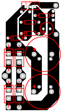

All this got me to thinking about a minimized PCB for the chip-amp portion since you don't need big caps any more... I came up with this.
Single sided board (though the R from pin3 to pin8 should really be mounted right to the pins, there's room for it). There is room for a zobel, for those that might want it also. There is one jumper here, but it connects power ground to signal ground, where I believe its normal drawbacks may actually be an advantage... I think.
So, as usual, the question is... any good?
I wasn't sure about putting the output ground separated by O+ so far, but that keeps the ground traces shorter overall and that seemed to be the more sensible approach...

Yes it is pretty nice.
Maybe that V- line could be routed left of (behind) the chip, so Rfb can go beneath the board and between two rows of chip’s pins?
It is not a long shared path but it might be not that hard to connect the Zobel to the PSU caps ground point independently of the signal ground. Speaker ground should be taken from the same PSU caps central point.

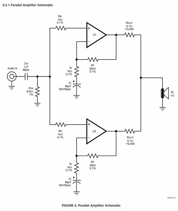

Parallel LM3886 board?
Hi C-
Since you are learning and tuning your skills, would you like to make a parallel LM3886 board?
I need one for a project, and my drawings have not been coming out as neat as yours.
The schematic is attached.
Thanks in advance,
Troy

oook. :) round two. I didn't mention previously but this is for the LM3875. I'll peek at the 3886 here in a bit.
The output ground is where you suggested I put it Pedja - that doesn't keep the connections quite as clean as I might like but I think it's in a spot such that it's not a problem, and hopefully the better placement as far as components goes will outweigh any other concerns.
Depending on the type of resistor you use, Rfb can probably go topside under the chip pins. If you're using premium components, I suspect you may also just choose to solder direct to the chip pins for that one. ;)

I just noticed, I don't have any place to bypass the caps with a small poly... should there be here? Also, the power cap spots should probably be set up to accept a small range in sizes since tuning those seems to be suggested by some.

here's a shot at the 3886 without implementation of the mute. I didn't dig too far yet to see if pin 7 always goes to ground but it was a straight shot so it's there right now. More reading of spec sheets will come. ;) edit: I still didn't read anything on this, so that leads me to believe it should be connected. ;)
One additional question: Would it be better to have separate traces for all the power ground points all come together at a single central point to the large mass to which they're all connected right now?

For the LM3886, I think this slight tweak will allow parallel circuits with as many as you choose. I believe you'll want to leave R2 off the boards and use just one at input (?) - same with the cap at input for parallel circuits. Output can come straight off the pin or through a resistor hence the dual O+ options. I have seen some suggestions that this R be used on a single board anyhow. I'm not sure whether trying to put two chips on a single board for a parallel circuit outweighs the potential to just stack as many single chip boards as you want/need.
I moved Rfb back outside the pins of the chip in case pin7 should go to the power ground directly not signal ground. ;) If not it leaves some room to open up the schematic and insert the mute circuitry...

I think I need to work on a better bypassing scheme... any suggestions would be helpful. :cool:

Yes, it seems it widened somehow… No need to move PSU caps to make a space for the speaker ground, just take that from the caps central point and make a track of few cm so you can make another pad. Bypass caps can be mounted beneath the board, though with 100u or smaller caps necessity for them becomes lesser.
I think the layout is generally very good and I think it is now most important to determine the definitive size of the parts.
