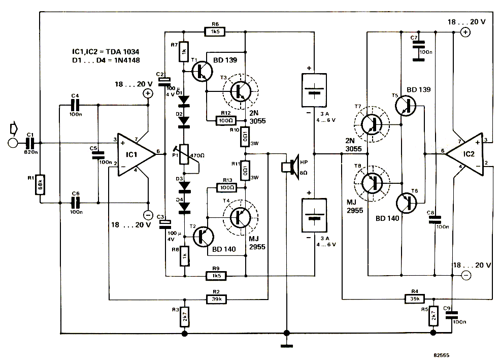

Personally, I would not forego the VI limiters in favor of tripping a relay. A relay is probably fast enough, but it does interrupt the music. If it happens because the speaker wires get shorted, it's ok. If it happens during a party, I'd rather listen to a bit of distortion than have the music(?) completely interrupted for a couple seconds. That might start a riot. Or get some smartawq saying your amp is a piece of
I'm sure the VI limiters will add measurable distortion when not activated but driving a 2 ohm load. At 4 ohms with only 1/2 the current you'd never even know they're there.

My thinking about this, is that since I never myself make any use of any amp under a 4 ohms load, I would design the amp for 4 ohms, with the protections tuned to be above that and have enough headroom in the outputs to handle any worst such case (reactive and all), but then I would only use the amp with 8ohms and the protections would never even come close to be activated. How about that? I'm even sometimes thinking about having 16ohms speakers, but I would not consider series or paralleling any speakers. They would have to be 8ohms or 16, whatever, but not 4. I think 2ohms is riddiculous, and when designing a bridge, then we can think of aiming for 4 ohms, which is normal, since we can load it with 8 and each sides sees 4.

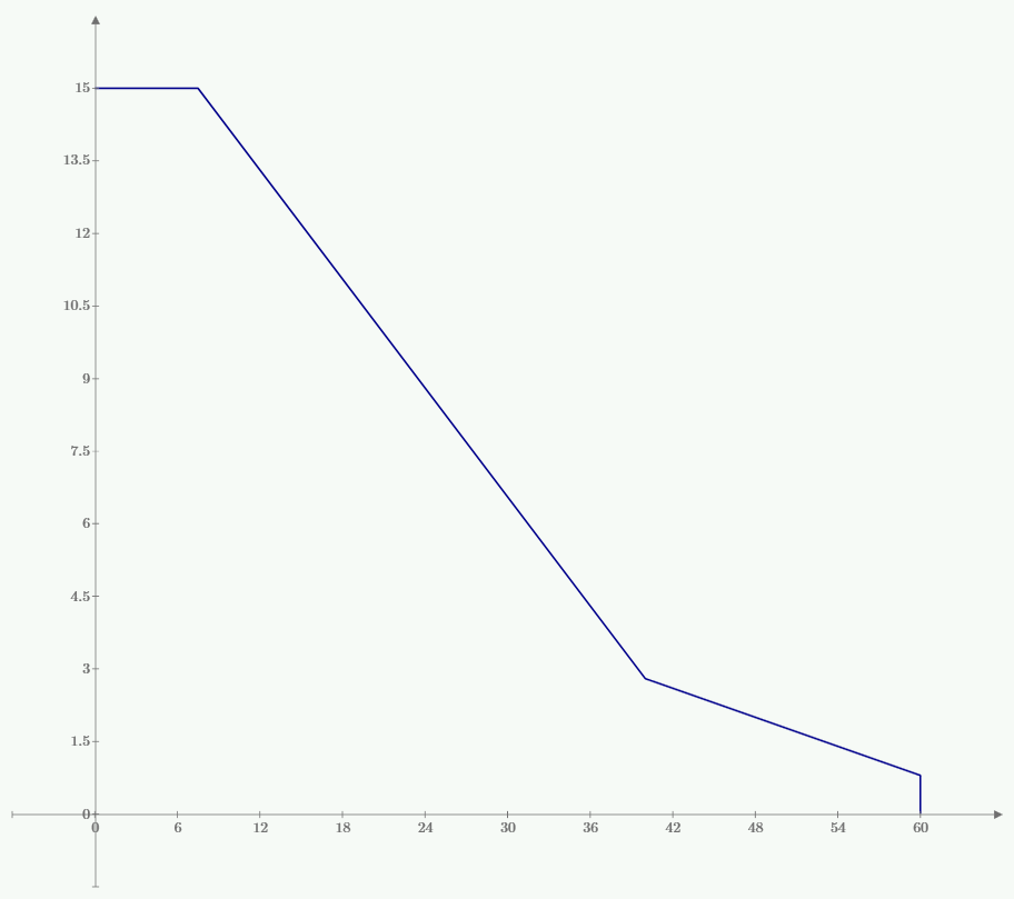

Here is a plot of the the 2N3055 SOA that I managed to make. This is not a hyperbolic curve, it's based only on the datasheet and I plotted it using the points at the knees for the DC curve on the datasheet SOA.
It seems to me that the simple dual slope locus with its knee (point B) somewhere not far from the secondary breakdown knee on the SOA graph should work very well. Plus looking at the available SOA "above" that, and having 3 pairs outputs, even 25A seems very conservative and as long as the protection prevents leaving the SOA, we can allow for more current. The 25A split into 3 pairs is below 8.5A and we have so much left over headroom above that, we could bring this up some more.
The AB slope could be steeper.
There is one detail that comes up however. Michael mentions that the slope with the segment BD must intersect the Vce axis higher than the rails if we want to insure against spurious action. However this is a problem, because we already have the rails a little above the breakdown max voltage, which is already outside the SOA at that spot, so by pushing the intersection of the locus even further above that, we're not making a safe locus.
This is what we get for pushing the limits on those trannies beyond the recommended. What should we do about that?

By the way, does my SOA graph for the 2N3055 look ok?QUOTE]
I don't think so.
Ok, I see now why I was wrong about the SOA charts. I'll be working on this over the weekend.
But in the mean time, while digging into some old info, I found an old interesting one, 2N3055/MJ2955 based, but quite unusual.
It's from an old elektor, but the concept apparently came from a japanese guy who found this was a way to have a class A amp without the dissipation issues. And apparently he made a 350W class A amp that way. (not this one of course)
Curiously, not only it is made with 2 amps, but it also does some type of funky flying rails, mixed with a class A amp half and the other half is class B. Weird ain't it? But this should work.
This one is only a 15W, but it's using the 3055/2955!
For a 15 watt amplifier, I would use TIP41/42 output devices....
"This one is only a 15W, but it's using the 3055/2955! "
Lots of room for improvement there. I would sneek in some bias on the slave amp, perhaps making it a CFP with a gain of 3x, and run it on ±30V. You could get 50W out of it (if desired).
Yamaha made an amplifier with this topology a while back.
