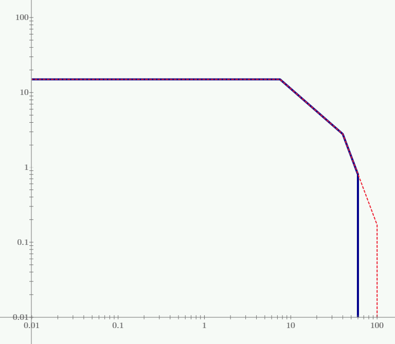

you don't need a linear scale.What I'm wondering now is how to use this to make this curve with a linear scale from that log/log scale...
Read David Eather.
Read David Eather.
I'm just thinking about plotting the protection locus against the soa curves. This still needs to be calculated. We had this started several weeks ago and then I got sick and was out of it for some time. I will get back into this soon and I was going to plot this and make an excel sheet that would easily recalculate the protections if we change the rails or other things.
One thing that could be done is to use those newer modern 3055s (MJ15015/16). And with their Vce0 at 120V, we can pump this amp up quite a bit.
Several scenarios can be examined, for whoever wants to make the amp: using all old 3055s, using the newer ones, using the MJs, etc...
Having the complex calculations all worked out properly in an excel sheet would allow any diyer to make any version of that amp as needed.
Yes, Bensen did that from Eather's article.
Anything that can be shared?
Where can we see this?

You do if you want to display the normal elliptical load lines, as shown in most literature on this e.g. Bob Cordell's book Fig 15.4, 15.7, and especially if you are trying to fit a VI limiter to the SOA curve.
Must have missed this. Where did Bensen display a protection locus (ie VI limiter) against the SOA curve?
I know what you have pointed out.You KNOW it doesn't move. Look at the SOA curves for the TIP41/A/B/C....................
That different versions of the SAME device produced by the SAME process has an SOA Vce knee that does not move with changing Vce0 rating.
But that is not what is being discussed.
The discussion is whether DIFFERENT 2n3055 from DIFFERENT manufacturers likely to be produced with DIFFERENT processes could have similar or same power capability that varies with rated Pmax and with rated Vce0.
I suspect the power rating has a small effect, that the Vce0 rating has almost no effect and that the Knee Vce+Slope determines the power capability of an amplifier using the generic 2n3055 device.

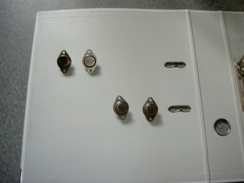

me read so good performance to 2N 3055 and répear me old ampli stéréo to 2N 3055 for upgrad to 2N 3773 appaired !
the old amplificator to kit " Cogekit 2040 "
very good build to little power ( env. 15 W to only 34 V )
