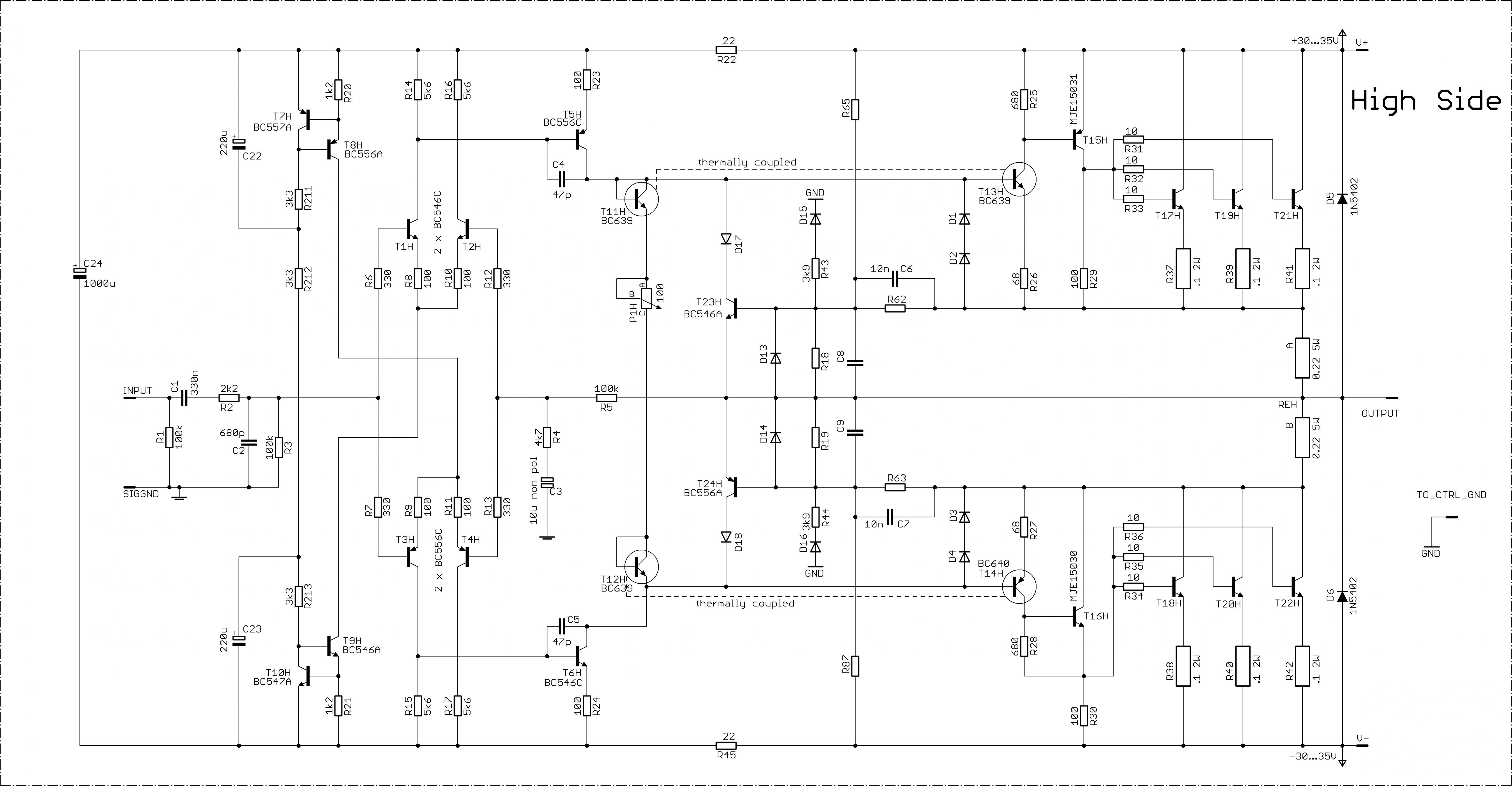

Amplifier based on 2N3055
.............For now, there is one criteria at least that I'm looking at, which is it must not be acting on valid signals. .........
That probably requires protection transistor Vbe peak to be <<400mVpk.
Maybe 300mVpk would be a sensible limiting Vbe voltage for passing all valid audio signals.
I note that a sch showed ~385Vbe in quiescent mode. To me, this seems far too high.
Some measure of early triggering (due to excessive heat) can be achieved by coupling the protection transistor/s to some "hot" part of the amplifier.
This will reduce the permitted Vbepeak even lower to allow a valid signal to pass.
I would set it for 7A into a short circuit and 25A peak at (theroretically) zero Vce.
How de we make the distinction between the short current and the valid signal current?
Assuming near zero Vce at near clipping and low psu sagging, we should be somewhere around 32V peak on the output, so that's about 16A peak for valid current, and we're not even talking about transients and reactive load. If we limit at 7A, we're surely within the valid signal area. Now 25A peak seems more in line with valid signals, but how do we make that distinction? The separate R18/19 and R43/44?
That would be 75W each device at zero crossing (inductive).
I get the 75W number (the 7A / 3 devices times the Vce peak). On inductive? You mean when we assume a phase shift of 45, or 90?

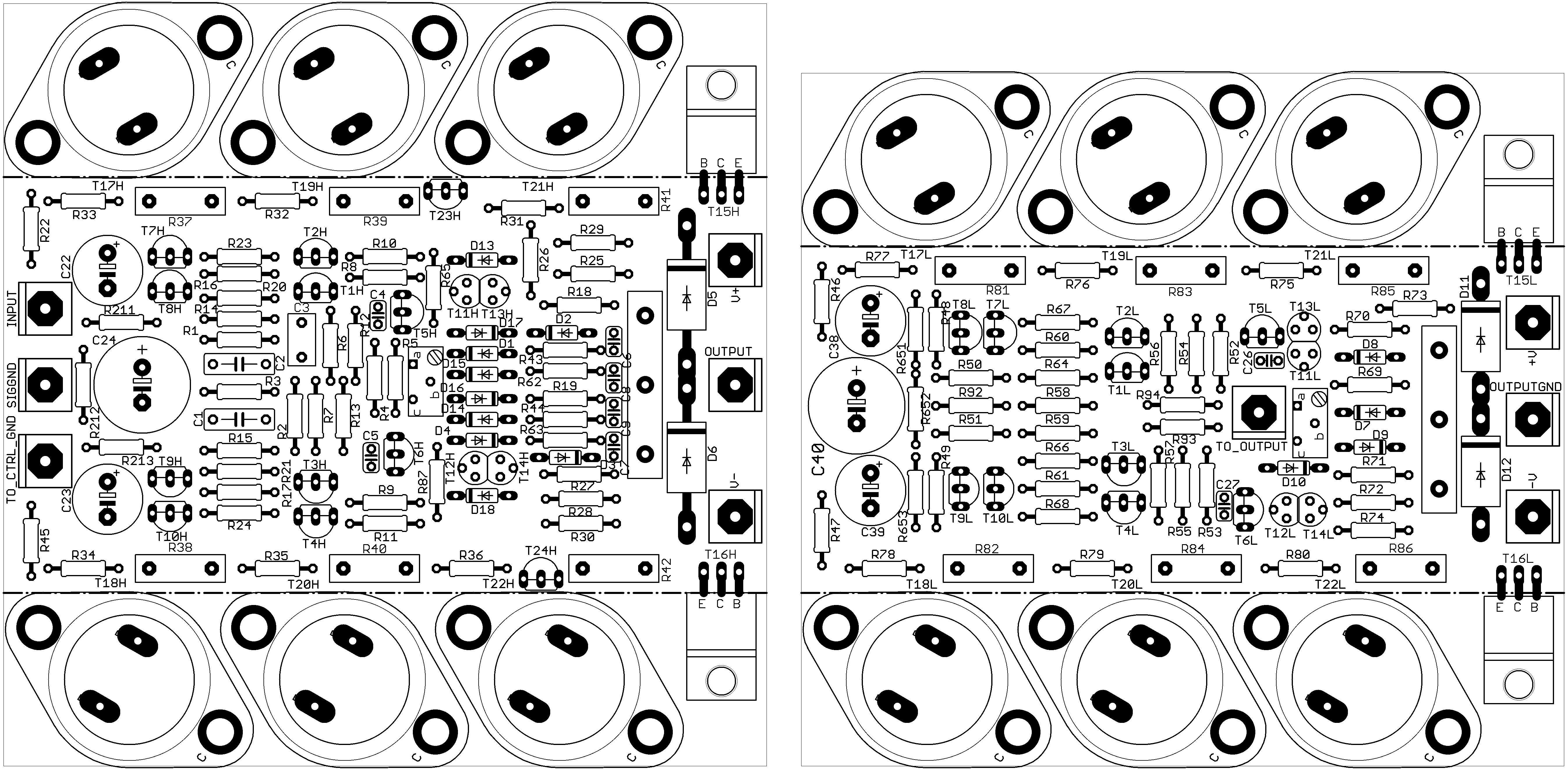

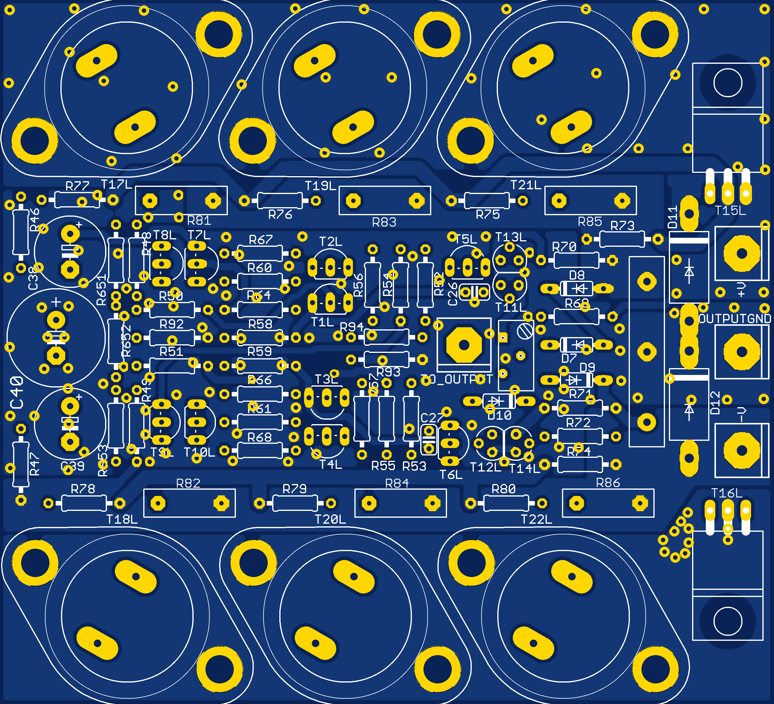

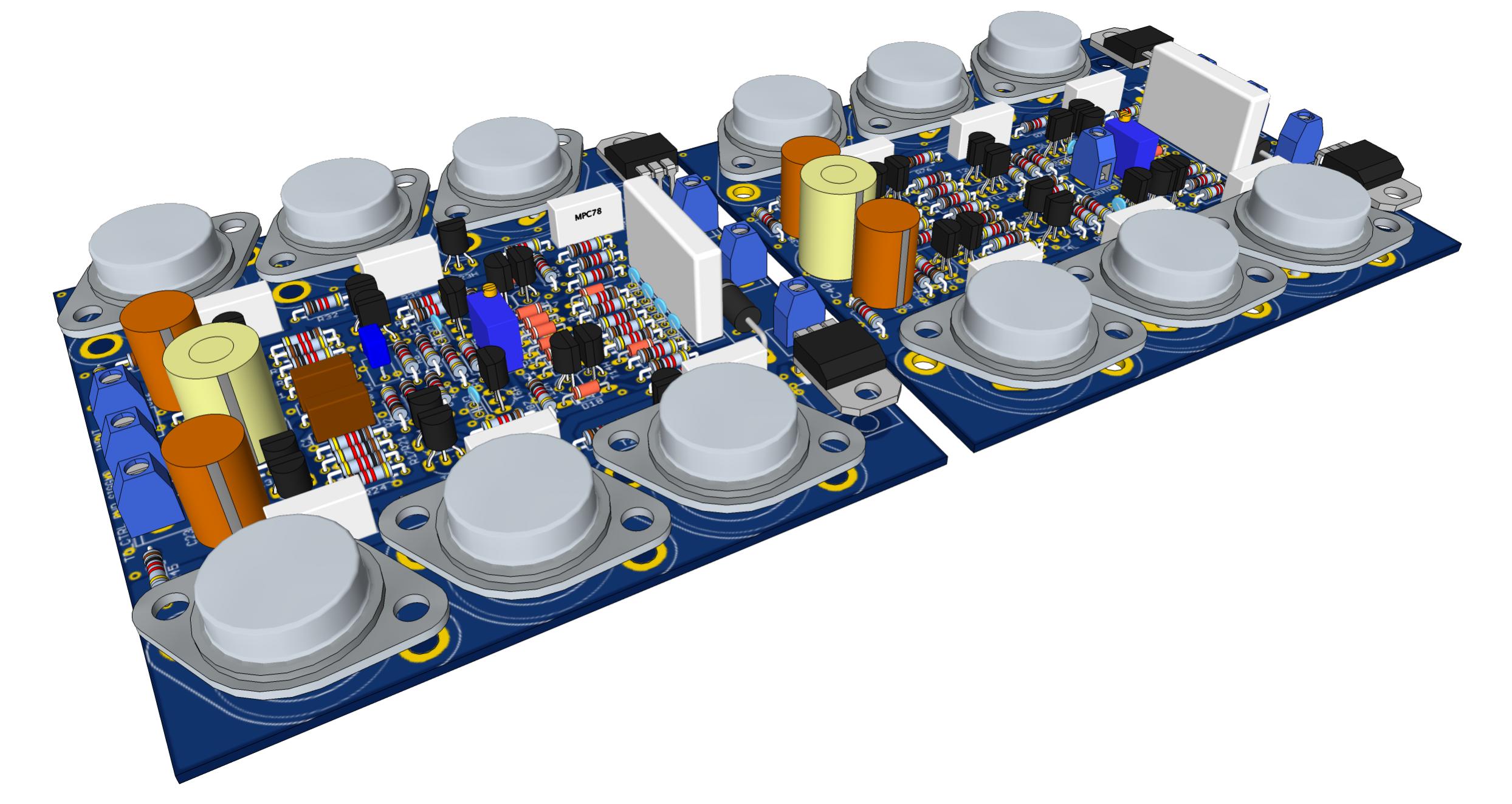

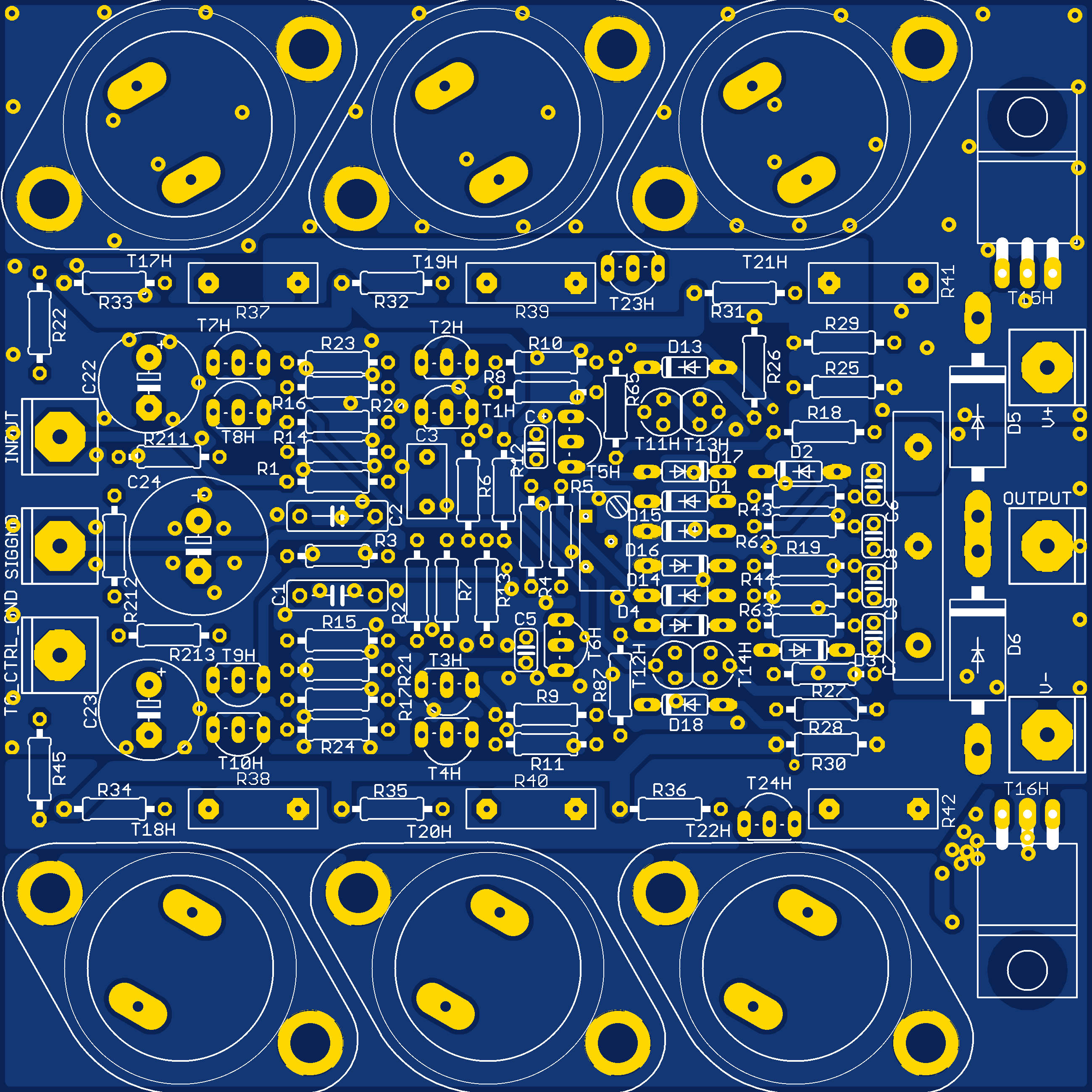

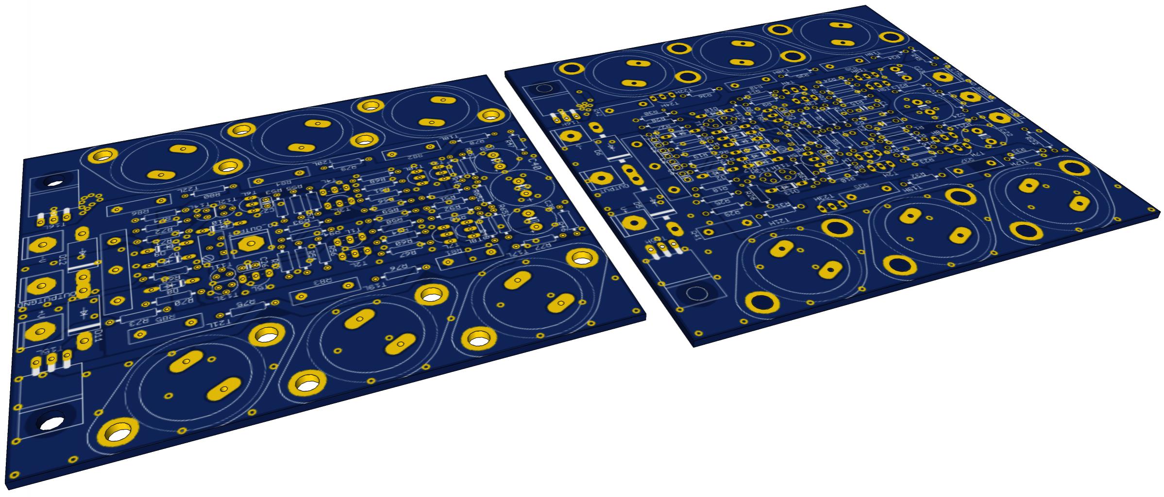

In the mean time, I reworked the pcbs to include those protections. We'll calculate those protection values now.
Here are some views of the latest boards. I had to add 10mm in width to the high side so the extra parts could fit. It's still rather tight and I arranged to put the protection transistors flat against the heatsinks.
There are possibilities for heatsinks.
One is with corner profiles of 40x40mm. Those could be reversed and pointing in the other direction. The profiles used could possibly be 30x30mm, but then the TO3s would be quite tight and may bump against the inside angle. Or the 30x30 pointing down could work.
One other is with U shaped profiles, 30x30mm works well. That way both sides can be mounted on the same heatsink.

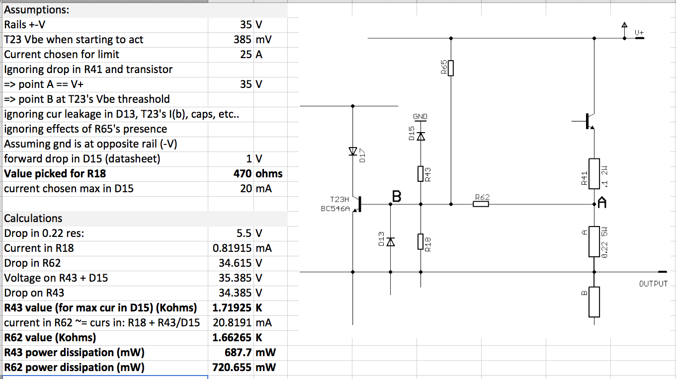

Anyway, I'm attaching that spreadsheet and a screenshot of it. I'm sure we can find all kinds of things wrong there, but it's a start. I put a partial schematic with A and B points marked and removed some parts to simplify it, to make the discussion easier.
I made assumptions, all listed first, mostly to simplify calculations and avoid including tiny amounts that don't have a real impact, such as the leakage current in D13 for example.
One thing that bothers me is the dissipation in R62, because I've never seen any amps using anything bigger there than about a 1/2W, so I must be wrong somewhere.
I chose a value for R18 that causes all the currents to be lower, to keep the current in D15 reasonable (I picked 20mA) and the dissipation in R43. Am I wrong somewhere?

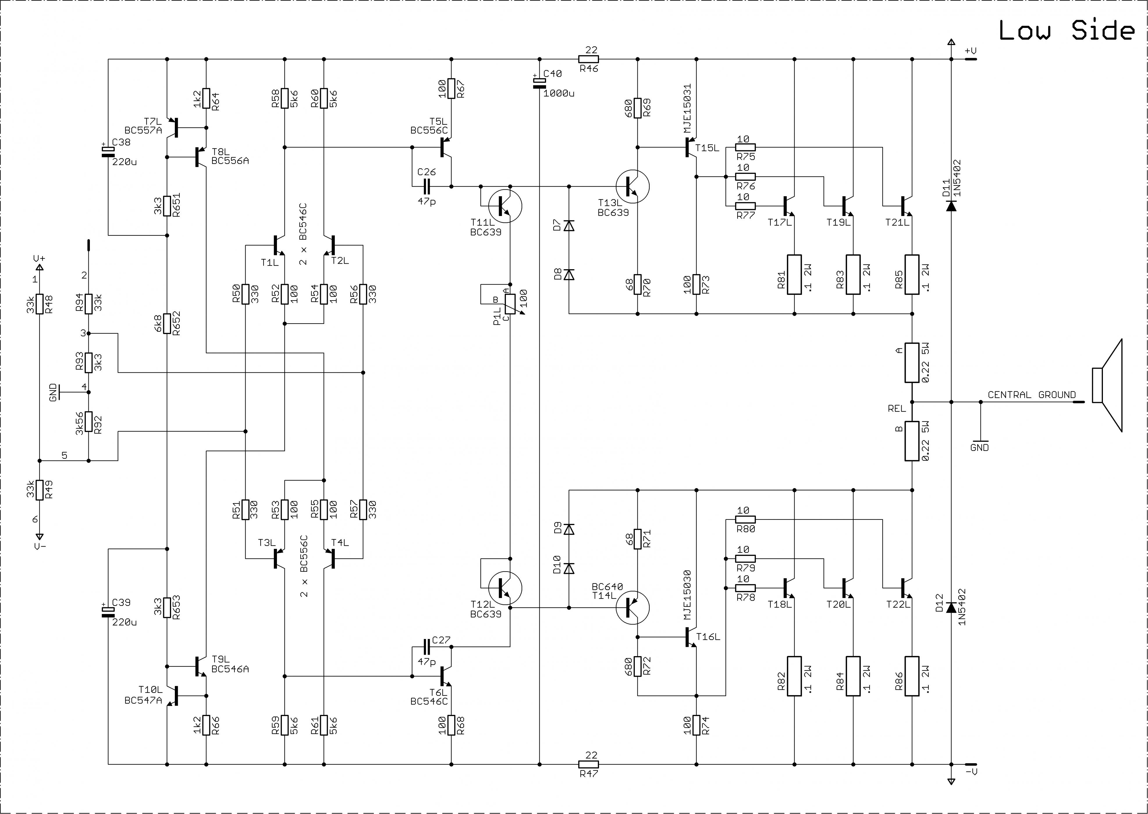

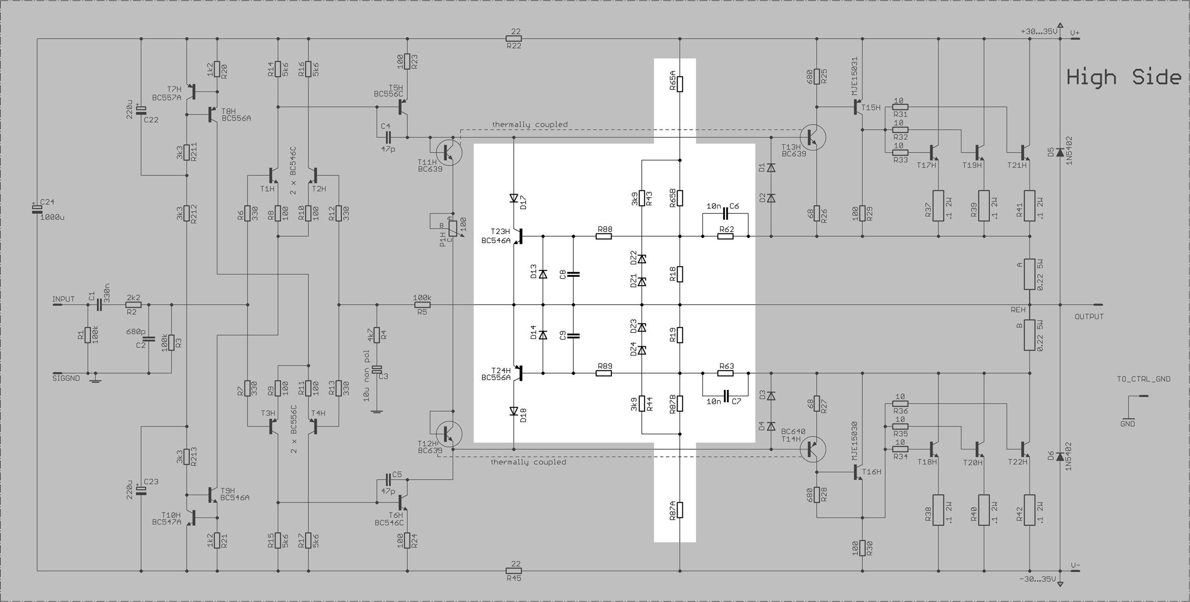

After reading with great interest the paper from Michael Kiwanukas at this thread:
http://www.diyaudio.com/forums/solid-state/235841-michael-kiwanukas-soa-paper.html
And not having yet understood properly how to calculate all the values in the current protection scheme in place. I'm trying a slightly different solution proposed in his paper. One of the possibilities was very close to what I already have put in place, but leaving out the resistors on the protection transistor's base/emitters, so I figured I would look into the closest proposition but one that doesn't have a link straight to ground.
The protections as I put them in place lately, have those diode/resistors in series that link to ground, and I figured since we're in a grounded bridge situation with those rails constantly flying, it might be a good idea to avoid that reference to that always moving ground (from the point of view of the rails).
So I'm trying something a tiny bit different and adding the suggested resistor in series with the bases on the protection transistors.
I'm attaching that altered schematic now. With the non shaded area being the only part in question now. Don't pay attention to that value for R43/44, since I only move the resistors' symbols instead of deleting them and making new ones.
Everything needs to be calculated and I started making up a spreadsheet for this.
With some help, we should be able to have something workable.
This scheme is slightly different from the previous one (from Leach, plus the resistors going to rails), but not really too different.
This dual slope scheme, if properly calculated, should keep it safe while making as much as possible of the soa available, within limits.
For such a low rails amp, this may even be more than it needs. But this one is aimed at being driven hard, so better plan for that.
A fully reactive load on each side seeing a 2ohms load, should cause a serious amount of strain.
If we can end up with a bridge that provides in the order of nearly 400W on 4ohms, we've got a serious amp that can drive a big sub already.
More can later be done by swapping the 3055s for 3773s and double the rails (or a tad more).
Either limitier can be made to work. If you're more comfortable using published equations, use one for which you do. In the original scheme, the resistor that goes to ground with the diode in series just sees 2x the voltage swing you would normally expect (since the "ground" is moving away at the same rate as the speaker out is moving up the rail).
This is one of the reasons you really need to have an understanding of what's going on - so that you can have confidence in what you're doing if you have to change something and don't have canned equations to work from.
Sure, but since I have troubles figuring out the calculations properly, then I might as well use one with a more in depth example.
That's the whole idea. And even with his extensive explanations, he left out a few intermediate results, which for the math buffs is no problem figuring out, but for the less math inclined, this can turn out to be a little more difficult.
The part that I'm having trouble with, shouldn't be a problem, but it is due to my lack of math mastery, especially the part where we have to do substitutions to solve more than one equation simultaneously
That much I figured, and I was taking this into account in my attempts at calculations. So I was not too far off in my assumptions and reasoning, however beyond that, the maths need to be applied properly and that's where I need an extra push.
Absolutely!!! Agreed!
And that's why I'm not going blindly with ready made calculations. I was trying to understand how it's done in other spreadsheets, so I could also make one myself and make sure I got it right.
