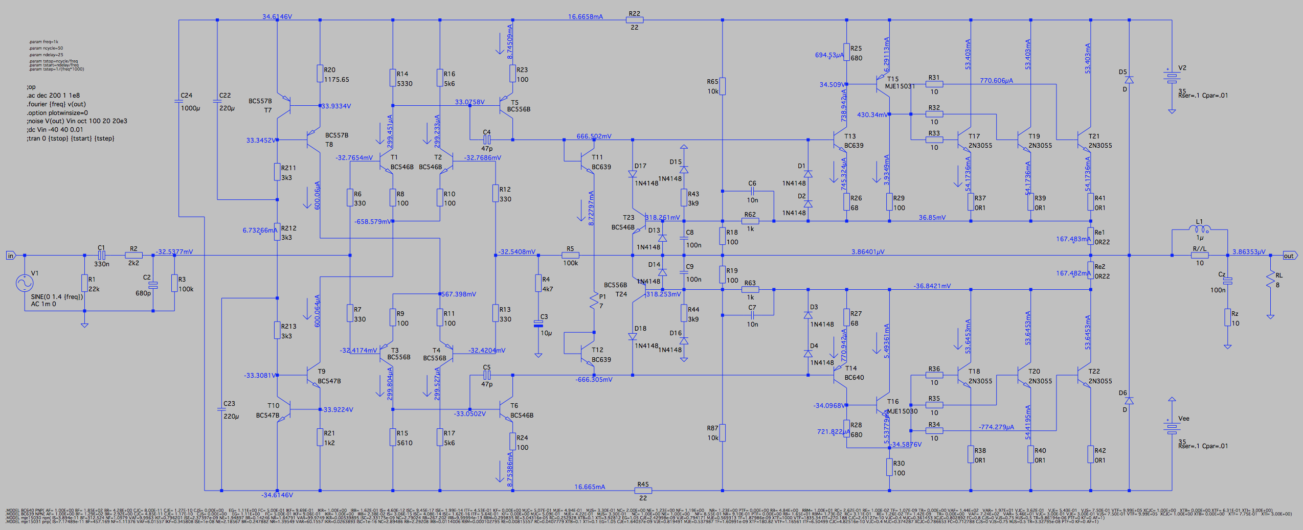

Put R38, 40, 42 in the emitters not the collectors - that will probably better balance the drive Ic's.
Yes! My mistake! The schematics are ok to make the pcb but this sim was done wrong. I corrected this in my last post. And I also updated the eagle schematics for both sides with the latest.
Changing the BC547s for BC639s in the bias stack definitely is better. And now that I also changed this in eagle, the even route better with less crossings.
I changed the Bs into Cs for the diff amps and T5/6, although I don't have the models for the higher hfe in the sims, using those in the actual build should be better, isn't it?
I also figured T8/9 might be better with higher Vce0 types, and T7/10 really don't need much there, as they never see their Vce going very high anyway.
Would using lower noise types be better on the current sources? The BC550/560 have too low Vce0 for the diff amps...
Here it is, with some tweaking done on R20 so the tails are much closer to each other. It's very difficult to go further, as now we're dealing with 100s of an ohms at a time and it jumps fast.
I think I got them close enough, since after tweaking R14/15 some more, they got even closer and the output offset is now below 4uV. I think going further is futile.
This closer symmetry allows looking closer at those much larger differences on the drivers, but after looking at this closer, I saw that we're looking at too different current paths, so I added a few more currents to compare better. The first difference, which isn't huge, but that will impact the difference on those drivers, is the currents in R25/28. Roughly 30uA of difference, times some beta, can make some difference on those drivers. Which may explain at least some, if not most of the difference in their emitter currents. It's tight for space there, but the 2 currents to compare would be their collectors.
The thing is, we have both drivers seeing that voltage drop on R25/28, but we must have a slight difference because on T16 we have that R30 collecting both emitter and R28's currents (and the output's bases), as opposed to R25 on top going straight to rail. This difference I suppose we can't avoid because we are quasi complementary and there is no other way.
I'm sure if I changed the - rails trannies to MJ2955s and re-wired for complementary topo, then we might have a much closer match.
This could be an other version of the amp. With only slight difference.
It's rather close now anyway. Look at the bias currents in those outputs. Not so bad.

If you really want to see what kind of difference in bias current to expect, try unique models for all 6 outputs, either varying temp by 25 degrees between them or Is by a factor of 2. Randomly, of course.
This would make for a simulation closer to the real world. However what would interest me right now is a single frequency sim and take a look at the crossover point. I've been experimenting but haven't figured out yet how to get the single frequency instead of a sweep.
But an other sim shows a freq response that would be something like around 6hz to more than 100khz at -3db, if this is correct. That wouldn't be too bad.
I haven't looked at distortion yet, and the noise analysis didn't speak to me, I don't know how to interpret it and what to look for exactly.
I was just experimenting with a transient sim, but all I got was a good looking sine wave with no clipping at 30V peak. So I must not be doing things right.
I don't know the commands, I'm discovering them now.

We're working on protection right now, but I don't know what would happen in case of an output failure, probably the same as any other push/pull.
But this is more than a simple bridge, it's a grounded one, and I don't know of any 3055s having been used in this way, so we're probably pioneering that. This makes it quite interesting to me.
Plus to see what we'll be able to get out of those old 3055s will be great. I think we can make quite a decent little amp, considering the use of old junk, and when we can get a bunch of watts out of it, with only 35V rails, this was not common back in the glory days of the 3055s.
And although 35V is kind of at or a little beyond the 3055's limit, at least we're not throwing it +-50V and calling it a 150W/8ohms amp.

Here are some questions that I'm asking myself while reasoning on some aspects:
Thinking about the input diffs first, their Vce0 exposure. One end, the collector (of any one of the diff amp's tr) is around a couple of volts below the rail where it is near, depending on which side we're looking at. And this won't vary very much apparenty. And the other end, the emitter, can only vary around the ground level in plus or minus the peak level of the input signal.
Am I on track so far?
So basically a diff stage transistor will only see at the maximum roughly half of the rail to rail voltage.
That's in a "classic" setup with the ground nicely in the middle and not moving.
Now let's think about this grounded bridge situation. The signal ground will follow the main ground regardless, so we can basically assume for the reasoning that it's at the same level. Now when the ground is being pulled around by the low side towards each rail back and forth, that ground level moving changes what Vce the diff stages can be exposed to.
This makes me think that since the ground gets pushed close to each rail back and forth, then the diff stages' transistors are seeing nearly the whold shebang and not just half.
Now tell me where my reasoning goes wrong, but that doesn't jive with what crown explain about the advantages of the grounded bridge, in that it reduces what transistors see of the rails, so their needs for handling high Vce would be reduced. Where I am going wrong in that reasoning?

Too bad. I'd like to see that SOA data.
Maybe for a power supply it would excel.
It's rated at 350W SOA at 20V.
The 40V figure may be a misprint. The 2N6277 is about 40W at 40V, so the BUX20 might be 60W at 40V?
Switching transistors have poor SOA for linear use, that's just the way it was.
http://pdf1.alldatasheet.com/datasheet-pdf/view/82712/SEME-LAB/BUX20.html
The I S/b line.
The I S/b line.
BUX20 pdf, BUX20 description, BUX20 datasheets, BUX20 view ::: ALLDATASHEET :::
The I S/b line.
That's one of the 2 datasheets that I have on that one and besides the numbers on the second breakdown, I don't see any soa info.
I am trying to put together a spreadsheet to easily calculate the protections.
I'm having trouble figuring out how to proceed with the soa info.
For now, there is one criteria at least that I'm looking at, which is it must not be acting on valid signals. So since the bridge is destined to be loaded with 4 ohms, I am thinking about the peak output current that can be encountered. In the case of the 4ohms load, each side sees 2ohms, so I figured if the rails don't sag too much and we account for some losses in the Vcesat and emitter and other resistors, I'm just taking a rough figure of 32V peak on the output, which probably can never be reached unless the psu doesn't sag at all. On 2ohms, we're at 16Amps total already. The resistors to sense that current on are 0.22ohms, so here we are with a 3.52V drop to use to trigger the protections, a threshold under which we don't want to activate.
I can calculate the R18/19 and R62/63 to use this threshold, but then what to make of the R43/44?
And finally, there is the matter of R65/87 as well.
If I get this right, the R43/44 cause a knee in the protection locus and R65/87 add a second one.
Those calculations need to be done right, no room for guessing.
The diff pairs do get to see more voltage in the grounded bridge setup. But small signal transistors have no problem handling normal power at high Vce. Power transistors have second breakdown limitations, so they basically can't handle squat at or anywhere near rated Vceo. The higher the fT, the worse this is.
The Crown Macrotechs do not use diff pairs. They use op amps in the input stage, so the topology avoids high voltages in the front ends. With a 60 or 70V supply, MPSA06/56 are useable, as are 2N5401/5551. Lower rated devices (like the BC's) could be selected based on actual Icbo.
We're planning on the BC546/556 right now, with their Vce0 at 65V, we're not far from the max, although their Vcb0 is 80V... Those have been used in the leach amp by many, with rails at 58-60V I think, and nobody reported any failures.
I just measured again that dual 24V secondary transformer that I'm reserving for this amp. The unloaded voltage was 26.3V, and it's only a 160VA, which won't allow the max power on 4ohms loaded bridge, but should get fairly close to max power on 8ohms though. Once hooked up the the rest of the psu, that unloaded voltage may already sag a little bit before being actually loaded by a functioning amp. But regardless, I guess my rails might be close to 37V or slightly less at idle.
I'm sure the rails will sag quite a bit with increasing load, especially with an underpowered transformer. And at full power I expect the rails to fall below 35V for sure.
The option of using the mpsa06/56 or 2n5401/5551 is quite feasible for me, since I do have a bunch of those in stock as well. I even have tons of the mpsa92 but not the 42 right now. Situation that I will correct later, because I plan to use those for a leach amp. I don't even have any bc546/556 at all. I do have loads of bc547, but only few 557 (I just checked, I have 178 bc547, but only 3 557 left). So obviously to build this amp I will have to use other types at the time.
I would set it for 7A into a short circuit and 25A peak at (theroretically) zero Vce. That would be 75W each device at zero crossing (inductive) and 85W max dissipation (half way up the rail resistive). With 32V rails (64V total for the bridge). 3055's at reasonable temps can handle that for 25ms pulses (20 Hz bass, half cycle).
To calculate R43/44, just use KCL with the Vout set equal to the rail. The voltage drop across R62 must be the difference between the voltage across the emitter resistor and the Vbe of the protection transistor. When the limit current at "zero" vce is reached of course. Calculate the current required to get that, and you get a value for R43.
