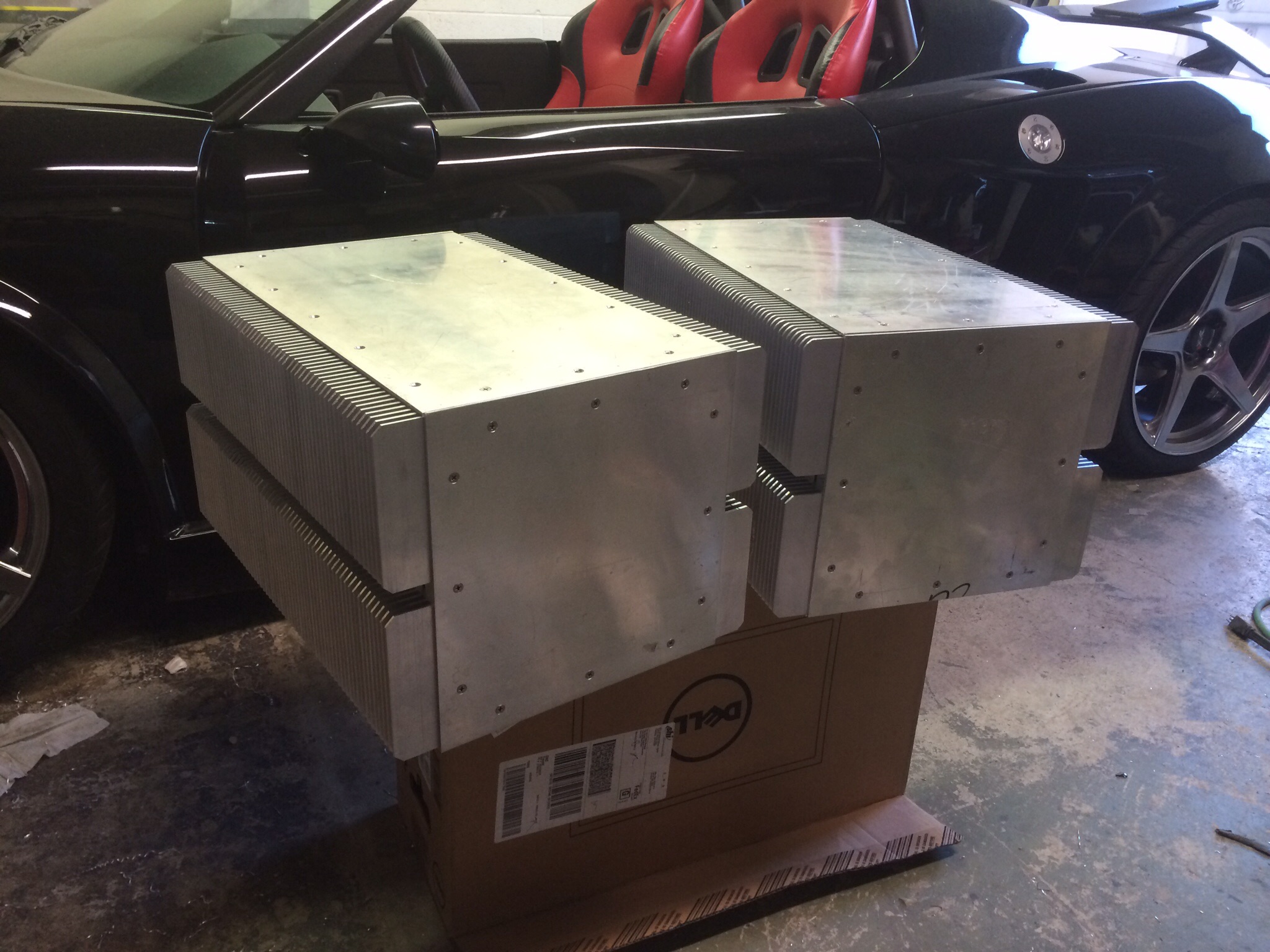

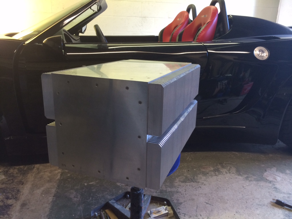

I would not make one big sink out of the two smaller one's. The heatsinking ability does not double if the heatsink is double the height, because the heatsources on the upper sink raise the temp of the lower sink and vice versa. I contemplated cutting my 10" heatsinks in half, because doing so would actually double the heat carrying capacity of a 5". Making them twice as tall, but connected, increases the capacity on the order of the square root of the difference.... eg 5" -> 10" gives you the heat carrying capacity of about 1.4 x 5", ( some say 1.6). Keeping them separate, actually gives you double.
Thanks for sharing! I remember that discussion. Besides increasing the performance of my sinks the final look of each monoblock will appear to be two units stacked. Having the 3/4" gap between aids in both those goals.
The first monoblock chassis is now mostly complete. I used some regular steel screws for assembly, then switched to all stainless steel hardware now that I'm past the mock up stage.
I tapped the 1/8" angle for ease of assembly during the build, then when complete I will add a washer and nut to each location on the bottom and sides, due to the weight for security. The top should be ok for easy access later.

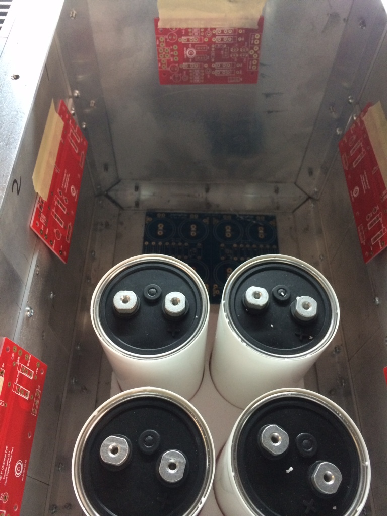

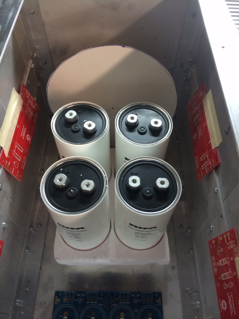

The chassis is a little tight inside, but adequate I think. FYI, inside dims are 19 1/4" (489 mm) deep, 10 3/4" (273 mm) tall, and 10 1/4" (260 mm) wide.
The second monoblock is getting close to the same stage. I'm waiting for the transformers to arrive before I start making any penetrations.
The second monoblock chassis is now assembled too! Started playing around a little more with the board layout. Will probably start installing them, then work onto the cutouts. The transformer hasn't arrived yet, I'm a little anxious about cutting anything till I see how everything actually fits together.
Really nice power plant you have there ... will be awesome if you can find someone to anodize all this aluminum ... Anyway, awesome ...
So far I haven't been able to find someone to anodize. Due to being an island it's hard for businesses with caustic waste to operate here. When complete, the only aluminum showing will be the heatsinks. I'm hoping that by splitting the sinks and injecting some air between them, I can overcome some of the benefit lost by not being anodized.
