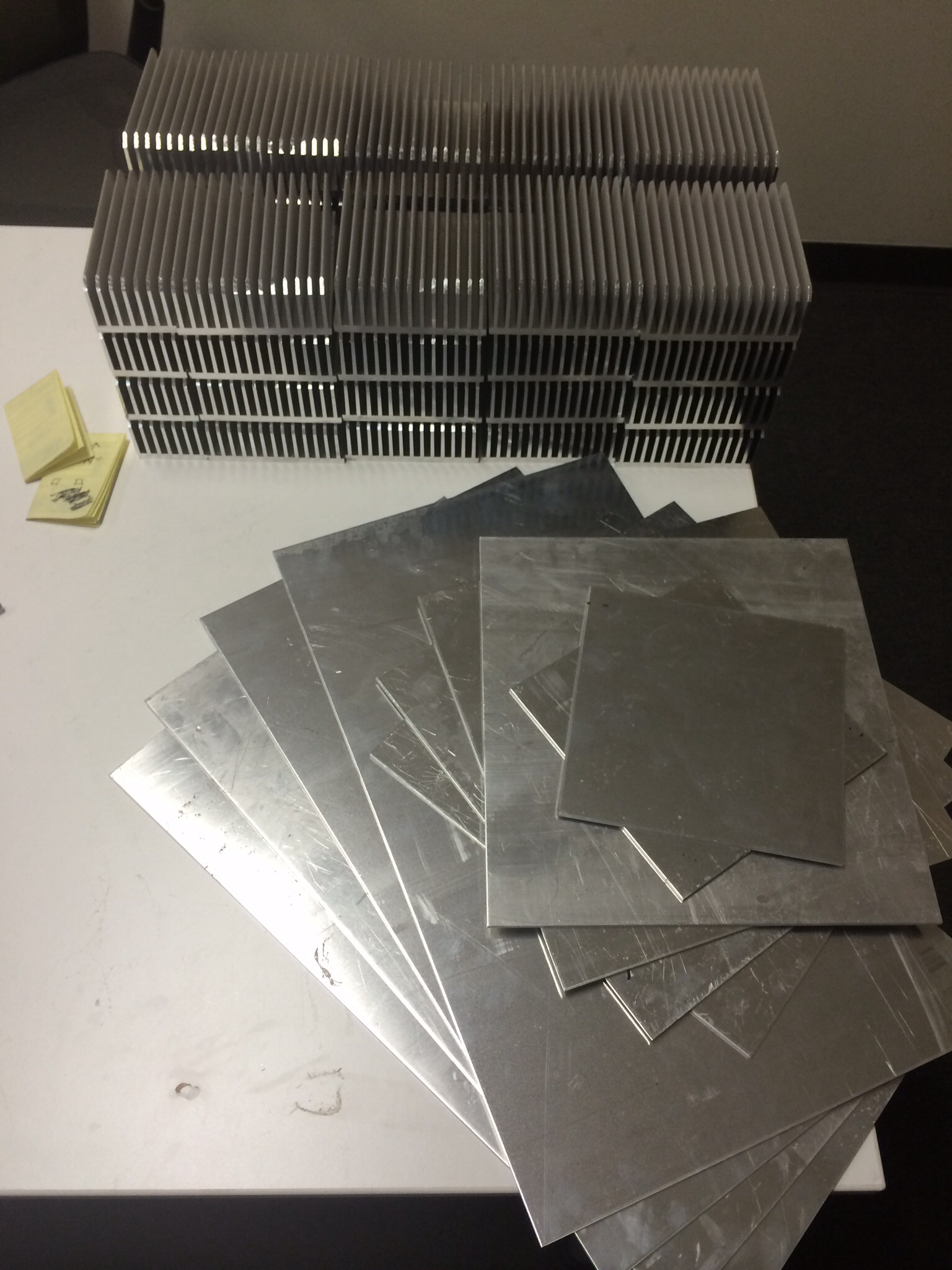

I'm putting together my order at McMaster for all the fasteners to put the chassis together. Trying to get as much as I can on this order. What is the recommended size fastener for the chips to the heatsinks? In your build guide you have a hex headed bolt and a washer. Is it best to use the Keratherm pads from the DIY store?You're coming along nicely... What else is still on the shopping list?
Thanks in advance
Using a deluxe chassis from the diyAudio store?
Mounting hardware -
M3x5mm (PCB to standoff)
M3x10mm (Mosfet-heatsink)
M3 standoffs, 5mm thread depth (PCB-heatsink)
Fender washers (For mosfet)
( I don't know what exactly the screws are for the IEC, it's more a function of the actual piece you use, but likely countersunk M2 or M3)
Yes, use the Keratherm pads from the store.

But no, I'm not using the DIY chassis. That would be too easy
I'm building my own. I just received my aluminum flat stock pieces for the top and bottom, front and back, and platform for the large dia caps.
Now a few hours of drilling and taping ahead of me

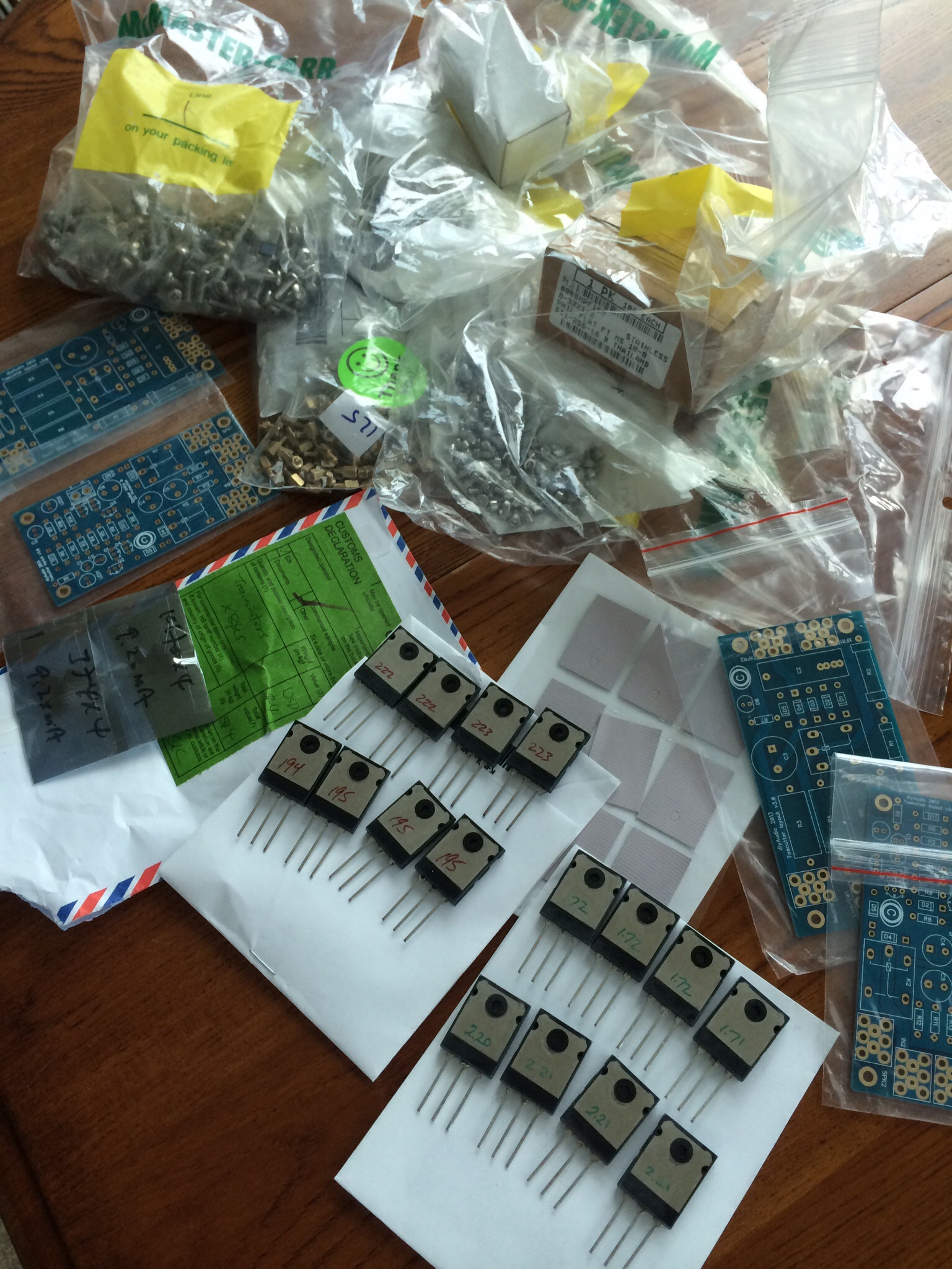

More parts have arrived, fasteners from McMaster, Toshiba K170 and J74 Jfets from Spencer, Toshiba 2SJ201/2SK1530 Mosfets from Tech-DIY, Keratherm insulators, and speaker and soft start boards from DIY store;
The mosfets from Tech-DIY were ordered matched. This is how they are marked;
K1530
1.72, 172, 1.72, 171, 2.20, 2.21, 2.21, 2.21
J210
222, 222, 223, 223, 194, 195, 195, 195
Are these number close enough for this build?

The Mosfet are completely and overkilly well matched. You have 2 sets of 4 per channel.
There is no reason to match N to P, so don't worry about it at all.
The rest of the parts are available form Mouser or Digi-Key, in stock an ready to ship Monday morning.

DO NOT install the soft-start and/or DC protection board until the amp is completely operative, tested and burnt-in. Use the CL-50 or -60 for inrush protection in the meantime.

I'm assuming your comments about the soft-start and speaker protection implementation are referencing to independently verify the operation of each system of the amp prior to integration to minimize troubleshooting? Or other?
Buying straight from the published F5 Turbo BOM would be too easy
But strongly suggested.
Yes. Build the amp. Get it working. Build the soft start, install, get working properly, build DC board, get operative, install.
Andrew thanks. Please continue to comment as I progress and learn!I suggest you use the mains bulb tester for all power ups until all modifications are complete.
The bulb tester also operates as a soft start due to the cold filament resistance.
