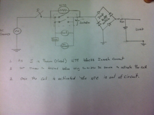

Ametherm also sent this sketch;

Coast,
I can't read all your notes.
At least two are wrong.
You said "As S is thrown (closed) NTC blocks Inrush current".
No, it does not.
The NTC is an added resistance in the primary circuit. The total primary circuit resistance limits the start up current. It is NOT "blocked".
Then "Once the coil is activated the NTC is out of circuit.".
No. Once the contacts close the NTC is effectively out of circuit.
After coil current starting to flow, there is a time delay until the contacts close and stay closed.

Andrew thanks for the reply. The sketch and notes are from Ametherm, FYI.
I'm assuming that you are further defining the statements, i.e. "Blocked" vs "limits" and "out" vs "effectively out", as to the actual schematic your good with it?

I will comment on the circuit you posted as is. Please forgive me if these points are assumed or described elsewhere.
1) For safety reasons, mains AC voltage should first come to a fuse. A slow blow will be good.
2) The way it is drawn, when the relay closes not only is the NTC bypassed, but also the coils, which will drop out, and the relays will open again. You will get a nice chattering sound.
3) I am not sure what the bridge is supposed to do, but one thing it does is effectively short the negative half of the sine wave to ground...Not good.
4) No current will flow to the other side. Please explain what you are trying to do so we can offer a suggestion.

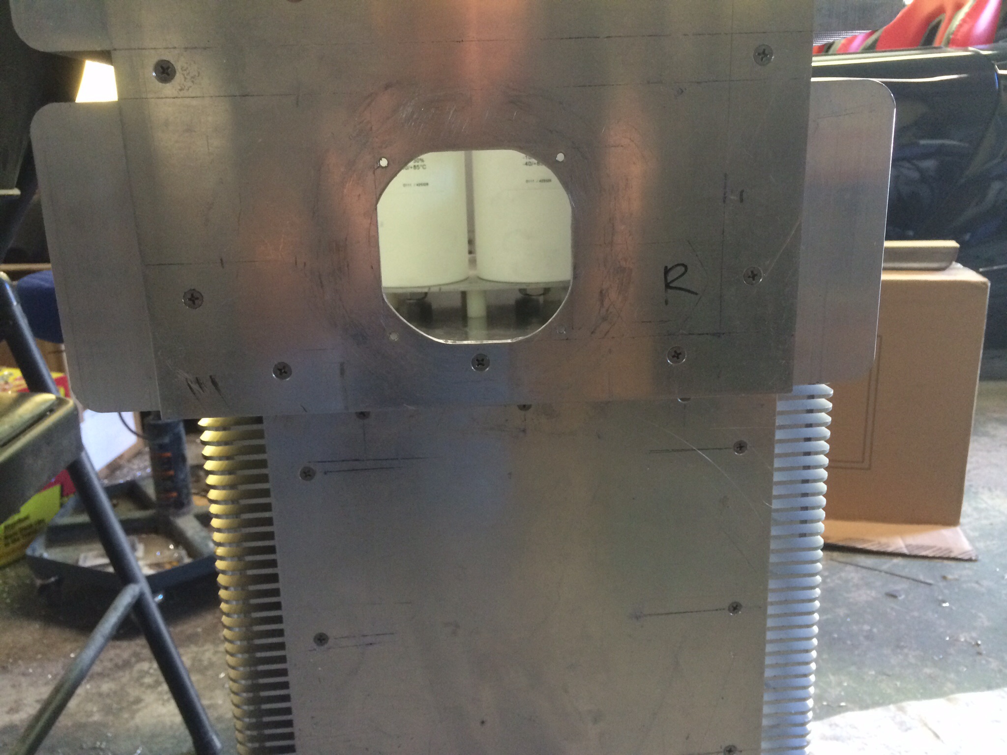

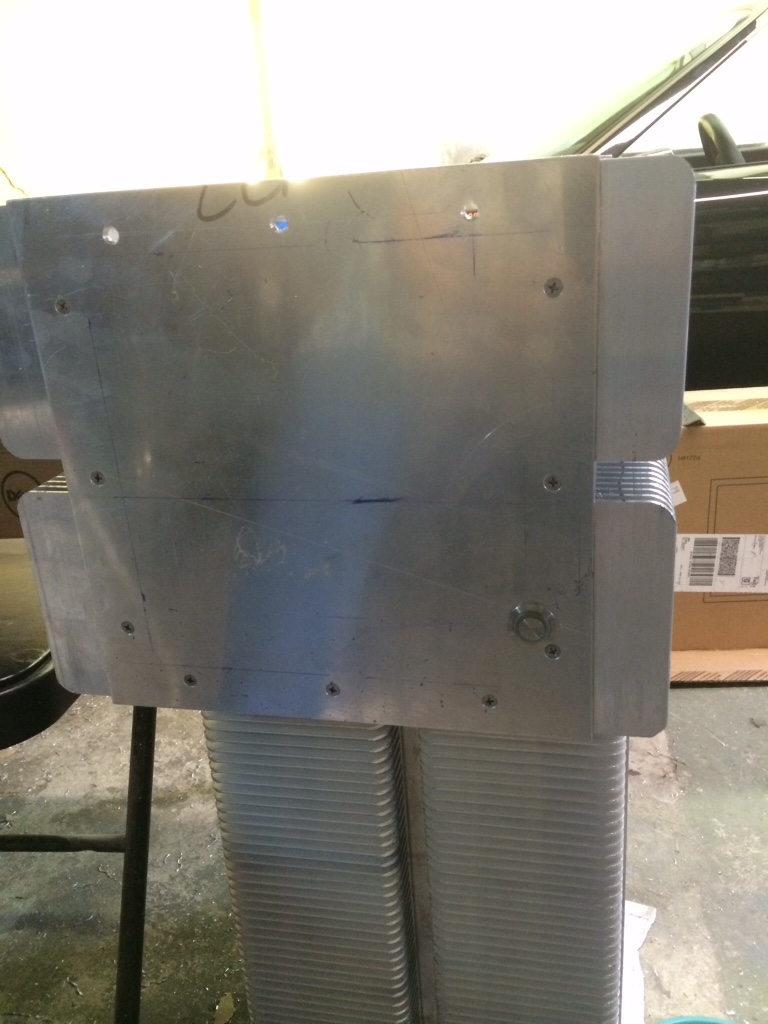

Chassis construction continues. My 80mm fans arrived yesterday so I cut those in.
I wanted rounded corners on my heatsinks, so I first ran them all through the table saw and cut away most of the corner. Then today I used a 1/2" carbide round over bit to finish the shape. Finish sanding still needs to be done.

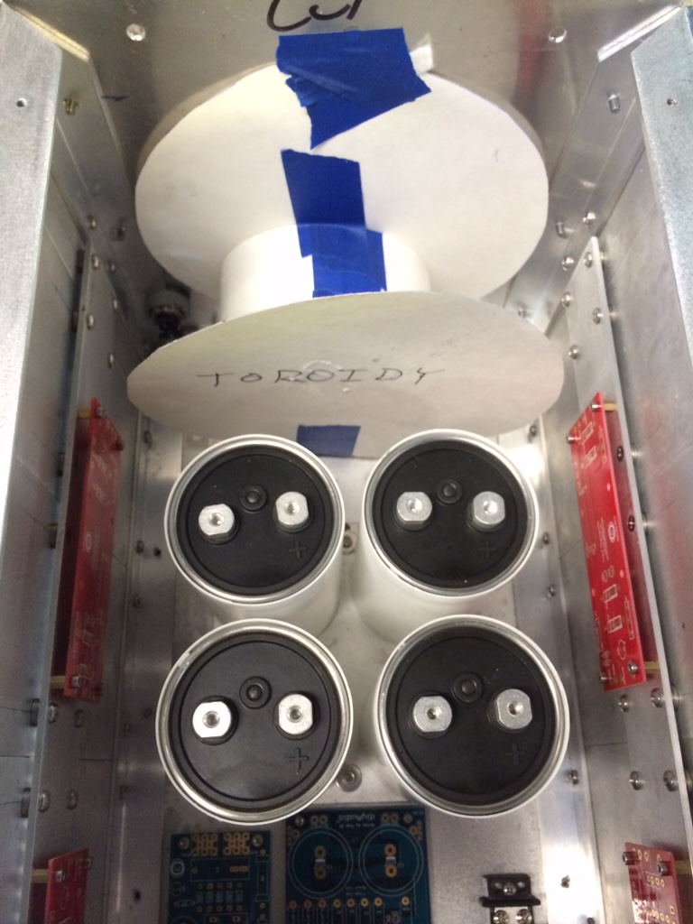

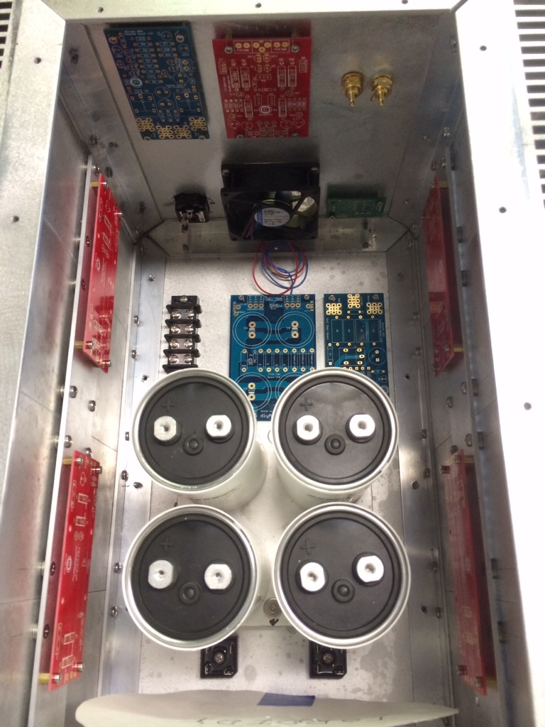

The large cap Rifa's have a bolt on the bottom that protrudes about 13mm. I didn't really want to have exposed nuts on the bottom of the chassis so I built a little platform for them to sit on. Probably keep them a little cooler also.
Don't forget to use these to isolate the stud of your caps from the chassis.

I didn't know that they needed to be isolated. Thanks for the info.Don't forget to use these to isolate the stud of your caps from the chassis.

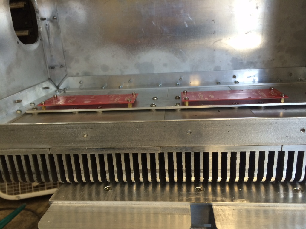

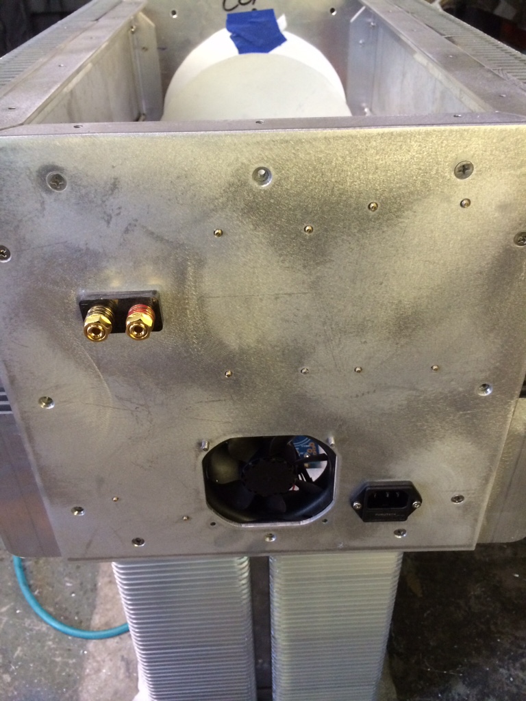

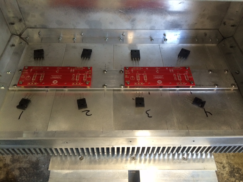

Received an email from Toroidy, their epoxy machine is under repair, so my transformers haven't shipped yet. So against my own advice I went ahead and started installing the boards, drilling all the penetrations.
I'm mounting the N and P channel boards to the 2" piece of aluminum that secures the middle of the upper and lower sinks. I countersunk the screws under the boards and used 3 washers to space the 2" strip away from the sinks for an air slot. The goal is that since this slot on each side is the only opening in the chassis that the air from the fan will inject cooler air between the sinks and at the same time cool the interior of the chassis.

So I made a paper transformer to confirm layout. Everything in the pictures are mounted to the chassis. All hardware is either brass or stainless steel. I forgot to bring the balanced inputs to the shop, so those are left to go, also I have left an area on the floor in front of the fan for a separate 12vdc power supply for control. Due to space I split the DIY power supply boards and will stack to make more room. I will have as part of the control circuit high temp cut off. I also plan to set a fan on temp switch to allow the sinks to heat up and stabilize quicker before the fans start.
Here is a rough layout of the Mosfet's and mur3020's, Mosfet's on bottom. The sinks are 5" tall so planning on tapping for the mounting screw 2" up from the bottoms and center side to side of each sink.
So what do I have right and wrong so far?
