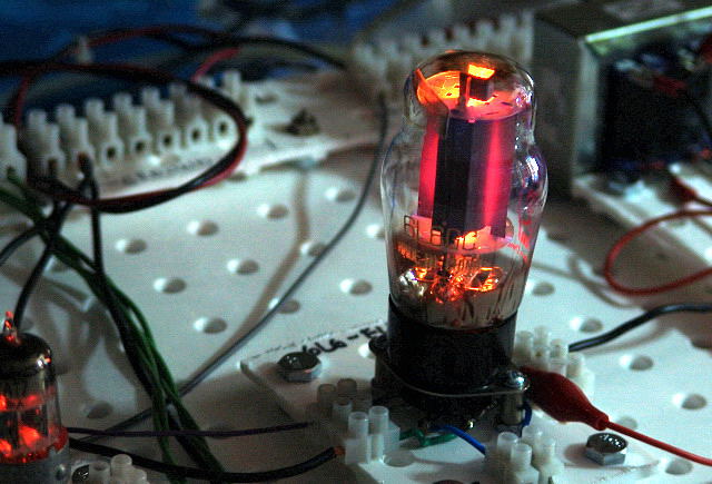

We are taunted with pictures of warp drives, there are even two flux capacitors in the picture. These are not capable of jumping to hyperspace.
I built the proper equipment for the job, and in my usual style, I set the controls for light speed, and made the jump. The voltage pot on the warp drive (power supply) has always been loose. I was exploring the upper limits (above 500 volts) of a very well used Chinese 6L6GC when the voltage pot broke. The voltmeter on my power supply slammed all the way to the right (it goes to 600 volts) and a serious fireworks display erupted inside the 6L6. I hit the kill switch, fast!
I disconnected the power supply form the test amp and fired it back up. The voltage knob has no effect, but the voltage range switch (selects transformer taps) still gives me 50 volt steps. The 250 volt range now gives me 470 volts, and the 300 volt range gives 520 volts.
I set my camera to record video and decided to plug the amp into the 480 volts and make video of the meltdown. There was none. That tube just won't die! I set the power supply to the next range. Still no fireworks.
What do I do now? I decided to find out how much power I could get out of a 6L6GC in UL mode. Given a limit of 5% distortion, but ignoring all tube specs and its cries for mercy, I sterted cranking things up. I was getting 23 watts at 5% distortion when I took this picture. For a 6L6GC this IS light speed! The power supply was no longer in regulation and I was getting about 490 volts under load and the current meter read 110 mA. The poor tube just kept going!

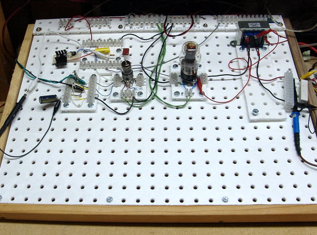

Now, back on earth......
I decided this morning to back up, clean all of the circuits off of the breadboard, and build a new test amp. The Tubelab (my breadboarding system) had two complete amplifiers still wired up on it and I had started on a third. I have about 10 different experiments that I want to do here, so I needed to start fresh. I documented the two amplifiers on the breadboard, and removed them.
The first step was to build a basic SE amplifier. I built an amp very similar to my SimpleSE, but used fixed bias in the output stage. I left plenty of room around both stages for experiments. I will experiment with different driver tubes with CCS and resistive loads. I plan to explore A2 operation using PowerDrive, and of course experiment with adjustable UL and G2 bias. I have a few other ideas that work in LTspice, but have to be proven in the real world. I also have a big box full of different mosfets to try out.
The basic amplifier was built and tested. I used an Edcor OPT for initial testing because it has UL taps, and I have plenty of test data on the SimpleSE amps using this transformer. This amp does indeed work like a SimpleSE. The included photo shows the basic amp. The screen grid is simply connected to the UL tap on the transformer for this testing.

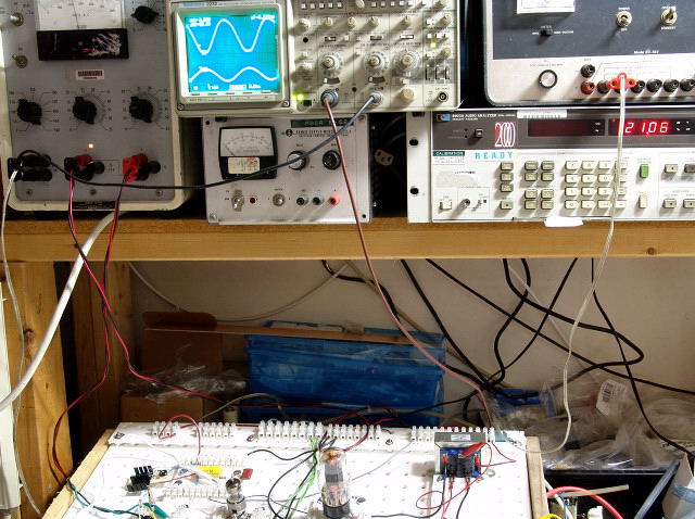

Here is a picture taken at almost full crank. The audio analyzer is set to display "watts into 8 ohms". I backed the current and drive level off until the tube was barely glowing. I was still getting 21 watts at 5%. The bottom scope trace is the 6L6 grid and the top is the amp output. I don't have the FFT hooked up yet.
Tomorrow I will perform an autopsy on the power supply since it doesn't work very well like it is. With no signal into this amp, I get 140 mV of 120 Hz at the output. This is messing up the distortion readings at low power levels.

The upper trace is plate current, the lower trace is screen current

If you look carefully at the glowing tube, you can make out "6L6GC" on the front of the tube. Just below that it says "Made in China". I pulled a pair of 6L6GC's out of a Fender Bandmaster when the customer wanted to try the new Sovteks. I have used that same pair of tubes for many life threatining experiments since then. This is one of those tubes. There are truly hard to kill! They show up on Ebay from time to time in the $3 to $5 range, and I have bought a few more just for experiments like these.

No, PS in its grammatical sense - postscript! "Turn it up until it explodes, then back off a little". The 6L6 won't oblige.
I judged the 6L6 purely by the bottle - only 6L6G's used to come like that. So the Chinese use the Coke-bottle enclosure also for the -GC! Not to again digress, only how does one know that is a 6L6GC? Firstly the direct mounting on thick pins in the base lets out a little heat compared to mounting on a tongue. I think I notice the latter in the photo (will check again). Then comparatively large cooling fins on g1 frame prongs needed, larger anode "fins", etc. I did not notice that either. Anyway, back to ...
Many of the new production tube suppliers have been known to use some loose interpretation of the tube numbering system.
In this case I had a friend with a Fender Bandmaster. He had gone through several sets of 6L6 type tubes, with some of them only lasting a few months. Several years ago Antique Electronics Supply was advertizing some Chinese "Coke Bottle" 6L6GC's. Their ad claimed "we could not blow up this tube no matter how hard we tried". I took this as a challenge, and ordered 4 of them. Two went into that Bandmaster where they lived for over a year. They were still alive when my friend wanted to try the Sovtek 6L6WXT which is also hard to kill.
I now know that these tubes were made by Shuguang and are not commonly sold in the US any more. They have been replaced by the 6L6GCR which is the same tube in round glass. The round glass must hold more heat because the new tubes are easier to glow red.
Both of these tube types have no problem operating at power levels that will melt an ordinary 6L6GB. I have run this same pair of tubes in a simpleSE amp for extended periods of time at 35 watts of plate dissipation. Are these true 6L6GC's, I don't know, but they act like it.

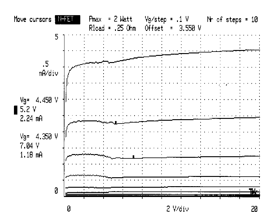

I also want to set up a switch for the MOSFET drain connection (screen current) to change between the B++ supply, the 50% primary tap, and the plate tap (+250V floating boost on these last two taps).

Lets just say they are closer to being a 6L6GC than some other tubes that are sold as 6L6GC's. The Electro Harmonix 6L6GC appears to be the same tube as the Sovtek 6L6WXT. The large rectangular plate structure doesn't look like any traditional 6L6GC that I have ever seen. I have used these in guitar amps because they will live in situations that fry some tubes. I have several of them, but have yet to spend some time listening to them in a HiFi amp.
After messing with it for most of the day, my Fluke 407D power supply is back on the bench, working. It turns out that the voltage range switch was broken. I glued it back together with 5 minute epoxy. There were some wires pinched between the voltage pot and the front panel. These were probably there since the unit was new. The loose pot finally cut through the insulation causing erratic operation and random 600+ volts of output. There were some burnt wires that were apparently damaged by someone tweaking the current meter shunt. Other than these issues the unit seems to work fine with all of the original capacitors. All of the tubes are IEC brand. These are either the originals, or the unit was re-tubed with the same brand of tubes.
The 6L6 got shocked with 600+ volts again, no sparks this time but it was glowing really bright when I hit the kill switch. It is still alive! Now I can get back to the experiments.
