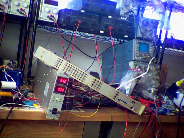

I got this setup ready for testing last week. It has produced no sound yet, let alone any measurements. If circumstances permit, I may get some experiment time this weekend.

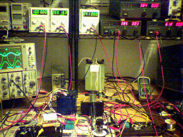

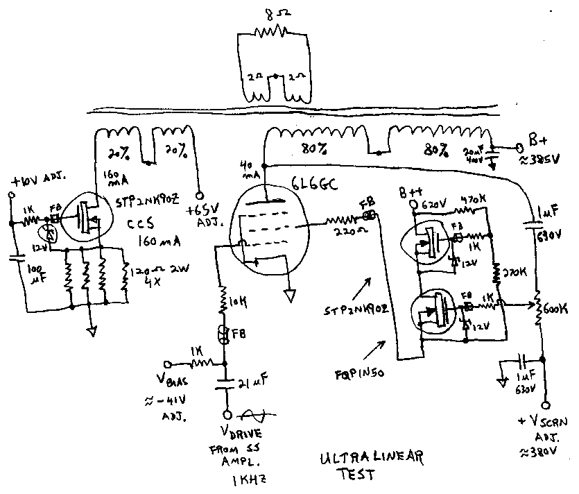

I have my test setup up and running. No parasitic oscillation, so looks good. I have only run a simple test so far, sweeping between pentode and triode mode, using a separate B++ supply for the screen (MOSFET drain actually) current return.
Monotonically decreases in power toward triode mode but distortion also monotonically decreases, no minima apparent in between. 2nd harmonic is dominant at -20 dB triode mode to -17dB pentode mode. This lack of a dist. minima may be the expected case when using a separate B++ supply for screen current return. (this is not the normal UL setup this way) About 1 to 2 Watts max out so far, using 40 mA on the 6L6 tube, I may push it further later after some operating experience is gained. I am attaching the test rig schematic. Not shown on the schematic is a floating 250V supply available to connect from the plate to the B++ drain supply point or the 50% primary tap, (instead of a fixed ground referenced B++ as shown). This will allow for more normal UL operation modes with screen current returned thru the xfmr.
Seven power supplies in action, 2 of them for the P-P current nulling CCS. 1 for filament. 1 for screen DC program. 1 for screen DC power to MOSFET drain. 1 for B+. 1 for Vg1 bias. What a job to get it up and running with all those adjustments!
The output Xfmr is a 5K P-P Edcor CXPP100-SP1, but is reconfigured for 3200 OHM load on the 6L6 tube. CCS runs on the rest of the primary with 4X current of the tube to balance DC in Xfmr.
Don

smoking-amp said:Here is a picture of the test setup:
Great pic!
Now, please online camera so we can see you experimenting!
Where is the Jacob's Ladder and Wimshurst machine? (You appear to have everything else.)
Most interesting will be to see if there's an odd order null.
"Most interesting will be to see if there's an odd order null."
Yes, there is some 3rd harmonic. I will do some tests and post spectrums for varying %UL, varying load and the connection point for the screen current return.
