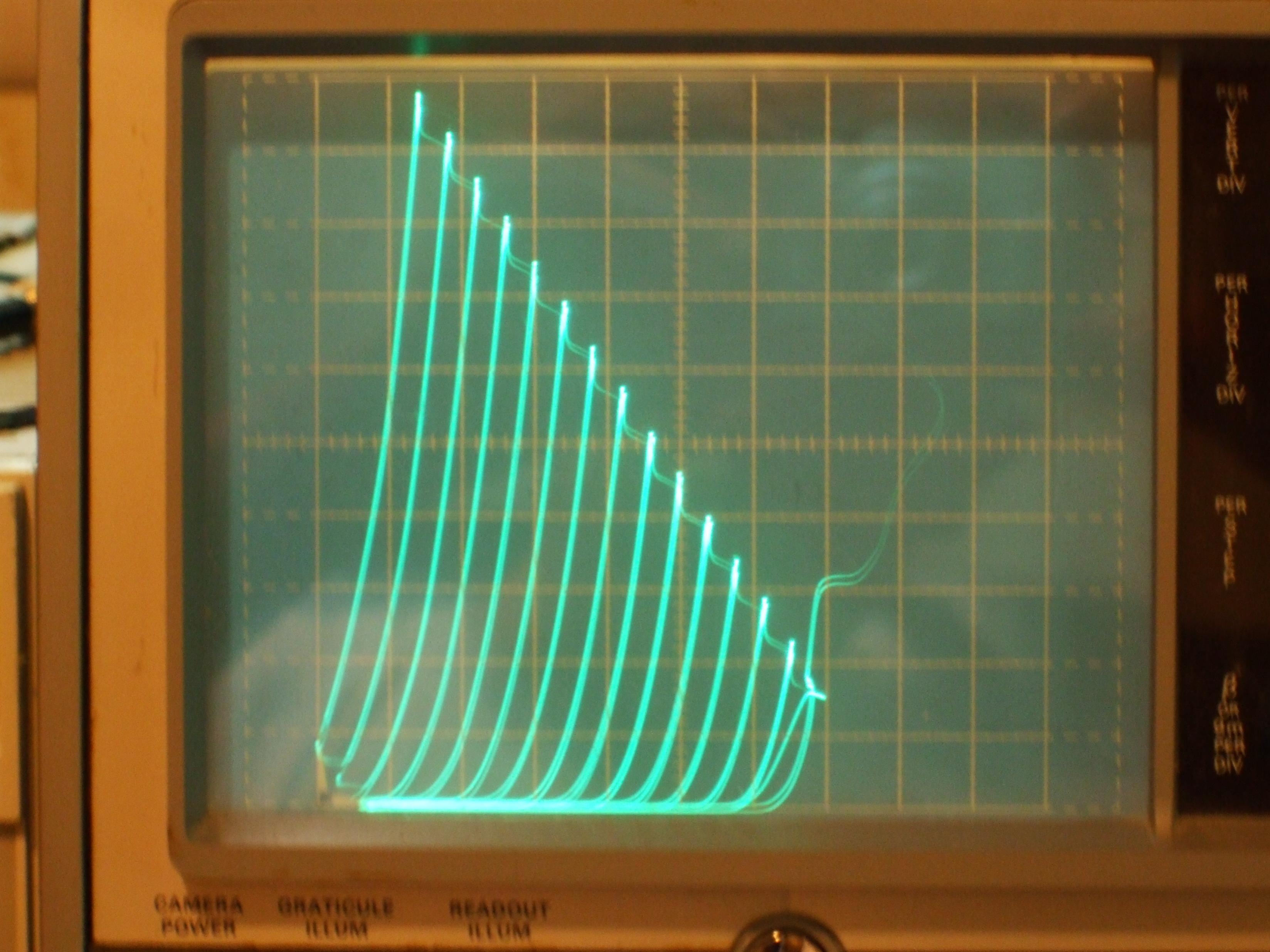

One issue with the UL scheme is that it cannot improve the effective triode performance beyond what the native internal triode curves look like. There could still be excessive plate curve rollover for example from a grid1 spaced too close to the cathode (causing 2nd H dist.). Exterior (linear) N Fdbk can of course improve beyond those internal triode characteristics.
The latest "new" series Schade N Fdbk (UnSet, CED) scheme can produce remarkable "triode" curves. Adjustable from the native triode to 211 like "perfect" triode curves by setting how much Schade N Fdbk is used. Curves for an ordinary TV "Sweep" with the "new" series Schade below.
The UL N Fdbk uses up quite a bit of the output tube's gain, so not so much is left over for Shunt "Schade" N Fdbk to do more. Some simple calculations can give an idea of what is possible, but you may have to go back to the driver stage to get sufficient gain to lower the output effective "triode" Rp enough for low distortion. Only so much can be done using local N Fdbk around the output tube.
Another problem arises with shunt "Schade" local N Fdbk. The feedback resistor from plate to grid is supposed to provide current Fdbk proportional to the output voltage. But it actually provides current proportional to plate V minus grid1 voltage. With low gain this can mean grid1 V is a significant error term there. This is what lead to the "new" series Schade N Fdbk scheme, which avoids this.
Also, conventional N Fdbk to the driver stage avoids the issue too. Higher loop gain leads to less error in the Fdbk current and lower output Z.
A driver loop can provide much more error correction and output impedance lowering than a local loop. Of course, stability is then a bigger issue, but should be manageable if the OT is not in the loop.
Thanks, I sent my previous post before you posted the perfect-triode curves.
It is really ashtonishing. The EL34 amp has a high gain cascoded PI, and I used nfb from the driver and the output of the amp.
The shunt on EL84s is easier to be implemented, because there's only need of around 30 Vpp to drive them. I will see if there will be need of gnfb there.
