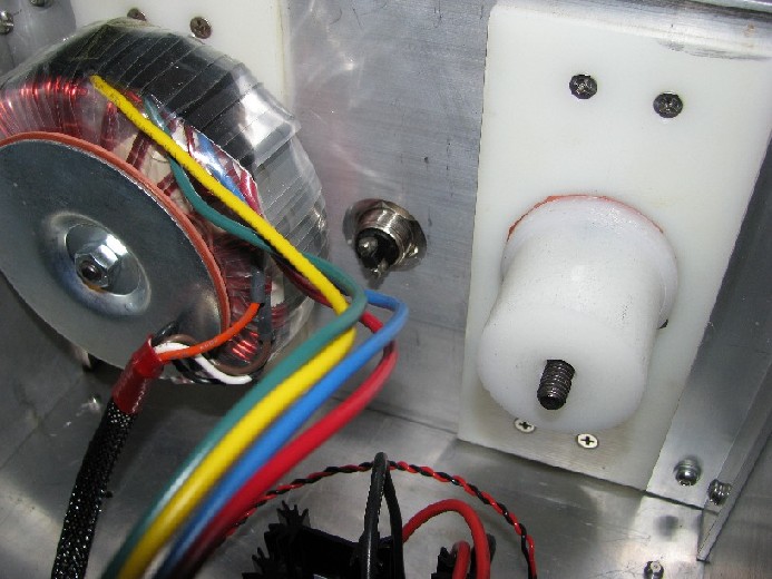

If a Front panel were to be part of the kit I am not sure what would be a standard. Mine is 10mm thick and I had to mill out the back with an End Mill to accept a standard switch as shown. This is a nice feature, but it all depends on machining costs. I will likely have to send this to a production shop if this proceeds rather than do all this work myself.
