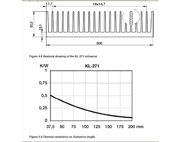

Just for comparison purposes, this KL-271 extrusion is considered one of the best with about 0.15 C/W from natural convection. It is recommended for the Leach Amp, and you may find more info at that site. There have been a couple group buys for the black anodized ~$65 shipped USA in 2006

LineSource said:Just for comparison purposes, this KL-271 extrusion is considered one of the best with about 0.15 C/W from natural convection. It is recommended for the Leach Amp, and you may find more info at that site. There have been a couple group buys for the black anodized ~$65 shipped USA in 2006

Yes I too like the Seifert Comb series Heatsinks, but they no longer list the KL-273 profile. I like the look of a longer Amplifier rather than the stubby look of an amp with 12" (300mm) heatsinks. I am hoping to get some interest in some thing over 14". The KL-271 was $65 two years ago and my favourite the KL-273 was $125. Prices have most defintely gone up since then.
I think the Seifert KL-271 and the Aavid 72545 are pretty close in real life applications at similiar lengths. I like the 72545 because it gives a deeper look for $65 in today's money.
