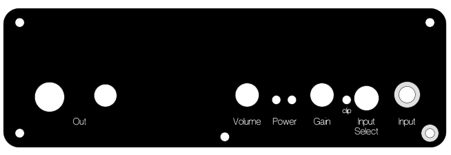

A version of an O2 Desktop Amp (ODA)

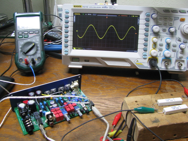

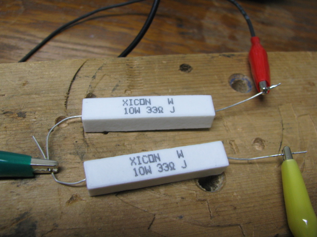

I set up a test this evening with a (nearly) 50 ohm load, photos below. Each channel has 33R in series with 16R = 49 ohms. This is with the attenuation resistors on the board jumpered to get the full output swing.
The first photo is the test setup. The next is the load resistors. I'm playing a 1KHz tone through the computer. The scope is set for 5V/division. The next 3 show the level, about 9Vpeak = 6.3Vrms. That isn't the maximum either, that is just as high as max volume on the laptop and max gain and volume on the ODA would give, without me having to break out the signal generator to go higher. :D The absolute (clipping) max is probably around 7Vrms. Also note in the photo (although hard to see) the clipping LED isn't on at the 9V peak level yet. But this is enough to show there is no clipping problem into 49R, at least all the way up to 9Vpeak, which is about 4 times more voltage swing than is needed via that loudness calculator spreadsheet.
The bass boost at 3dB would roughly double the gain at low frequencies. But only 1.5Vrms is needed for 115dB so there is still plenty of headroom.

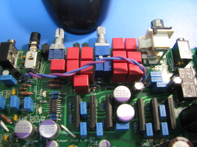

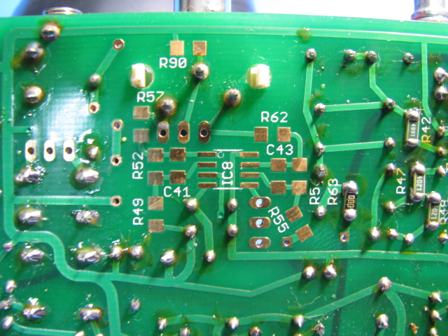

ODA pre-amp wiring, testing, and the NJM4556AM

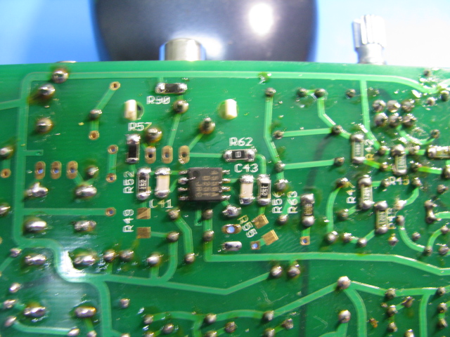

Since Mouser can't supply the MUSES8820E chip for another couple of months I decided to go ahead and build up the pre-amp section using a NJM4556AM. That is the surface mount version of the NJM4556A chips used in the O2 and the SIP package version used as the ODA outputs.
The nice thing about the NJM4556AM is it can drive cable capacitance. Someone could easily plug a long RCA cable into the pre-amp jacks and exceed the 100pf or so drive capability of a lot of op amps. No troubles there with the NJM4556AM.
I've wired the pre-amp up as a unity gain buffer. R57 and R62 are zero ohm jumper resistors to run the output of the NJM4556AM directly to the pre-amp out. Those resistor pads are in there to add isolation resistors, if needed, with other op amps to help solve the cable capacitance issue. Not needed with the NJM4556AM.
R52 and R56 are 1.5K, while R49 and R55 are left unpopulated, giving the unity gain. Then 180pF compensation capacitors are added for C41 and C43. R90 is another zero ohm jumper resistor to attach the RCA jack ground.
I've run the signal feed lines from JP7, which is the output of the input select switch, to JP20 which is the pre-amp chip input. So the pre-amp stage gets fed from whichever input jack is selected, the rear RCA or the front 3.5mm. The pre-amp stage also shares the 10K ground return resistors for the input stage, R16 and R17. This is important when using the pre-amp chip (as opposed to running signals directly to the pre-amp out jack and not using IC8), since the pre-amp chip's input bias current needs a path to ground.
* The first photo shows the pre-amp section of the ODA board before being built up.
* The next photo shows the NJM4556AM chip and other parts listed above installed. The molded dot on the chip goes toward the board edge. Best to install the chip last to help avoid static damage.
* The next photo shows the signal jumper lines from JP7 to JP20. The middle hole of JP20 is unconnected and not used.

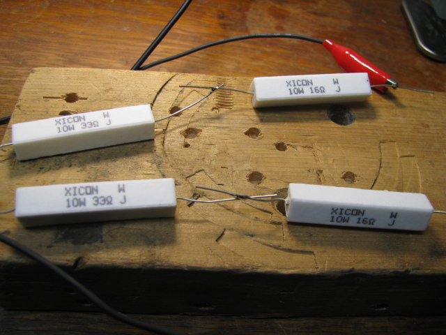

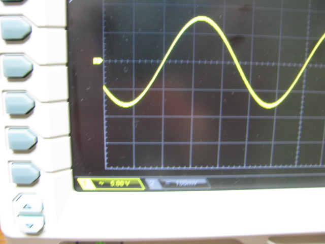

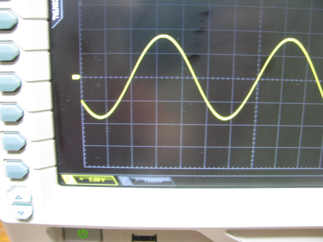

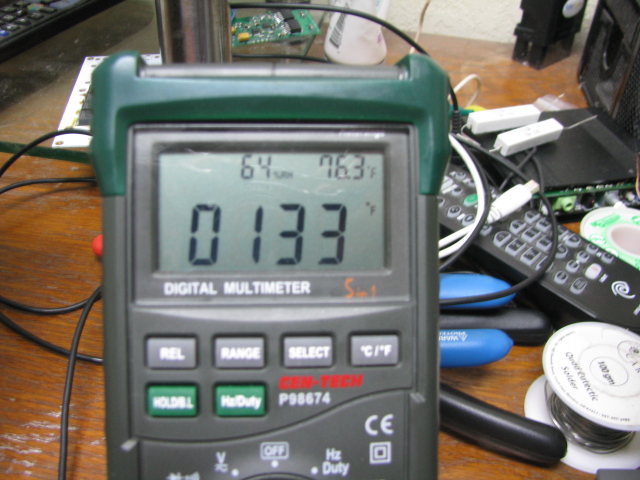

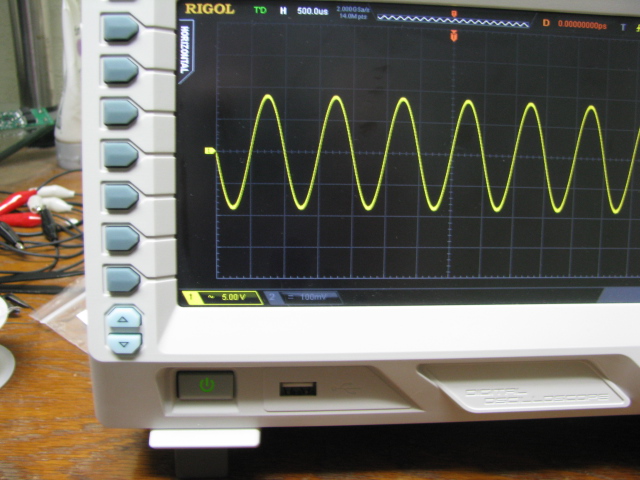

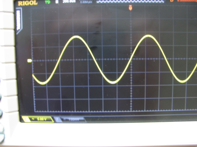

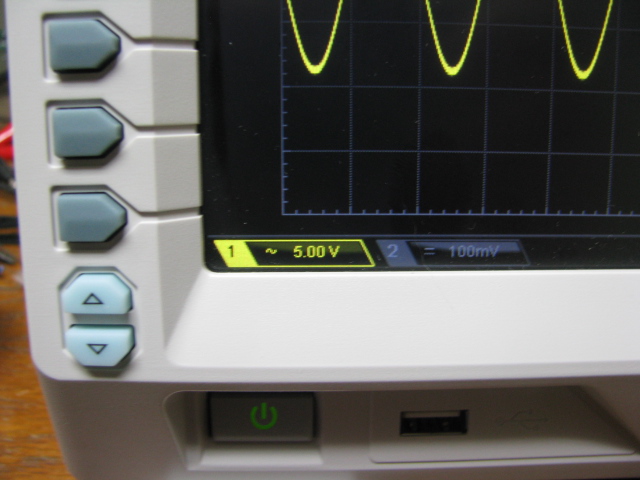

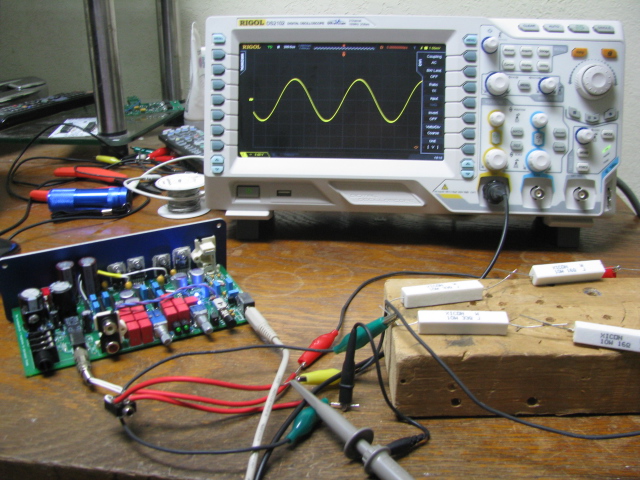

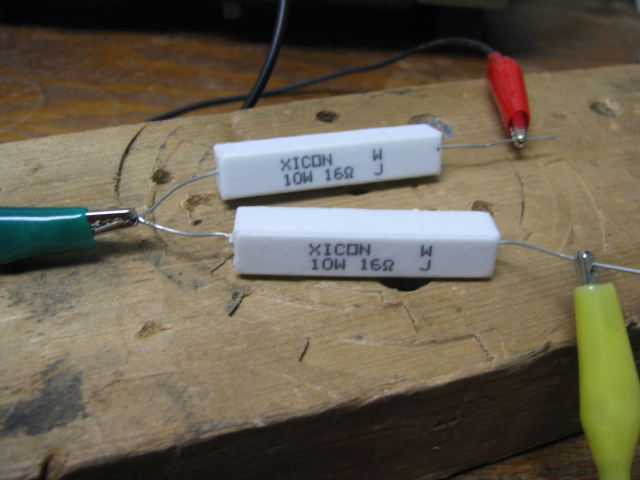

Sine wave tests at 32R and 16R
Here are photos of some tests of the ODA running sine waves into a 33R load and a 16R load. These will produce temperatures about 2x - 3x more than actual music.
* The first 2 photos are the test setup and the 33R load resistors.

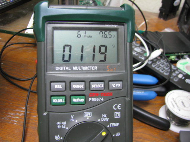

* Next is the steady state temperature of the output chips, 119F, and the waveform. No clipping at 9Vpeak = 6.4Vrms. This is in free air though, in the box it would probably go up another 10 - 15F, so I would still recommend only sine wave testing for 5 minutes at a time then letting things cool down. Again, real music doesn't have this problem because the average level is 2x - 3x less than the peaks. Keep in mind with this test we are delivering 6.4 ^ 2 / 32 = 1.28 watts to the load!

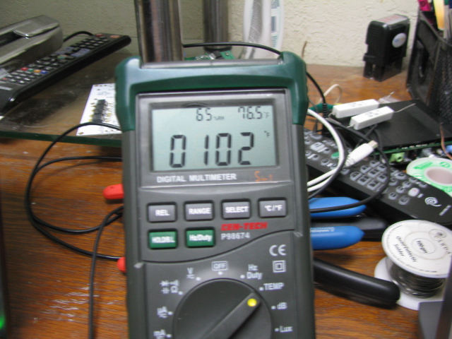

* Next are the 16R load resistors, steady state temp of 133F, and waveform. Here we finally have some clipping at 9Vpeak. The second waveform is the output reduced to 8Vpeak = 5.6Vrms, which is now clipping-free. The power delivered to the load is 2.0 watts.
* The last photo is the rear panel temperature. This is with the 16R load and pure sine waves, pretty much the worst case situation. And the panel is not attached to the metal box which will heatsink even more. 102F, which isn't bad at all.

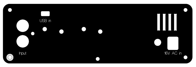

Bass boost info - change input resistors to 10K with 2Vrms sources

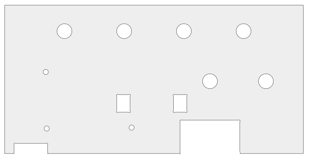

Here are the FPD files for the panels and ODAC mount I used.
Thanks for posting those!
