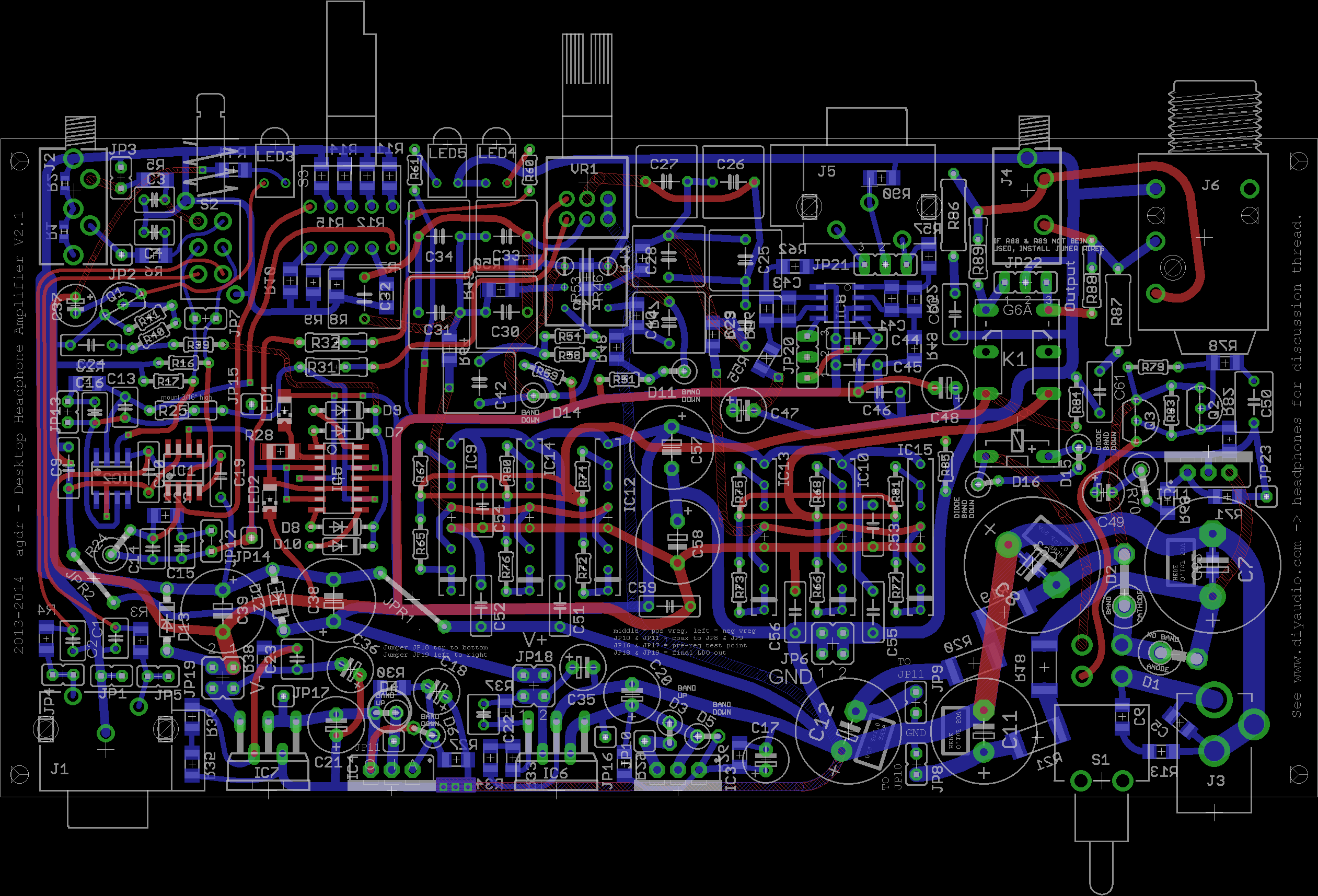

ODA V2.1 preview!
There are several folks on the "next board run" board waiting list now out at the project's Google Drive link. This board will be V2.1 with some minor changes. I've had some questions about what the changes are going to be. I've summarized the whole thing up in the PDF file below.
This isn't the final product yet. I'll likely mess with a few more things before sending it out to fabrication. No changes have been made to the schematic, other than the part values in the BOM have changed in a couple of places, as noted in the PDF. All the changes are layout related.
dace - I haven't forgotten about your good suggestion of the molex spacing at the rear RCA jack. That is one of the things I haven't got to yet.
If anyone wants to be added to the next board run list just PM me. It will all be at-cost again and I'll post the Gerbers again at the Google Drive link if anyone wants to fabricate their own boards. I just realized in working on V2.1 here that I pulled the V2.0 Gerbers a week or so ago to make a text change and forgot to repost them. I'll do that tomorrow.
Thanks for the quick reply!
Perhaps it would be an idea to split the "final" version into a "Core" and "Extended" module. That way people could use the B4-080 (and it's quite convenient size) or move to a bigger case if they want the "mess-with-the-signal" stuff. I imagine the electronics are modular enough for this to be doable.
I wish we could get cases like the Sennheiser HDVD800's (though smaller, it's such a nice design) - what would you say is the ideal size? I can take a look around and see if I can find anything in Europe that might be usable. I'm not sure how tall components are, but what would you say would be the minimum to have two PCBs on top of each other?
If I understood correctly from this thread, are the attenuation resistors before or after the opamps? If the former, since you said noise added is only proportional to the sqrt of voltage, wouldn't it make sense to feed the largest voltage to reduce SnR, and then attenuate afterwards?
Do the 1K pots have lower noise than the alternatives?
For the stepped attenuator, wouldn't it also be a good idea to use the shorting method to prevent a surge of current while switching?
For starters it would be great to find a box that can take a 100mm x 200mm board instead of the 100mm x 160mm for the B4 series. When getting the boards fabricated at Seeed Studio the choices are a 10cm x 15cm price and a 10cm by 20cm price. I have to used the 10cm x 20cm, even though the width is 16cm, and that last 4 cm goes wasted. That would also be 4cm more of front panel space for no additional board cost. But I'll bet 10cm x 20cm isn't a standard size anywhere.
Past that, wider and deeper would both be good, although I would have to go somewhere else for the boards since Seeed only goes up to 20cm. Or maybe not - I see they have a special order section now that does 6 layers, 2oz copper and some other stuff.
The attentuation resistors are after the op amps. The main purpose of those resistors is to provide more travel (rotation) for the volume pot when using 2Vrms or higher sources (which most of mine are). At 2Vrms in, even with a gain of 1x, you only get 1/3 rotation out of the pot with the fairly sensitive headphone I have. The attenuation resistors cut the op amp output in half, essentially giving you a total gain of 1/2X if the lowest gain switch position is otherwise 1X, to cut the incoming signal voltage in half. Then you are up to 2/3 rotation on the pot.
Which brings up an interesting point. If a person knew for certain that ALL their sources were 2Vrms or higher, why even have a gain stage? Why not feed the pot directly and just use the output stage? Well that is actually one of the modifications I posted in the O2 mod thread for the O2 headamp. But in this case the gain stage does still buy something. With the pot at 1K to reduce noise the gain stage acts as a "pot driver" to drive that relatively low impedance load. 1K would be too low for many sources. The LME49990 are rated for 600R and even have THD graphs in the data sheet at 600R (the 1K pot in parallel with the 1.5K feedback resistor). Without the gain stage a person would be back to a minimum of 10K pot if it were on the signal input. I know what Sergey888 and some other folks would point out here though. It is trading off lower Johnson noise in the 1K pot for additional voltage and current noise by adding the gain stage (Vs. just feeding the 10K pot directly).
Which brings up yet another interesting thing. I haven't tried this yet, but it should be possible to use FET input LME49880 chips instead of the bipolar LME49990, then up the input resistor from 10K to 50K. That might be an interesting option for foiks who have sources that would be happier with a 50K input impedance.

Over the phone they said making bigger sizes of the solid boxes isn't doable, but the U-Case 1 has a "standard" option for 220x160 PCBs so 200x150 shouldn't be a problem - that's just a case of cutting things shorter, though it would add to the cost (mildly I hope). And we'd have to factor in the cost of shipping overseas too... it could come to quite a bit per case - I'd expect $50 each at the very least.
The spec says 32mm as max component height, is that enough or would you like more?
Yeah I think the extra cost of the case and shipping probably wouldn't be worth it, plus the cost of the PC board would increase exponentially. But thank you for checking into those cases! I will keep those in mind for the future.
The best solution for a bigger box in the future might be giving up on the card-edge cases and just mounting the boards on standoffs in a much larger case. That way several 160 x 100 boards could be used, lined up edge to edge across the front panel. One card could be input / gain stage / gain switch - plus stepped attenuator!. Then the card next to it could be crossfeed and parametric bass boost. Then the card next to that could be volume control, coupling caps, and DC output offset null. Then in the back a power supply card and an output stage card, both heatsinked to the rear panel.
Well, I'll send them an email anyway. No harm in getting a quote.
Bigger box and standoffs is exactly what I was looking for at first. I like the 4 boards idea too, modularity could let people skip the bass/crossfeed bit if they want. Hopefully there's room for an ODAC too, that'd be nice.
That would be interesting to hear the quote! In going from the 220 x 160 to 200 x 150 case, would they do the cutting in both directions or would the user have to do the cutting? Maybe the shipping cost isn't that big of a deal in the overall scheme of things if more board value results. On the other hand I should look into other services like OSH Park. Maybe someone else out there can just make a 160 x 220 board.
Yeah modular would be handy. Folks could just uses the pieces they wanted.
C11 & C12 change to 25mm tall in September
Here is some good news for the project. On September 15th the BOM part specfication for C11 & C12 will change to a new cap Mouser is getting in, Mouser #661-EGPD500E821MK25H. The cap is the new GPD series from UCC, which is the downsized version of the existing GPA cap used for C11 & C12. It is 820uF, 50V, and 12.5mm diameter just like the existing cap, but 5mm shorter to match the 25mm height of C7 & C8. The new cap has a similar low ESR, a higher ripple current rating, and is also an automotive cap rated for 125 - 135C.
Right now C11 & C12 are the tallest things on the board. They just barely miss a board inserted in the top slot. With the change C7, C8, C11, & C12 will all be the same height and give a good 5mm spacing to a top slot board.
Got a package today. Thanks a lot agdr.
How much do I owe you for these?
Nothing! All on me. That stuff is just the changes I've made since the boards were fabbed, plus the one big screw-up that Alex found of the 1NXXXX diode holes being small. Those diodes in the package fit. Sorry about the delay in getting those diodes to you! I thought that I had sent diodes out to everyone weeks ago, but uncovered that packet I had put together for you under some papers where it had gotten lost.
If you haven't ordered parts yet then you have less to buy, and if you have ordered parts you won't be out any $$ on the changes.
