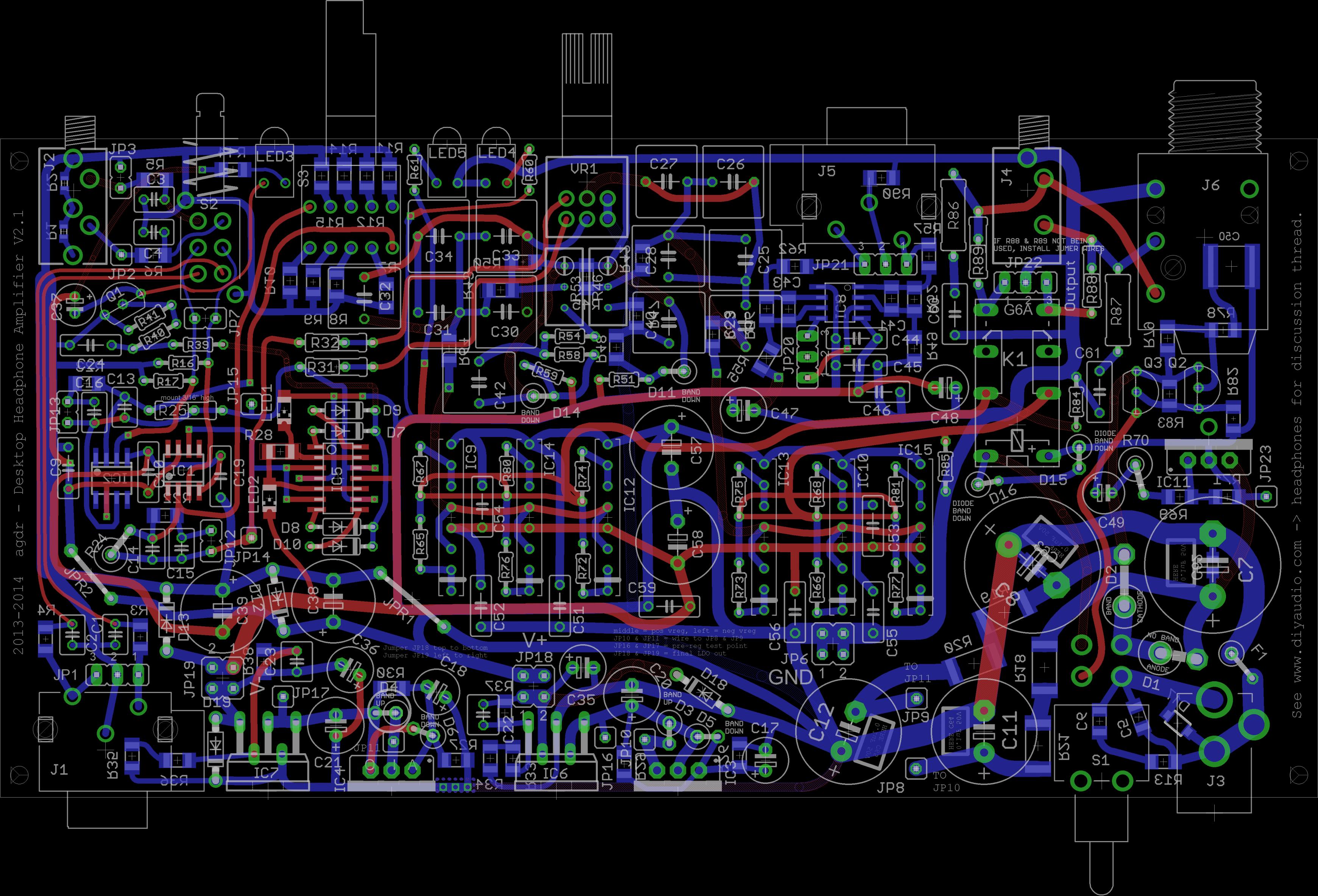

Well... I'm pondering some ideas for a larger PCB. It would be a V3.0 at some point in the future. But on the new V2.1 going out in a week or two I will see if I can add holes attached to those LT regulator set resistors. That would make it easier to wire those across to an external voltage setting switch.
Some ideas for a V3.0 -
* Add the inductors back in the CRC section to go back to a CLC. The coils I had in originally were not shielded and coupled into a nearby ground trace. Sheilded coils are too large for the current board. I could go back to sheilded 100uH inductors. The whole goal of the CRC or CLC filter is to block incomming RF / EMI conducted from the power line and/or picked up by the power lead. I always try to design for the worst case. Instead of assuming clean power coming in I assume a person lives next to a metal plating shop on one side and a welding shop on the other, both of which attach to the same pole transformer as the house, then a satellite dish uplink farm across the street. I've lived in Los Angeles for awhile, lol. I've actually seen that kind of situation. There are some amazingly electrically noisy commercial operations butted up next to residential areas, on the same power grids and within EMI radiation distance.
* Something I was thinking about doing originally but didn't have the board space was add yet another LDO regulator, one of the TI ultra-low noise recent units that have both rails at about 500mA max, to power just the gain stage chips. In addition to even further reduced power rail noise this would dramatically isolate the gain stage power from the output stage class AB transition current spikes (and resultant voltage variations on the power rails).
* I could potentially add pads for a voltage select switch again that could be optionally installed, along with resistors, or left out for fixed voltage.
* There would probably be room to switch the IC5 clipping detect chip (14 pin TLO64) back to through-hole with a socket rather than the 14 pin SOIC. That is the hardest chip to solder on the whole board.
* And maybe room for the crossfeed!

Here are some more additions and changes for V2.1. I think it is getting close to being finalized!
* Added a fuse just above the power input jack. A picofuse with wire leads, on end to fit in the space.
* Added a bidirectional transorb diode across the AC power input. This will help snuff out fast moving power line transients. It should respond faster than the MOVs in a typical surge supressor power strip. I've seen at least one situation over the years where a loose 100 amp feed wire to a power panel was causing fast transients throughout an office building that surge strips wouldn't touch. Gas discharge tubes nailed them though until the power panel problem was found and fixed. The transorb response time should be somewhere between a MOV and a gas discharge tube.
* Changed the two 200K through-hole resistors in the relay circuit section to surface mount and changed the 4.7uF relay timing capacitor to surface mount. I've placed a few parts underneath the 1/4" jack. Then moved all the parts up toward the 1/4"jack a bit. All of this allows the IC11 regulator to move up a bit. This provides more room now that IC11 has a heat sink. It may even provide enough room for the next larger size heatsink with longer fins. I'm going to try to place PC mounting holes so the version of that heat sink with PC mount pins can be used. The change makes good use of the unused board space under the 1/4" jack.
* I discovered that the C51 and C52 decoupling capacitors were returning to a different ground star segment than the rest of the output parts. This is fixed and a new ground star segment is run to C38 and C39. I've made some layout changes around those capacitors to make them more specifically for the gain stage. For folks with existing V2.0 boards none of this should make any audible difference. Those C51 and C52 caps are just decoupling to supress any oscillations. I'm just cleaning the layout up a bit here is all, and it may eventually make a difference with very sensitive dScope or AP analyzer tests.
* I'm getting a quote on having the V2.1 boards done in 2oz copper rather than 1oz. Related to that I've decreased the size of the traces that go by the bottom right pin of S2 to 0.3mm from 0.4. Those traces are the tightest squeeze on the board. 2oz copper needs more spacing between traces for the etch to work, so I wanted to open that trace to hole spacing up a bit. The current through those traces are extremely small so it won't make any electrical difference.

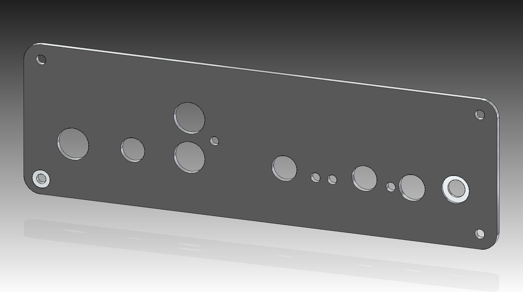

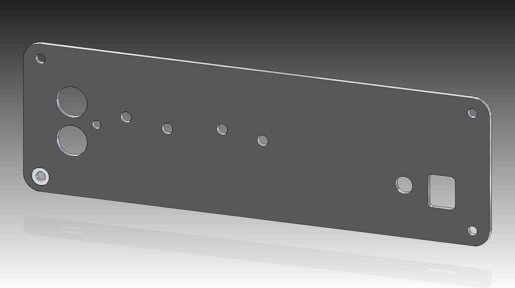

Here are some files case maker can use. In zip file there are stp files that can be opened in Solid works.
Please can someone check if all measurements are ok. I attached PDF files with technical drawings.

Thanks! I've sent them your files and the "official" xlsx so that should be fine. They were able to open the included files anyway.
If you want I can add few holes for cooling but you would have to specify where to put them since I don't have my own ODA.
@agdr: This'd increase LincolnBinns price if necessary and I didn't mention it to them, please let me now if so.
Also, they'd like to know what font size (and font?) you used.
Thank you!! That gives the files in another format that is more universal.

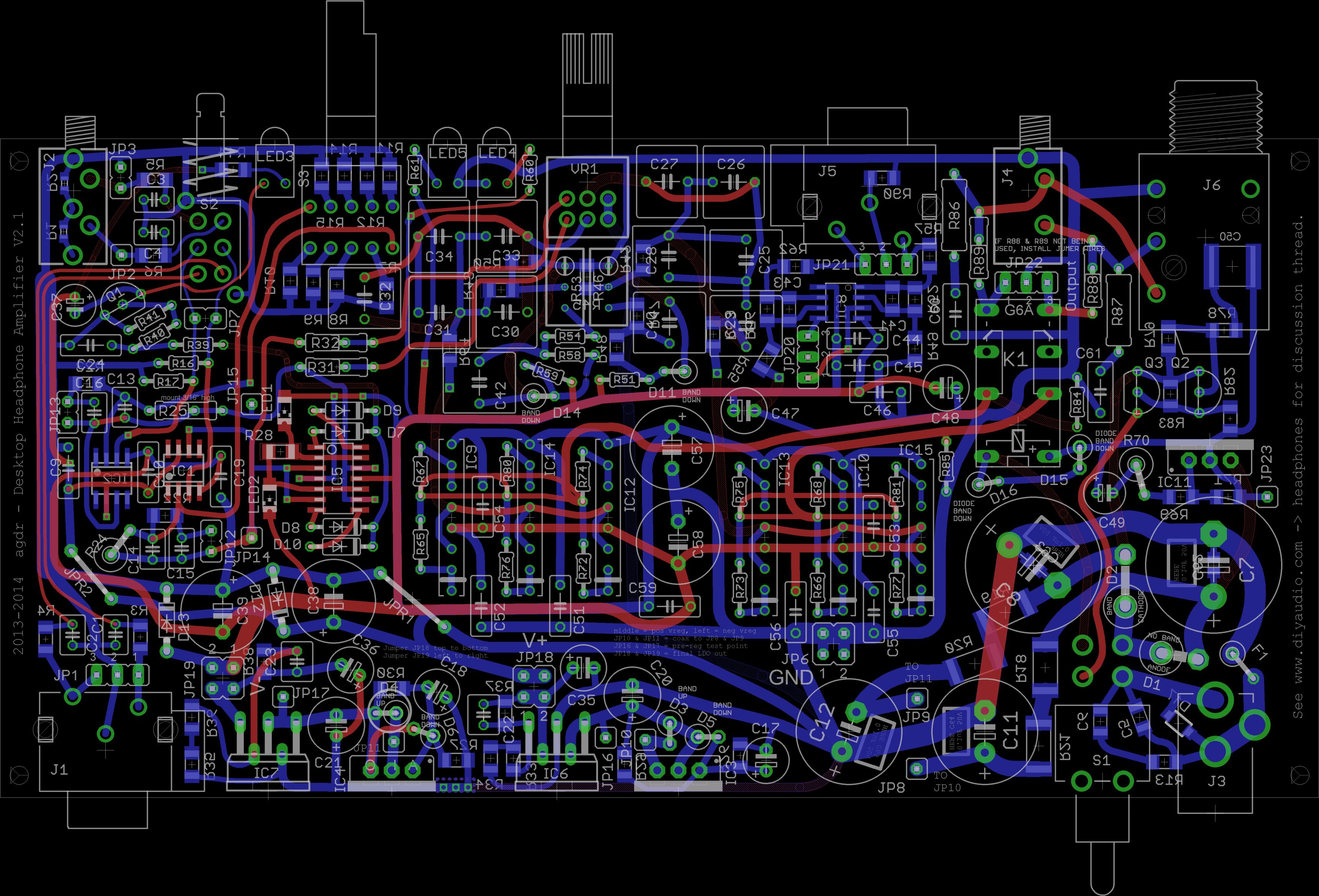

ODA V2.1 is now out for PC board fabrication!
I was able to get the final bits of revision done on V2.1 last night. I sent it out for fabrication today. The layout below is what went out.
I did get a quote back on 2oz copper and it was nearly double the cost. Not worth it since it really wouldn't make any significant electrical difference. The fabrication should take around 5 business days, then around 7 days in the mail to get back to me, then building one up and testing it!
Here are the last changes to the board:
* I changed the holes near the rear RCA jack to Molex spacing, as dace suggested.
* I've added an additional set of Schottky rail clamp diodes before the power disconnects. When I added those disconnects it left the rail clamp diodes on the other side. Those diodes are important in dual rail power supplies to make sure the rails maintain the proper polarity during the instant when starting up. Usually one voltage regulator (positive or negative) will start up and instant of time faster than the other, leaving the opposing rail with the wrong polarity voltage for an instant (via rail to rail parts). The rail clamp diodes prevent that. The adjust resistors for the negative LDO got moved to the unused space under the rear RCA jack to make one diode fit.
* I was able to add a hole for a heatsink mounting pin in front of IC11. If my measurements work out there we will be able to use the version of that heatsink with one PC mounting pin.
* I wasn't able to fit in holes to attach wires to the LDO adjust pins for an external voltage select switch. I see thought that those wires can just be soldered onto pins 2 and 4 of the LDO regulator chips on the top (or bottom) of the board.
* Numerous other small layout tweaks.
I still haven't added vent holes to the rear panel. Lets see if I can get time this weekend to do it. On the one I sent out for dScope testing I just drilled one hole above each pre-regulator and one above the switch/power jack. I really like the slots that dace did on his board and the circular vents that kamilgd created on his back panel. Both look nice! I also still need to figure out the USB hole. Part of that is that new capacitor type for C11 and C12 I posted about. With that change there won't be any problem using the top case slot. dace certainly has a good solution there that he posted, with a notch in his carrier board for those two capacitors and using the second slot down.
In fpd the font is "Helvetica Light, 1 Stroke" with text height 2.5mm, text spacing 1.5mm, alignment = centered, and engraving tool 0.2mm.

If we move to the Uniobox we get up to 66mm of components, but in the current LincolnBinns case you wouldn't have any room whatsoever for anything big in the top slot. A few mm at best.
