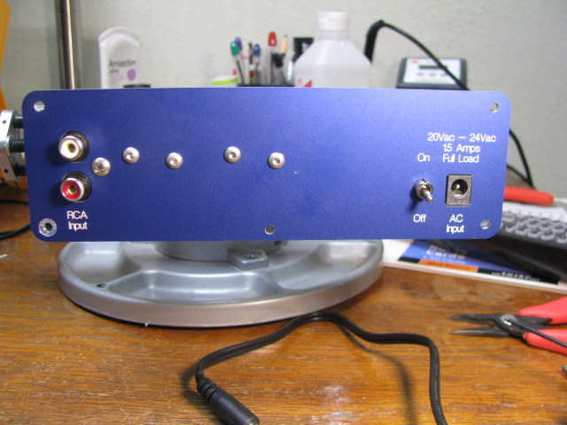

Well I finally got the front panel almost completed, still needs some minor work, labeling etc..
But it looks pretty good so far...

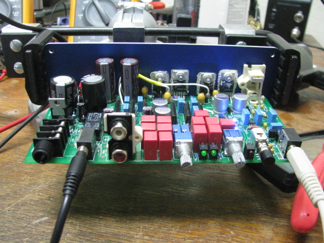

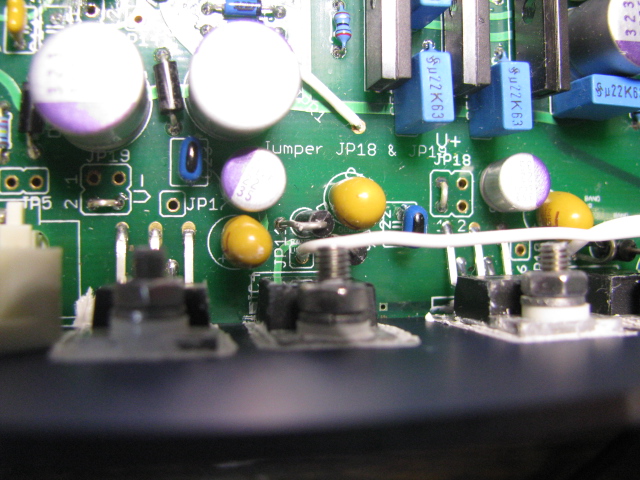

IMPORTANT: D4 IS IN THE WRONG WAY IN MY PHOTOS
A big thanks goes out to dace for just discovering the mother of all screw-ups in one of my build photos, below. See how the "flying lead" on D4, the diode in the middle front of IC4, is oriented toward the IC4 chip? That is wrong! The Part ID diagram out at the V2.0 Google Drive project link shows it well. That hole is JP11 where the white wire carrying the power input should go. That diode lead should isntead go the hole just left of D4 (the hole that has the last 11 of the JP11 silk screen cut off), which is where I put the white wire.
In a truely lucky turn of events this mis-wire didn't smoke anything, which is why I didn't discover it in testing. The mis-wire ran the incoming power directly to the LT3015 LDO, which still produced the correct output voltage. The LT3015 has a 30V maximum input though. Part of the purpose of the pre-regulators (which are rated at 37Vdc input) is to reduce the voltage to less than 30 for the LDOs. But in my case I used 20Vac and 16vac transformers for testing, which equate to 23Vdc and 28Vdc peak, under the 30Vdc chip maximum. And on Alex's board, which I can see I also mis-wired from the photos, he is using the new 16Vac 2.4A transformer. So the LT3015 survived just fine.
As for why the LM337 survived, the mis-wire fed incoming power to the output of the chip rather than the input. But luckily the mis-wire left the input floating, and the adjust pin doesn't care as long as the polarity from output to ground is correct. So the LM337 also survived, it just was sitting there not doing anything.
Hopefully only my board and Alex' go snagged by this so far. Let me know...
Clearly I'm going to have to improve the labelling on JP11 on the next batch of boards. In the build instructions I have a step to check that pre-regulator voltage by using the test point JP17. But I skipped that test on my own builds. If I hadn't it would have detected the problem.

Question,
Once I correct this will this affect the offset voltage settings?
GOOD CATCH !! Dace!
Thanks for letting us know ASAP agdr...
I will correct this pm and post results!!!
Alex
(smiling here!!)
Nope, won't affect anything. Both LDOs were still producing the correct voltages. The only effect at all was that the LT3015 was working harder than it normally would, but still within specs.

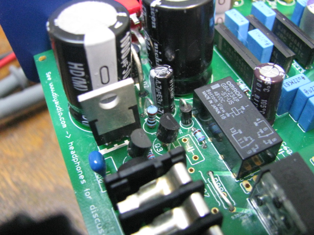

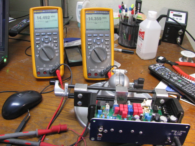

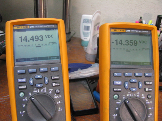

Corrected photo of D4's installation and JP11 power feed
OK, the first photo below is with the D4 diode and JP11 mis-wire fixed. The negative rail power input is now going to JP11, in front of IC4, and the flying lead of D4 is going to the hole just left of it, view from the back of the PC board. Thanks again to dace for spotting this!
* The next photo is the current back panel design that I received back from cam-expert.com a couple of weeks ago. It really does need vent holes! I haven't had a chance to add those yet but should be able to do it this week. Or even better use kamilgd's design. Mine will just be holes - I like the circular slots he had made.
* The next photo shows the "new" R70 (the one on end) in the relay circuit section that goes with the +/-12.5Vdc power rail BOM and 24Vdc relay. It is still 3.01K, just 1/4W. If you have the larger 1/2W 3.01K that was originally in the BOM that will work just fine too. Lol - note from the lettering on the relay it is still the 48Vdc. Next step when I installed R70 was using the Hakko 808 to get the relay out and swap with the new 24Vdc unit.
* The next one shows the voltages at the pre-regulator output test points, JP16 & JP17, +14.5Vdc and -14.36Vdc, right on the money. If I had made this test during either my build or when wiring up Alex's board - and the test is in the build instructions! - I would have discovered my wiring problem.

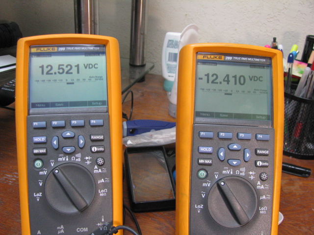

* The next photo shows the output voltage from the final LDOs, +12.52Vdc and -12.41Vdc, again right on the money. The voltage references built into the voltage regulators have a small +/- tolerance from chip to chip. The final result will usually be just slightly off from the 12.5Vdc target unless you get lucky. That is why R33 and R36 are in there as "tweak" resistors if anyone wants to get really fanatical about perfectly matched rail voltages. That miniscule voltage difference between rails won't matter a bit electrically, clipping would just hit one rail first by 100mV, but what the heck. I did some math and upping the R36 from 20R to 40R would likely bring the negative rail down to around -12.50Vdc. Easier than the math just order some extra 1206-sized SMD 0.1% resistors (1/8W or 1/4W is fine) in 10ohm increments, like 30R, 39R, 49.9R, etc and pop them in one at a time until you get where you want to be if your particular LDO chip on either rail reads a tiny bit low.
* The next photo shows the new relay regulator output voltage, +23.47Vdc here but remember referenced to the negative CRC rail, not ground. That voltage is just fine. The relay regulator target is 24Vdc and close definitely counts here. The relay is good for +/-50% of the rated coil voltage.
* And the final photo is playing music! Sounds great.

Good Morning...
Mine are 12.5 and -12.44.
