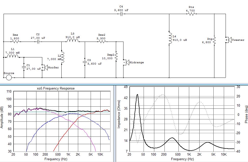

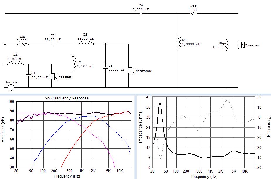

I had to pull the bottom off the speakers to get the values again. I lost my old notes on the values used. The current crossover are as follows:
Tweeter: 3.6uF .91mH
Midrange: Just one of the high pass and low pass
Woofer: 27.0uF 7.0mH
Remember your original crossover, not so bad. See schematics below.
I strongly suggest to test it before ... The sensitivity is 83dB, but you can increase the sensitivity to 86 dB ... Adjustments must be done by listening. Suppress Rms2, Rmp2, Rms = 3.3 and Rts=3.3 Rtp = 15 (the overallimpedance is above 8.6 ohms)

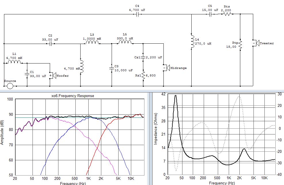

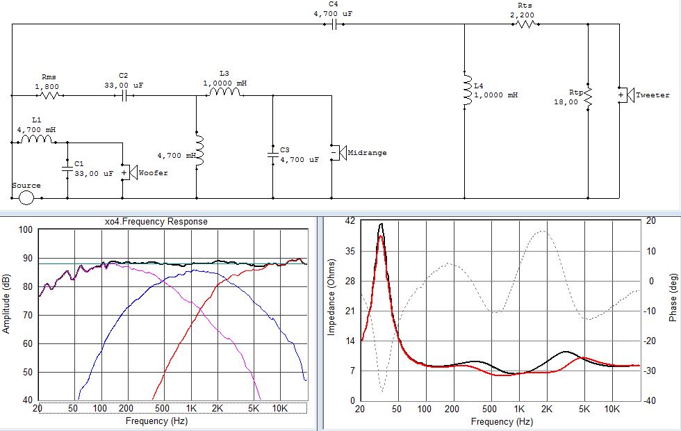

Yes because it's a full LR2 crossover. I didn't understand why you have LR4 goals and you do not achieve them. I think LR2 between the woofer and the mid is enough. But between the tweeter and the mid, it is more difficult to say. Only listening tests can say. To make a correct LR4 crossover in the treble, you may need actual measurements. According to my experience, my ears a LR4 gives better result.
I done a schematic with LR2 at 500Hz and LR4 at 2800Hz see below, min impedance is 5ohms. The second schematic if you keep your original values.

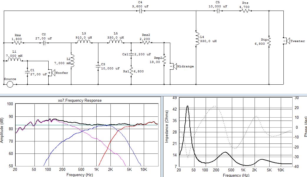

diyAudio Moderator
Joined 2008

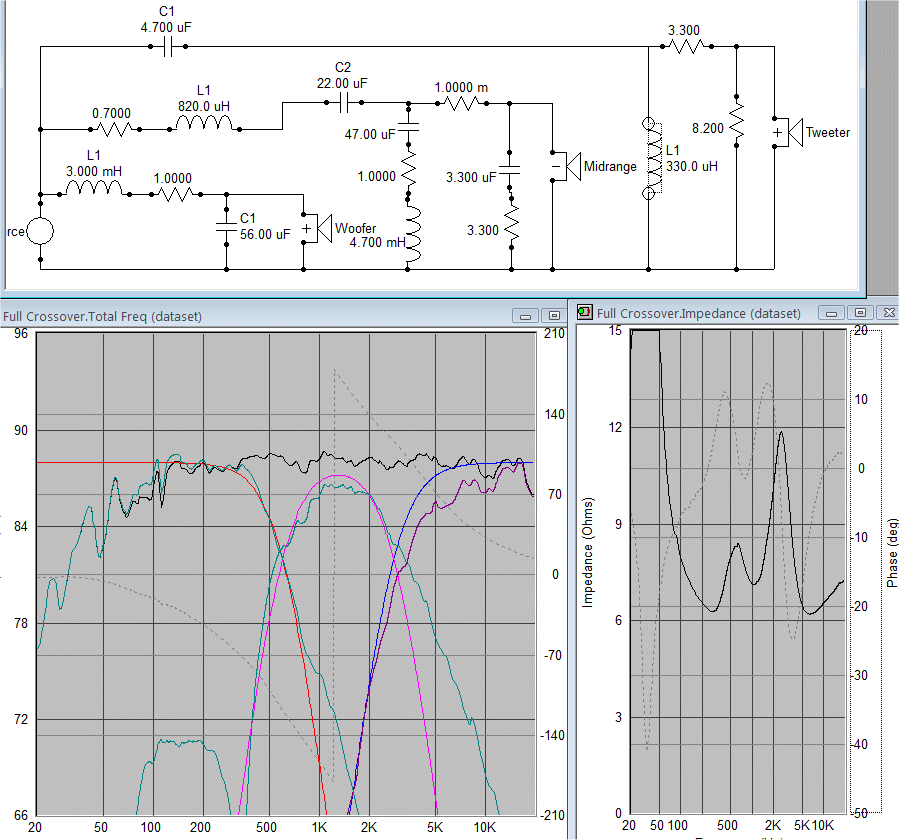

No doubt you discovered just how difficult it is to get the lower midrange right without that impedance dip. ;)
I was trying to stay away from large value inductors but in this attempt I needed one in the lower midrange.

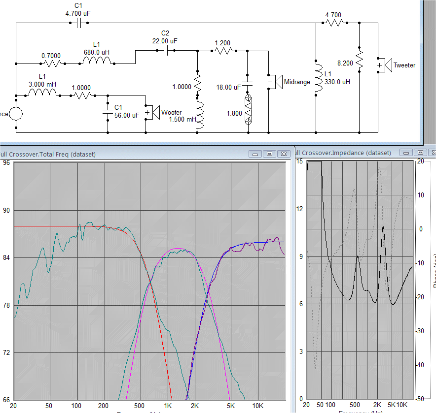

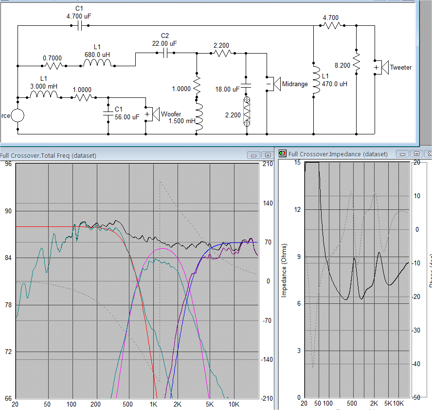

Second order Linkwitz-Riley and fourth order. Each order represents a fall of 6dB per octave from the crossover point, and the LR respresents the rounding of the 'knee'.
This plot is the same as the last one except I've targeted the individual driver goals rather than the total goal. I wasn't intending to aim at a total response until I got into the impedance dip, and I noticed you were concerned about the midrange level (which is reasonable, but complicated). I've just shown where the tweaks for this are.
