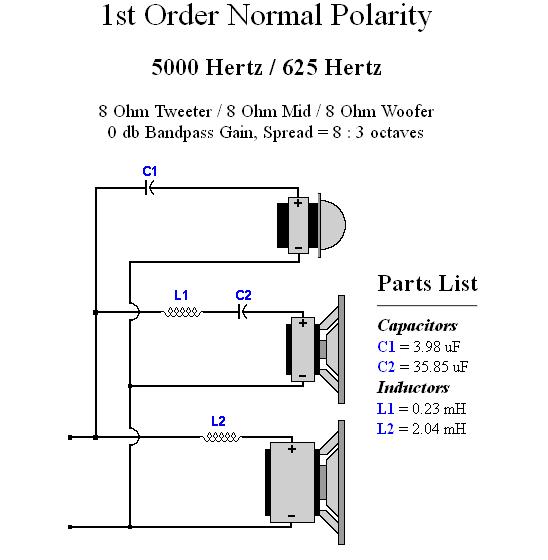

@Istoc
Maybe I'll repeat a suggestion but you can try first order crossover? Tone can be relaxed and more natural... Your drivers can handle this crossing points: 625hz/5000hz or 750hz/6000hz.
there is calculator
3-Way Crossover Designer / Calculator
