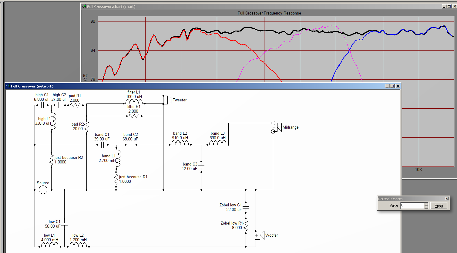

I'm going to be ordering my crossover components here soon. Thanks Allen for all your help, I modified the curves a touch more with the values available from ERSE's site to get them as close as I possibly could, as you said the information is only so accurate without reading however I'm thinking with your expertise and patience this will turn out fantastically.

It would just be easier to re-upload the SW files again. I never built them into one solid crossover array in SW because they will be 3 separated crossovers in actuality anyway. The changes were minor at best.
Not big changes I actually left the tweeter completely alone just a nudge here and there.

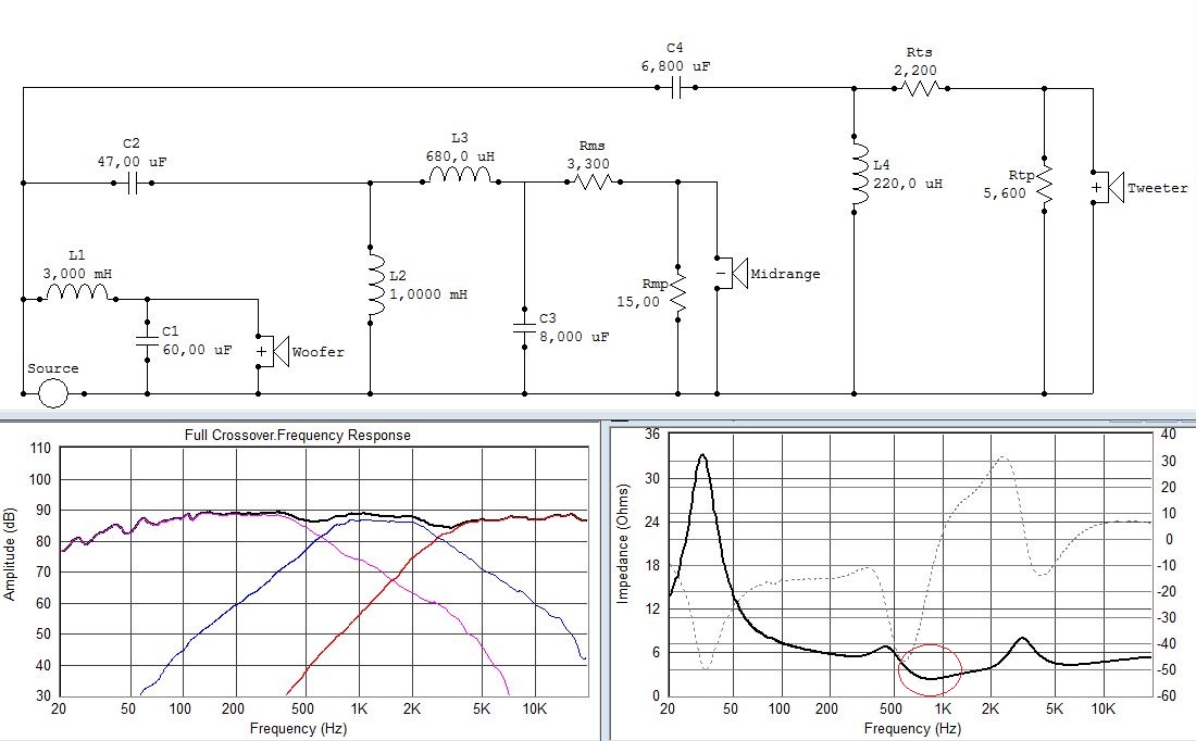

Istoc, I looked the crossover, 87dB, 650Hz-2800Hz... SPL curve is good but:
Sorry , it is not already finished. You have an impedance issue : 2.4 ohms at 700Hz. I verified with actual measurements it was worst. The impedance curve is not very good. You still need crossover work.
1.5 ohms for L1, the 3.3mH is too much ! Keep it below 0.5ohms.
See the schematic below.

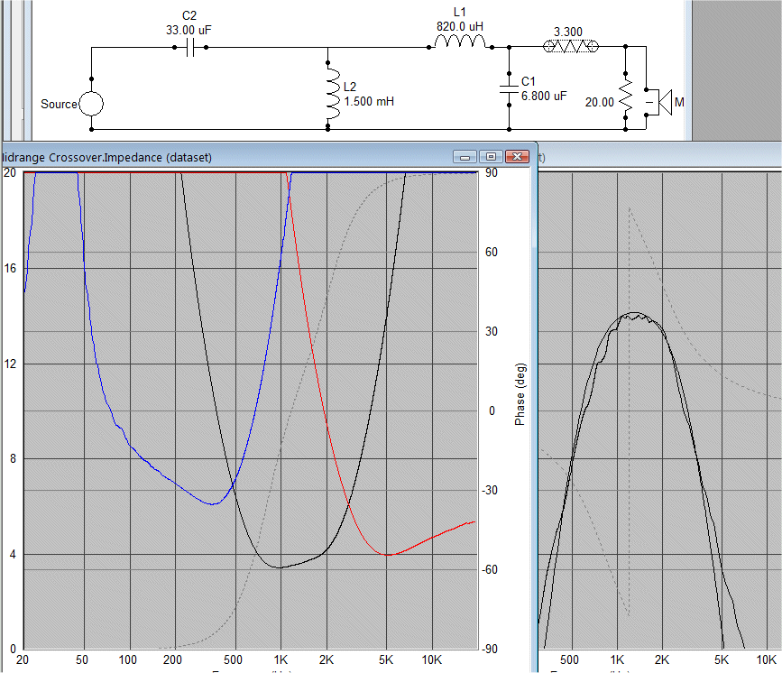

With regard to the impedance dip. Such a dip wouldn't normally put me off, still it should be noted that the impedance file contains invalid phase data and so cannot be trusted.
considering that the L-pad swamps the driver and the first filter has a hand in the potential dip, I've offered a replacement midrange section.
