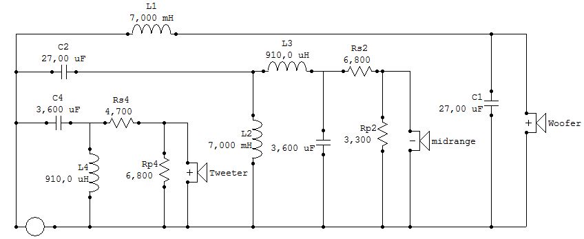

I had to pull the bottom off the speakers to get the values again. I lost my old notes on the values used. The current crossover are as follows:
Tweeter: 3.6uF .91mH
Midrange: Just one of the high pass and low pass
Woofer: 27.0uF 7.0mH
Ok I can help ;)
It is a starting point, you need measurements to design a precise crossover.
You are lucky because textbook values could work in this case.
Buy four LPAD and follow the schema below. The LDAP are represented by Rs2/Rp2 and Rs4/Rp4.
I keep your values but you need to attenuate a lot more the mid and the tweeter ! Full bass step compensation here Sensitivity = 82dB.
Note the midrange is connected in opposite polarity ;)
If you do the recommendations, suppress L4 and listen if it is better.
Let us know it works ;)
Ok I can help ;)

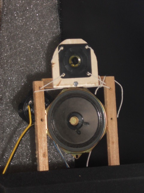

Expensive or not , it is the target that you want to acquire .
That was the only way to make less shouty an Audax PR17MO .
The woofer was a late seventies Altec clone made by Kenwood.
But I dismantled the gigantic boxes 1 month ago.
Now the woofers runs in OB , well , just a frame :)
in 3 way+rear tw , and the mids and tweeters are super -budget

Well they are nothing like the OP's speakers,
remotely. So what is the practical relevance ?
rgds, sreten.
