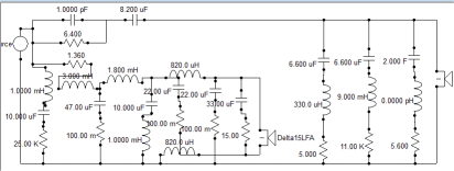

In my speakers I currently run each crossover wired independently so should I only create 3 different networks or create 1 overall with 3 others for each driver?
It is normal to wire each driver and its crossover separately from the others, they are only joined at the amp which doesn't count. Create one total network, and if you want to work on a target slope for each driver separately, which is reasonable to do, then create a network for that driver.
I'm trying to punch in the numbers but for the life of me I can't get Speaker Workshop to accept the right values.
For what, the crossover component values? There should be a small box that comes up, click on your component on the network form and the value will come up in that box.

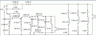

I don't expect SW to be too neat with the schematics but it is possible to rotate the components. Double click on them and you'll have some buttons to click on.

good points Allen, my example may have been a bit misleading in that I showed the schematic of the final crossover. I actually used separate networks for each driver and only did a combined one at the end to check the impedance.
Creating a separate network for each driver has another benefit as well. It allows you to use the optimiser. The optimiser is a bit tricky to get the hang of, and occasionally gives really odd results but it does work quite well.
As Allen mentioned earlier you can combine two curves, that is what I did, I calculated each network separately and combined the results.
