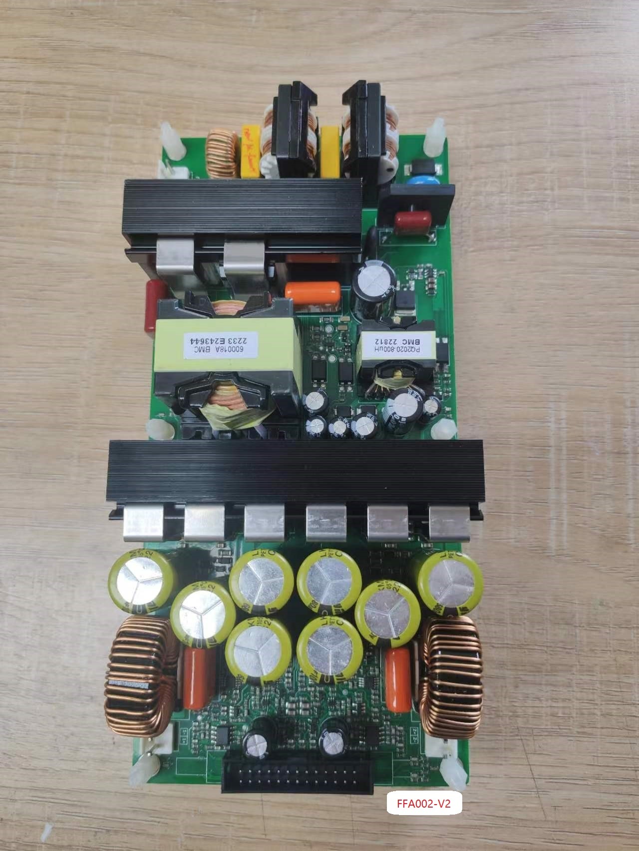

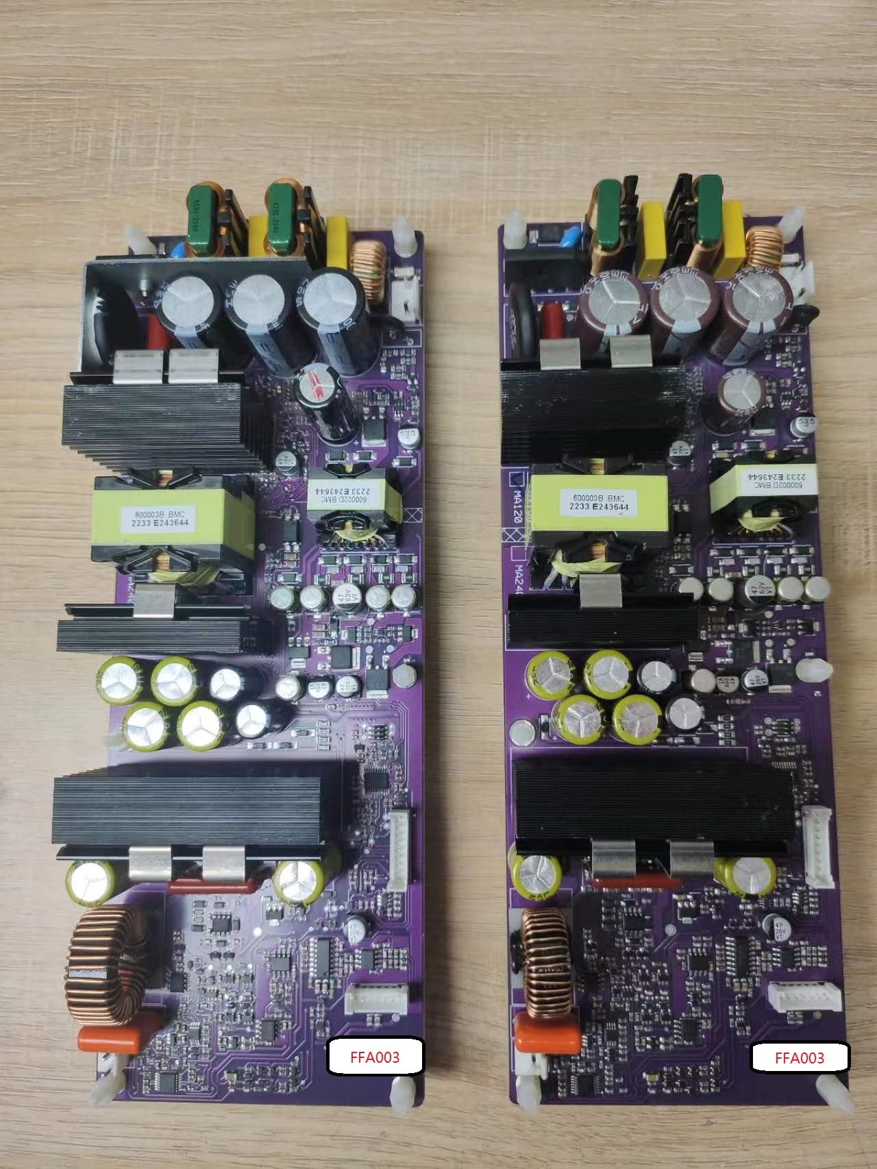

Thanks for your suggestions, and it did put higher demand on us, we'll try to see how far we can go
With your requirement for high-power modules, I'd like to show you some pictures in advance (the 2x350W same interface with the 2X150W version, and a single 350W module.) With these boards in your system, I hope it will not cause the complaints from your neighbors ~~

What speakers are you driving? I worry about my speaker choice being laughed atI’d definitely be interested in trying The 350w X 2 amplifier. I like the 150w board but it’s not quite enough power to really crank up the volume when listening to Rock in my main system.
Living for interest is the happiest and most fulfilling lifeThanks for the pics. For me, delving in these things is good clean fun, looking forward to making the 2800w 4 x10 bass amp, the Bassinga Bageera
