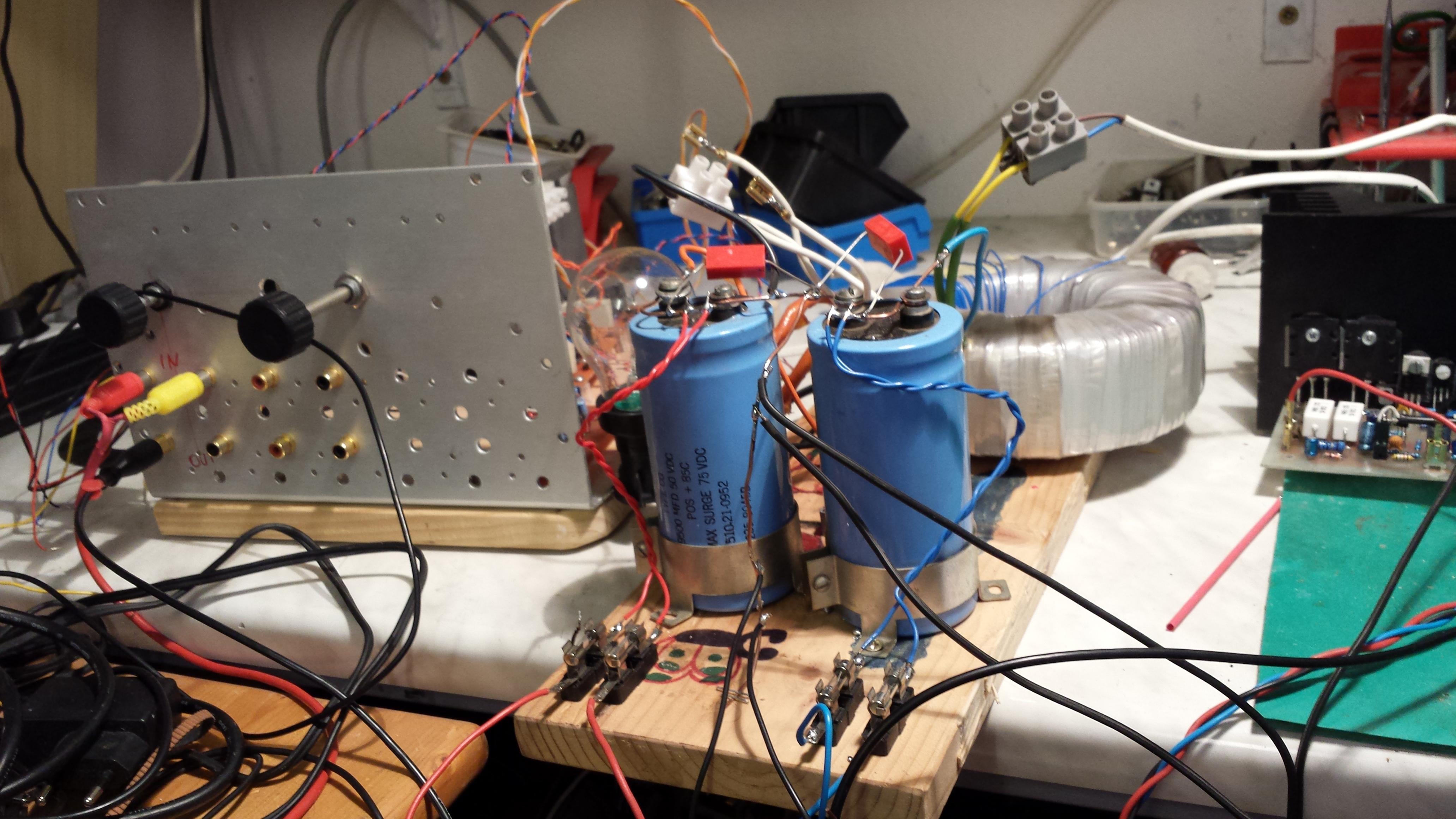

this is my AX-14 with 2 pair 5200/1943 output and mje15032/15033 drivers. PSU is 2x53 VDC and 30mF per rail. It plays very well,strong bass and clear mid and high. Now i will try to build AX-11 with TO-3 transistors .

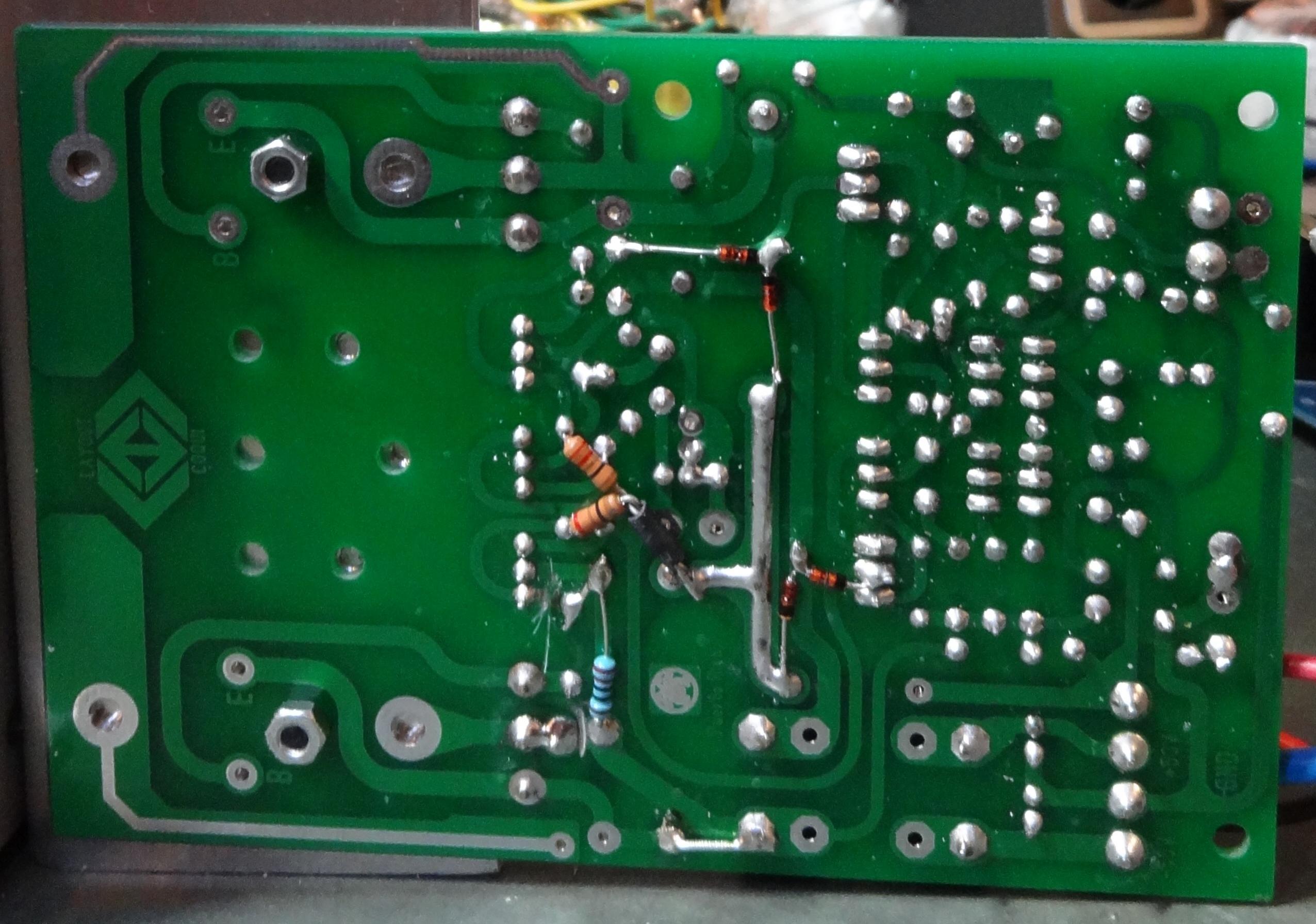

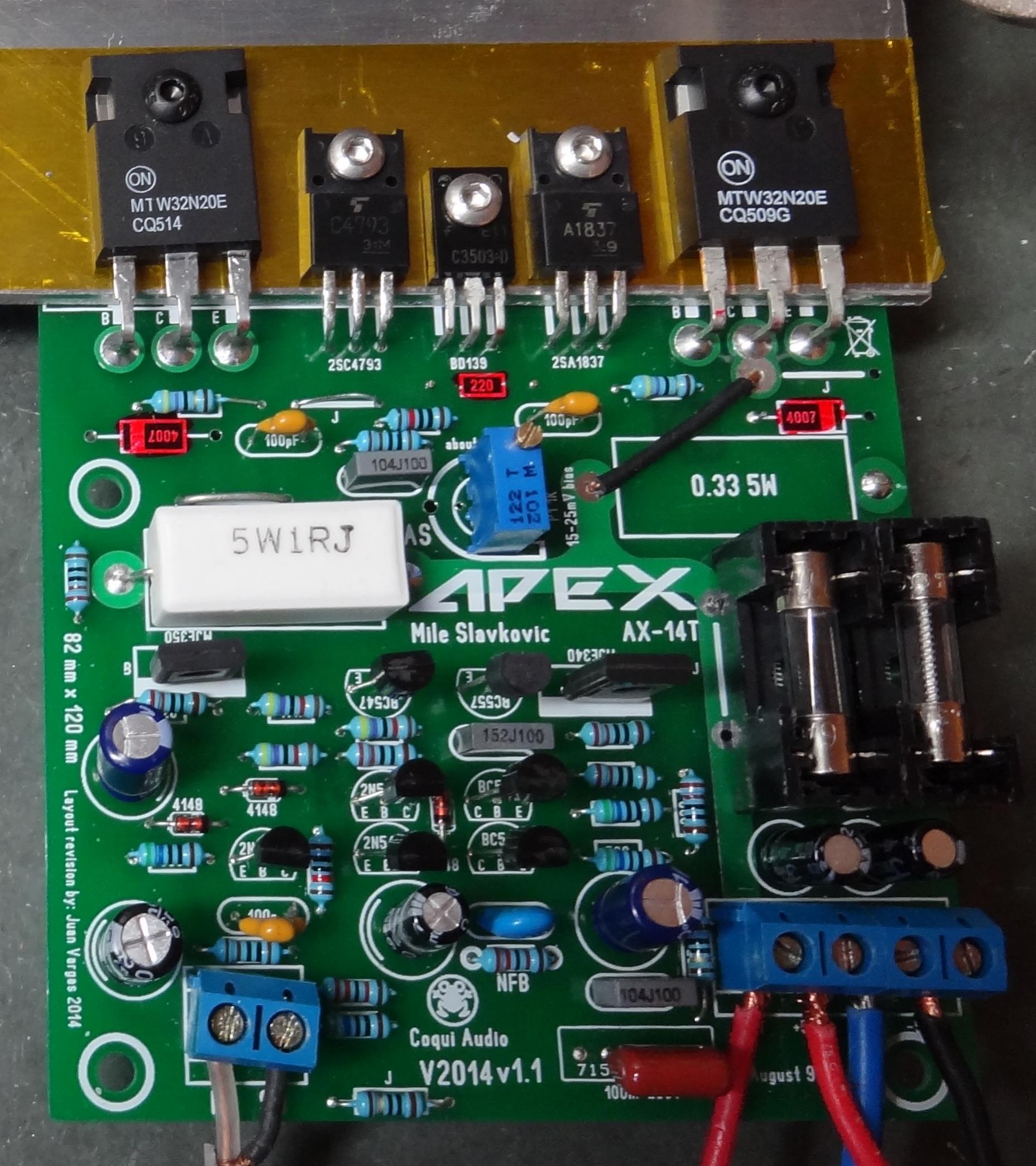

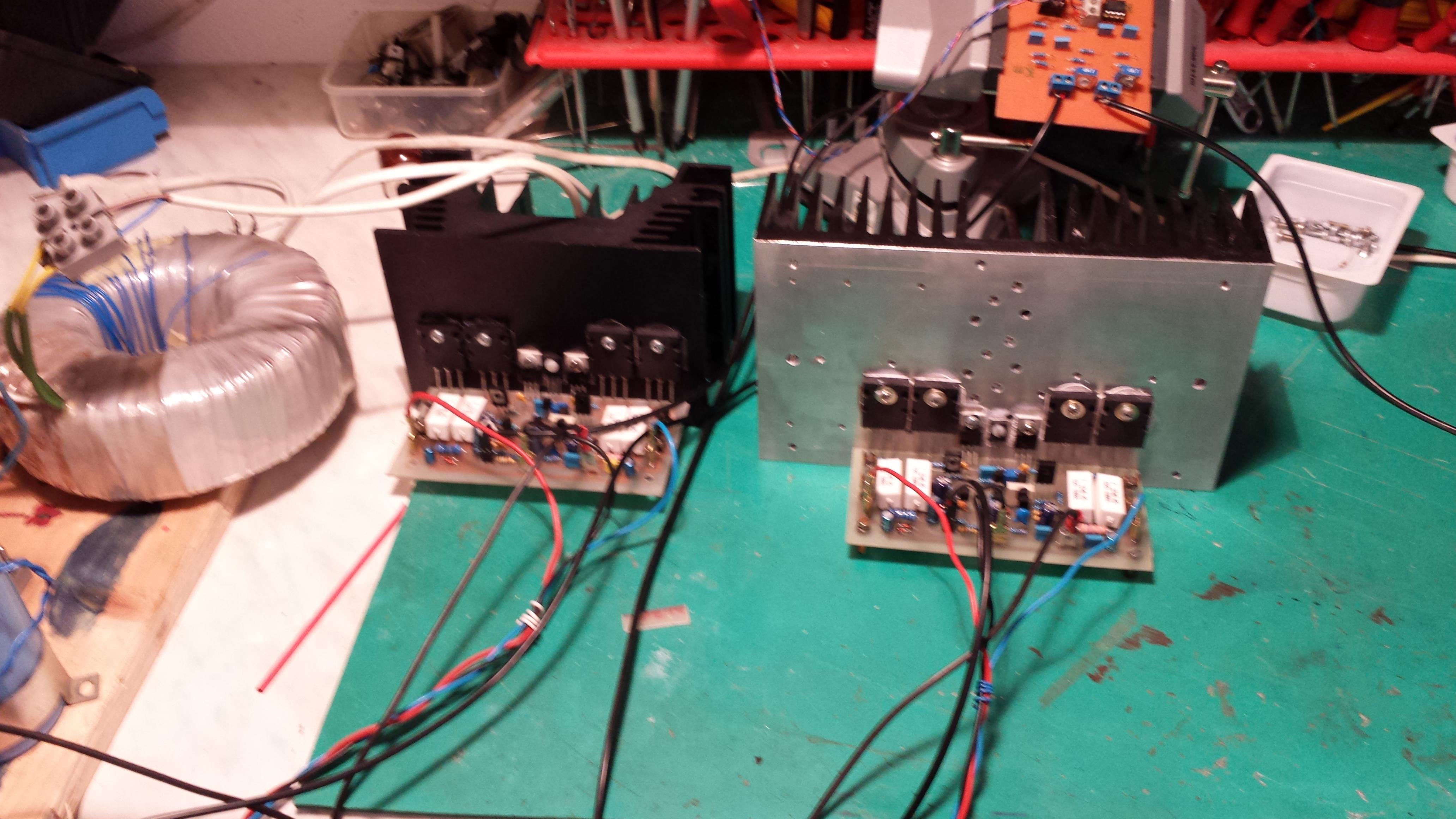

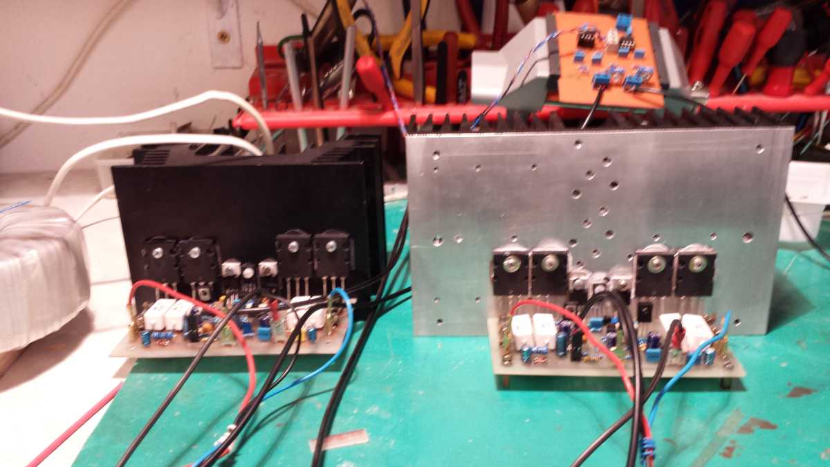

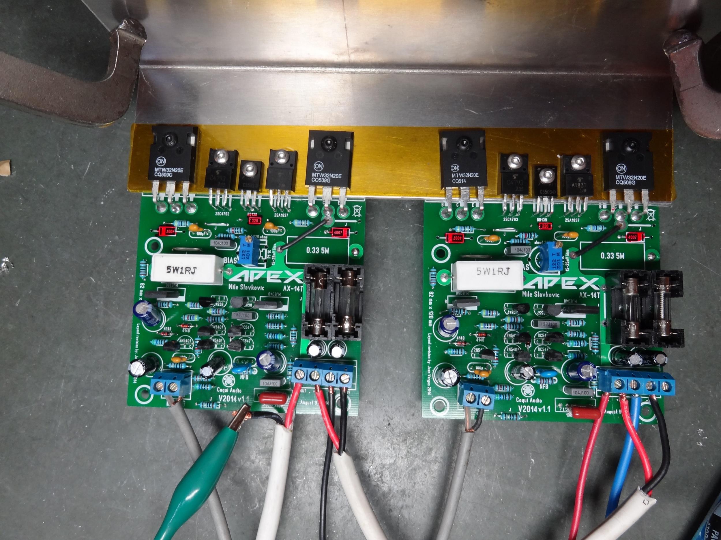

Meet the NX-14 using On-Semi MTW32N20E MOSFETs. I have the bias set to 100mA and it sounds really nice. Here are some pics of the top and underside so you can see the mods I needed to make to the boards to make the layout match the schematic. So now I've done AX-14, SX-14, NX-14 and AX-Slewmaster. I can't think of any other ways to use the boards aside from maybe different outputs.
Blessings, Terry

I'm not sure if On semi makes these anymore. I got them a few years ago to use in my Aleph-X. They didn't make a complementary P-channel device so I have kept my eyes pealed for an amp that used only N-channel so I could give them another try. I was excited to see this design come along. Sounds really good.
Blessings, Terry
