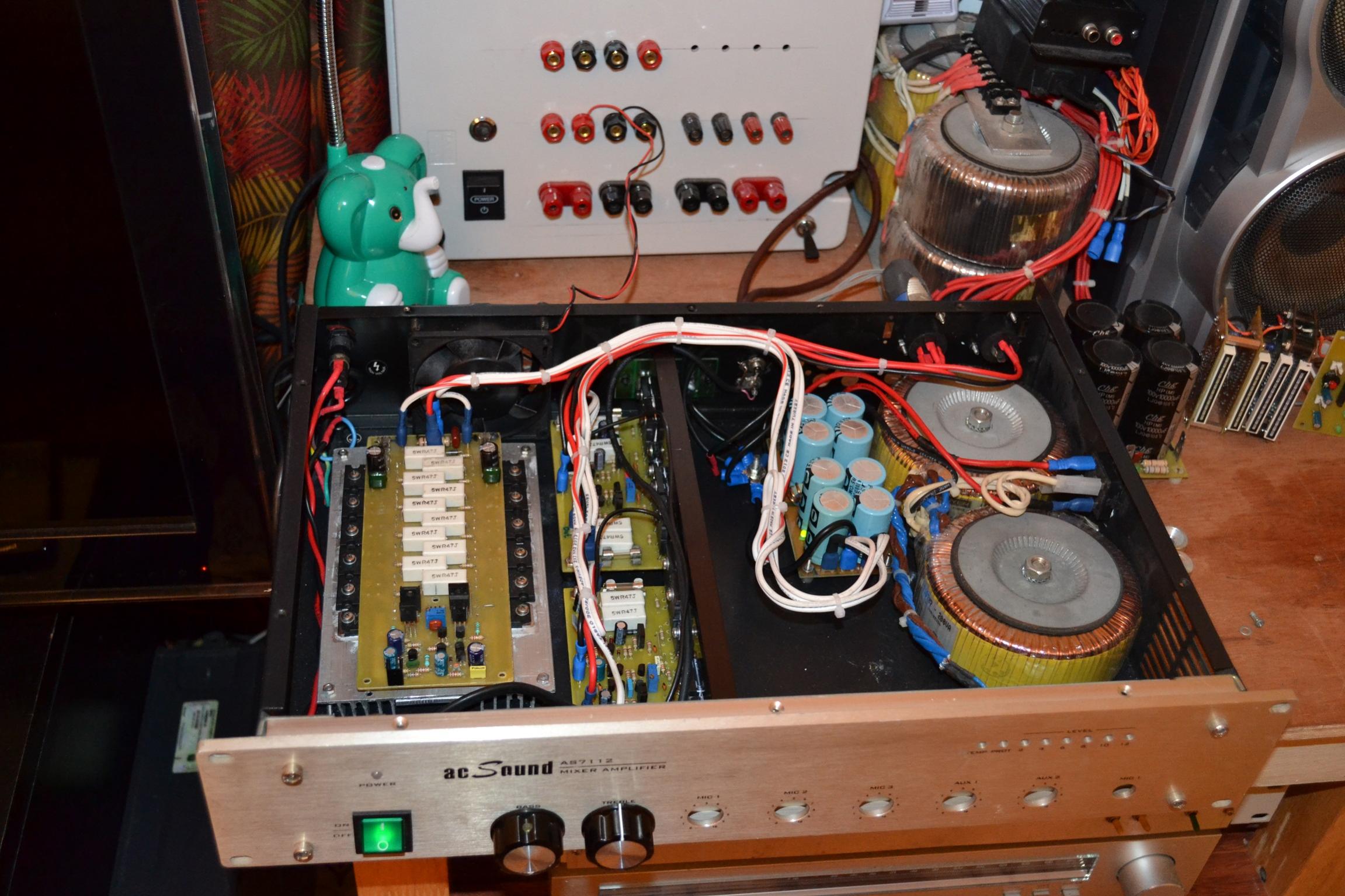

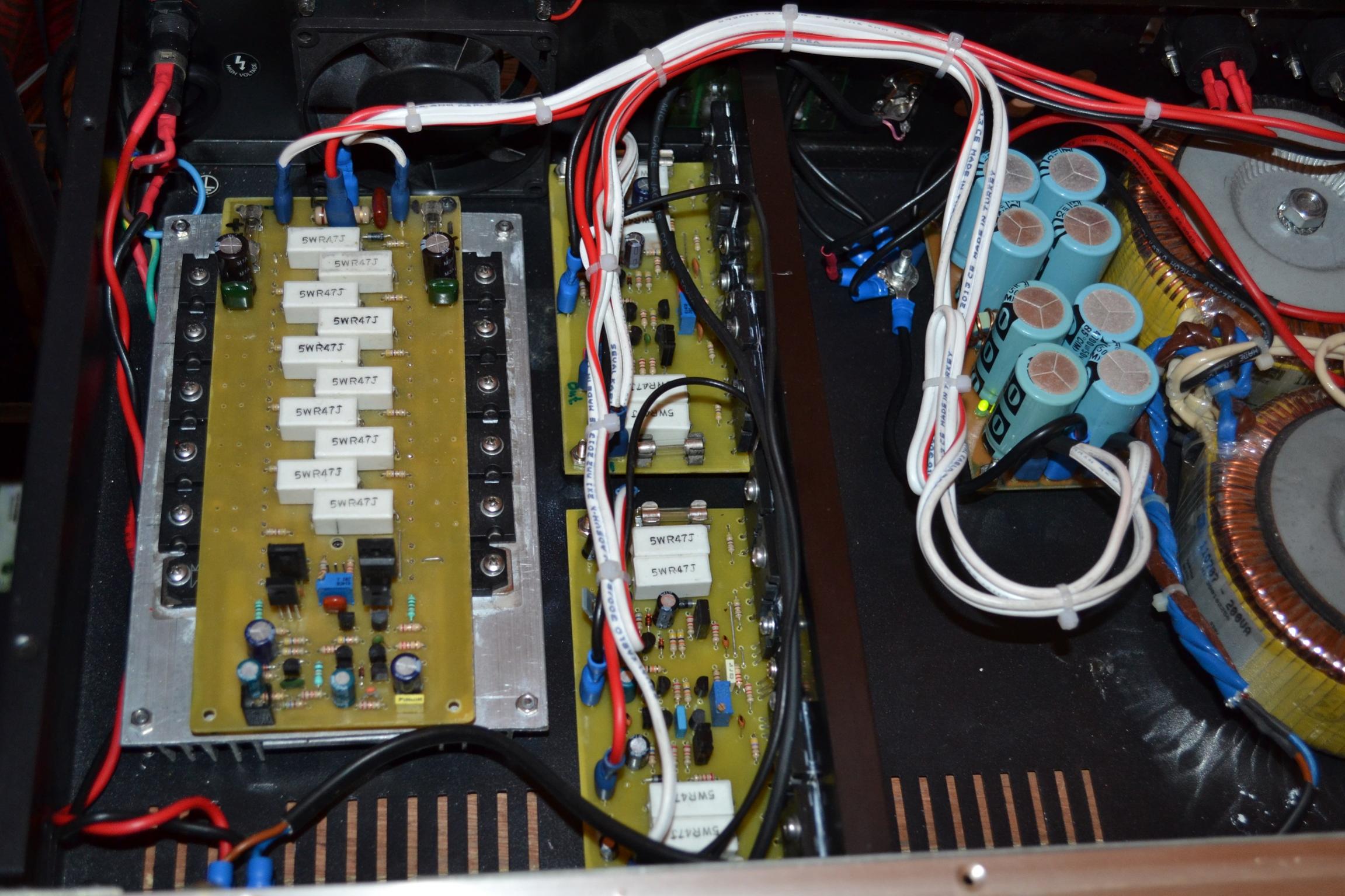

Beautiful ,congratulations!Stereo AX-14 2 pairs for clarity and AX-20 5 pairs for bass...

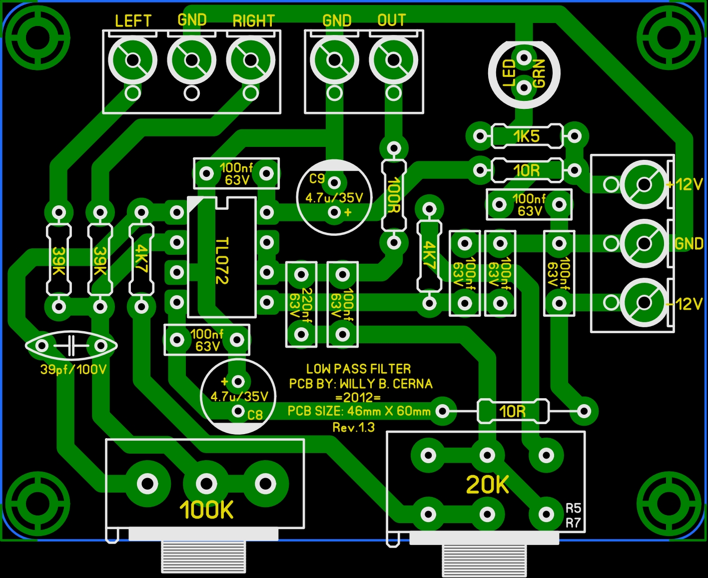

Nice work, is there activ x-over in your amp?
Thanks..Beautiful ,congratulations!
Thanks and Yes Mr. Mile see attached..Nice work, is there activ x-over in your amp?
Hey wow Willy that looks fantastic !
Regards
Juan
Thanks bro...

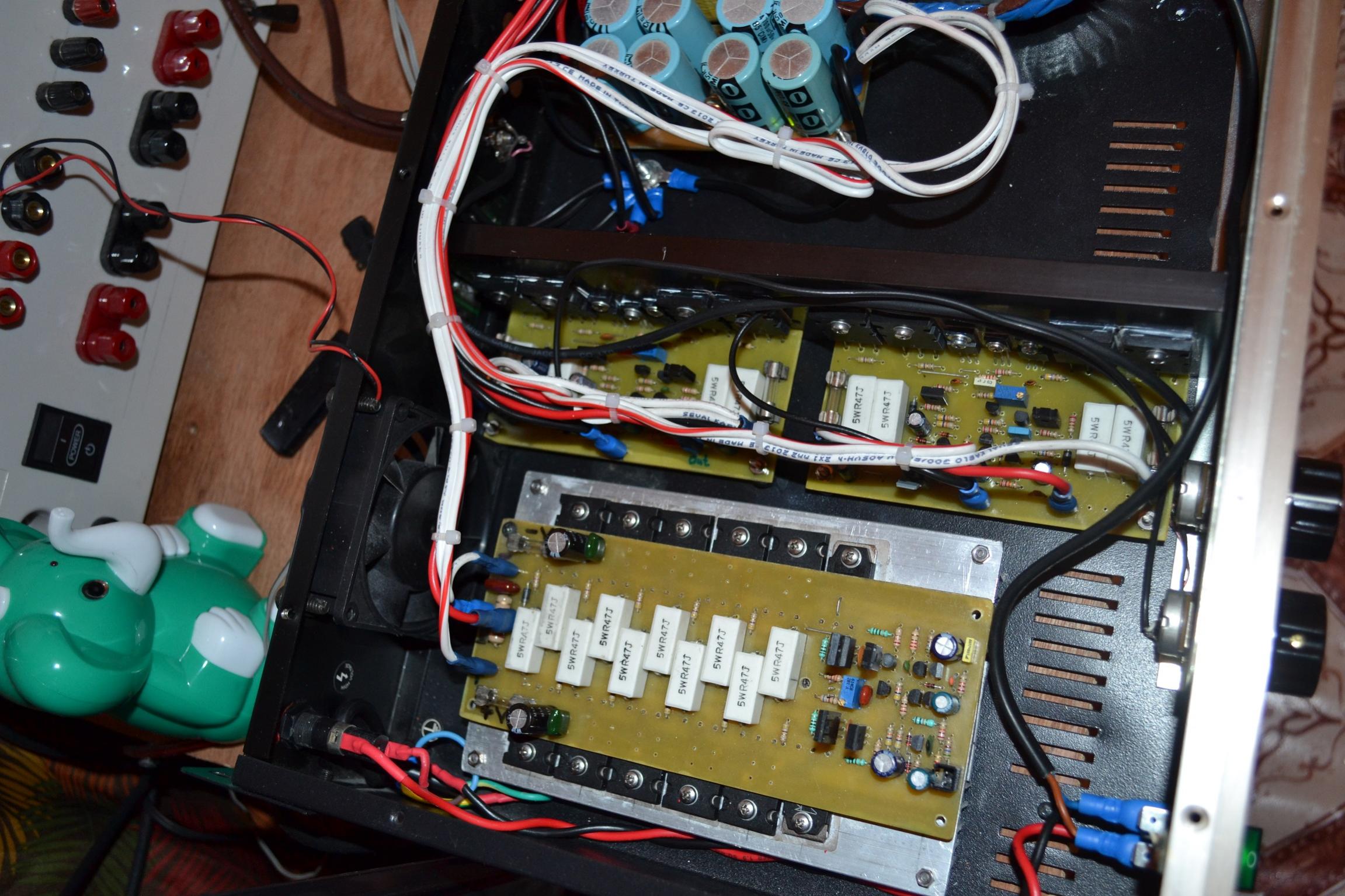

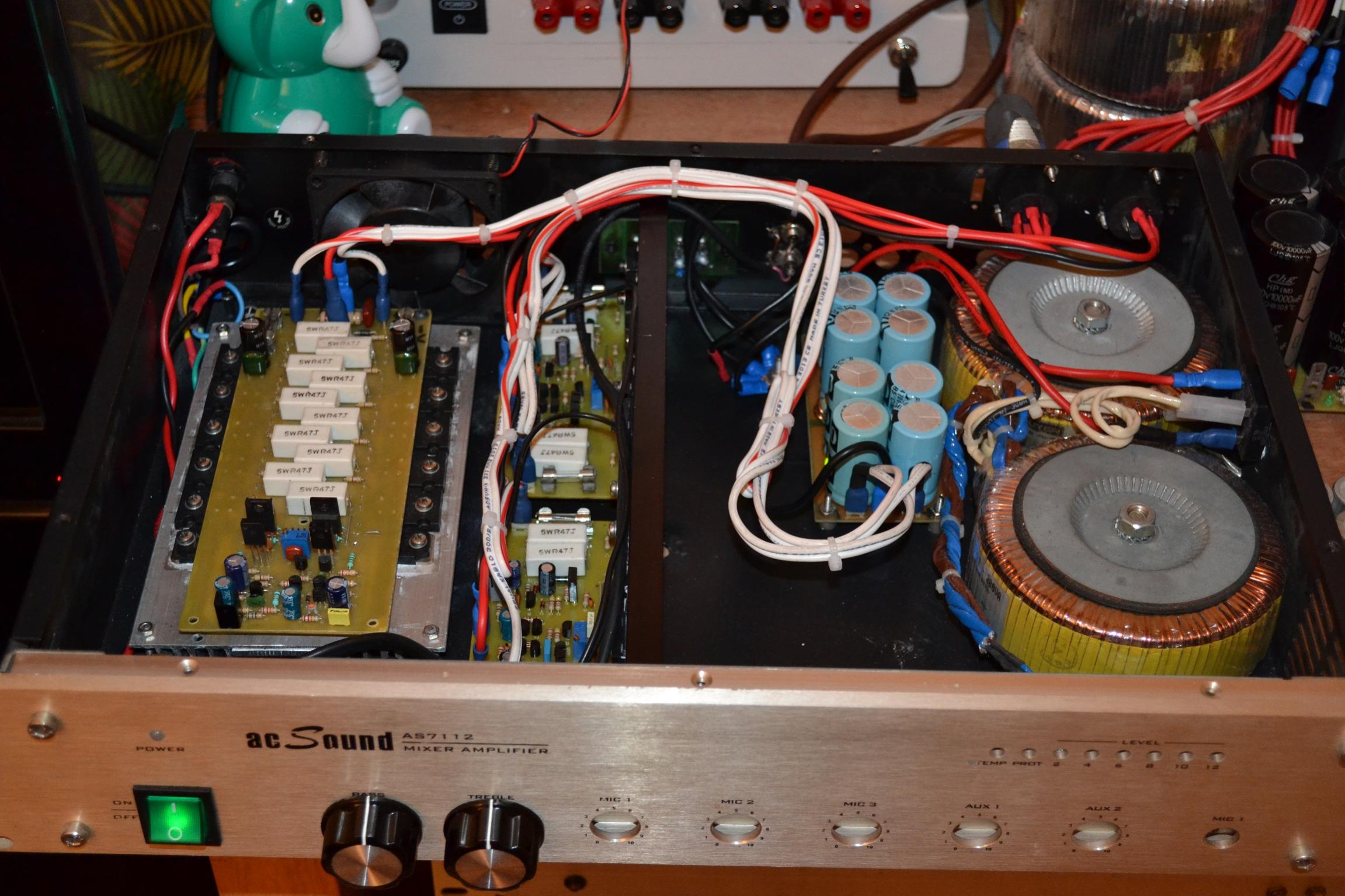

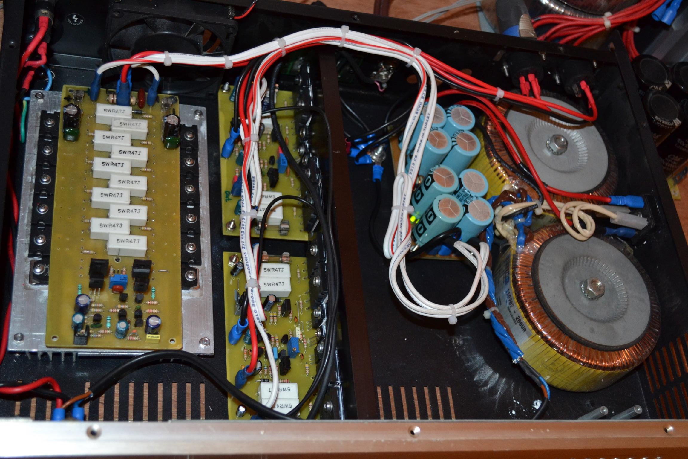

Wow! Does that 5P stay cool enough laying flat inside that enclosed case? What kind of bias are you running on it? Is there a heatsink on the two 2 pair units?
Thanks, Terry
one fan pulling the heat to outside. i think one fan is not enough
hi wiilj did u load at full volume? what is the heatsink temperature?
I didn't tried it yet in full volume and heavy used or for a battle, I just set this in minimum bias settings around 14mV across .47R/5W just enough to handle the heat of my small heat sink, temp is about 25-50 deg. about half way volume, my room and glass window is vibrating so much if crank up the volume so I just use this in normal purpose only just to enjoy the sound quality of this amp and my electronics hobby...
Well, optimal bias is not really related to the output power. It is set with the lowest x-over distortion in mind. 14mV across .47R gives us roughly 30mA, which is suitable for CFP output topology, but not enough for EF output stage, where some 70-90 mA would be the optimum. Even if you use it at the power of couple of watts. An under-biased output stage will give significant distortion increase at low power.

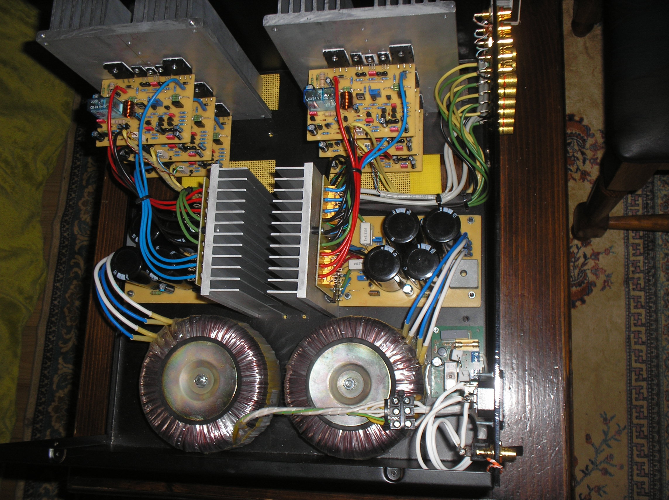

I made this amplifier for test my home DIY speakers (two way TL).
