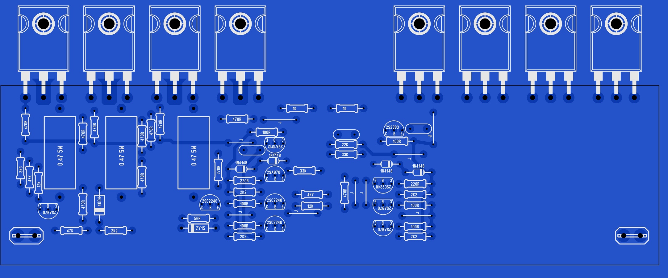

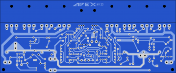

thanks Terry :up: I have another project that I wan to try out too I'm just re-drawing Apex HV23 this can be interesting :):bulb: I never try mosfet amplifiers before
note: don't mind about "CBE" on the TO-92's is going to change later on :D
Regards
Juan

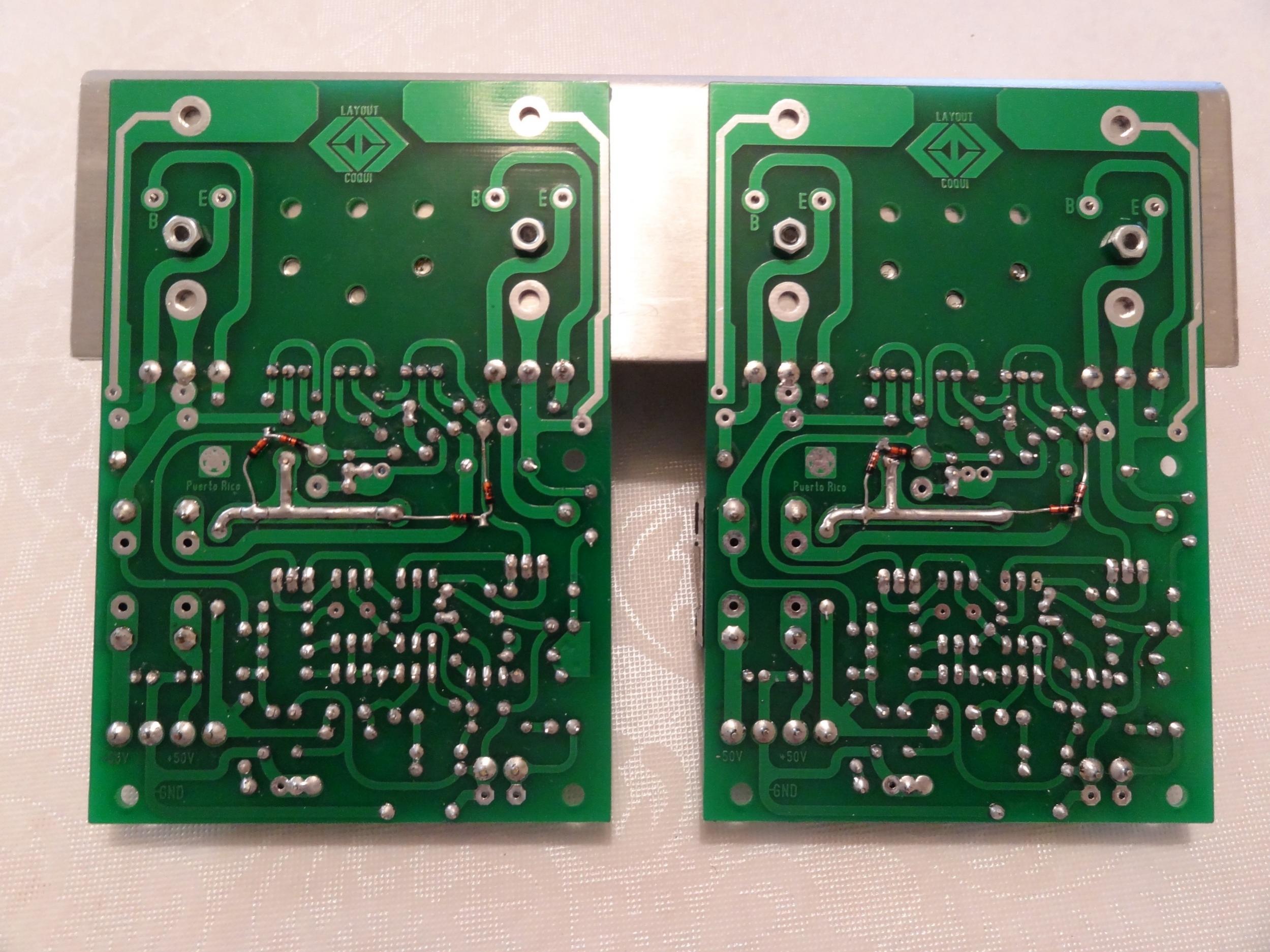

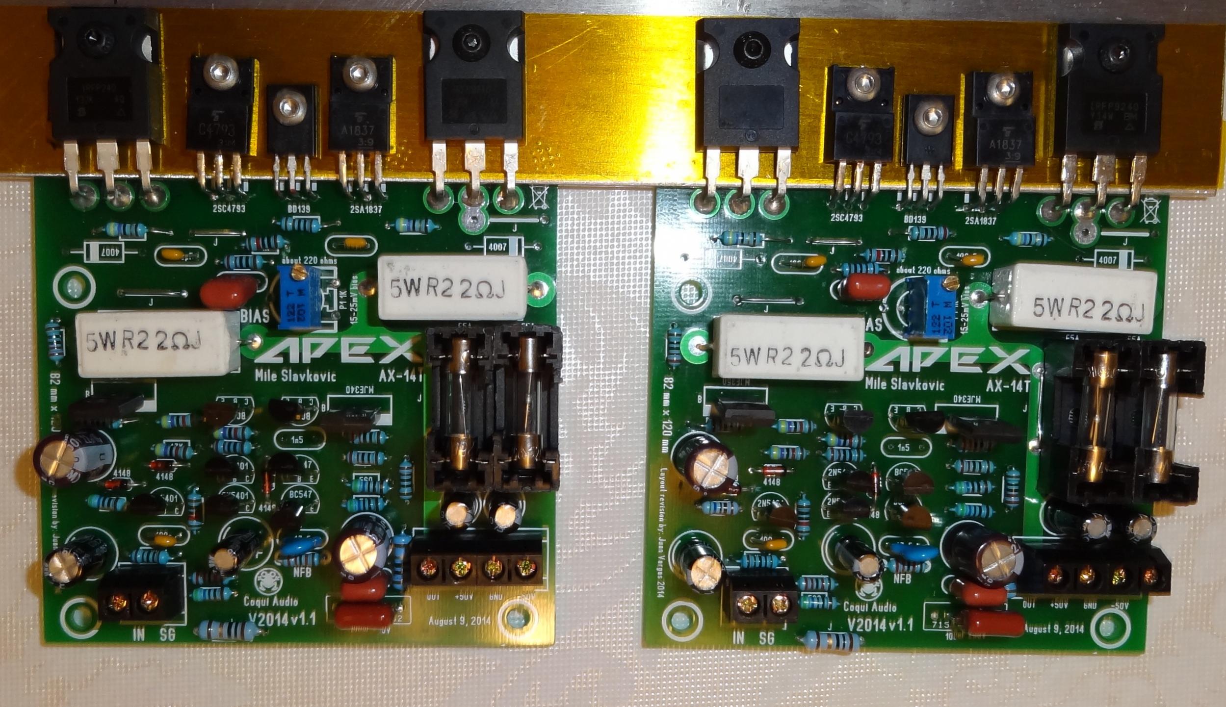

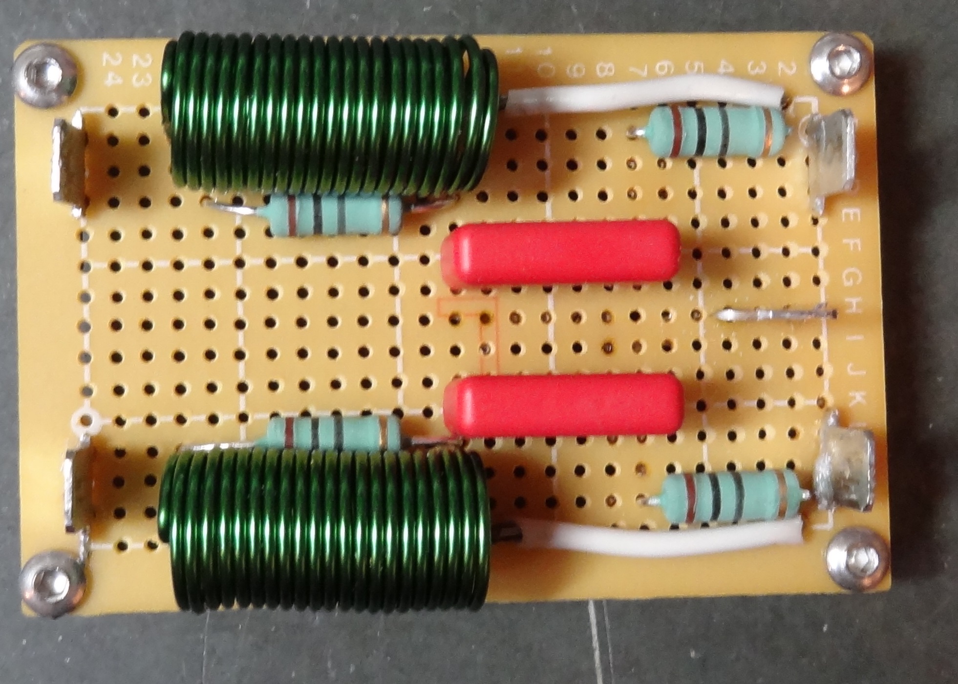

OK, so I stuffed the FX-14. Of course I'm still missing the 1n5 capacitors so I will have to wait until the order comes in. Looking forward to hearing it. The Ax-14 sounds pretty good. I did build a small Zobel network on perf-board since these don't have anything on the output. Here are some pics of the FX.
Blessings, Terry

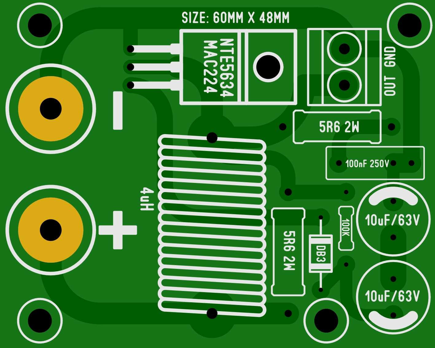

Terry I have the PCB for the protect and coil I made it a few months ago for example binding post of this type on the images, by the way nice coil solution looks great :D
hey about the zener I think I might be able to relocate them to have on top of the board I will see if I can do it either way your way to do it is fine :D
Terry what is the part number of that yellow insulator you are using I have see it a few projects of yours :)

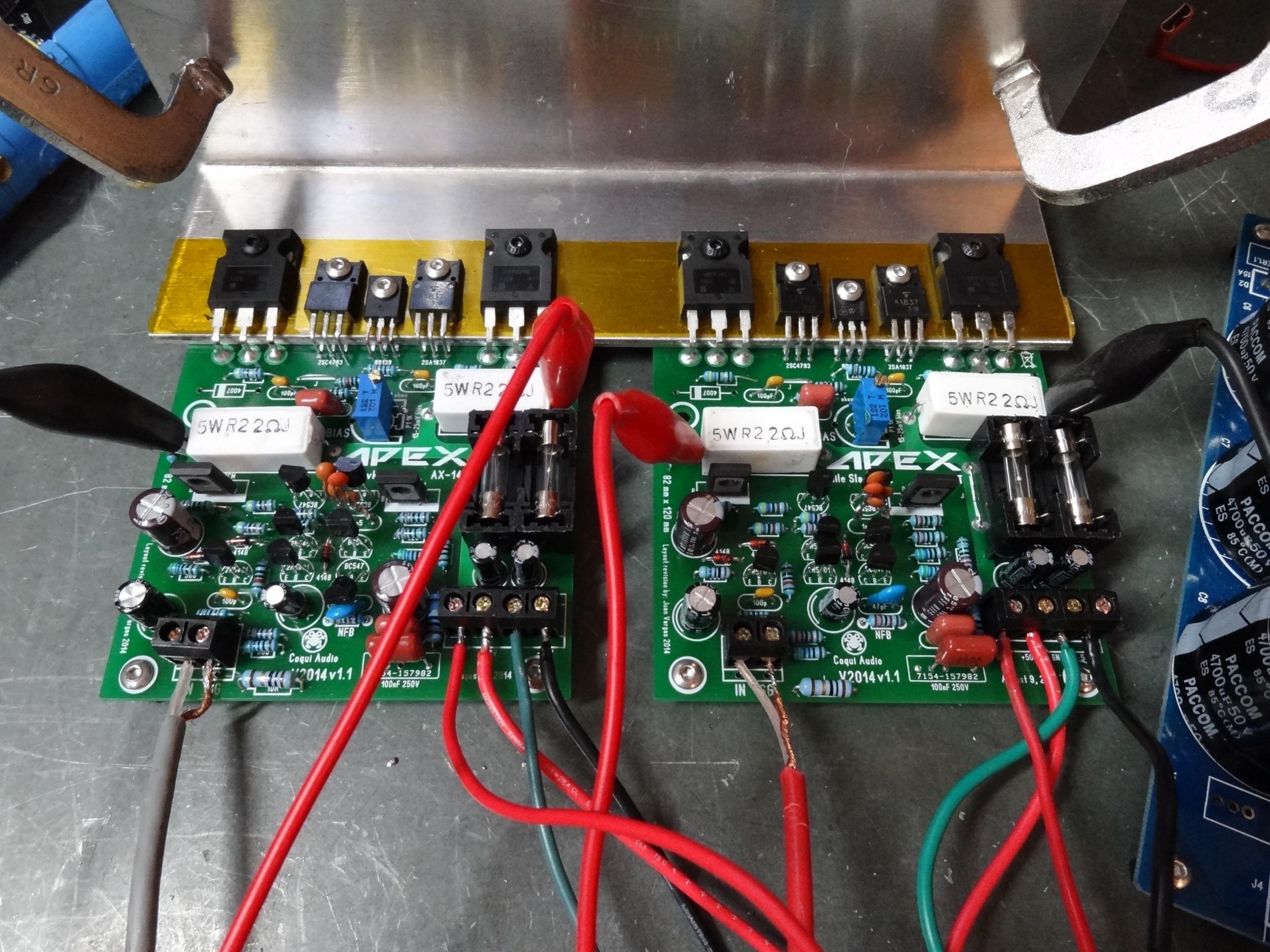

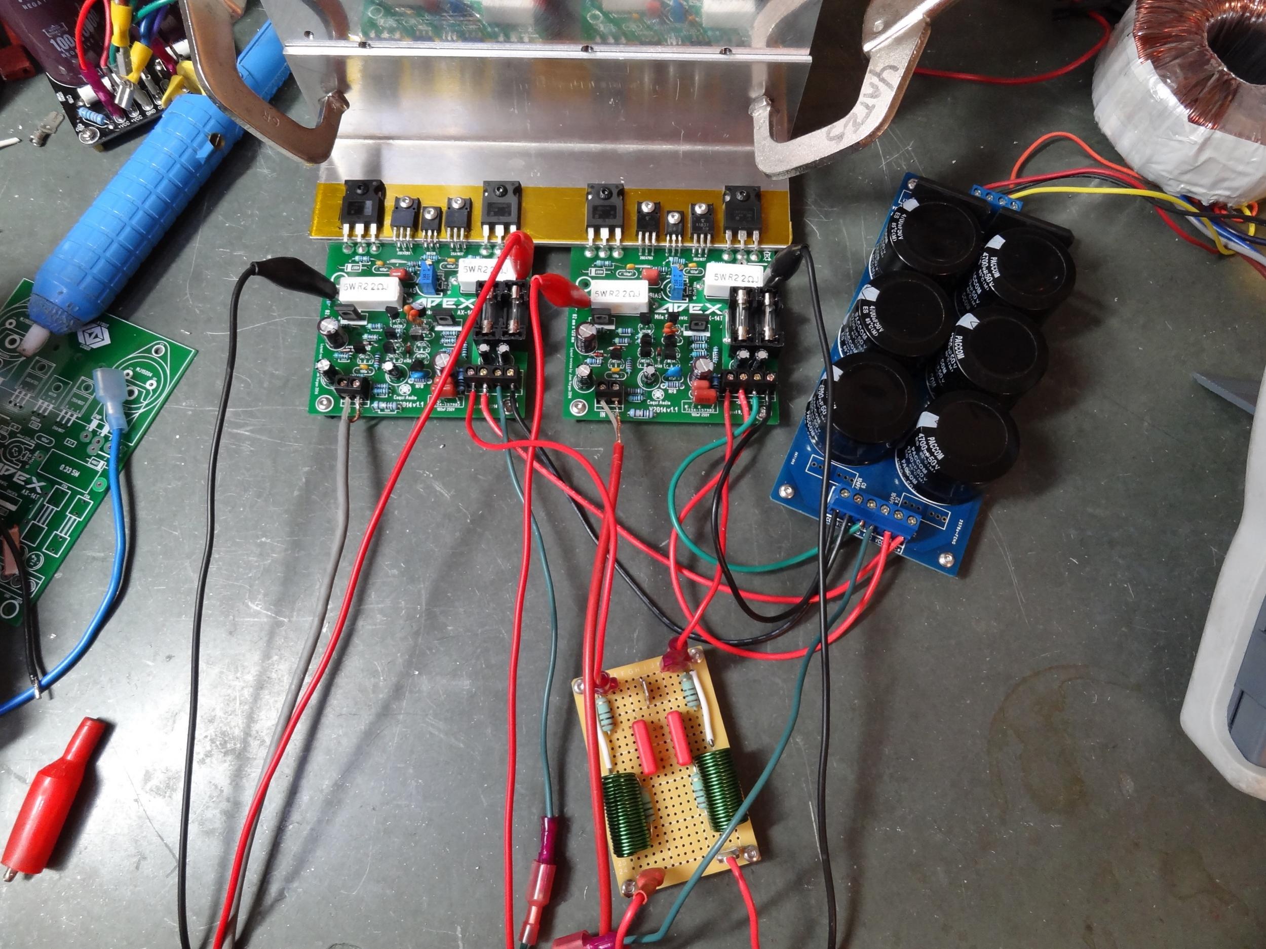

Well of course I couldn't wait for the parts so I stacked a bunch of ceramic caps to come up with the 1n5 caps I needed. I'm kind of glad I did. This thing sounds really nice. I have been A/B'ing it against a few amps and it's holding its own pretty well. I will try to find time to hook up the TO-3 version so I can A/B them together. Right now I'm pretty impressed with this MOSFET version.
Blessings, Terry

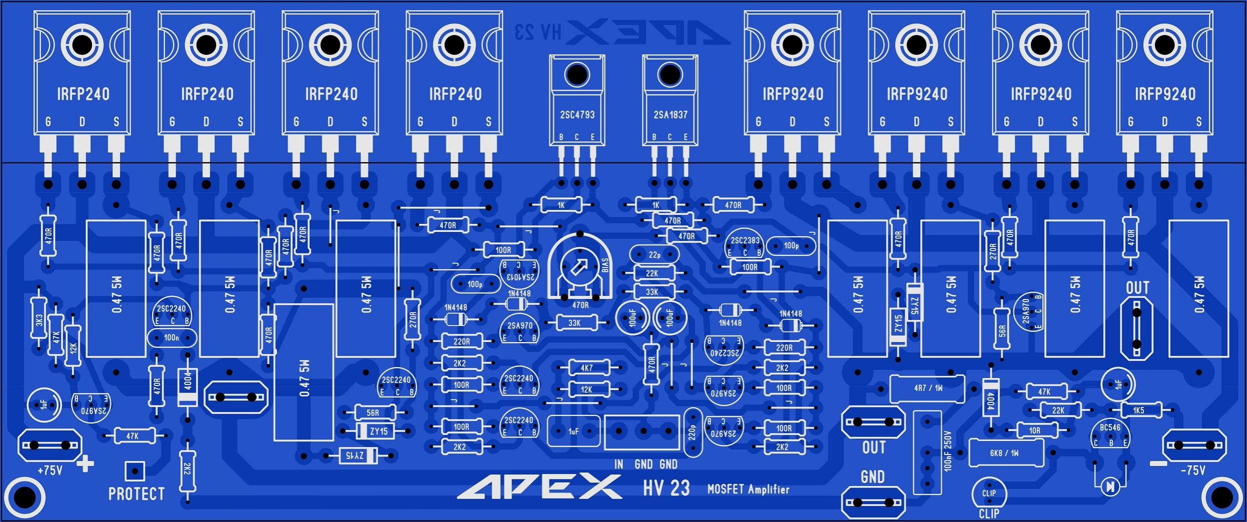

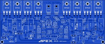

I'm really happy that you got work it with mosfet version a amazing :D how is the sound ?
I was about to modified the AX-14T layout but I think is not necessary as you did it under the PCB is not going to be seen any way :p, about other things I was working on the Apex HV23 a high power version I just re-drawing it and looks good I have to check if all to make sure is correct maybe later I will order some :), and yes good idea to have the mosfet and the regular in the same chassis that is interesting looking good man :)
Regards
Juan
