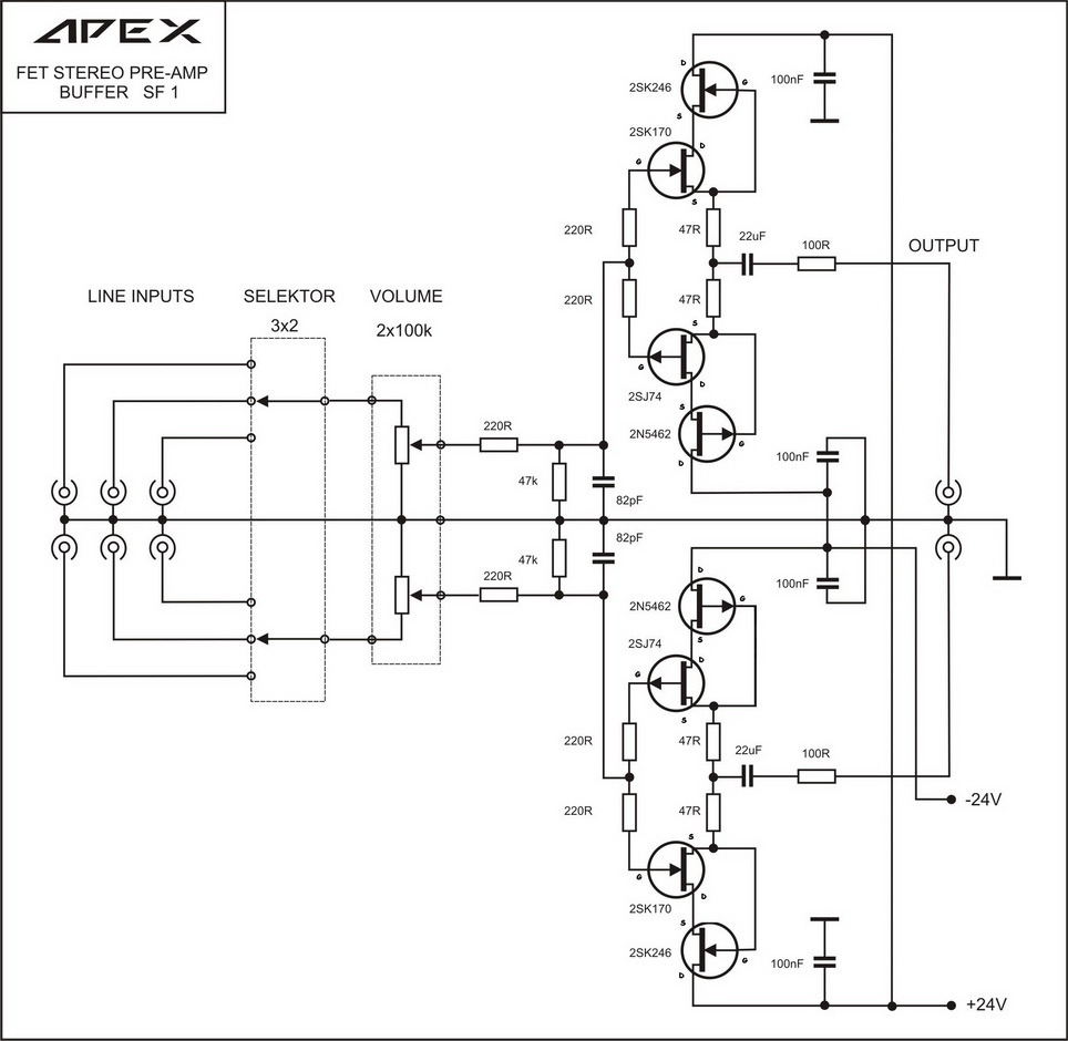

Apex Audio,
Do we really need JFETs for the CCS's on this FET buffer amp? They are hard to find or expensive. Can you suggest an alternate BJT CCS version that retains 2SK174 and 2SJ74?
Perhaps 2N5551 or 2N5401 can be used?
Thanks,
X
Thanks,
X
