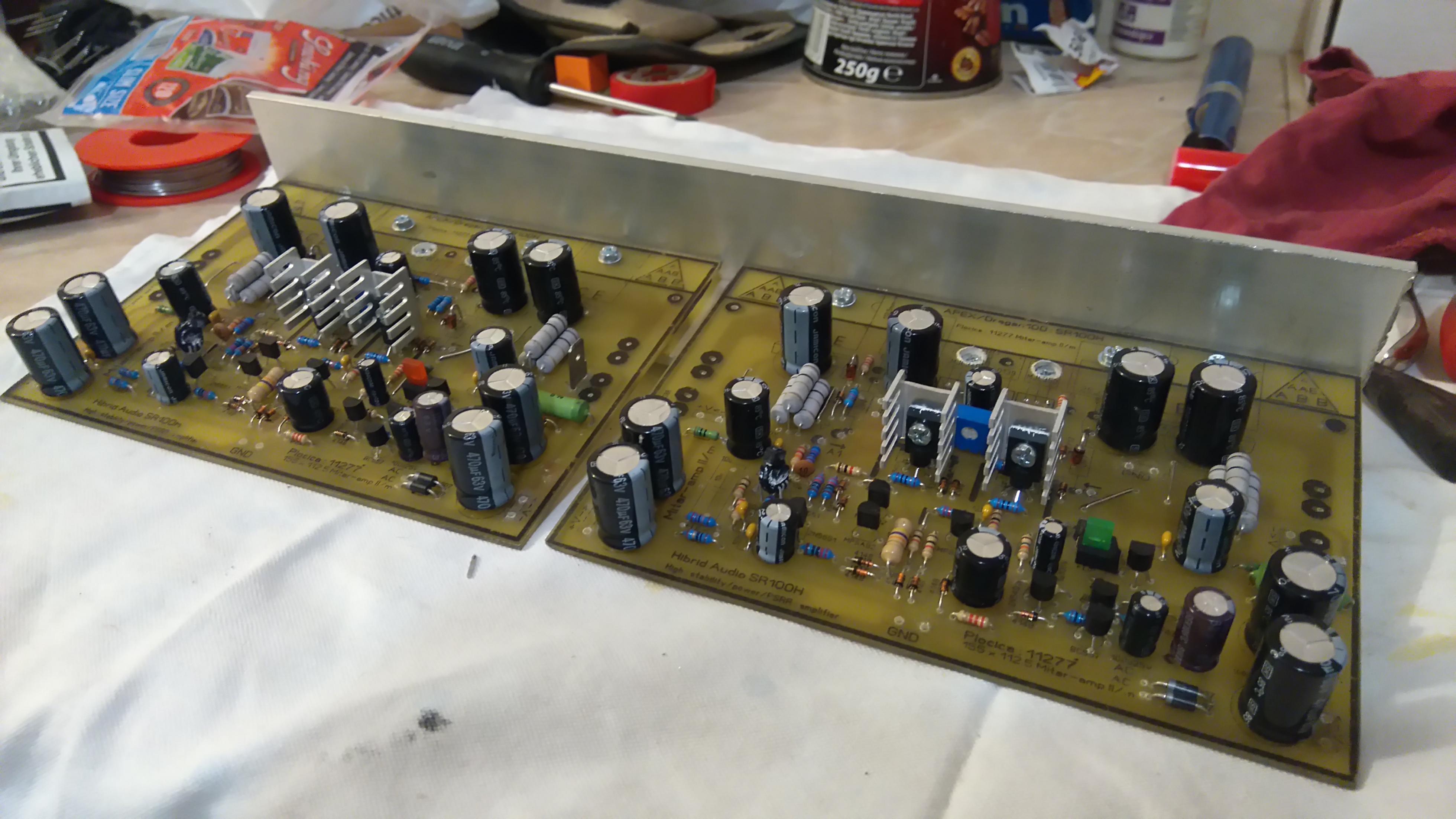

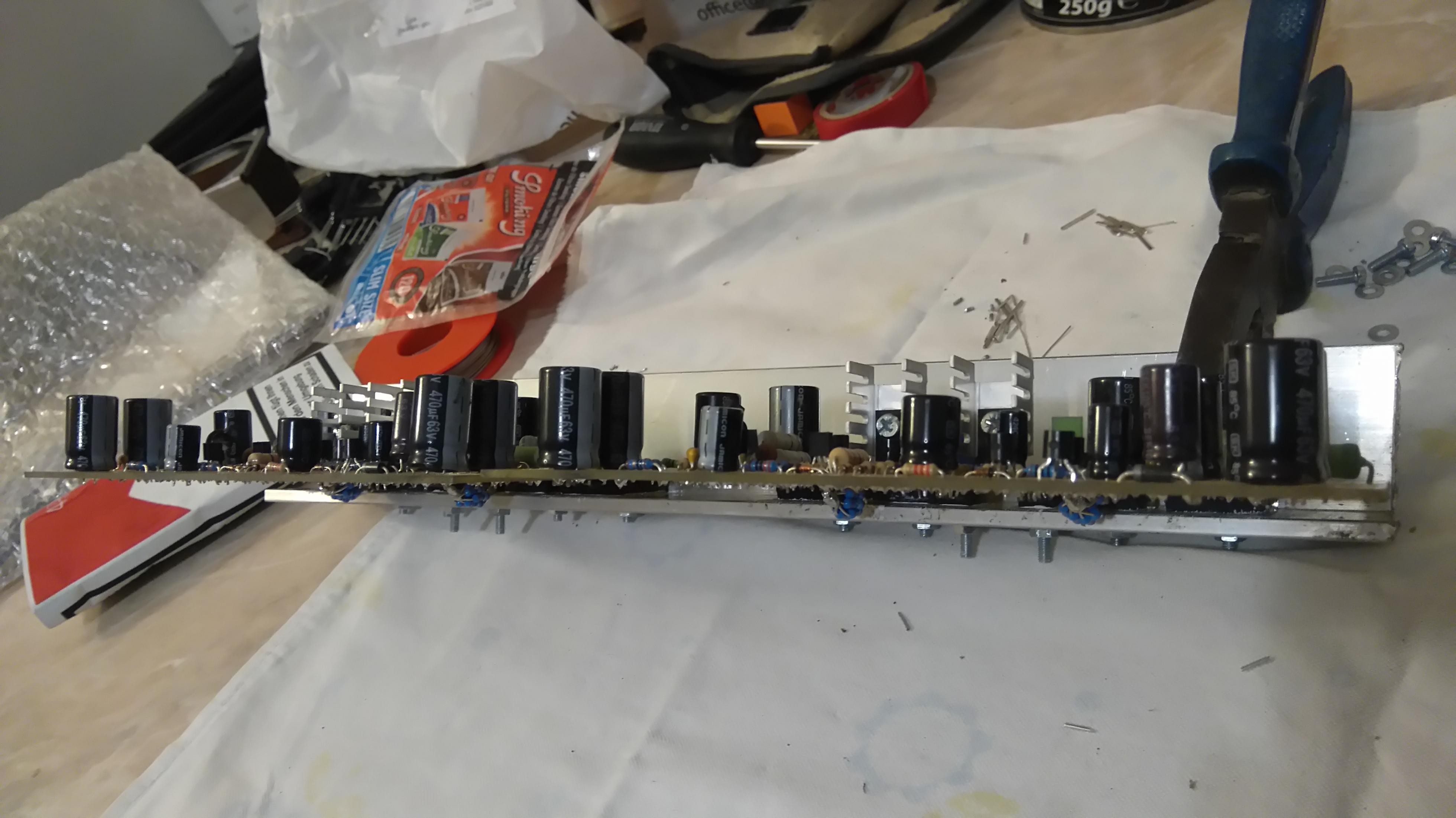

APEX/Dragan100 STUDIO SR100H(hibrid)
if i have time tomorrow i wil do first plug-in...

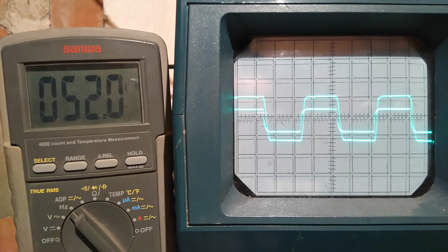

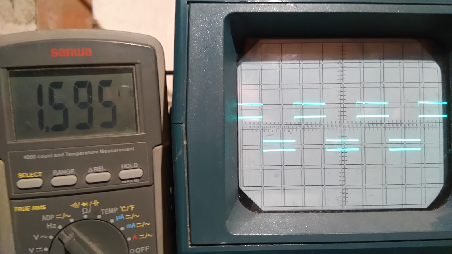

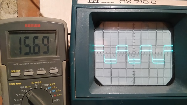

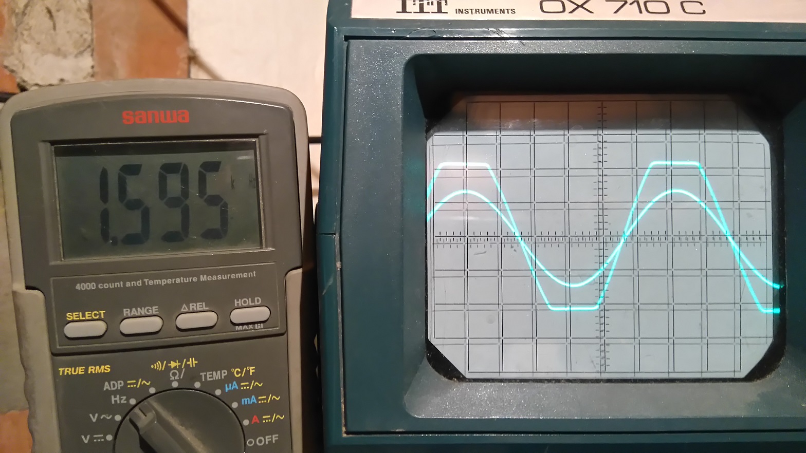

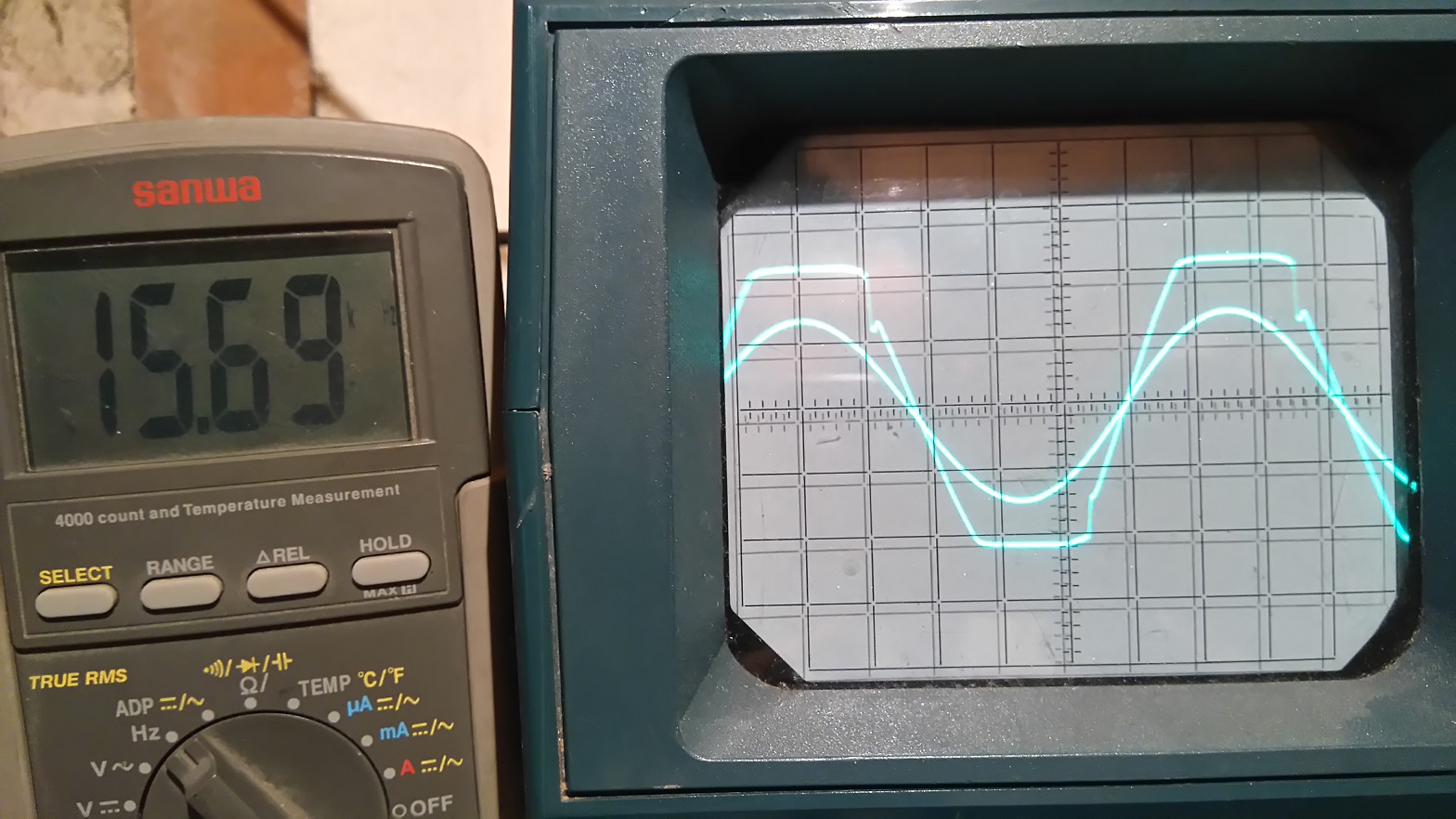

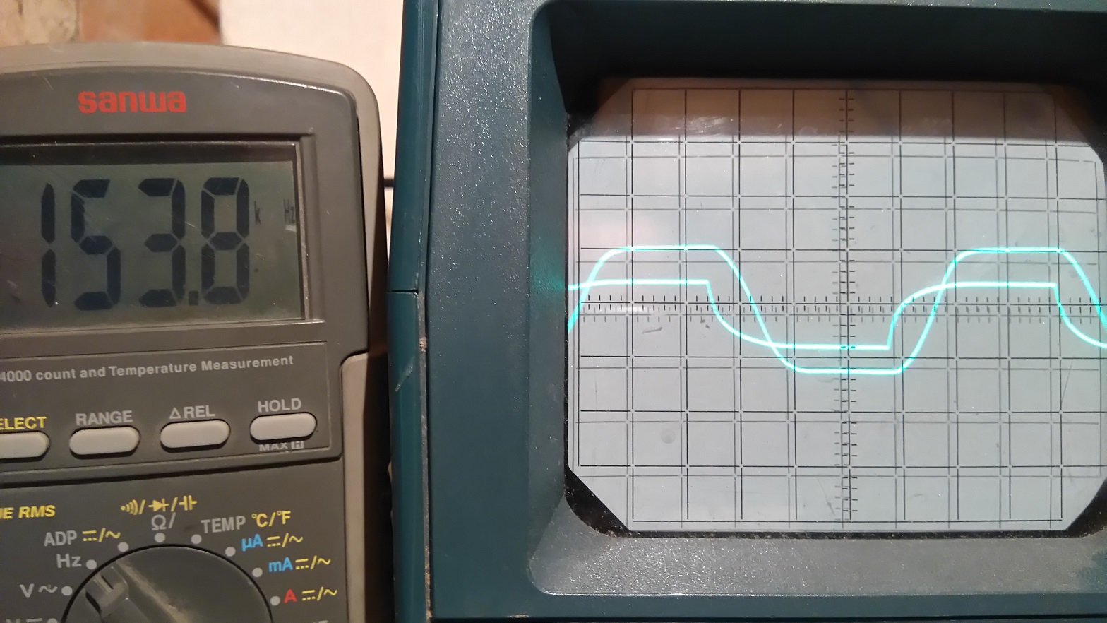

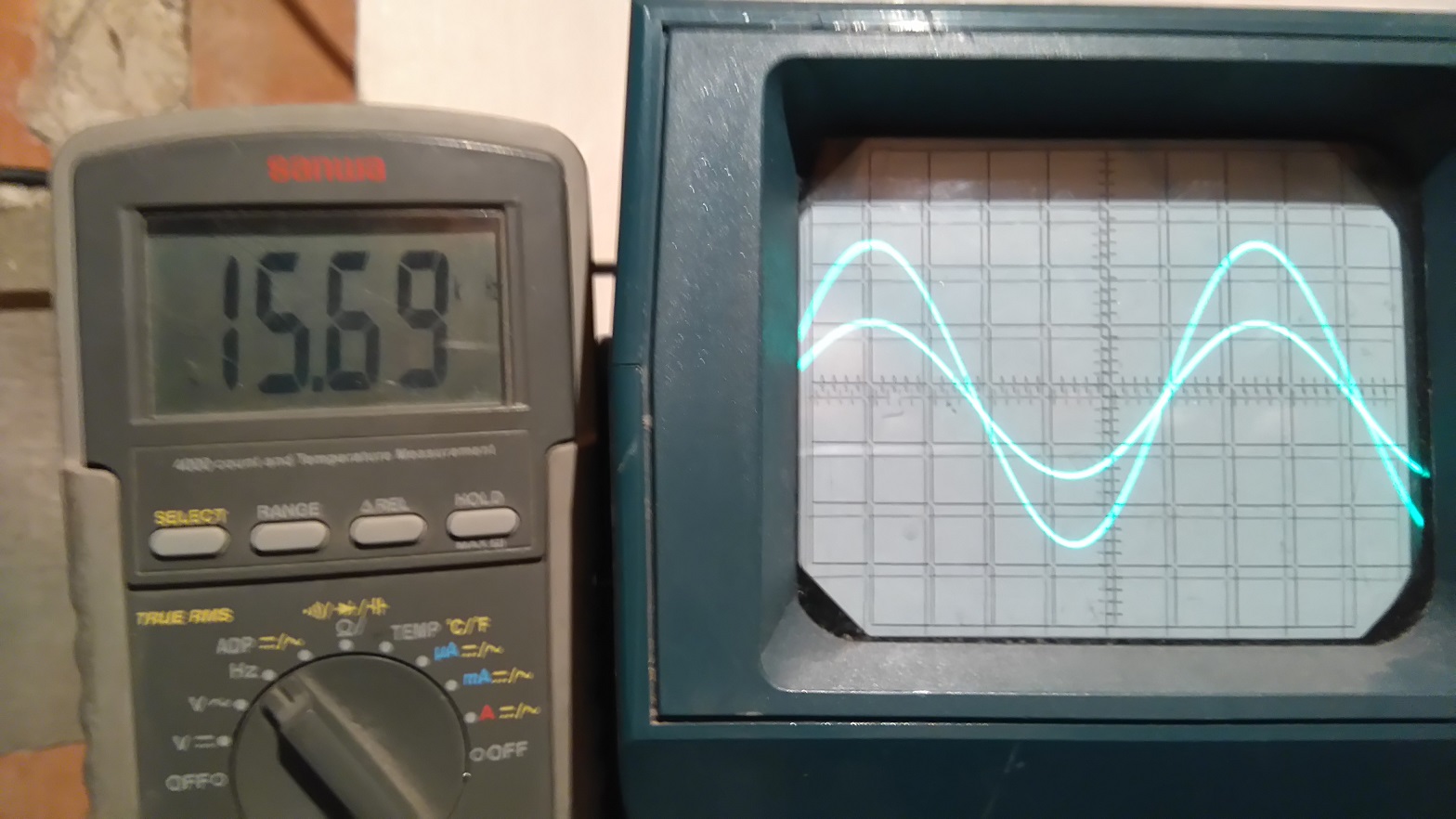

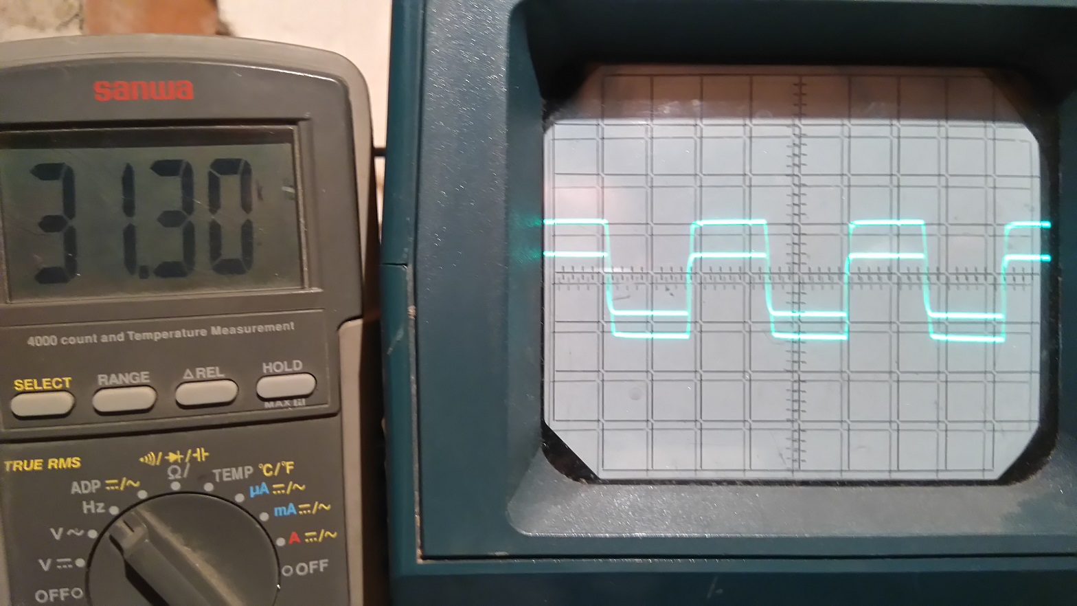

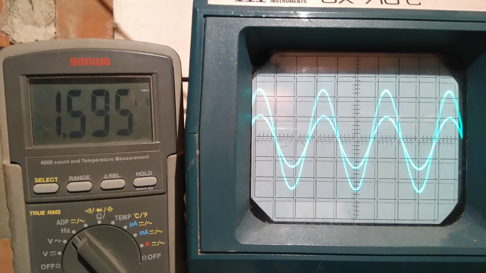

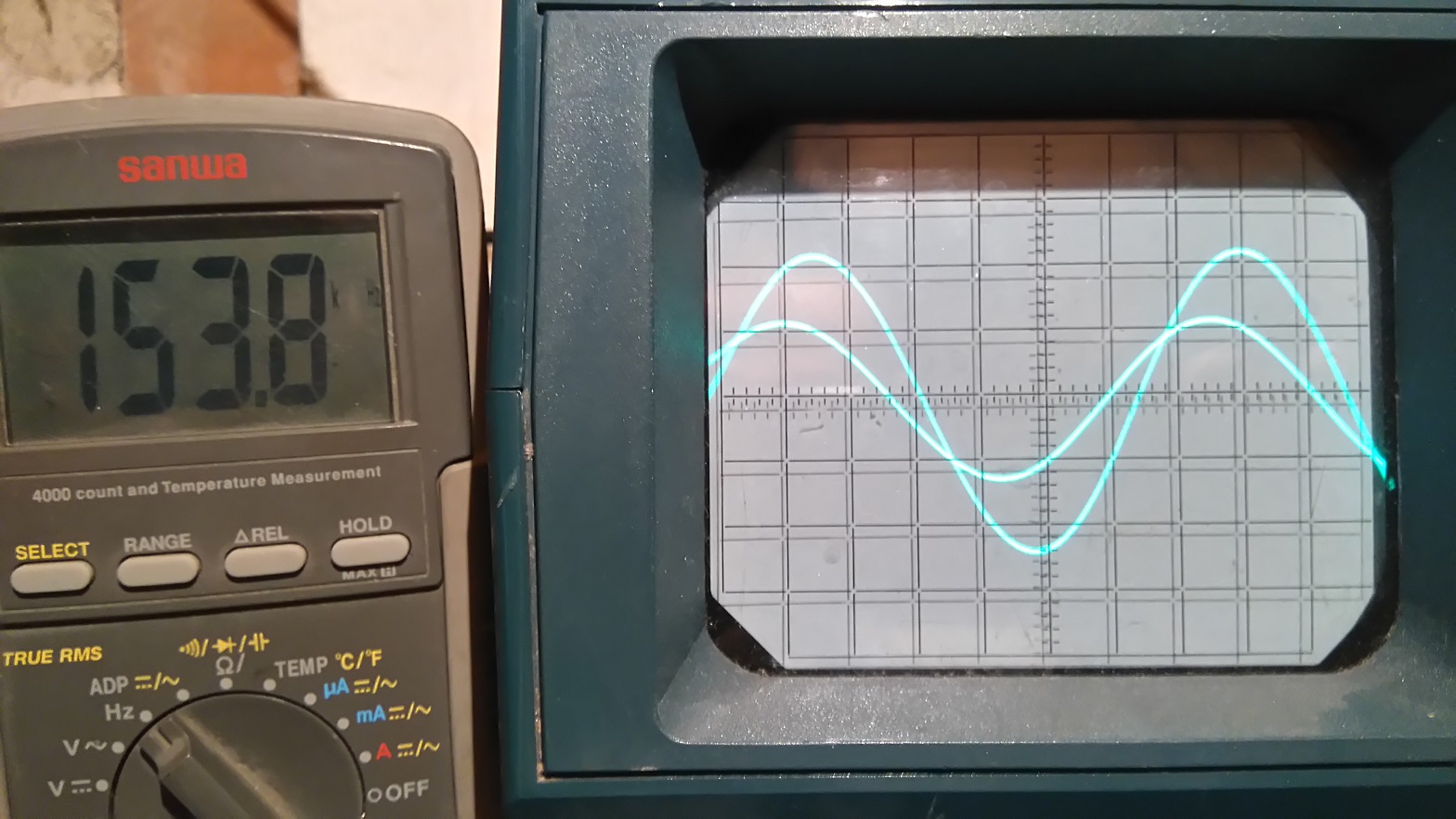

higher value is output signal (10V/div) and lower value is input signal (500mV/div).

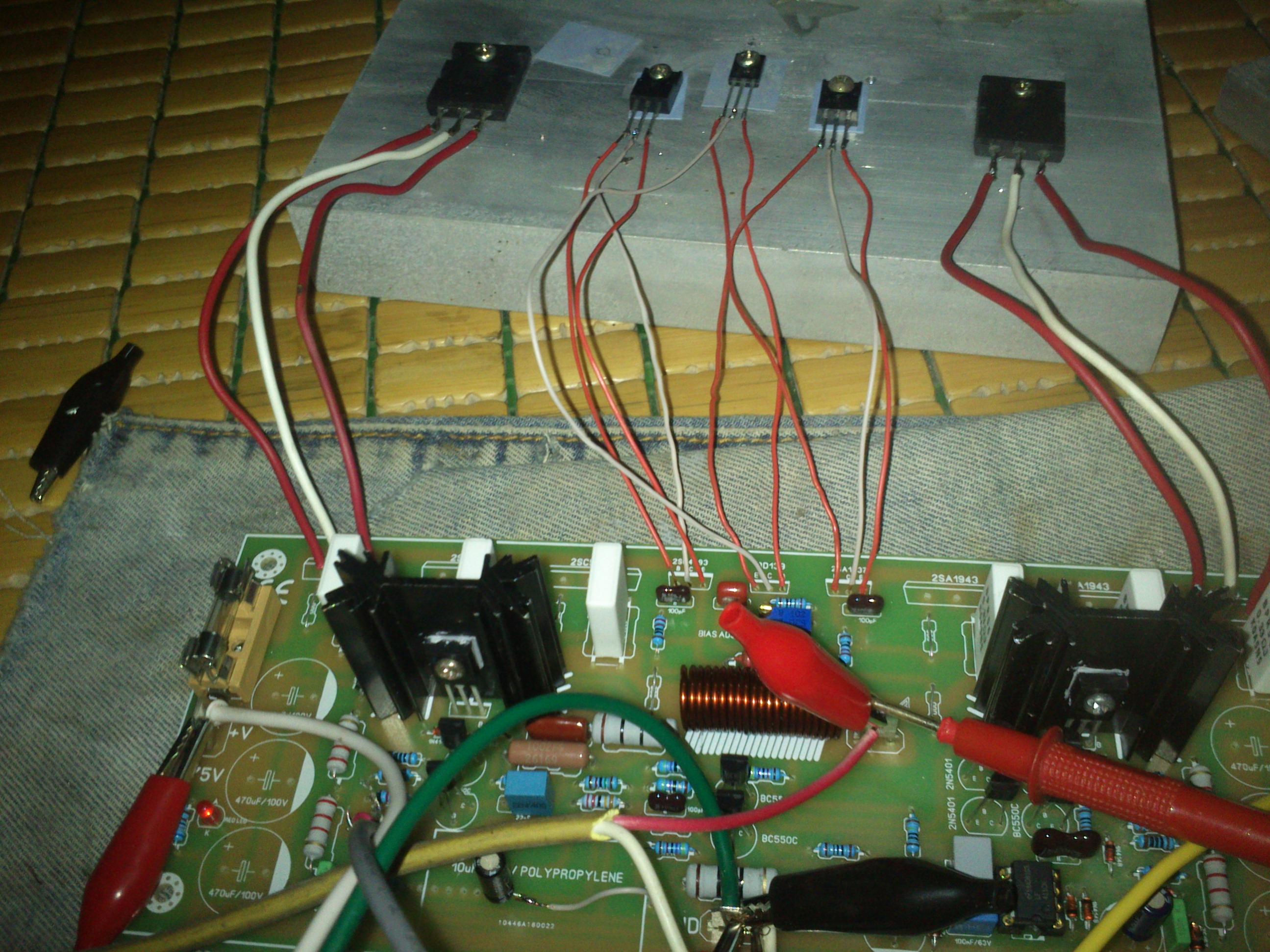

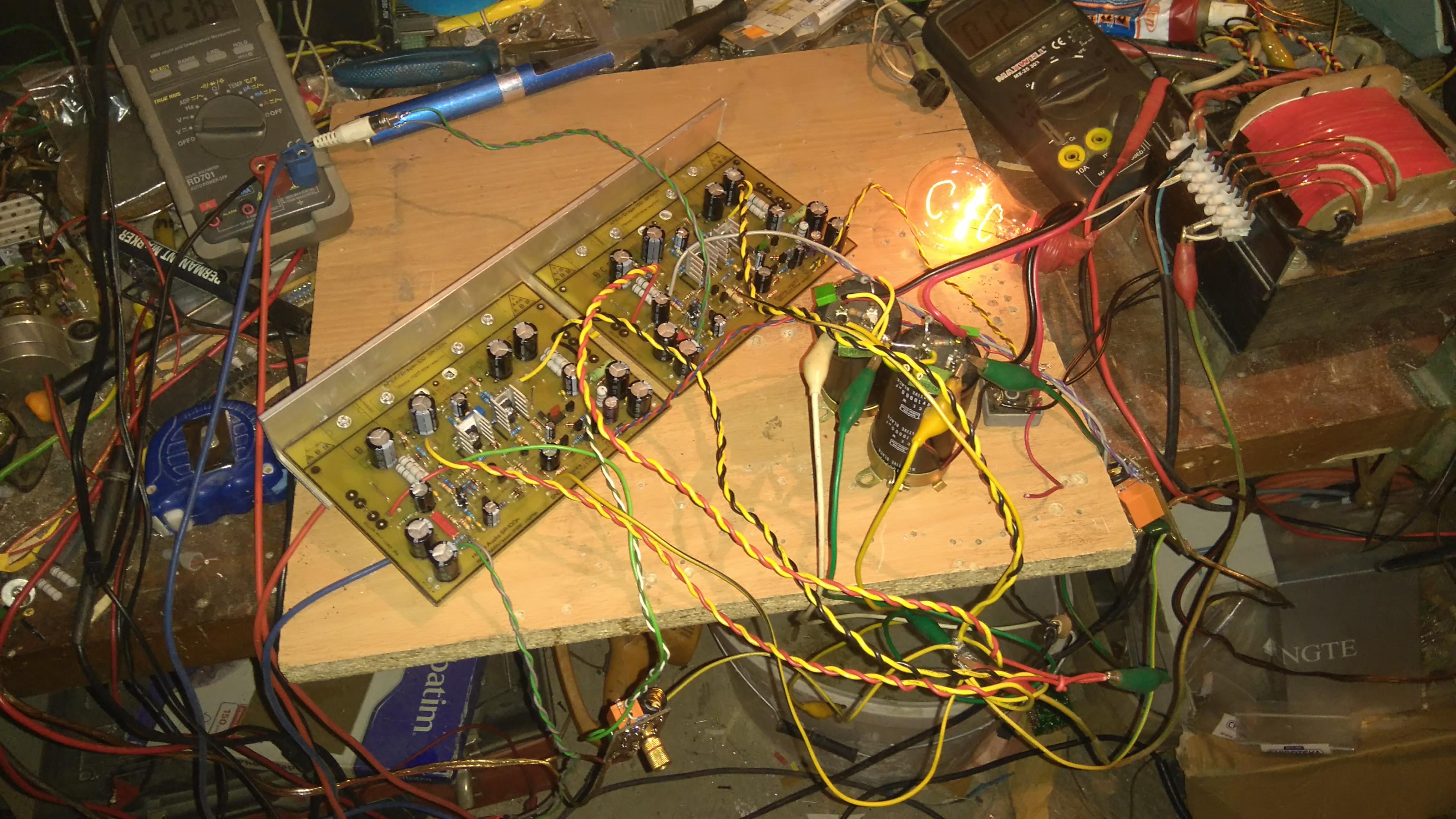

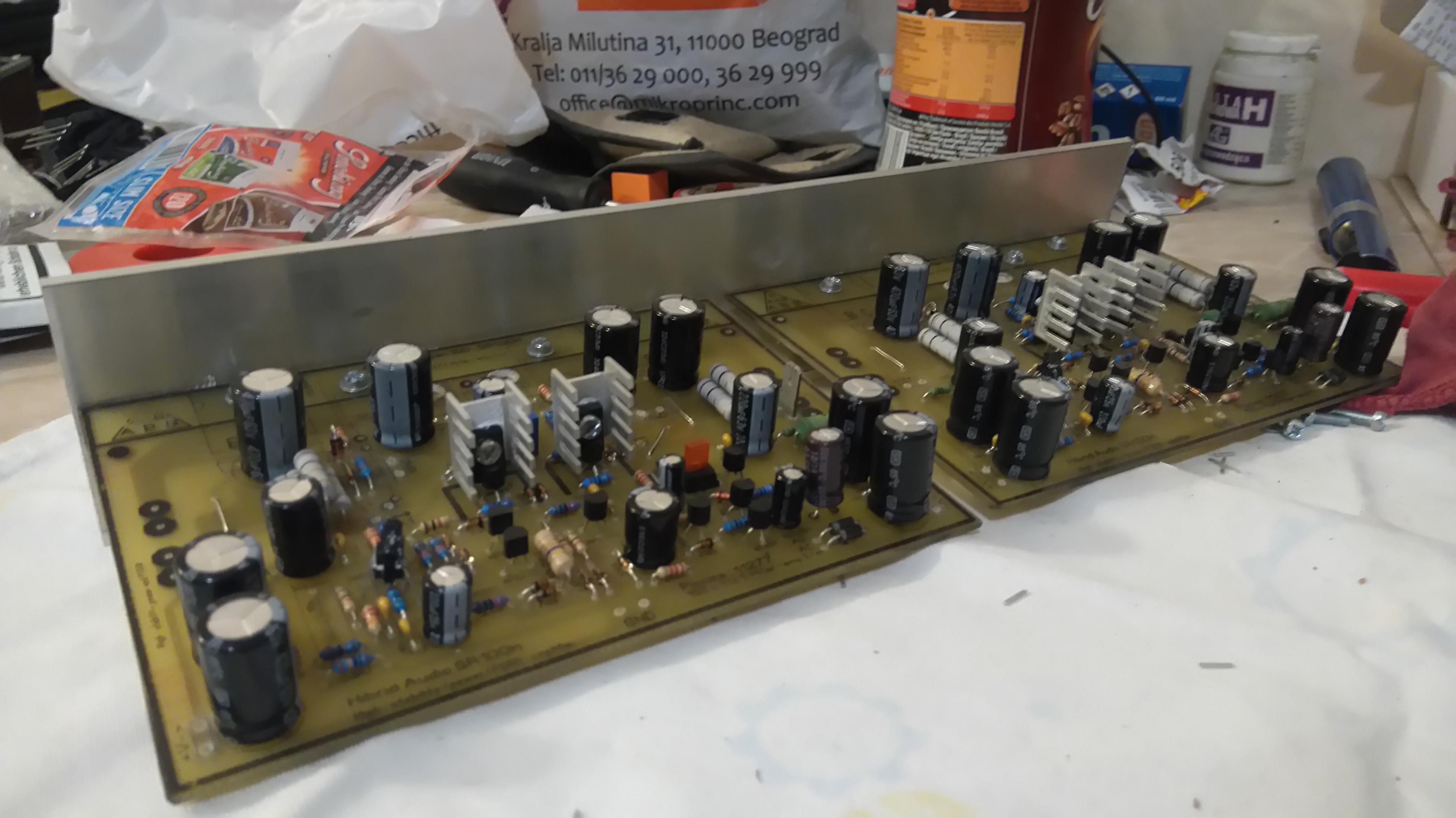

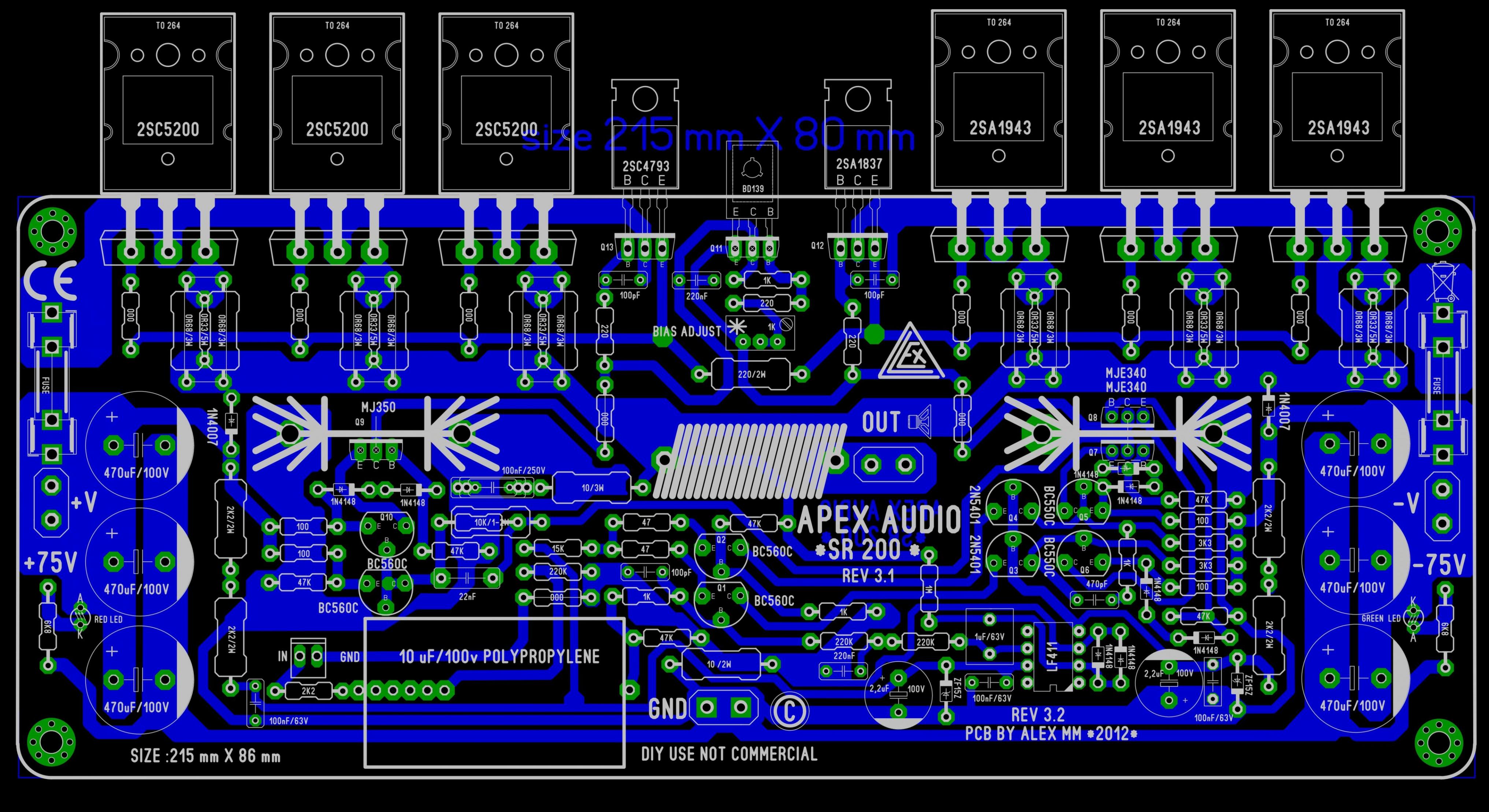

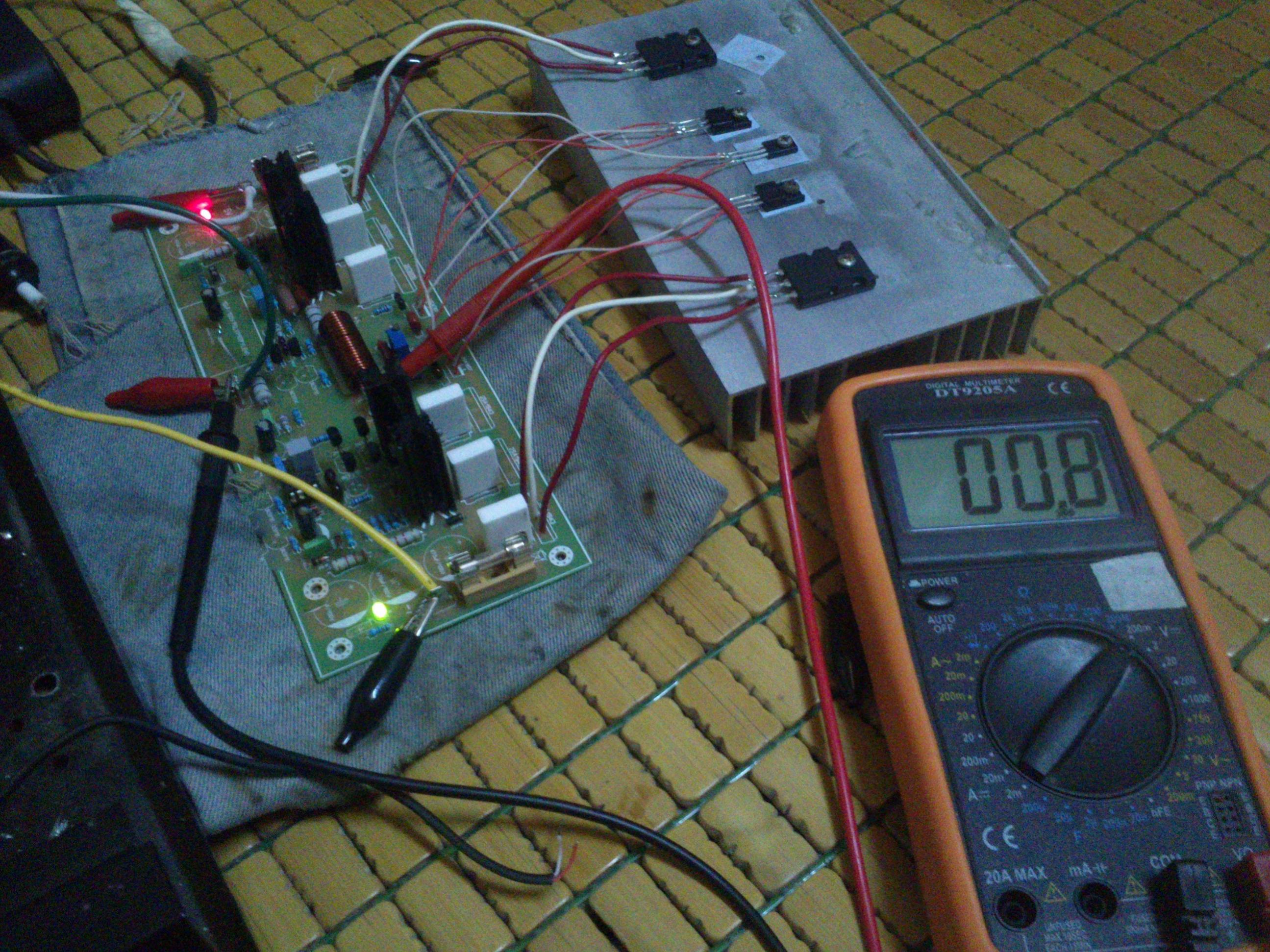

SR200, Iam testing one pair 5200 1943.
1.5V on resistor 10R instead, 150mA.
45mV on 0.47R 5W.
DC OUT: 0,1 -> 2mV 😎
Thanks apex and everybody!!! 🙂
