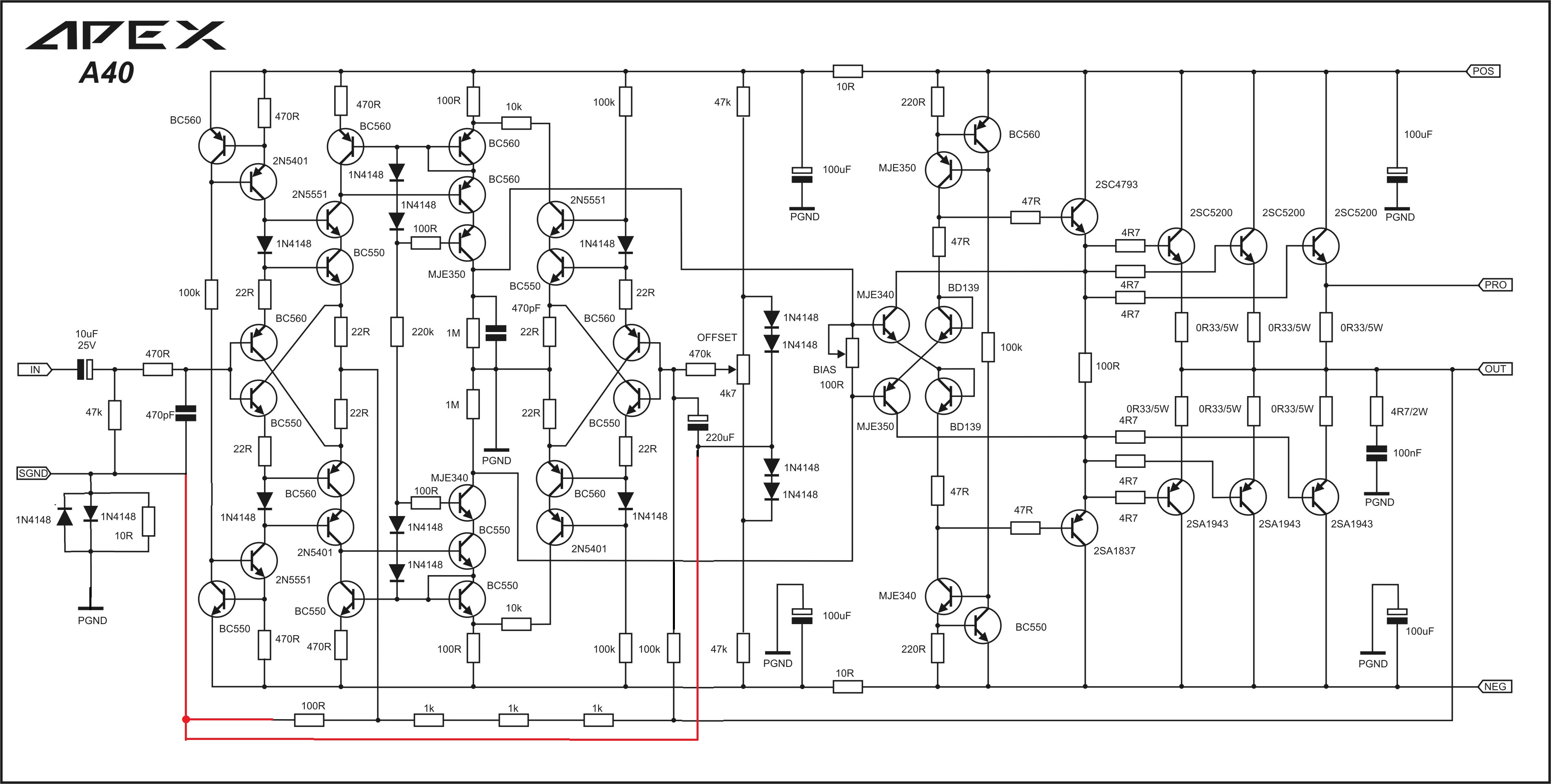

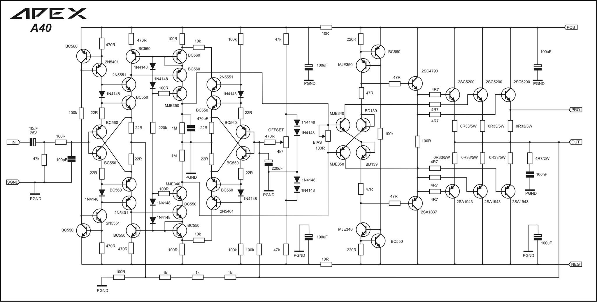

Hello, Sir. Mile. I saw that schematic and my question is in it nesesserity. Is Zobel required?Nice work, zobel is on speaker terminal... post #43,
Regards
100nF can be a severe test for ringing and overshoot.
Add your Zobel at the amplifier output.
Place the L||R after that .
You can add an optional Zobel across the speaker terminals for extra RF attenuation. But this should not be the sole Zobel and certainly not without the L||R in the output route.

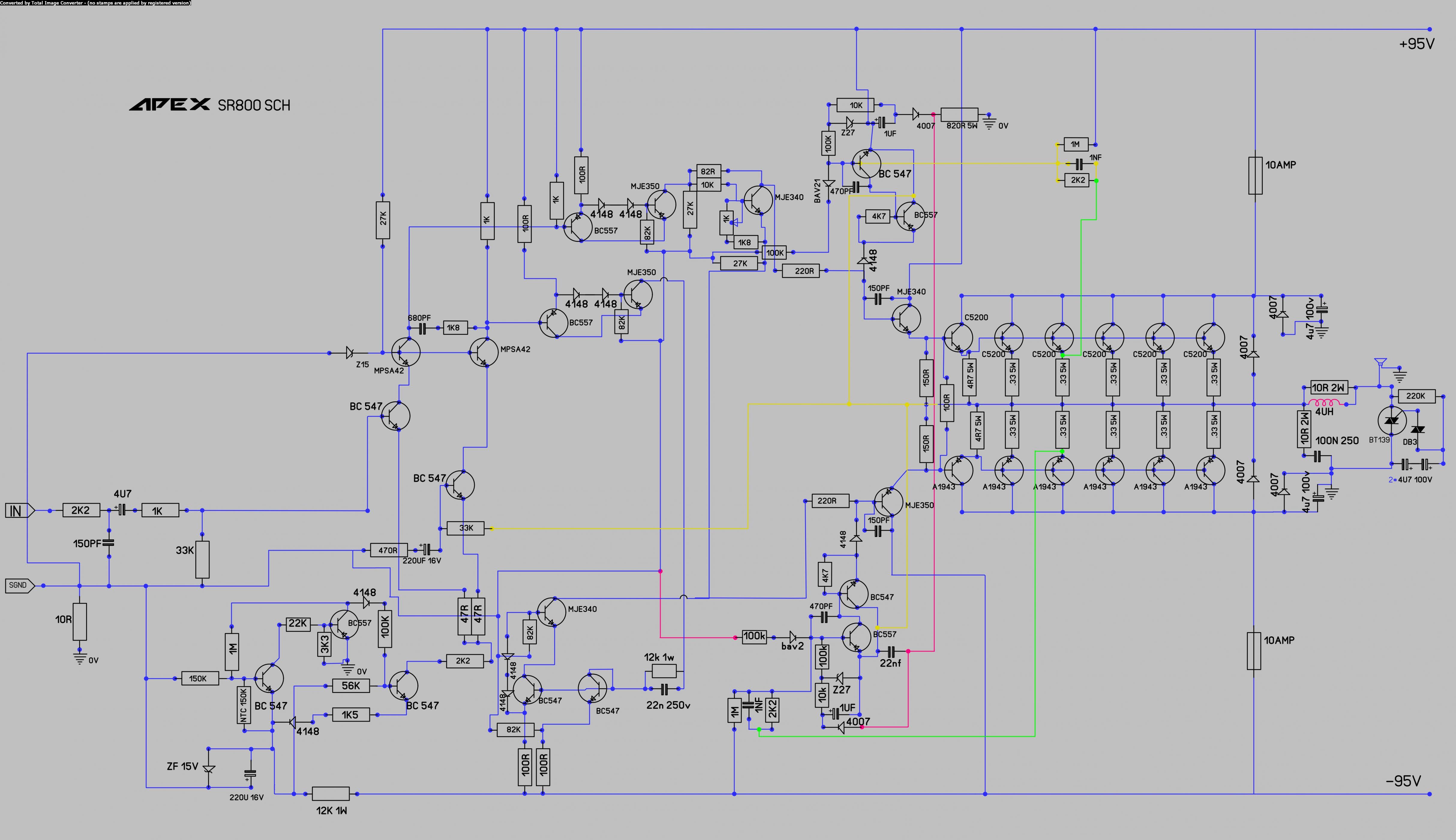

Hi sir rohin i make this pcb apex sr 800.any equalant for ntc 150k pls enybudy reply thank you
SR800 amplifier it's a commercial amplifier not for diy purpose 🙄 schematic was not posted ......😱
Schematic not postedSR800 amplifier it's a commercial amplifier not for diy purpose 🙄 schematic was not posted ......😱
Schematic not posted,but you know(and Mile of course)....is this ok to built as it?
i did something wrong? if anyone want to make that amp then what is wrong? we don't do this for profit ever.please forgive me if i did wrong.thanks.
I don't believe that is something wrong as this pcb posted here in this thread.
Just the schematic isn't available.
If Mile want to see this as DIY can answer the question.
Is this pcb on the right way?
Can we try this without the risk of a fault?
I can't help you with schematic, but you can clone SR800.

hi dear sir and everyone.please check this pcb so that i can make pcb.i want to make this op line amp because it has good quality sound.thanks.

apex sr 800 sch only for understanding and improvements not for raising questions to designer.thanks.
Nice work,
Regards
one or may be two mistake in sch.connecting z27 ziner diode not connect with + rail it only connect from outputs.if found any mistake please tell me.thanks.
