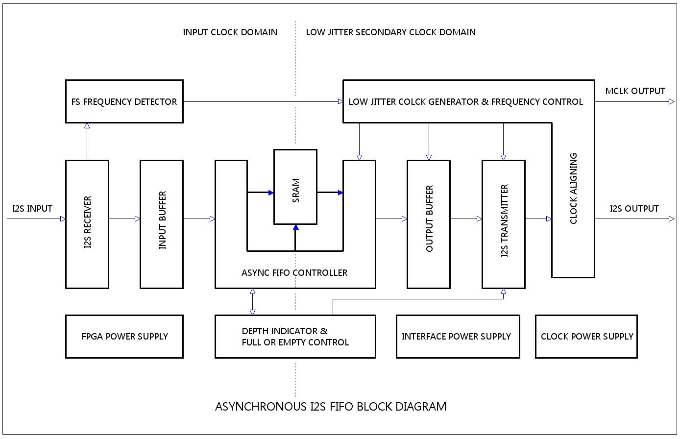

1. FIFO is widely believed as one of the final methods to deal with jitter problems. But the asynchronous FIFO itself is just a technology which could provide a logic function to isolate the two clock domain. That means, for an I2S stream, digital audio data could pass through without any modification but the input clock was blocked and replaced with the new one. The new clock is totally independent from the old one except they should have the similar frequency. The FIFO logic itself does not influence the sound quality;
2. What really makes it sound better (or even worse) is the low jitter secondary clock. For example, if we have a new clock after the FIFO which comes with one digit ps jitter(RMS), we should get much better sound quality than before (the jitter level of the master clock from DIR chip usually around 50ps(RMS) level above corner frequency). So, we should pay more attention on the secondary clock and related interface. Everything connected to secondary clock has to be very carefully to deal with; otherwise new additive jitter will be introduced;
3. The size of the FIFO memory should big enough to meet overflow or empty time caused by the worst case of i2s input clock, but still has to be carefully selected to get the balance between the delay time caused by the working depth(usually half full) of the FIFO;
4. FIFO with low jitter secondary clock could only reduce the play back jitter for an audio DAC, but has nothing to do with the sampling jitter. I don’t have any idea if a CD was reordered with poor clock of the ADC.
The main logic functions could be achieved by a FPGA/CPLD chip together with a megabit SRAM. But the clock section has to use specialized clock/timing circuit, because the jitter performance of the output of FPGA/CPLD are far from what we want.
Below is the possible block diagram of this I2S FIFO project:

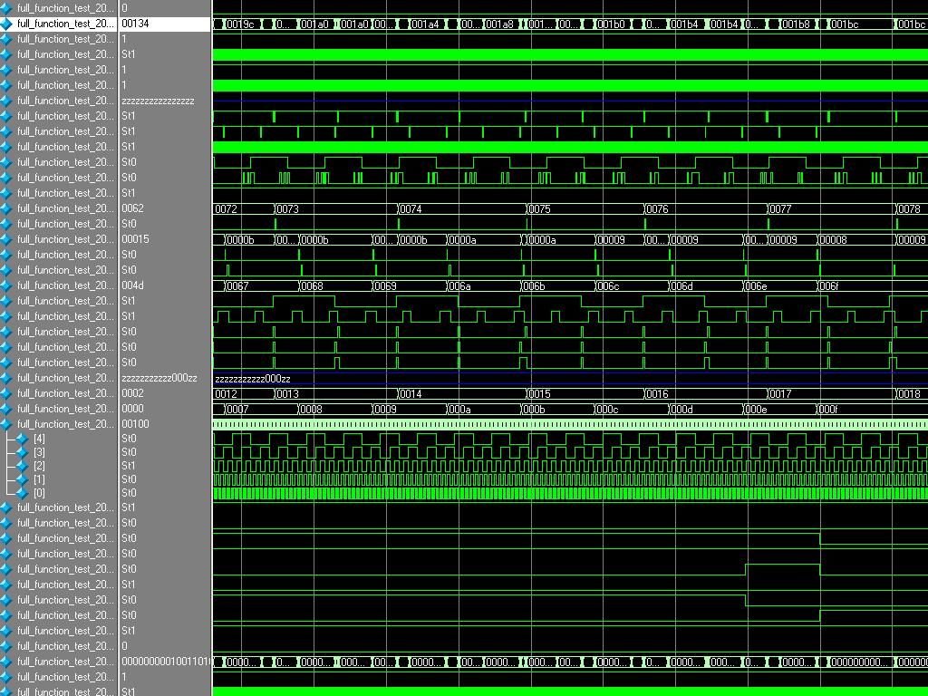

The Verilog HDL coding seems a bit boring, but it’s very fundamental to the project. Modules by module, state by state, signal by signal, have to go through everything one by one. CPLD/FPGA design going across two clock domains has to be tested with careful. Both functional and timing simulation is very important to make sure design target is achieved before running the real hardware.

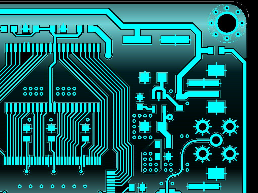

PCB layout is my favorite job. Not only because it makes you feel like very close to the actual board, but also it’s a kind of artwork.

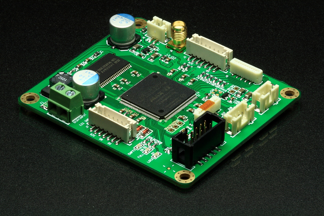

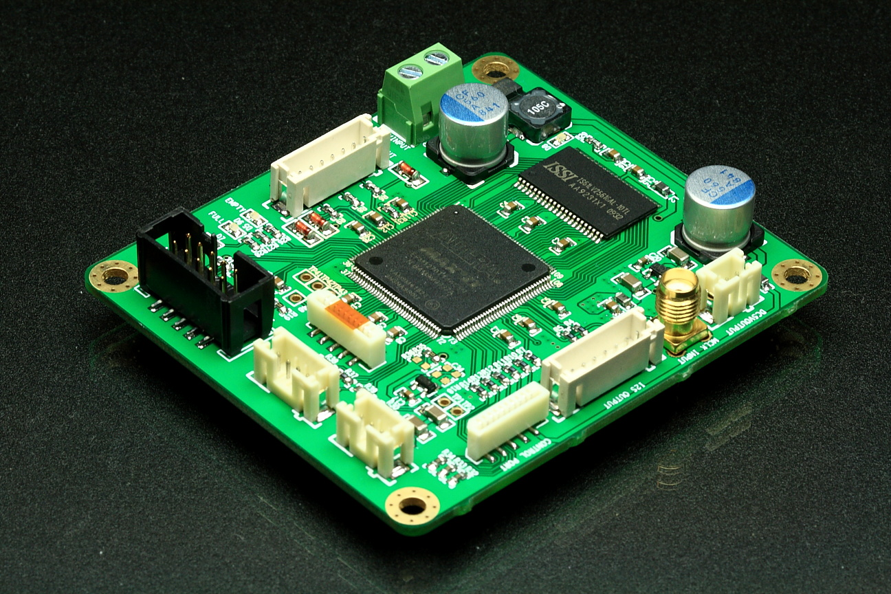

I just finish assembling the I2S FIFO board. A lot of SMT components. By using some little tools, it’s still OK for hand assembling, not that much difficult. So, finally I could show you some pictures of the board. This board has an I2S input, an I2S output and a clock input port. It could be driven by an external master clock or working together with a standalone clock board. This is a brand new clock and has no any business with input I2S signals. I’m gonna test it the next step. Just cross your finger.

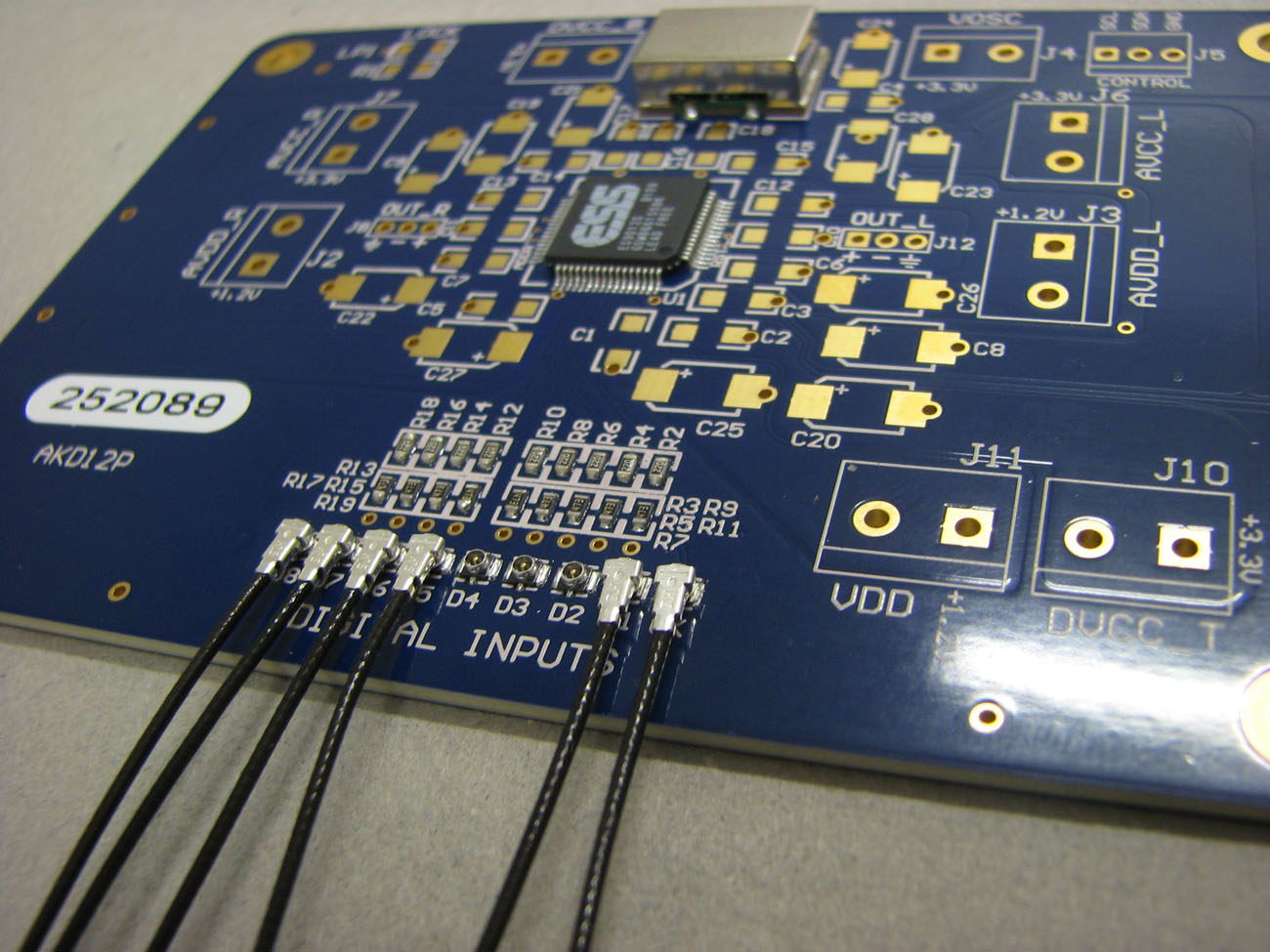

Hey Ian, yeah sorry i should have linked it and i forgot the dot in w.fl, its that type, but the one i'm using is a touch more upmarket, its made by hirose and comes available with double shielded mini coax cables, it looks to be the same, or at least similar connection standard as the one you linked, but its a bit pricier and does seem, or at least looks higher quality. its also described as ultra low coax smd, so perhaps its lower profile.
they really are excellent and handy little connectors, i have also used them just recently for sense/feedback connections for low noise regulators to power my portable dac.
see them on my ackodac AKD12P below, makes for really neat compact connections. they were just hooked up randomly for this pic a while ago now before i stuffed the boards

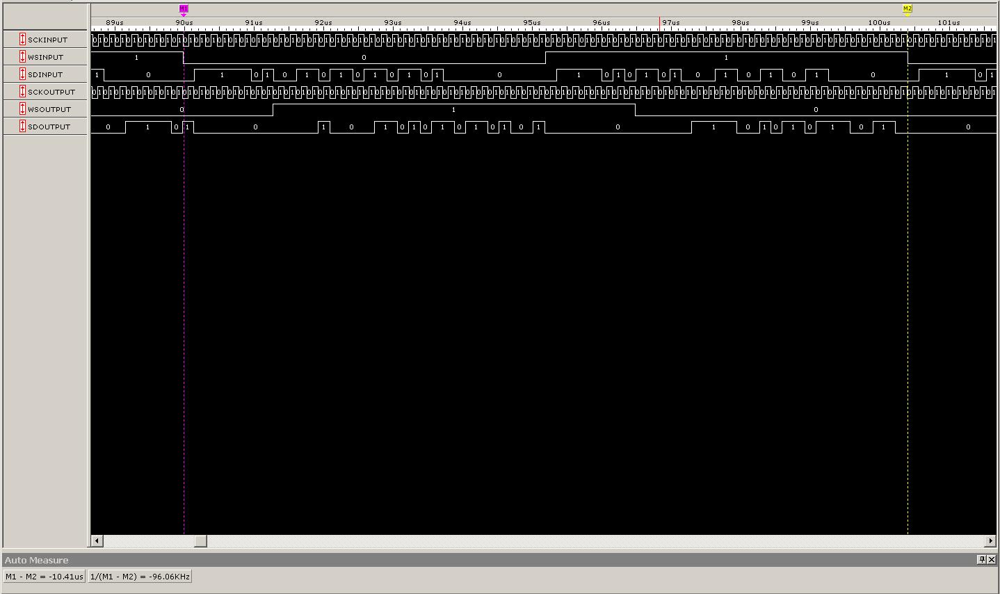

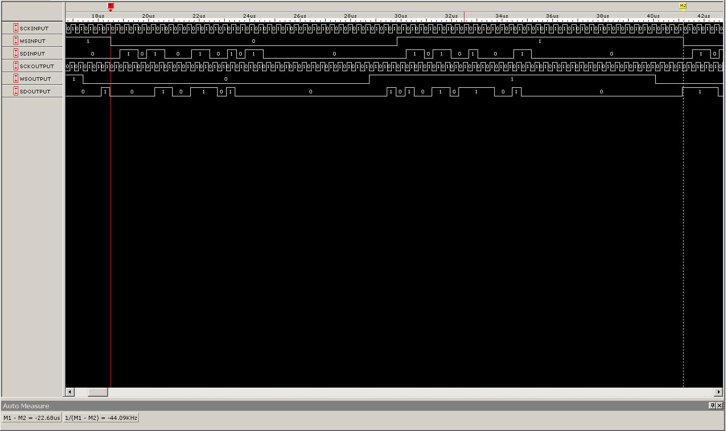

Functional test
Functional test was done. Everything seems OK, so far so good. The actual timing is almost as same as the simulation result I did a month ago. Some bugs in the Verilog source code have been fixed. Little bit modification on PCB will be shown at the next version. Here are some details.
1. I2S Timing test
44.1Khz 16bit: PASS
48Khz 16bit: PASS
88.2Khz 24bit: PASS
96Khz 24bit: PASS
192Khz 24bit: PASS
2. Bit perfect test
2^32 times 32bit data comparison, no error found

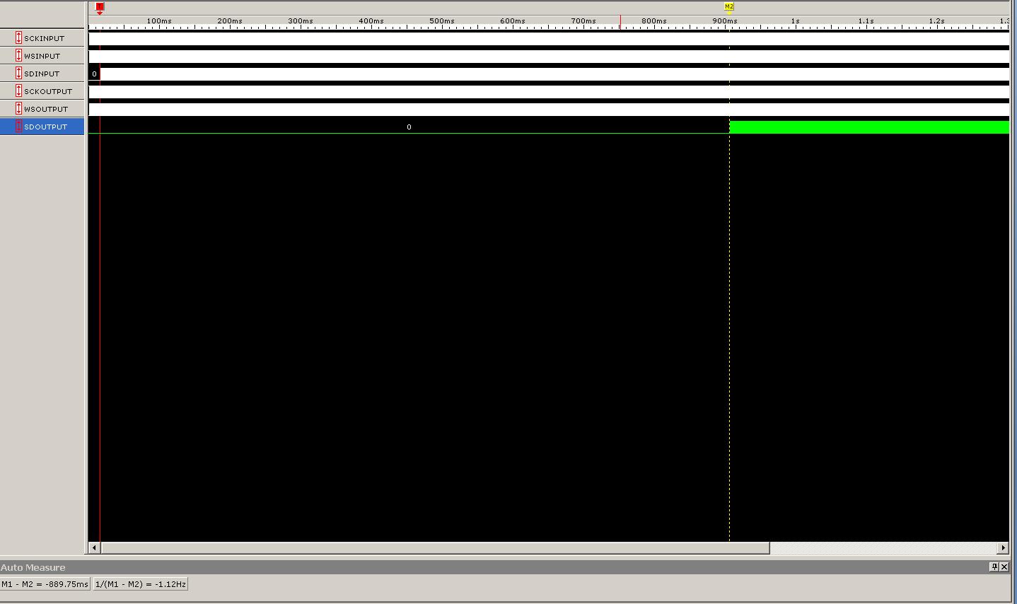

3. I2S FIFO delay test
0.89s for 44.1K I2S stream between input and output with FIFO depth around half full (could you put up with it?)
The attached pictures are the testing result from a logic analyzer. Just for reference. It shows very clear that the input sck and ws has nothing to do with the output sck and ws on timing.
I2S FIFO delay test 0.89s for 44.1K I2S stream between input and output with FIFO depth around half full (could you put up with it?)
