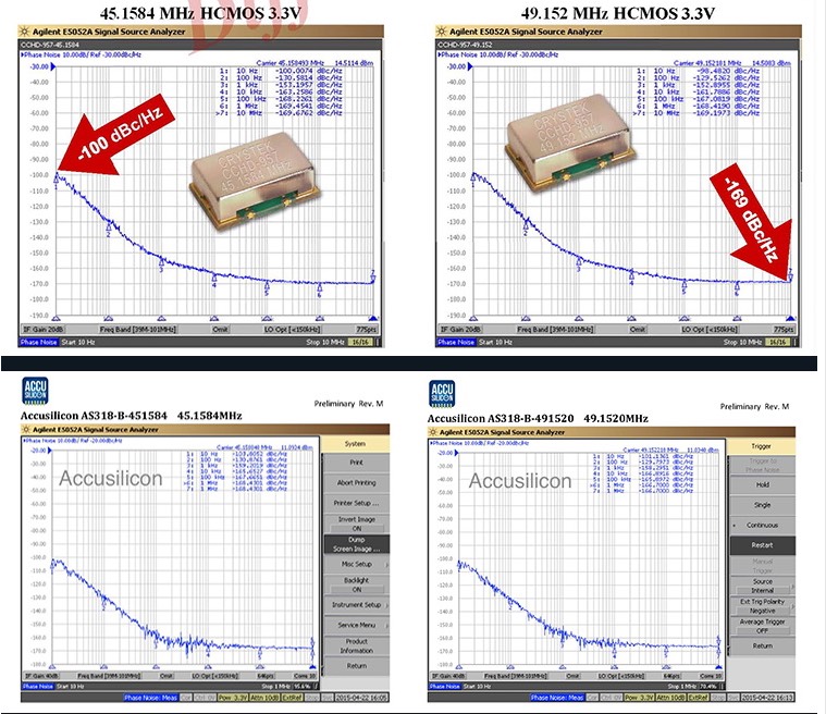

I have never talk about price, since you claimed that the Accusilon is a "extremely low phase noise crystal oscillator" I did remind you to the plots and the measurements of some real low phase noise oscillators, so you can see that the Accusilon is a "extremely HIGH phase noise crystal oscillator".
That said, there are no doubts that the Accusilon is cheaper and small sized against the TWTMC.

Firstly, if you claim the AS318B is a "extremely low phase noise crystal oscillator" your statement is absolute, there are no relation with price and size.
Then, even if the measured data from Accusilicon are true, with a phase noise of -100dBc at 10 Hz from the carrier, your absolute statement has to be that the AS318B is an "extremely HIGH phase noise crystal oscillator".
Last but not least, It seems you have difficult to read phase noise plots.

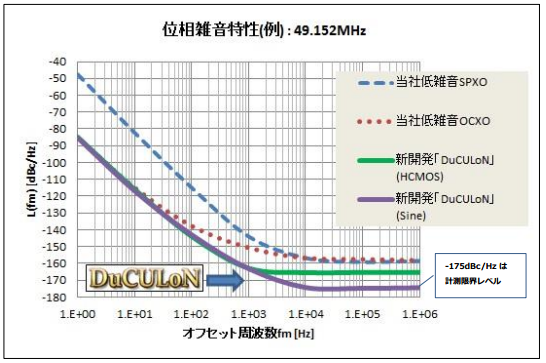

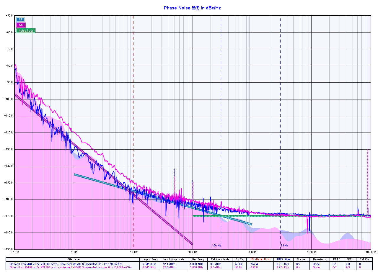

The TWTMC-DRIXO, by real measurement, is the best oscillator ever for digital audio: -157.4 dBc at 10 Hz and -130 dBc at 1 Hz from the carrier, see the plot.
The DuCuLoN, by the plot from the manufacturer, is -120 dBC at 10 Hz and -85 dBc at 1 Hz from the carrier.
So, since 157.4 - 120 = 37.4, the TWTMC-DRIXO is 37.4 dBc better than the DuCuLoN.
Even if you add the theoretical 6dB for each division down to 5 MHz to the plot of the DuCoLoN (18 db total), you get -138 dBc at 10 Hz and -103 dBc at 1 Hz from the carrier, that means the TWTMC-DRIXO is anyway 19dBc at 10 Hz and 27dBc at 1 Hz better then the NDK OCXO.
Finally, by phase noise comparison, the TWTMC-DRIXO is not "far inferior" as you claim, indeed TWTMC-DRIXO is "far superior" to NDK DuCULoN and costs a fraction.
