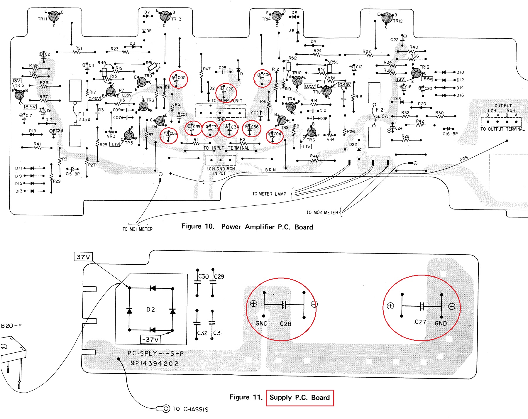

I have a Toshiba 330 power amp issue which I've had for about 10 years. I successfully replaced the Differential pair transistors in the amp a few years ago and its been in daily use ever since.
Recently I've started getting loud pops through my speakers. Sometimes it happens after the amp has been powered down. I've decided to stop using it until I can do a proper overhaul. Since I am currently unable to work due to cronavirus self isolation I have plenty of time on my hands to work on the amp.
I am guessing the amp needs a re-cap. Having never done this before I am unsure which caps need to go or which ones are likely to be causing the pops. Would it be excessive to replace all the capacitors or should I start with specific ones, if so, which ones?
Pics of the circuit board to follow.
Cheers

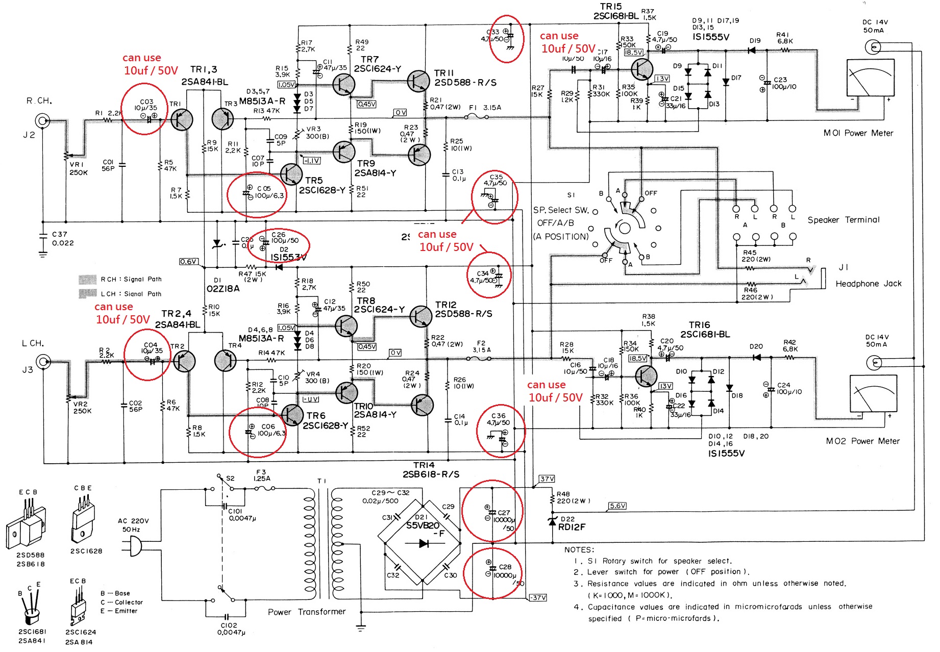

Hi, these caps needed to recap which important to the amp sounding.
The input caps 10uf/35v can be replaced by 10uf/50v and the four 4.7uf/50v can be replaced a 10uf/50v(which same as the input cap change), so that you just need to buy 6pcs 10uf/50v to replace them.
For the power supply board 10000uf/50v big caps, if you never recap them before, suggest recap them this time.
The cap you need to buy, you can check that if you can buy them form one vendor.
100uf/(6.3v to 25v is ok) x2pcs
100uf/50v x1pc
10uf/50v x6pcs
10000uf/50v x2pcs
