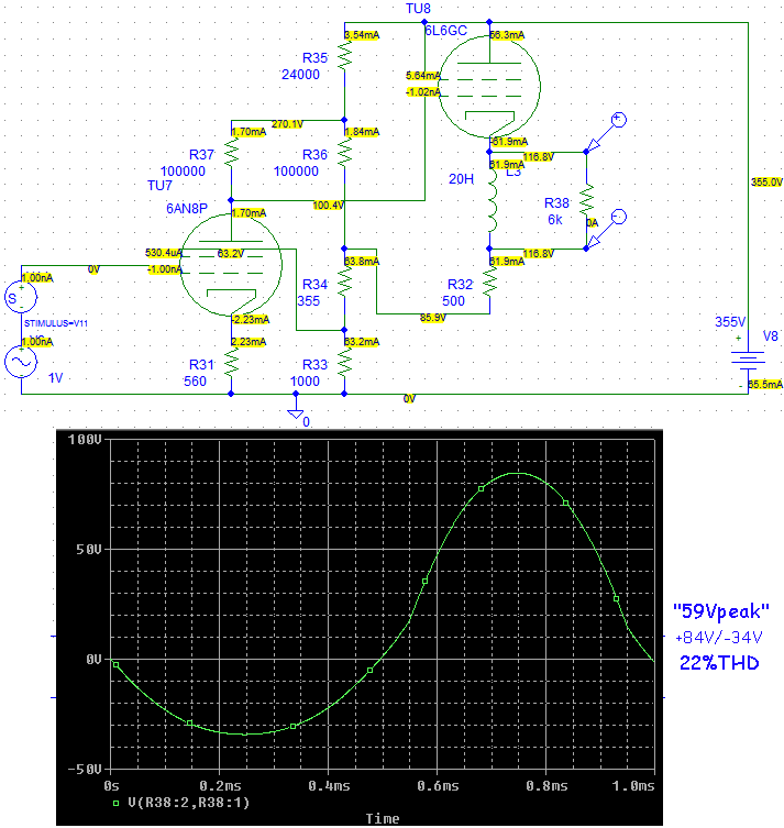

Not the first time this amp is mentioned. I doubt one can get the claimed 4.5W with that circuit. As the output stage is a cathode follower the input stage has to provide the full voltage. With just over 70V plate voltage I doubt it can do that. In principle it can be done but not this way. The easiest way might be just giving up DC coupling between the two stages.

The amplification factor has nothing to do with the maximum swing that one needs to drive the output tube to max power and 11.5V is the swing that is necessary IF the 6V6 is in common cathode. In that case it has its own voltage amplification and so the input stage doesn't need to deliver the full output voltage of the amplifier.
Having 6K output transformer for 4.5W you need 164V RMS (232V peak) on the grid of the 6V6 which is impossible to obtain from 70V plate voltage of the input tube no matter the amplification factor. The 6SJ7 simply can't swing that voltage. Actually you need about 180V RMS because the cathode follower output stage has a gain a bit less than 1.
With that circuit as is you will barely get 0.4-0.5W. If the 6SJ7 and the 6V6 are RC coupled then you have complete freedom about quiescent conditions of the input tube and can be adjusted to what one needs.

The fact that the grid voltage swing is limited to 85 volts in one direction looks like a limiting factor, but my bet is that it will swing negative due to the inductance in the OPT. How much this will help, I don't know without doing an LT spice sim...or building it.
The think I don't like is the 1355 ohms in series with the OPT. That will eat about 20% of your output power, and kill the damping factor.
The thing I don't like is the 1355 ohms in series with the OPT. That will eat about 20% of your output power, and kill the damping factor.

in common cathode gain stage the 10k resistor you refer to is the load against which the tube works to generate voltage gain. for the output of a power amplifier the output transformer is the load and the voltage developed across it (current) will couple into the load through the secondary winding. A resistor in series with the output transformer will simply waste heat and contribute nothing to the load. But being direct coupled you need to lift the output tube off ground and so you end up needing this resistor.
There is some stabilization of the operating point going on as the cathode of the 6V6 is connected to the screen of the input tube and this feedback to the screen of the input will help linearize it and improve the PSRR.

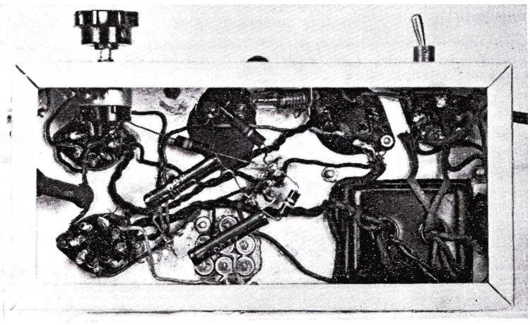

did anybody attempt checking that the schematic matches the wiring in the photo - a thankless task given the poor quality of the photo of course.

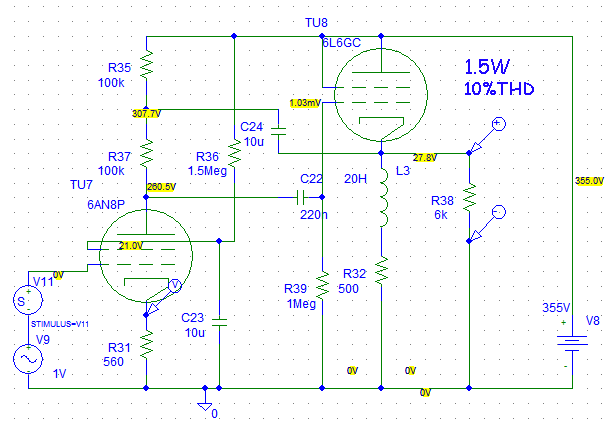

....If the 6SJ7 and the 6V6 are RC coupled then you have complete freedom about quiescent conditions of the input tube and can be adjusted to what one needs.
AC-coupled, you can do a heap better. Easily 10X the power. Still seriously distorted at any useful power.
My gut says it is not worth tracing the schematic against the chassis photo. A 6V6 as Triode just CAN'T make 4 real Watts SE. (Couple watts at best.) Bates clearly did not METER TEST this amp, just "assumed" it would reach normal-operation output.
Yes. With a cathode follower output one just moves the troubles to the input stage and actually it's even bigger trouble. Not so many solutions to get 180V RMS swing with little distortions. If it also has to be cheap even worse..... One needs a good device with its own power supply. That's why that circuit has remained unnoticed and no one addressed those design mistakes.
