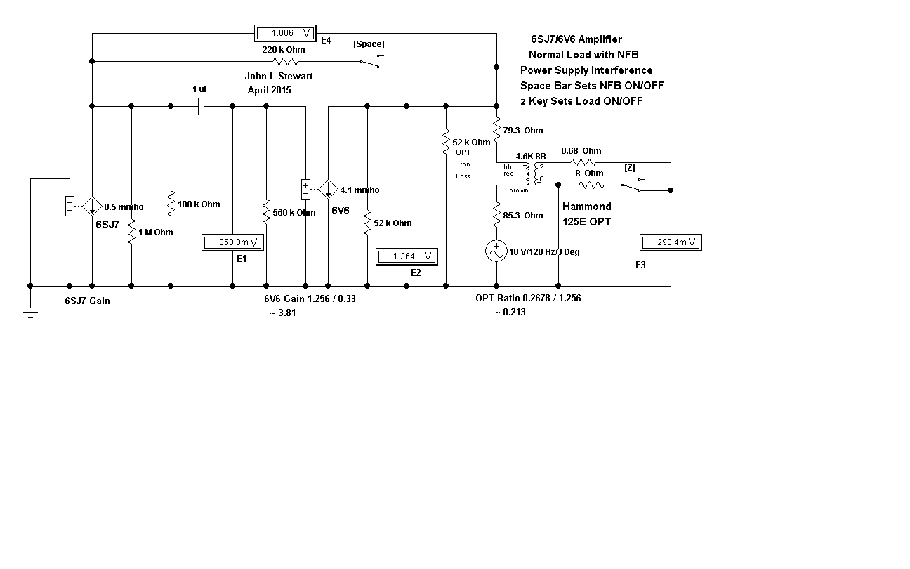

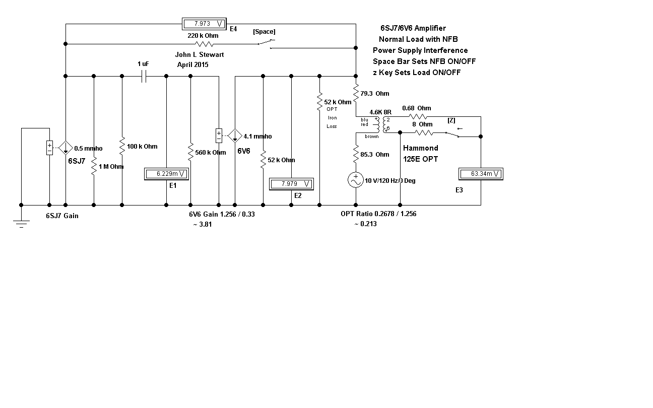

Effect of plate to plate NFB on PS Hum & Noise
Here is a worked example of the PS hum & noise problem The audio signal input is set to zero. A 10V AC signal is injected on the PS line. 10V would be typical of the guitar amp sited earlier in this thread, output tube B+ straight from the rectifier.
Without NFB the signal at the speaker terminals is 63.34 mV. With the NFB connected the signal increases to 290.4 mV. Thats 13.23 db.:eek:
May not hear the 60 & 120 Hz unable to make the trip thru a cheesy guitar amp speaker but sidebands of those would be on all the program material.:Ouch:
Need considerable care designing a PS for an amp using internal NFB such as plate to plate, same as we do with triode amps.

PRR
Joined 2003
...I thought adding NFB improved PSRR.....
Sometimes.
You have to understand that a transformer-loaded Pentode has high PSRR. The load may be 6k and the pentode plate resistance may be 60k. So only 1/10th of the raw ripple appears on the load. (This is another reasons pentodes stole triodes' lunch: less buzz for limited cost.)
With the NFB taken from plate, the pentode "acts like" more a triode, perhaps few-k plate resistance. Now 50%-70% of raw power buzz appears on the load, 5X-7X more buzz, in line with what jhstewart9's sims say.
Taking NFB from the secondary avoids the problem of taking NFB relative to the buzzy DC supply. This is cleaner.
OTOH, for ultimate fidelity (not just commercial fidelity) you want the raw DC to be *clean*. Even if NFB masks the buzz in the linear zone, transient overload peaks gain a haze of ripple. Of course real clean DC is not cheap.
