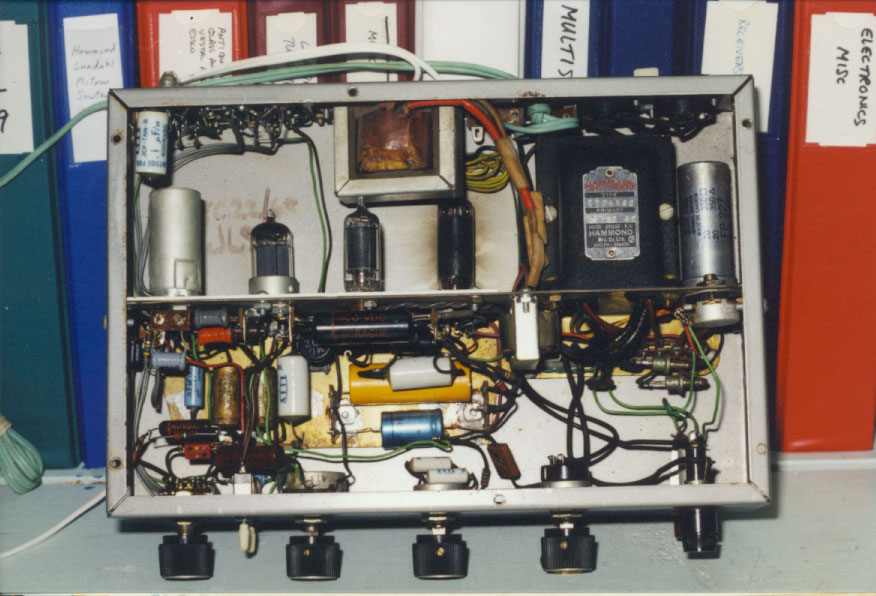

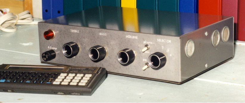

I built this little amplifier back in 1968. Since then it has been used in quite a wide variety of locations. For the past few years it has been in my workshop. Program sourc*es are an Eico HFT-90 FM receiver and a matching Eico HFT-94 AM receiver. And sometimes a CD player.
The electronics is a FB pair consisting of a 6AU6 & 6AQ5 driving into a Hammond 125D OPT. The front end is a 12AX7 connected as a Baxandall tone circuit & another 12AX7 as a preamp for a low level magnetic phono pickup up or can be switched to a mike. DC is supplied by a FW SS rectifier driven by a Hammond 270AX transformer.
I managed to build the entire amp, tone controls, and preamp into a Hammond 8 × 12 × 3 chassis. Most of the major com*ponents are on a 3 × 12 sub-chassis inside. That includes the power supply, power amp, preamp, and tone circuits. I assembled the sub-chassis on the bench. The controls, input, and output connections are mounted on the front and rear panels of the chassis. These were all wired together at the final assembly stage.
Because there is some heat to be dis*sipated, I used a set of four 1˝ diameter ventilation hole plugs mounted on the ends of the chassis. There are several ½˝ holes in the bottom plate to allow cooling air in.
Around 1960 I built two other complete amps inside the larger Hammond 8 x 16 x 3 chassis. Both were running PP 25L6’s into Hammond 125D OPT’s. Other tubes in the lineup consisted of the regular 6SL7 type preamps & drivers. They were used by friends & never came back due to failures.
So far no electrolytic failures to report but something to consider in a poorly ventilated environment. The pages are from another era, need to be redone. For those who would prefer octals, 6SH7 & 6V6 are drop ins for this circuit.:wave2:

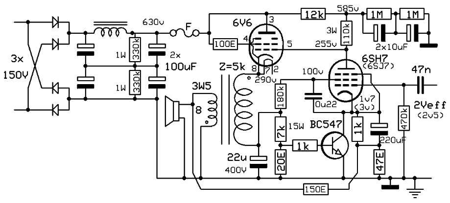

May I ask where is that circuit from ? Do you have access to any other information about it ?
I will let the more experienced members comment about the actual circuit. It’s a cathode follower, it has silicone involved, something that looks like a doubler in the psu, so really high voltage, but I cannot say much more. Thanks for your input !
+630VDC raw supply.
+290VDC at the 6V6 cathode means the 6V6s absolutely must have their own heater supply lifted up to around +250V. That also means the 6SH7 (6SJ7) tubes must have a separate heater supply. Two separate 6.3v heater supplies. More complexity. Worth it?
+585VDC B+ to the 6SH7 (6SJ7). That's what enables it to swing a lot of signal volts out from its plate.
The PS rectifier is simply a full bridge of SS diodes, nothing unusual except the very high & dangerous voltage.:eek: The 6V6 is still connected as a triode so can swing the cathode no farther than it would swing the plate in a normal grounded cathode circuit.
A lot of cct for very ordinary results.:)

The 250k ohm plate resistor means it would drop 250V with only 1mA across it. With B+ of 350V this would leave only 100V at the 6SJ7 plate.......I was thinking the plate voltage should be more like 150V. With 3mA plate current, that would mean something like a 33k plate resistor to drop 100V, leaving 150V at the 6SJ7 plate. The screen grid load resistor might be something like 220k(?).
This circuit comes from the 1940's. Leo Fender was trying to maximize the gain from the 6SJ7. The gain in a pentode is determined by the load impedance and the Gm of the tube. Gm varies with current, more current, more Gm.....more current requires more B+ voltage, or a lower load resistor which reduces gain. For any given tube there is only one combination of load resistor and current for maximum gain at any given B+ voltage......but there is a fairly wide range of "near maximum" gains with different combinations of load resistors and tube current.
That old Fender circuit runs the 6SJ7 in near starvation to get maximum gain. This kills high frequency response since the output impedance is very high, and requires a high AC load impedance. This is why there is a 1 MEG volume pot despite the 500K maximum spec for grid circuit resistance in the 6V6 tube.
I prefer a more sane load resistor with a few mA of tube current. Need more gain, use a tube with higher Gm. The previously mentioned 6EJ7 is a good choice, but it's a 9 pin miniature tube. Other tricks can be used like bootstrapping the plate load so the tube sees a very high AC load. I have achieved stage gains of over 1000 with a 6AU6, but microphonics become the limiting factor in this case.

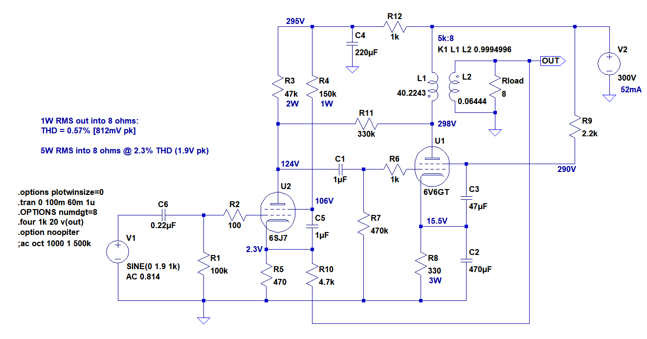

Okay, I'm not having an easy time with this. But here's what I have.
It doesn't try to DC couple. It's based on a 300V B+.
It looks like it's not going be a low distortion type of thing. LTspice says 0.57% THD at 1W out into 8 ohms, 1kHz. Not exactly hi-fi, and this is with both local plate-grid NFB and another 6dB of global NFB. Open loop THD is downright scary.
LTspice says max power is 5W into 8 ohms at 2.3% THD at 1kHz.
I don't know if this is good or not. It's the best I can seem to do at this point. I've attached the .asc file if anybody wants to play with it in LTspice.
I hope it's of some use.

Since the B+ supply is +300V, I'd make all caps 400VDC rated (or 350VDC absolute minimum), except for C2 (the 6V6 cathode bypass cap) which can be 50V or 63V.
I didn't give much thought to parts values. The sim is just a quick sketch. I'm sure it could be improved upon. I'll see if I can apply some tweaks to the simulation that make theoretical improvements.
PS - Let me know if you need tube models. I can send you some, or you can get almost anything from here.
Also, have you read through this thread? Vacuum Tube SPICE Models
One last thing... The most important part of an amp like this is the power supply. A pentode SE amp is going to be very sensitive to noise on the B+ supply. It would even benefit from voltage regulation, but that's basically building a whole other amplifier (a DC amp instead of an audio amp). At the very least, you want the B+ to be very well filtered with low ripple. Even that will require some effort and expense. Did you say you have a power supply filter choke available?
