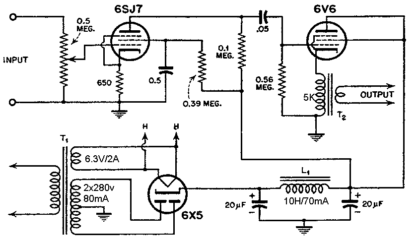

The Raymond H. Bates circuit was published at page 62 of Radio News, 1949, issue 11. The same year, mr. Bates published the non-direct coupled version of this amplifier on the june issue of Audio Engineering, page 30. This was presented as "low power cathode coupled amplifier". The more professionally-oriented magazine distanced itself from the autor by presentig it as novelity in the "reader's contribution" section. The author also toned down the claims, and dropped the absurd 4.5W power specification.
Do you have access to the orher pages of the article ?
The full issue of Radio News (issue 11 1949) and Audio Engineering (june 1949) are currently available for download as pdf files from the americanaudiohistory.com website. The audio engineering article is a single page one. This article has been published at least on a further magazine because I've found another scan on the web with different impagination but the exact same text and schematic; I have been unable to recognize the magazine. I plan to build in the near future a small amplifier with cathode follower output stage, and this Bates schematics is often quoted as example. It does have a few seriuous drawbacks, however. It has been obviously designed with a trial and error approach, using the parts that the author had on its drawer. This means that it probably works, unlike other designs from magazines, but it is equally probable that it may work better after optimizations and checks on a circuit simulator. The 6SJ7 / VT116 really looks to have been grabbed from a scrapped WW2 communication receiver. I have at least a dozen metal VT-116 and this tube has the important advantage to be really cheap, but I don't see a compelling reason to use it on a modern Hi-Fi build; I tried it on a test circuit with the standard component values listed on the databook and I was not impressed. As small output tube, 6V6 is ok but a tube with higher gm such as EL84 / 6BQ5 will ease the driver tube job. It would be interesting to compare on the simulator the original 6SJ7-6V6 tubes to something more recent at the same power level, such as EF86-EL84. The Tubelab cathode follower amp with sweep tubes is a far more reliable and documented design and I am certain that it work as described, but it does not meet my current need to have something small on power and size. This is why I currently have the Bates schematic around on my desk again.

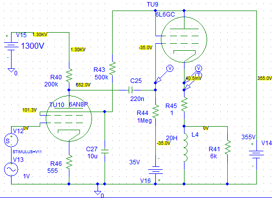

An ideal device as a power amp, choke/transformer-loaded, 250V supply, will swing +/-250V (500Vpp) around the idle point.
Cathode follower is "unity gain". So the driver has to make 250V peak or 500Vpp.
6V6 Triode won't swing full supply voltage. But also won't reach unity gain. So for stick-in-sand figuring, we still need 250V peak.
As DF96 and others say-- this won't happen by happenstance.
A good rule-of-thumb for a resistance-loaded driver is: peak output at 5%THD is near 20% of supply. Or the other way: supply must be > 5X the peak out needed.
5X 250V is 1,250V supply. 😱
We "can" cheat and bootstrap the driver (above) since we have a cathode follower. However all distortion in the CF boots-back to the driver; not a great cheat. (BJTs make better "CF"s which is why many BJT audio power amps use bootstrapping effectively.)
> has many different HV secondaries
OK, so spitball a >1,250V few-mA supply. Driver plate must sit 1/3-1/2 of supply, 400V-600V.
Ignore the fact that few small tubes enjoy such voltages (we can always stuff a EL34).
With pentode driver, 1,300V supply, 650V on plate, driving AC coupled 6L6 with 355V supply, 6k load, I'm simming 4 Watts at 22% THD. 2 Watts at 8%THD. There's an unresolved kink, which may be a model flaw, though when I isolate the cathode follower alone in DC Sweep it's dead linear.

The Bates' circuit is just wrong. Forget it, throw it in the bin!!! You will only waste your time and money. If you are happy with less than 0.5W output power there are better and cheaper solutions....it's really not worth the trouble as is in the original article.

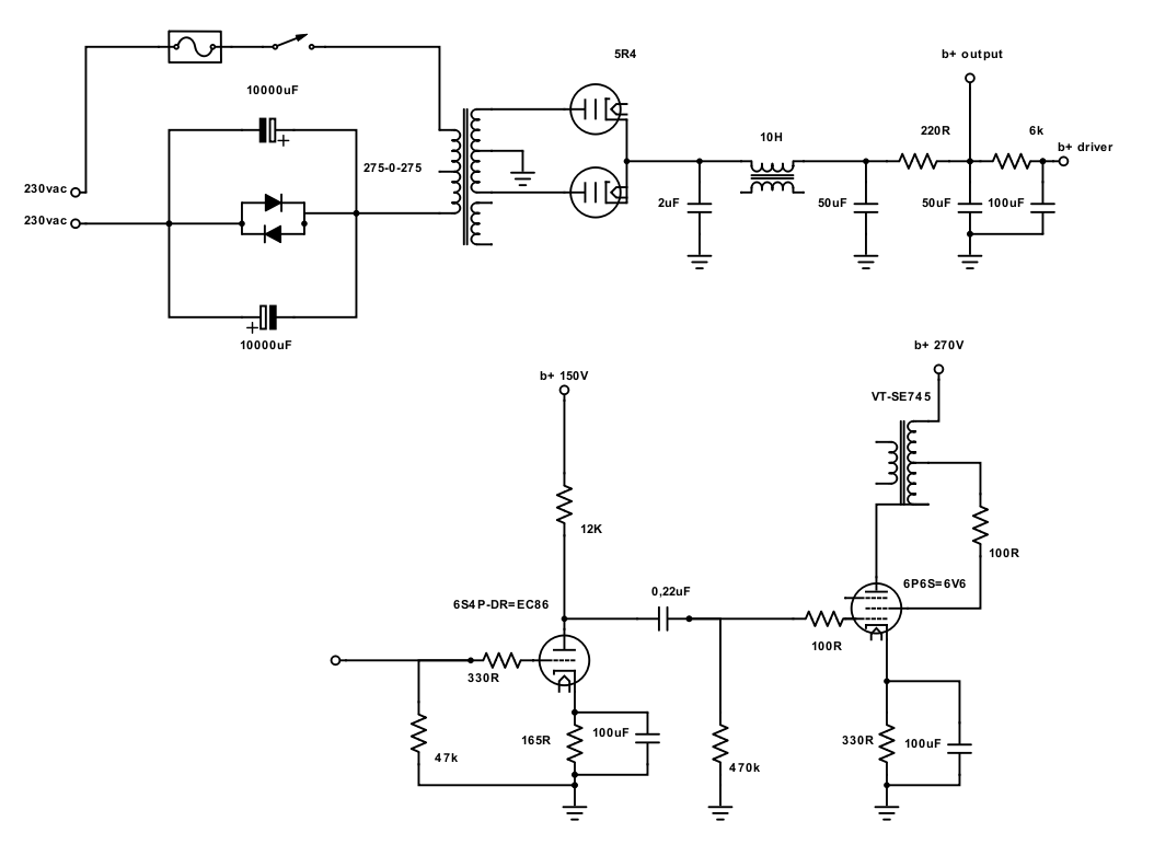

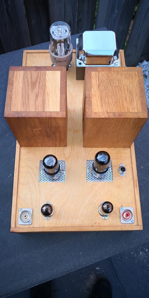

I guess i’ll have to find another ocatal/two valves circuit with 5k OPTs to fill my enclosure, wich has already been drilled. The other version of the circuit, the RC coupled one, was still tempting, but the power figures are so low for such an investment in time. 1250v is just wrong for such a low power output !!
Since my chassis is ready to receive this circuit topology, and because I can’t find a suitable two valve all octal single ended schematic for a 6v6gt, I think that I will assemble the rc coupled version of the bates amplifier. That will satisfy my curiosity and i’ll be able to measure it’s output power in real world.
The other option would be to tame myself and take the time to design something else that would fit the bill. I don’t have a computer that can run the tubecad programs and don’t know how to use LTspice so I would have to do it "by hand", unless you guys know of a circuit that I could use. Thanks to everyone who answered this thread, it’s been really instructive !
For me the bottom line of this cct max output would be One Watt on a good day. It is triode connected no matter how we look at it. 4.5W is the spec for a pentode connected 6V6 on a 250V supply. Better jack that up a few volts to account for the cathode bias resister & OPT primary R losses. So a supply of 275V might do it.
But never for the triode connexion.🙂
Some of the ccts published in that era are not exactly as claimed. Need to be careful. I wuz there!! Few people had any kind of reliable test equipment. I was lucky, I worked in an R&D lab.😀
