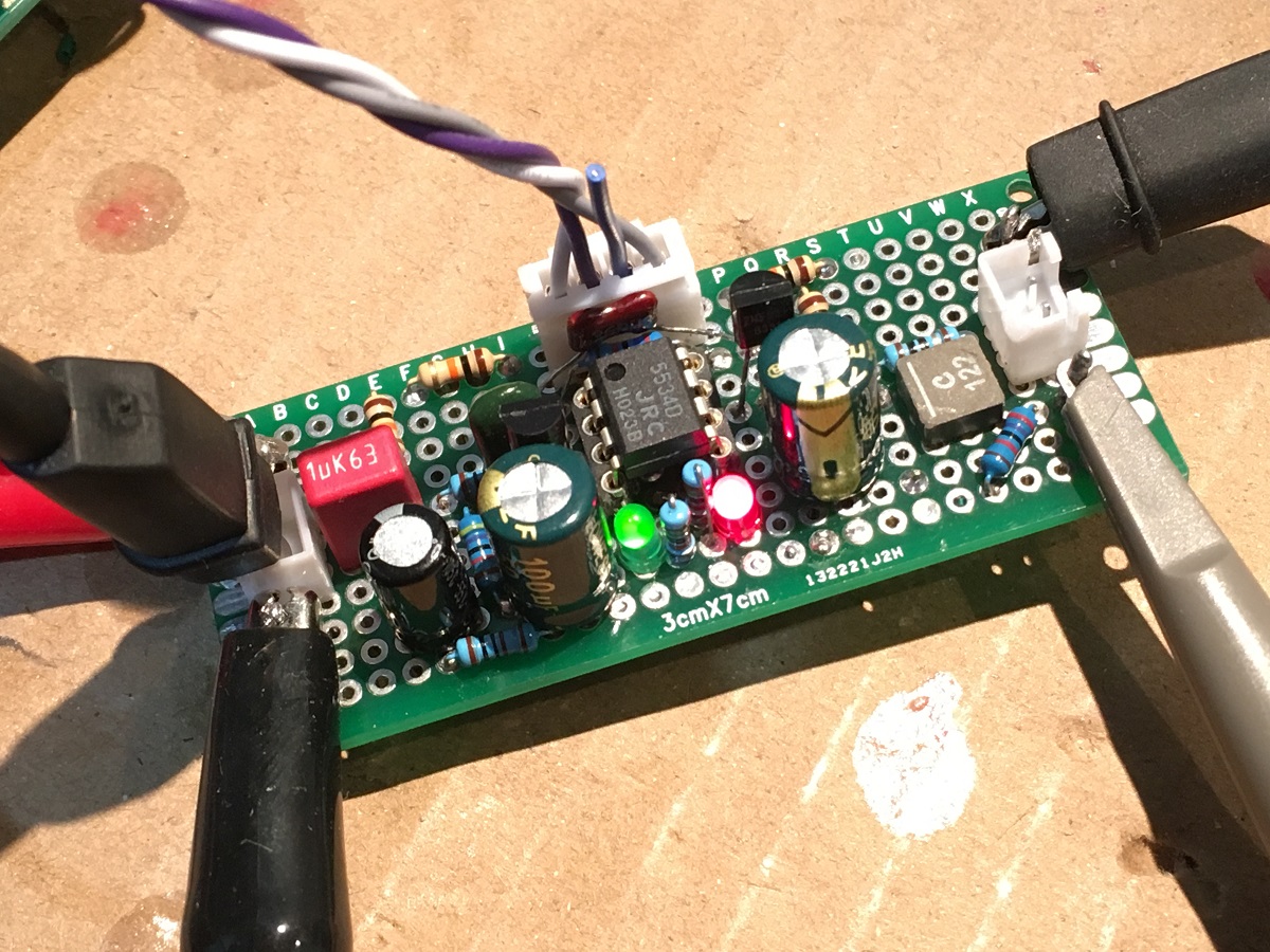

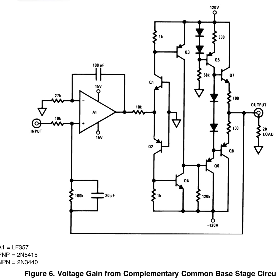

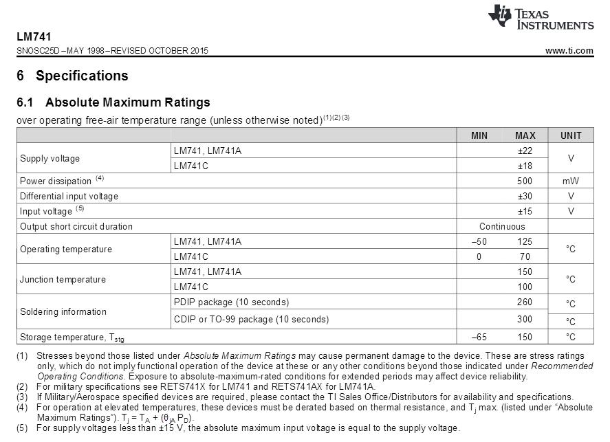

Member @mediatechnology (Wayne Kirkwood) told me about how to bootstrap ANY opamp using two TO-92 transistors and 4 resistors using Surjan Dogran's Opamp Bootstrap technique first published in Electronic Design, in 1974. I needed an instrumentation opamp that could swing 65v p-p but they don't make opamps that can do that. So I was using a modified Apex FX8 sans the output stage and with some mods to higher voltage transistors etc, it was actually working pretty well. Then I saw this article from 1974 and had to try it. I used a JRC 5534D opamp, normally rated for +/-22v rails. I followed this diagram and added qnty 4 x 10k resistors and a 2N5551 and 2N5401 BJT's to the circuit as shown. That's it.
Few_Extra_Components_741_Op_Amp_For_High_Voltage_Swing_Applications_Dogra_Electronic_Design_April_26_1974_Small.JPG
I then boosted the rails to +/-44v (as 44/2=22v so within safe limit). Here is a photo of my opaamp. I have a couple of extra's features already there from earlier build, including: a Coilcraft 1.2uH inductor with 10R Thiele output network, a 680pF RF lowpass input filter, and a 36pF silver mica cap in parallel with the feedback cap:
attachment.php

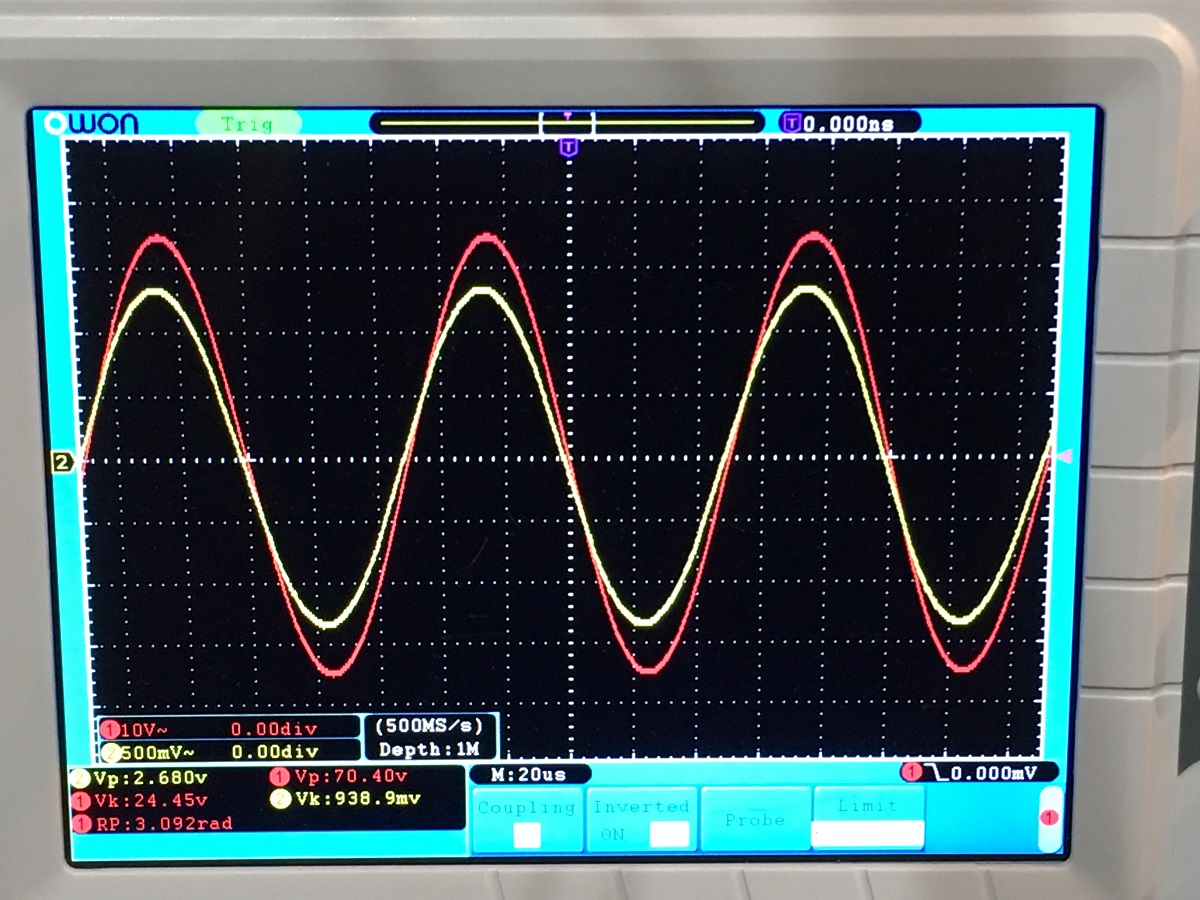

And here is the scope shot - it looks fantastic and I am easily driving a clean 70v p-p output and it looks really nice. For 2.68v p-p input I a, getting 70v p-p output. I think that this has got to be perhaps the easiest and most cost-effective way to put your opamp on steroids. Of course, it is not meant for driving low impedance loads - but for cost probably less than $0.25 in parts added to my opamp circuit, I have a bonafide high-swingin' contender here. I bet the THD is now even lower than before:
attachment.php
Anyhow, this worked out really well and hope you all find it useful. Seems like it would be a great ultra-low distortion front end for a higher power output stage.

Thanks for sharing, it's a great idea.
Since the supply voltage across the opamp is constant, it should be ok and perhaps even beneficial to add a decoupling capacitor between V+ and V-.
I actually have a 100nF X7R between the two rails right underneath the IC. You can also see I have two 100uF 50VA rail caps near he Vcc and Vee pins of the opamp. Wayne Kirkwood actually recommends a 470pF to 1nF film cap between base and collector of the bootstrap transistors. I did not use it and seems to work but probably a good idea for enhanced stability.

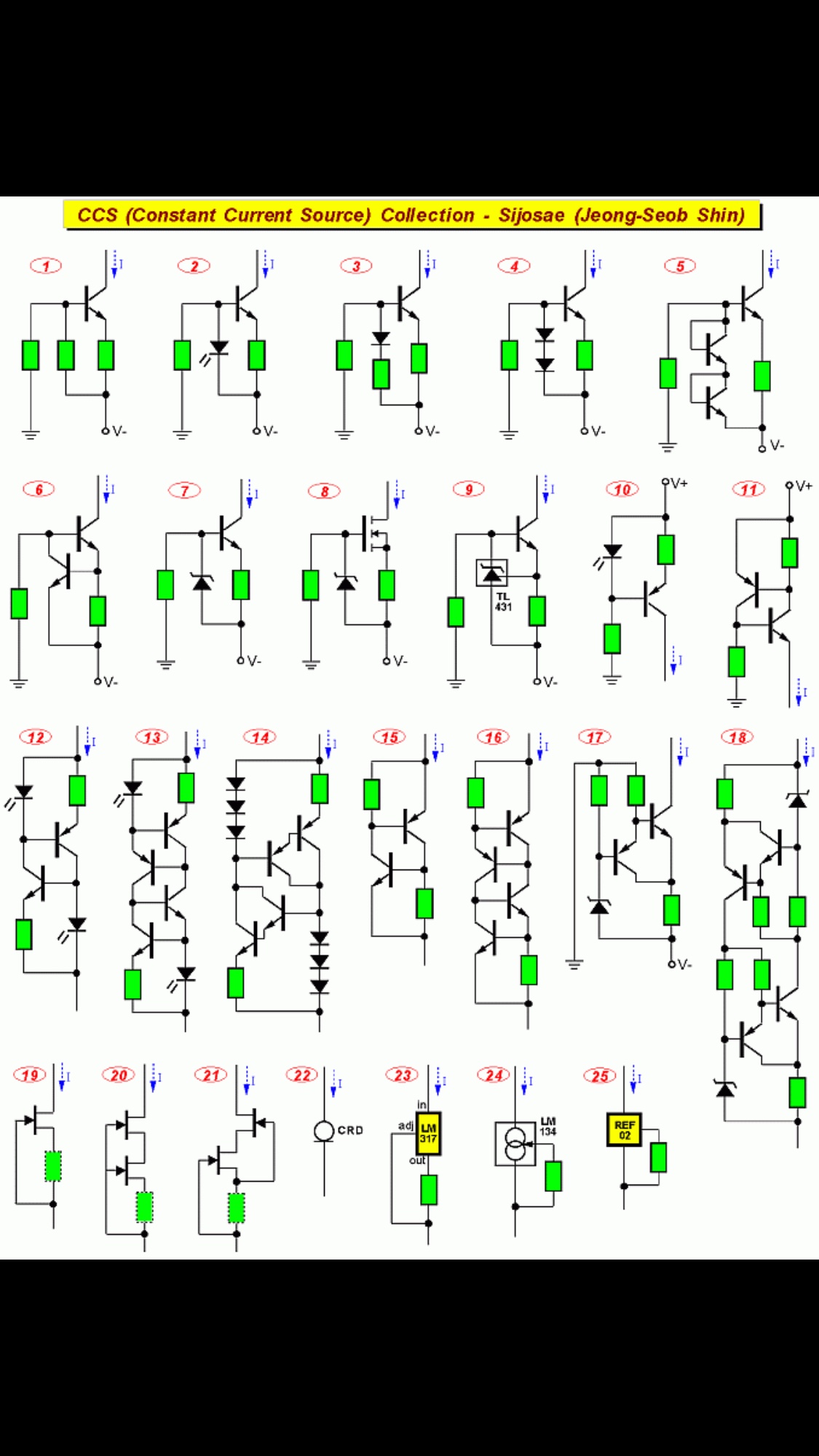

If you replace R1, 4 by a current source and R2, 3 by a zener you can alsmost double the output voltage range.
Jan
Founder of XSA-Labs
Joined 2012
Jan

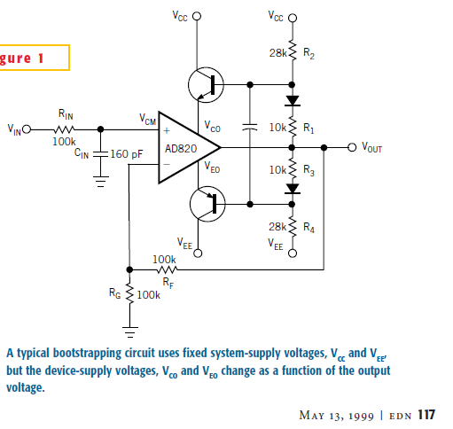

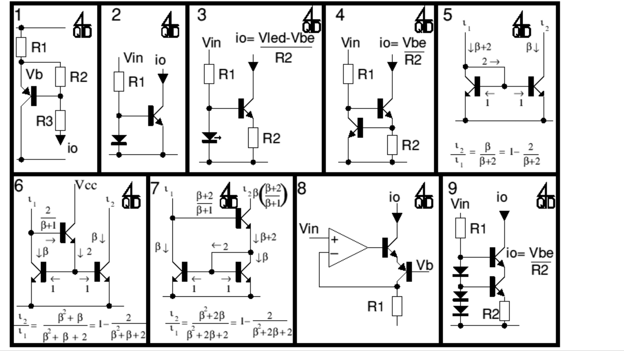

Thanks, Jan.
I will have to try that. Do you have recommendations for CCS? Could a J113 and a resistor work here?
This would be more along the lines of the schematic in the EDN article from Post #3?
attachment.php
AX tech editor
Joined 2002
The idea is to get the output of the emitter followers to the required supply for the opamp. If you use, say, 12V zeners then the opamp supply is about +/-12.6, which is nice.
Then if your cs can work up to say 2V across it, your max supply voltage is Vhighsupply - 12.6 - 2. For a Vhighsupply of say 40V that is 25.4V.
If the opamp then allows output swing up to 2.6V below supply, your max output level is 35.4.
Note that the current through the zener and cs + emitter follower base current has to come (partly) from the opamp output, so you may want to minimize it. Use emitter followers with a high gain is a good start.
Edit: in some respects this is a positive feedback loop. If the gain through the outside part is higher than the opamp PSRR, you can get instability. Hence the C from C to B on the emitter follower, to roll off gain at hf.
Jan

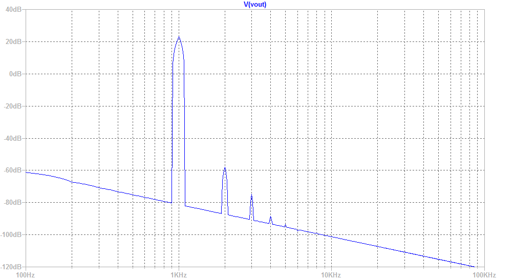

Here is a preview 40v p-p into 22kohm load with 2.15v p-p at the source:
attachment.php
Total Harmonic Distortion: 0.009011%(0.010907%)

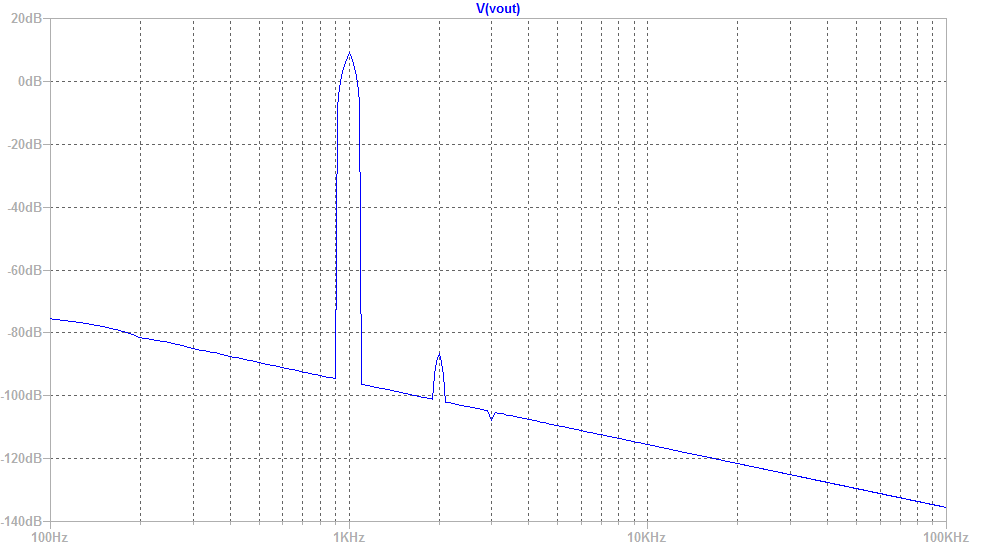

For comparison, here is 8v p-p (2.83v rms) into 22kohms:
attachment.php
Total Harmonic Distortion: 0.001707%(0.006170%)
