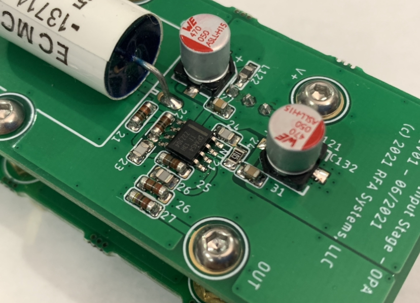

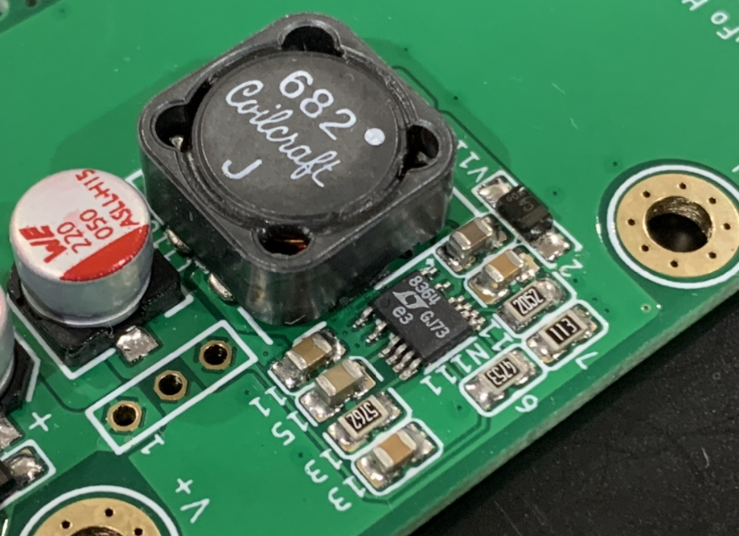

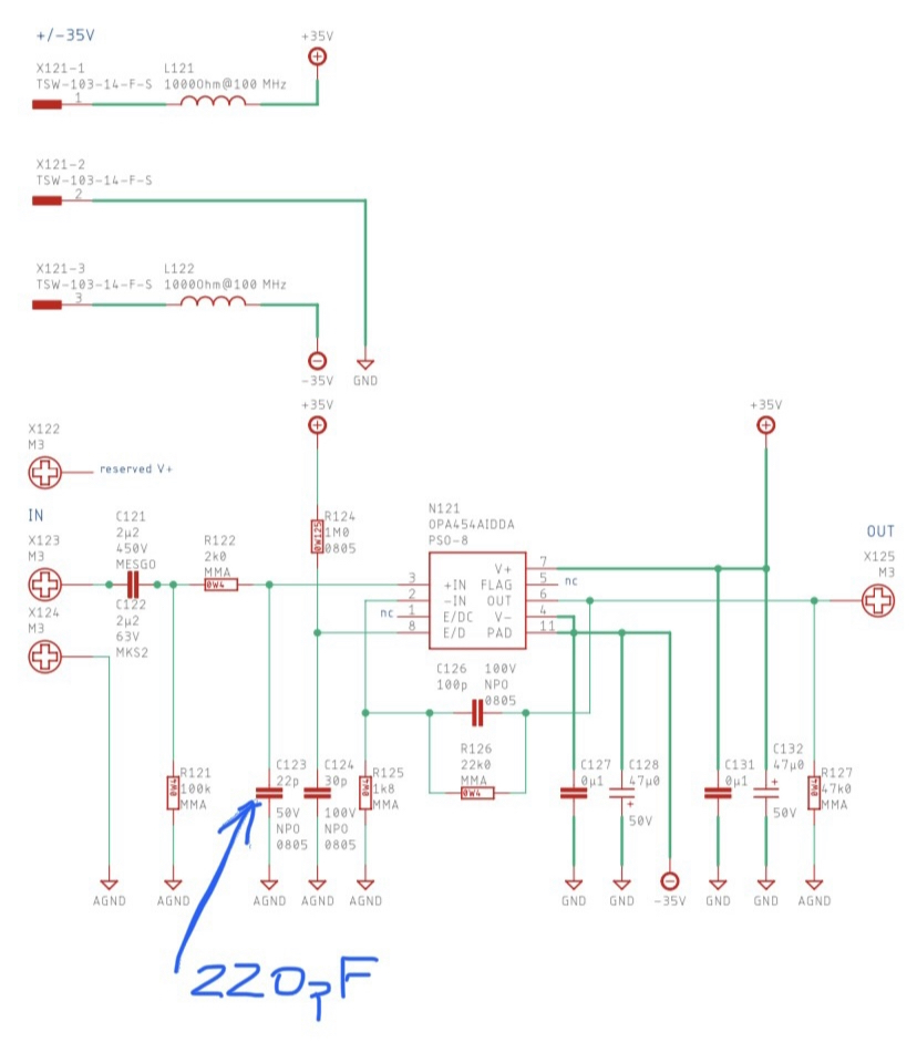

I built an OPA454 with its own sub mezzanine DCDC +/-35v PSU using LT8364 SEPIC topology inverters. It sounds excellent and can drive the 0dB gain LuFo amp to 40w rms just fine. This preamp/front end module uses the Yarra/M2X bolt format for power and input/output in a swappable preamp daughterboard type system. Now I realize Kees had recommended this chip 5 years ago!
Schematic of OPA454 22.4dB gain stage with 70Vpp output:
This is the +/-35v DCDC converter sub mezzanine:
