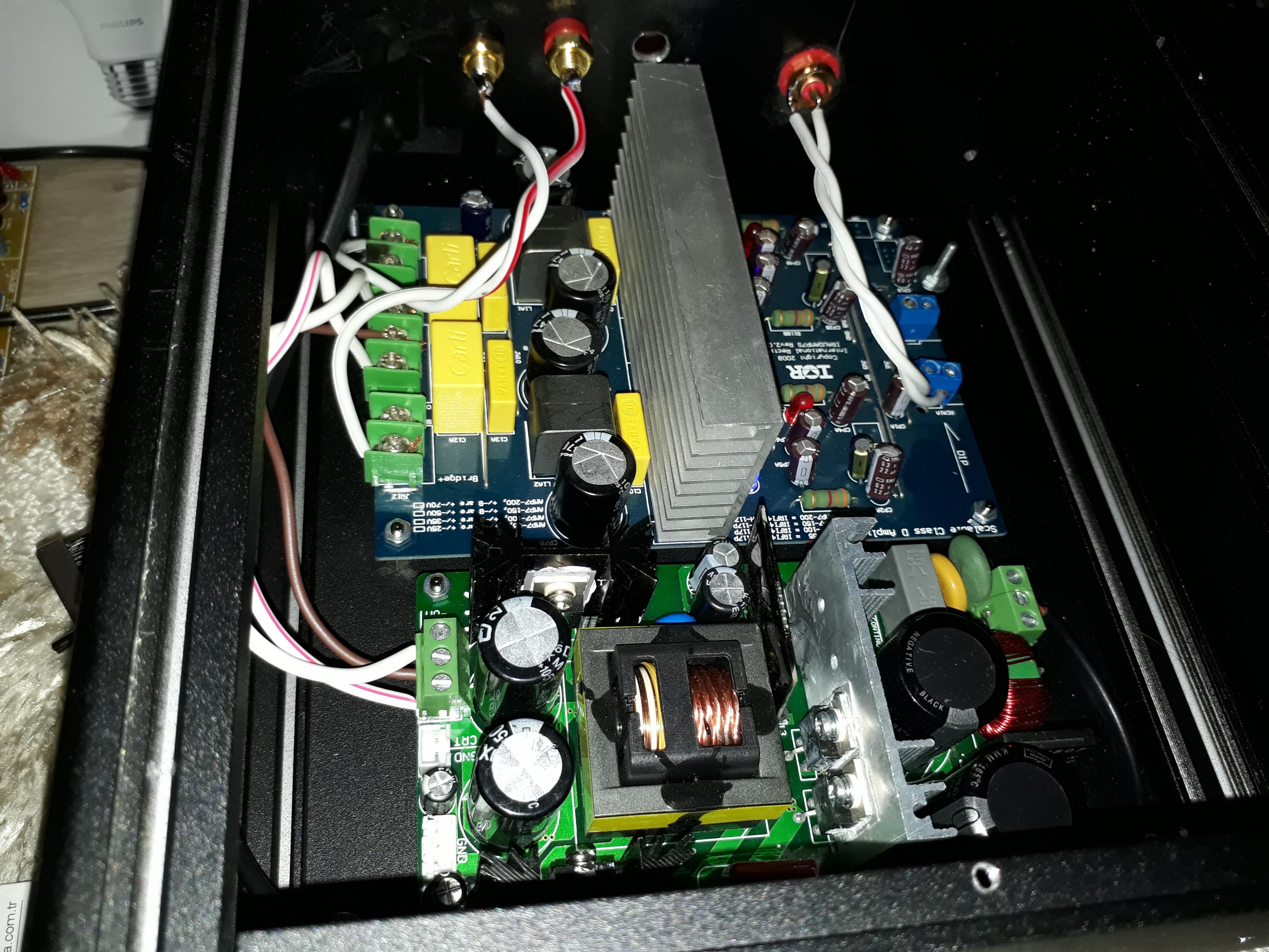

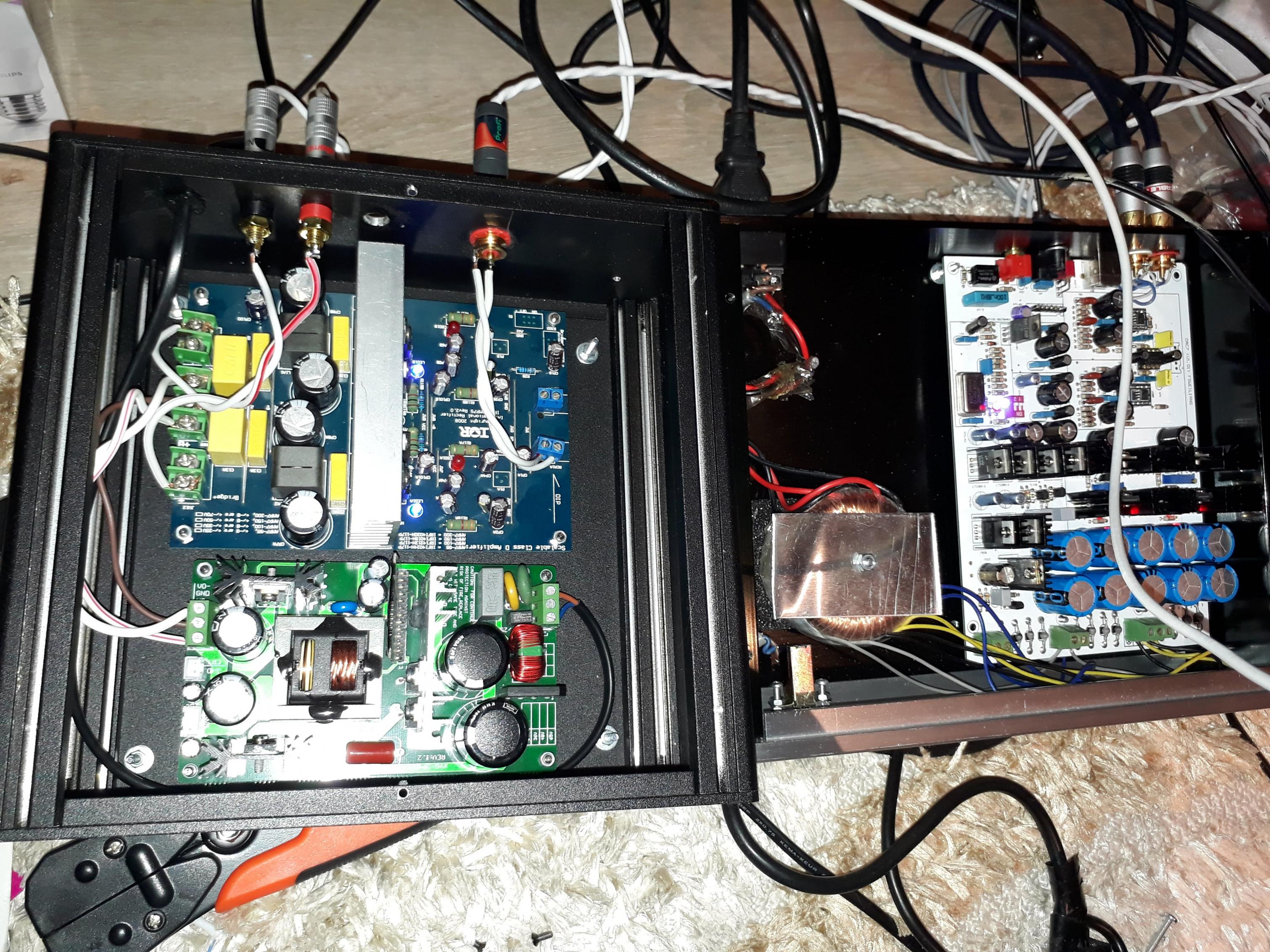

Hi Hansueli.I put this smps and L15DX2 500w class d amp in this case(I am using it bridged).It plays well since 2 days.But there is a small sound (tırrrrrrr) from smps transformer.(not audible over 30cm)
It plays well now.For your information.I did not open a ventilation hole on top and bottom because it is not heating up.
I hope it will not break down.

Hansueli,
with a bit reengineering I found out that the auxiliary supply has its own winding on the transformer and is completely separated from the rest, even the center tap. There are only two diodes and two small electrolytes, that's it. Shorting it will kill the transformer because the power of the auxiliary winding is too small for triggering the protection ciruit if there is any.
Do you still have the SMPS? I have tried to figure out how much power can be taken from the auxiliary winding, but the manufacturer can not be determined even with lots of hours googling and the various dealers know nothing about. We could at least estimate that if we could measure the wire diameter of the winding. For this I would have to destroy my power supply, but yours is already broken. Can you measure it for me?
TIA Heinrich
Dear heinrichh
Sorry but I have no possibility to measure the wiring diameter.
The wire are already at the recycling :-(
When I take the wire away from the transformer the wires were connected to the high voltage side. So for me it’s not really galvanic separation. It could be used for powering the L6599
