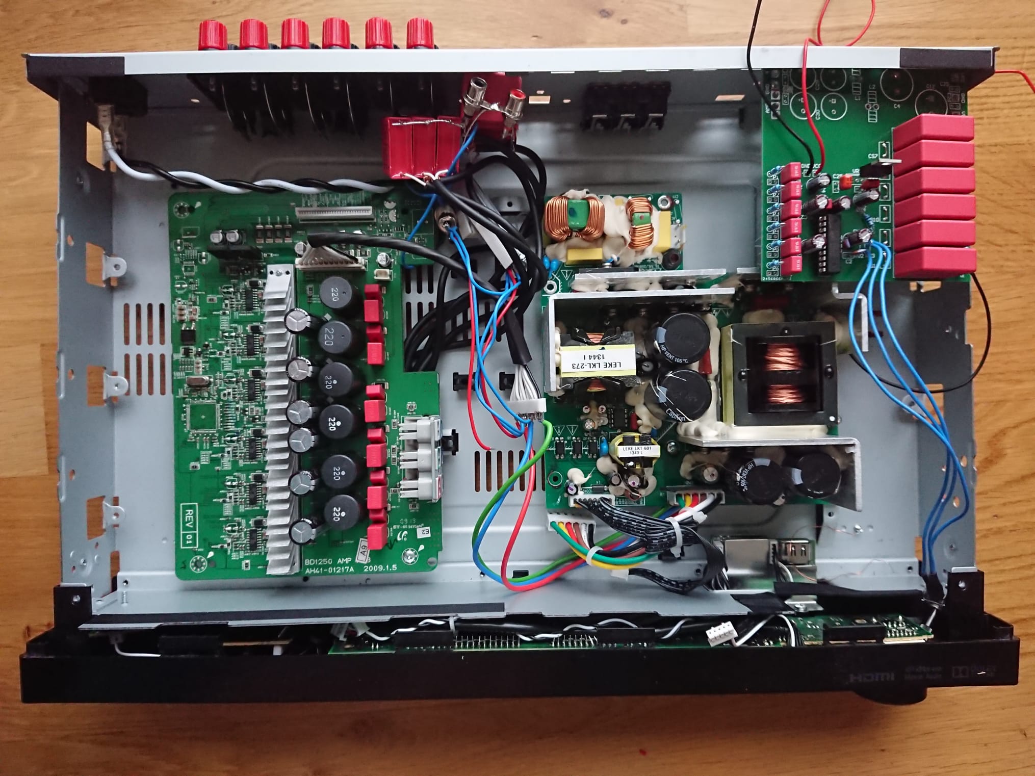

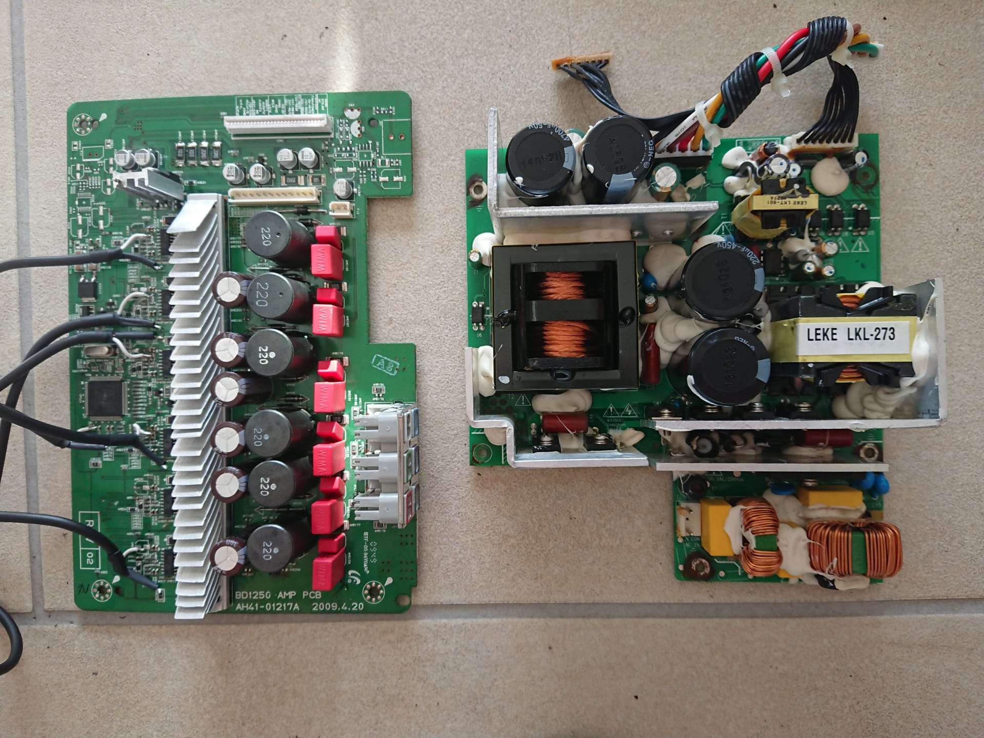

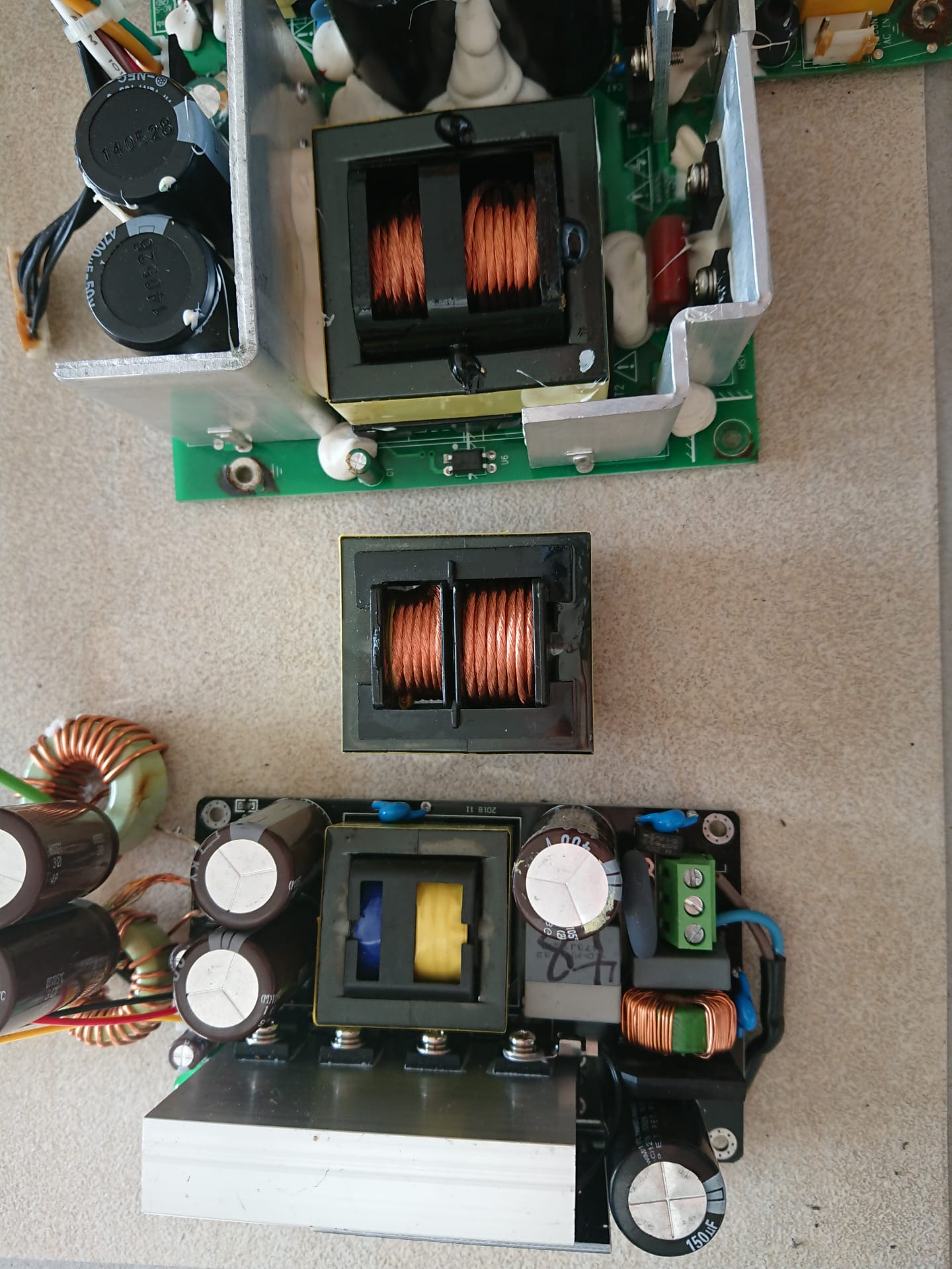

I have the problem with simulating such a smps, not because I can not design it but the transformer who is from a pc supply I have calulated with ExcellentIT7300 looks like the voltages are way higher on the calculated coil values, I had 15 volts 15 amps, 300 volts 250 volts 250mA and 2 x 120 volts 250mA it is for a tube preamp to test the circlotron.
Maybe I did something wrong, it is a ETD 39/20/13 core, I have test all materials but did not change much, why is this? or has this core a gap? the pc supply was half bridge, I have used half bridge, for simplicity when making transformer.
I have simulate al kinds of freguencies, none did give satisfied results, always to high voltages, Maybe ringing on the rectifier I did used a full wave 4 diodes rectifier to spare to much windings.
thanks for eventual giving tips.
