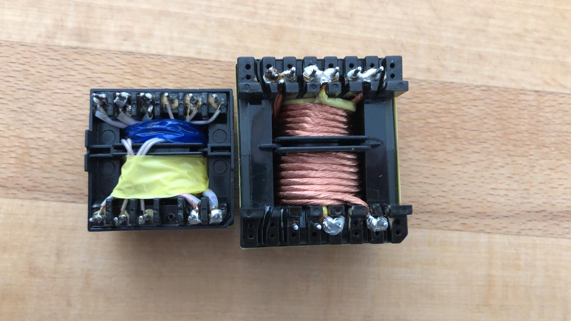

So I receive the new power supply. Can someone say why there is some wires from high to low side under the transformer? Is the galvanic isolation true with that thing?

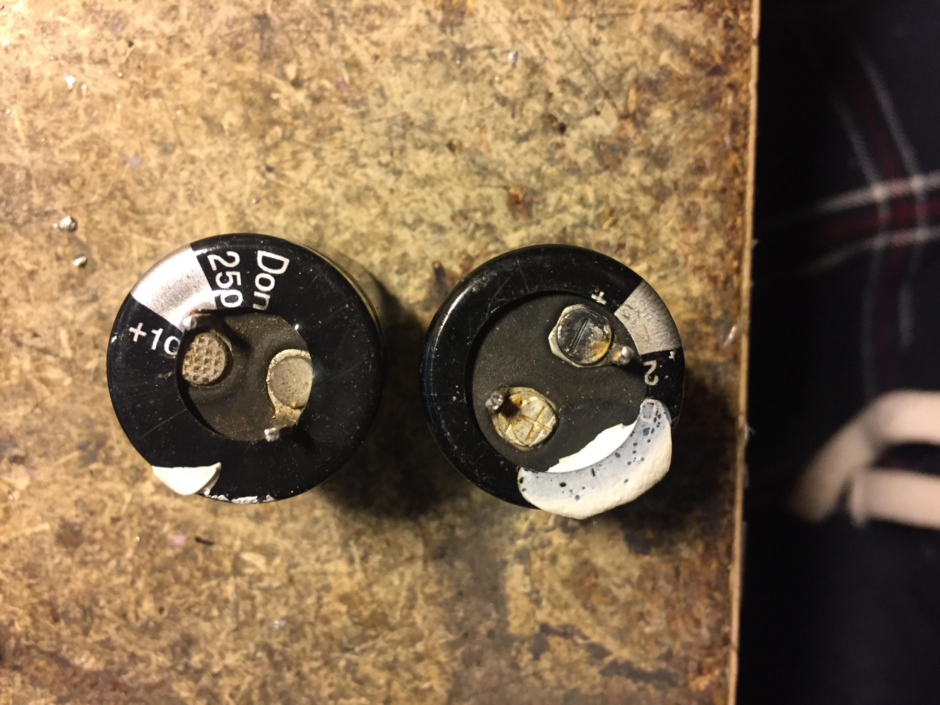

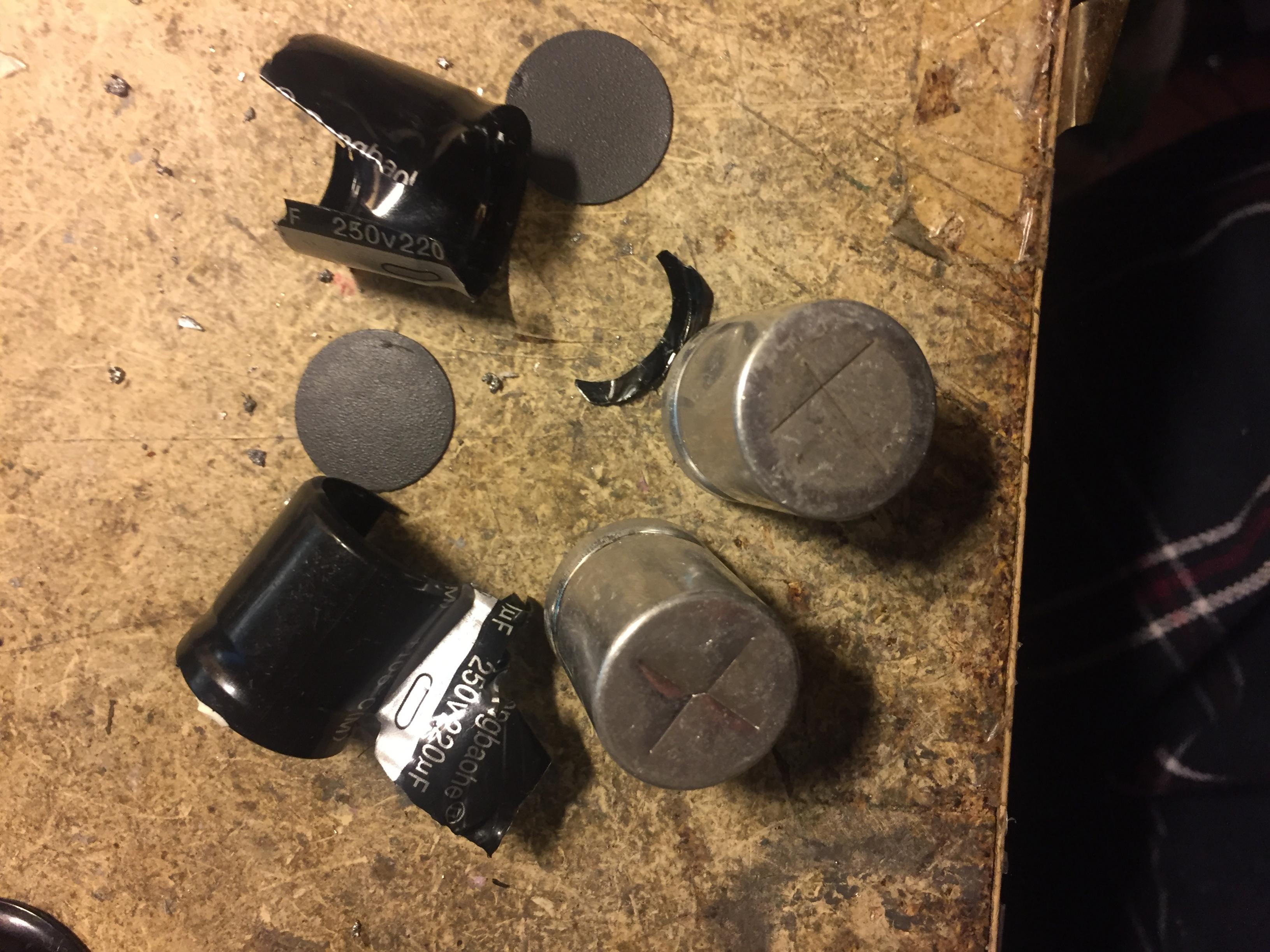

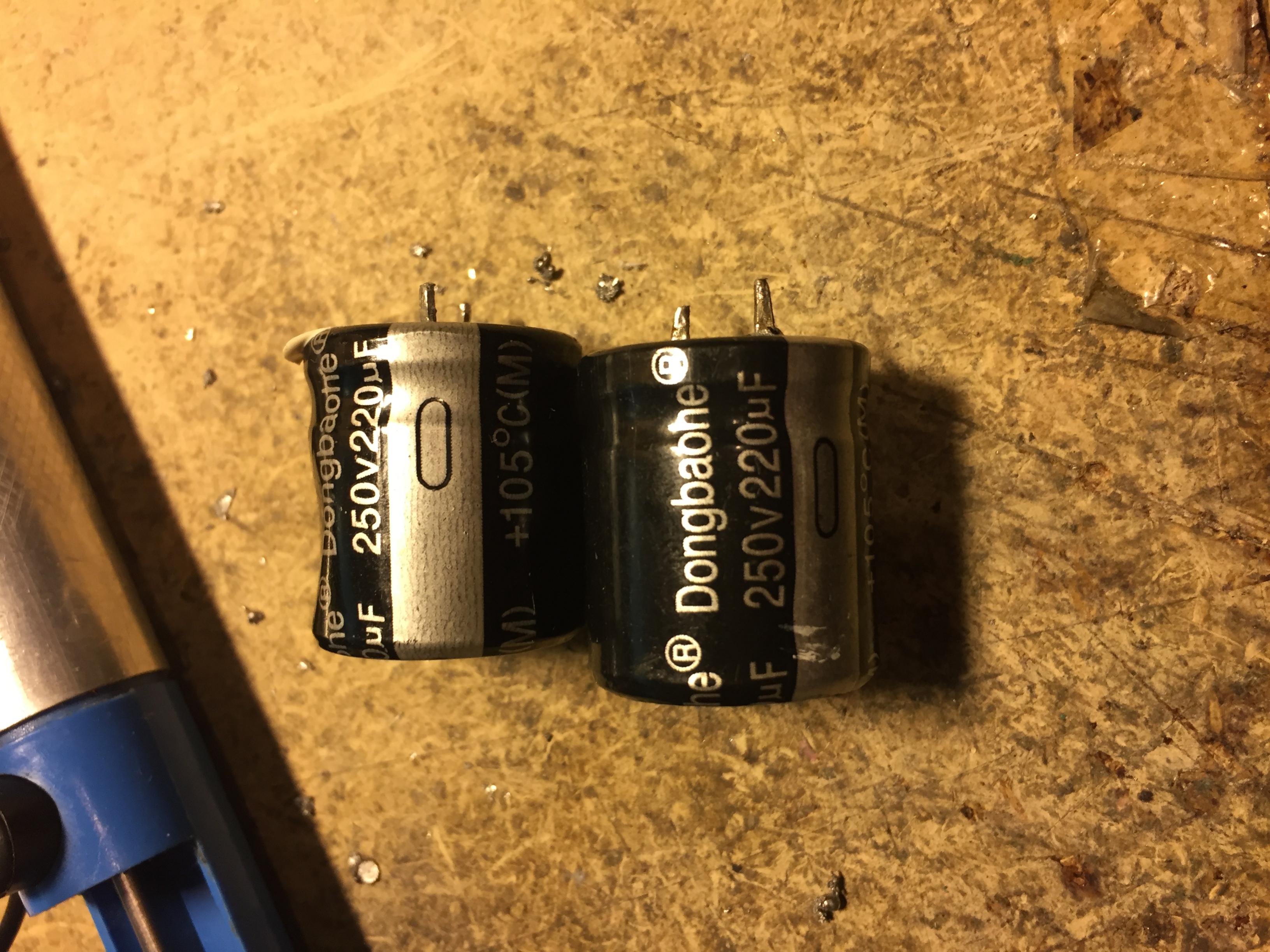

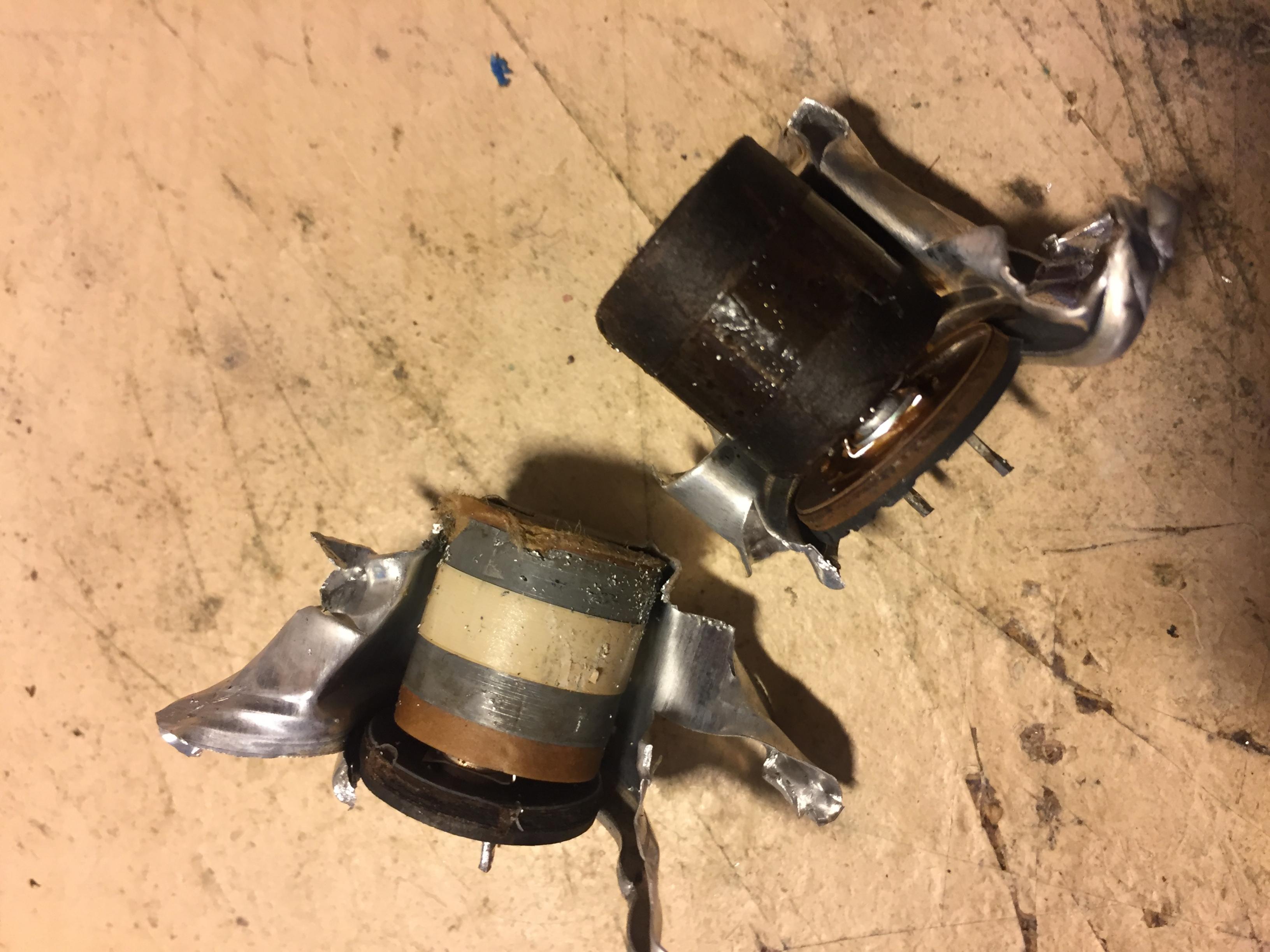

Im buying from china all the time, but only low-voltage components. This is what I found in my 3d-printer PSU.
Its a very common unit. Must be millions of them out there.
I always get rid of capacitors with bad print. But after seeing the top of the caps, I just had to open them.
The first rule about Amp Club is: You do not use chineese capacitors! The second rule about Amp Club... You DO NOT use chineese capacitors!

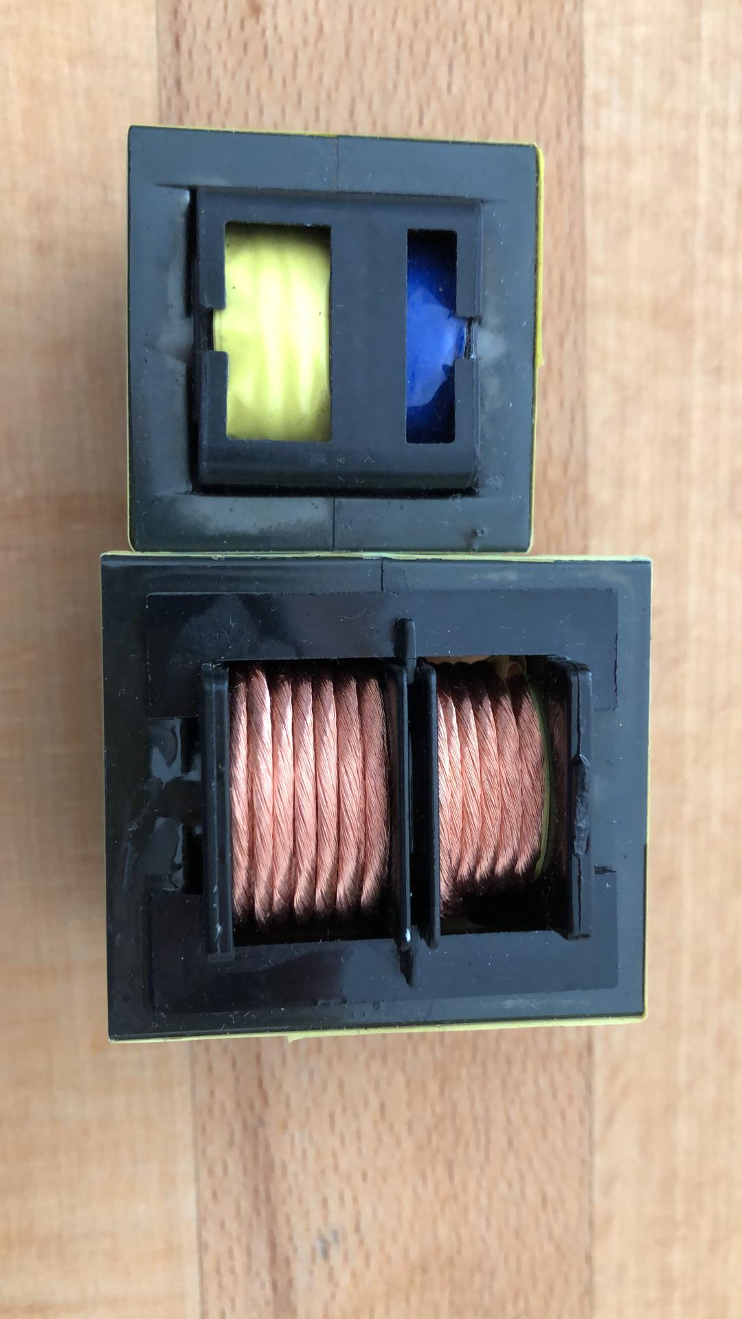

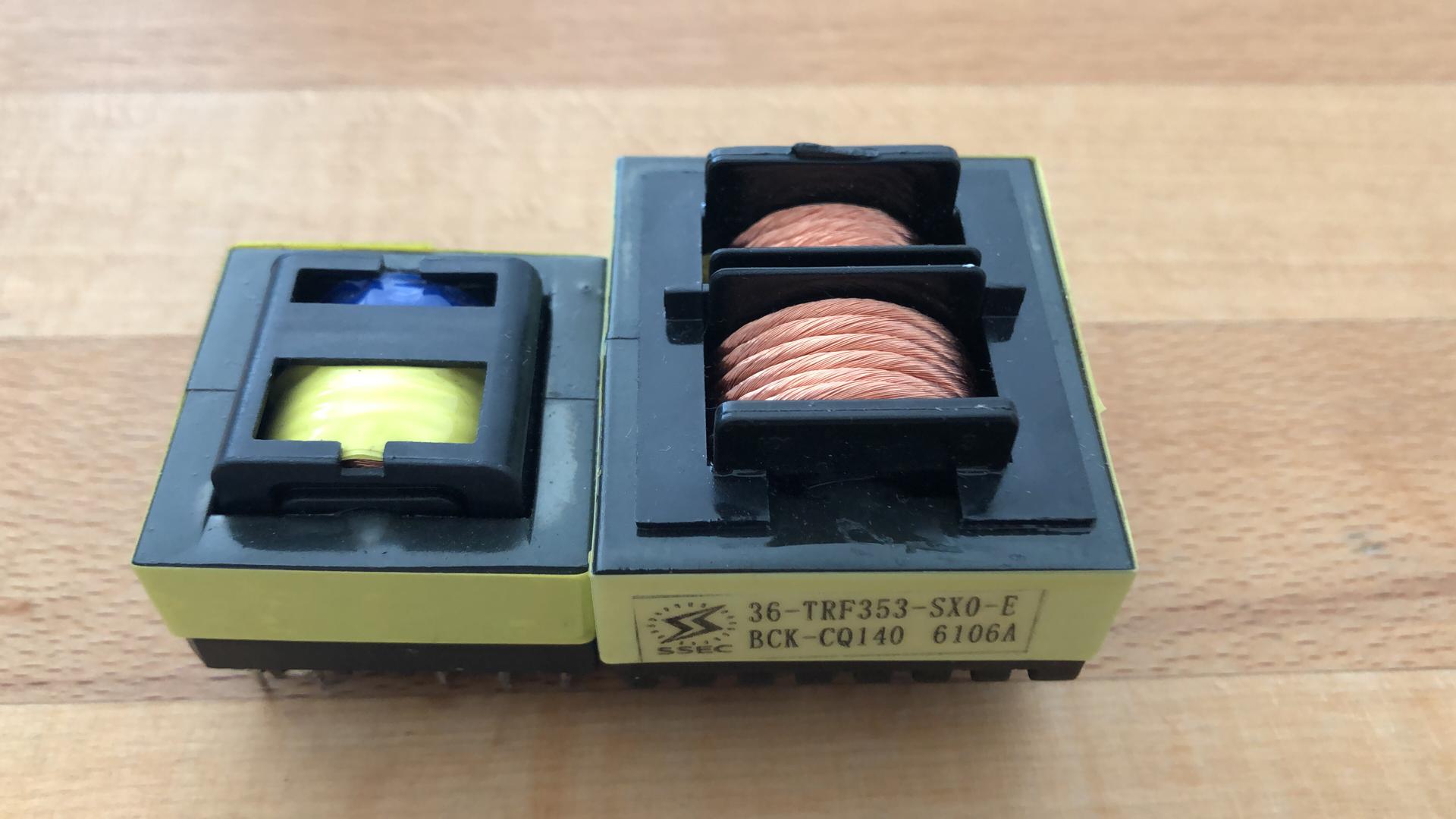

I just desoldred transformator for comparesion with other. Small one is from 500W LLC china supply other from an Panasonic Homecinema.
Wires are not soo thick. Did it help you heinrichh?
What you see is that some wires cross high to low side!!!!
I use Chinese caps all the time. Rarely had a failure, either but I use them for filtering and coupling...
Are they V close to free??
Can't imagine any Real Life audio weenie reason for economising on Caps though.

I got today a much more powerful supply. Output is only 36v. Look at the difference between the transformers.
